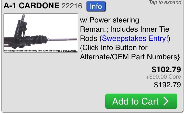

Motor is coming out in a couple of weekends for a refresh. I got to thinking about all the squeaks and creaks the car made when it actually drove/and the power steering fluid leak from the rack. So after filling my cart with MM Tubular control arms and looking up K members and coil overs etc. It hit me. If I’m lucky,after the engine refresh and the rebuilt aode-I’ll be lucky to be pushing 275rwhp. Do I really need the light weight,corner carving adjustable suspension?
My ultimate goal is to put it back together as a driver,and just drive it.

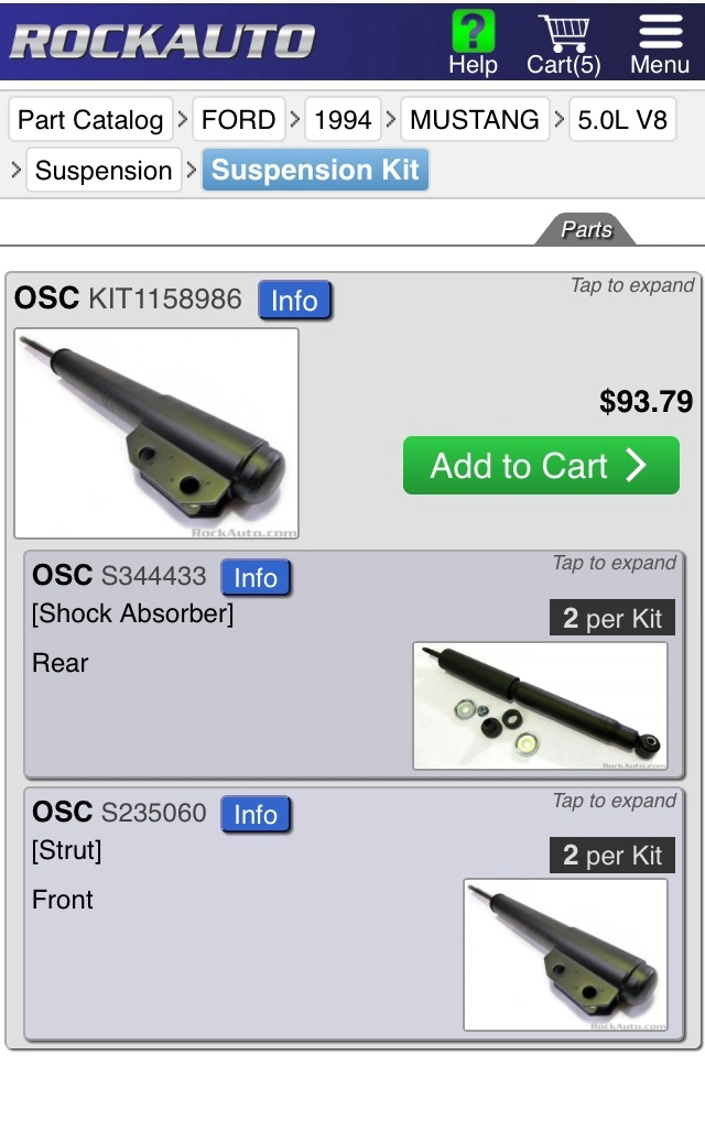

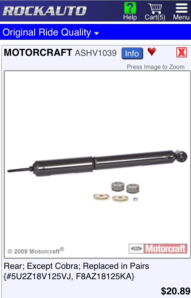

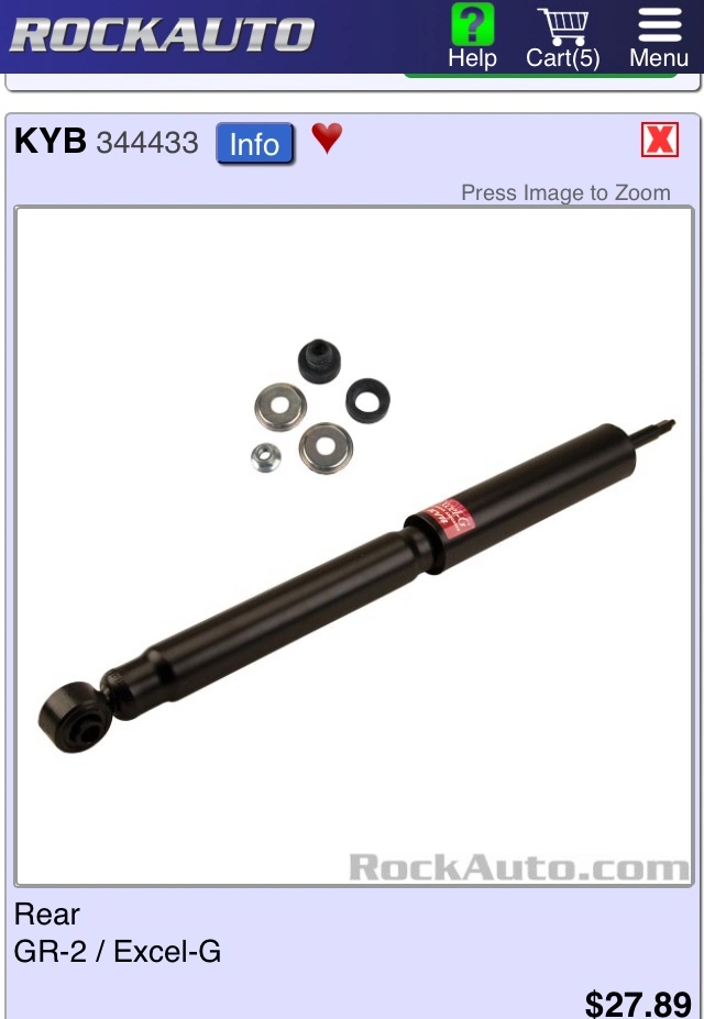

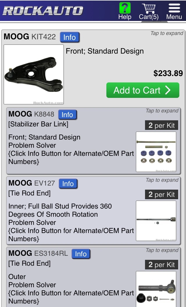

I paroozed around Rock Auto and looked up OE replacement parts,and the cost as you would imagine is a lot less lol.

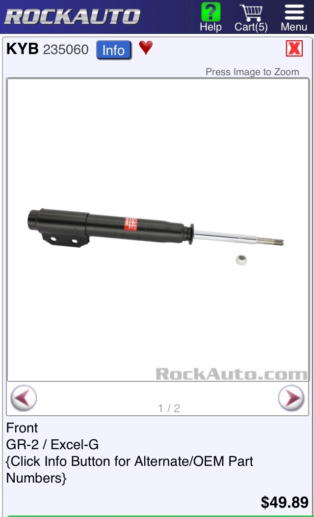

Stock shocks suffice?
Or would the KYB’s be a noticeable upgrade?
Same with the struts?

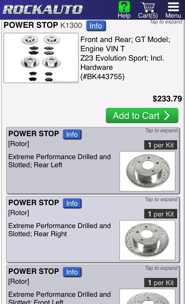

Factory rotor prices and these drilled and slotted rotors are pretty comparable. Are they any better than the stockers?

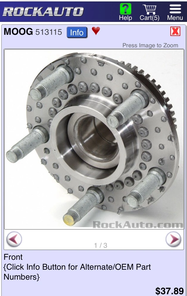

My hub bearings seem fine-but while it’s all blown apart?

I agree with you. K member and coil overs would be nice to have-but not in the immediate plans. I’m going to go the Oe/Moog route for steering/suspension. I am going to look into the Cobra steering rack and the MM steering shaft though :-)

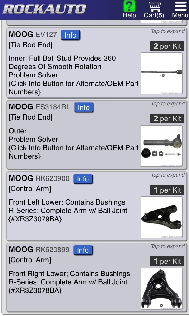

To the OP, just fix what's broke. The front bearings are double ball bearing, and start to ride with only a little bit of age. You can check them with a dial indicator. As for the ball joints, tie rod ends, etc, if they are wore out, replace them. As for the tubular stuff, I could take it or leave it. As said before, it's a lot of money spent for minimal gain. If you really want carve some corners, spend your money on quality shocks, rear control arms, and tires.

Not a fan of slotted/drilled rotors, don't need them unless you like that look I guess.

Why spend $230 apiece for control arms when you could do the bushings and ball joints on both sides for less than half the price of one new control arm, if you want shiny then blast them and por15, they will look like new. I think the tubular control arms are not much more money
