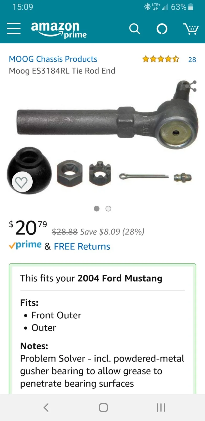

Is this the correct outer tie rod end to connect the '03-'04 Terminator/Cardone 22-2000 steering rack to a '94 spindle?

I think that will be either too long or too short, don't recall... If you're putting it on a fox that is. I used the 93 Taurus tie rod ends and left the 03/04 cobra inner tie rods in place as the threads match on those and they are good length wise. The other option that most people go with is to use fox inner and outer tie rods and replace both on both sides to make it fit right.
