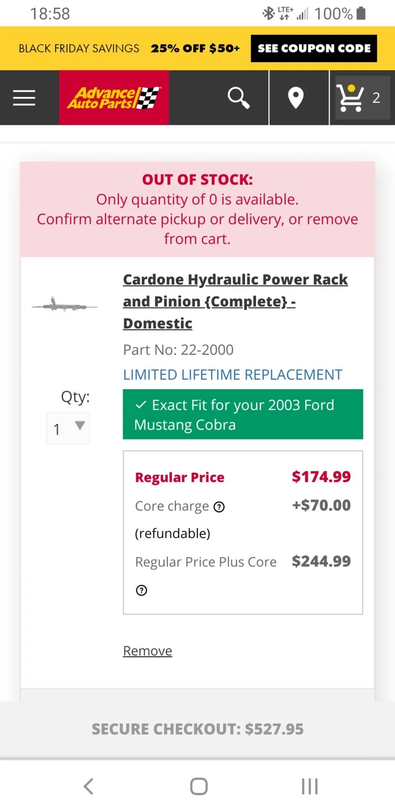

For those of you who bought a Cardone 22-2000 (SPR-ZM) steering rack, where did you get your? These seem hard to come by as most places require a core.

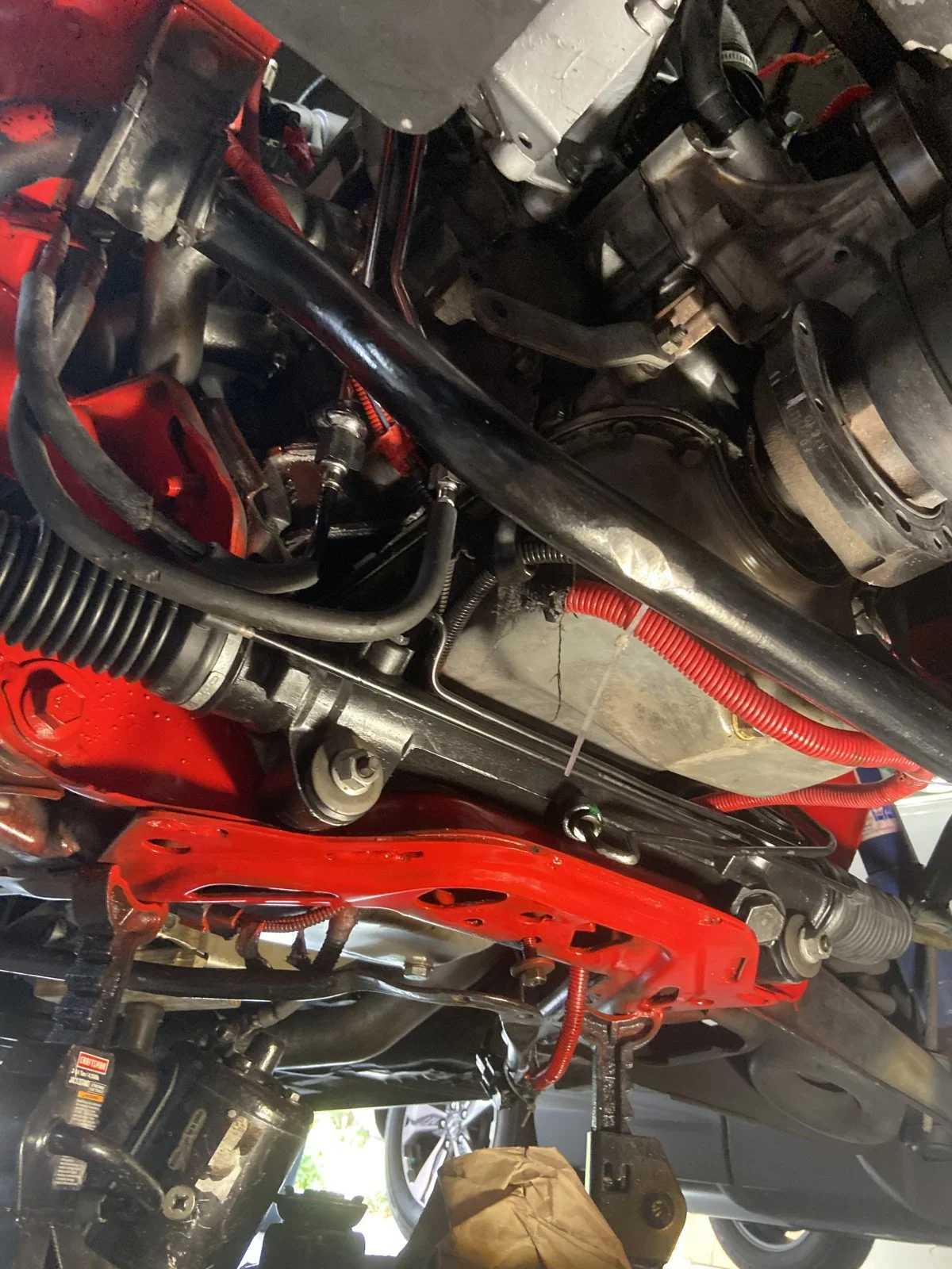

I got mine from advanced Auto parts, and simply returned the stock fox rack that was covered in grime and the guy didn't care... just said cool and gave me my core. HUGE upgrade in steering feel.
Did you purchase it online or do a local pickup? I called my local Advanced Auto Parts and they have a inventory of zero.
The only place that seems to have them in stock is Amazon at $440.
I just checked, seems the source of racks is drying up. Even eBay had none, which is strange.
Guess returning fox racks as cores leaves nothing able to be rebuilt

Alright, f it! I pulled the plug and bought the only remaining Cardone 20-2000 I could find online. Seems silly to do all this work to my car to retain sloppy steering. I can always return it through Amazon. Yes, I just justified the purchase twice in one paragraph.

I got my two and half turn at Advanced for $70.00 25 % off . Leave it in your cart. If your a member after a day they e-mail a 25% coupon . Let me say again . Unbelievable feel with supplied bushings....Also get a filter they say its needed.IMG_0238.jpg
Did you buy yours months/years ago? They don't seem to be available anymore unless you bought a non Cardone one. Do you have a part number or a screen shot. I'm not excited about dropping the $400+ on Amazon, but there doesn't seem to be anywhere else to buy one unless I pester all the Southeast Mustang salvage yards.

I'll probably install a new power steering pump as my old one is shot (numerous leaks) and I don't like to deal with problems a second time.
I'm planning all new steering rack, outer tie rods, power steering pump and even a new steering column with MOMO steering wheel. This will be similar to my 5 lug '03 Terminator brake swap out.
