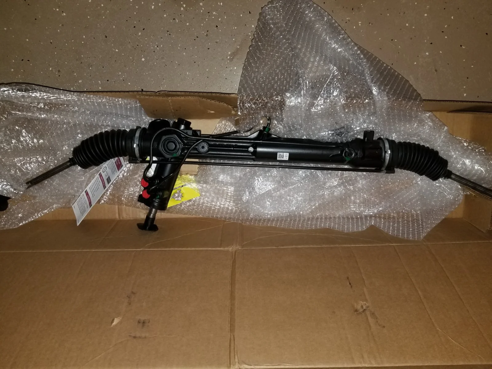

My remanufactured Cardone SPR-ZM rack arrived today. Here's hoping it's actually a SPR-ZM rack inside. Big thanks to Mustang5L5 for helping me through the various part model number process.
Thanks. Ya, I'm looking forward to excellent steering matching my excellent brakes.
This project is similiar to the '03 Terminator brake upgrade. Meaning lots of miscellaneous parts. Thankfully this trail has been blazed by many beforehand. I'll do a write up on my progress thread when I finish the upgrade.

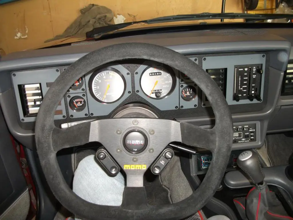

Looked to easy to not try to make own.Started with a cardboard template then transferred to 18 gauge steel,hour or so later had a working cruise button mount.Hardest part was coming up with a way to mount the switches but wasn't too bad.
my
I'm about install this same setup in my '84. Any tips or suggestions on the wiring of the 87-89 cruise buttons?
