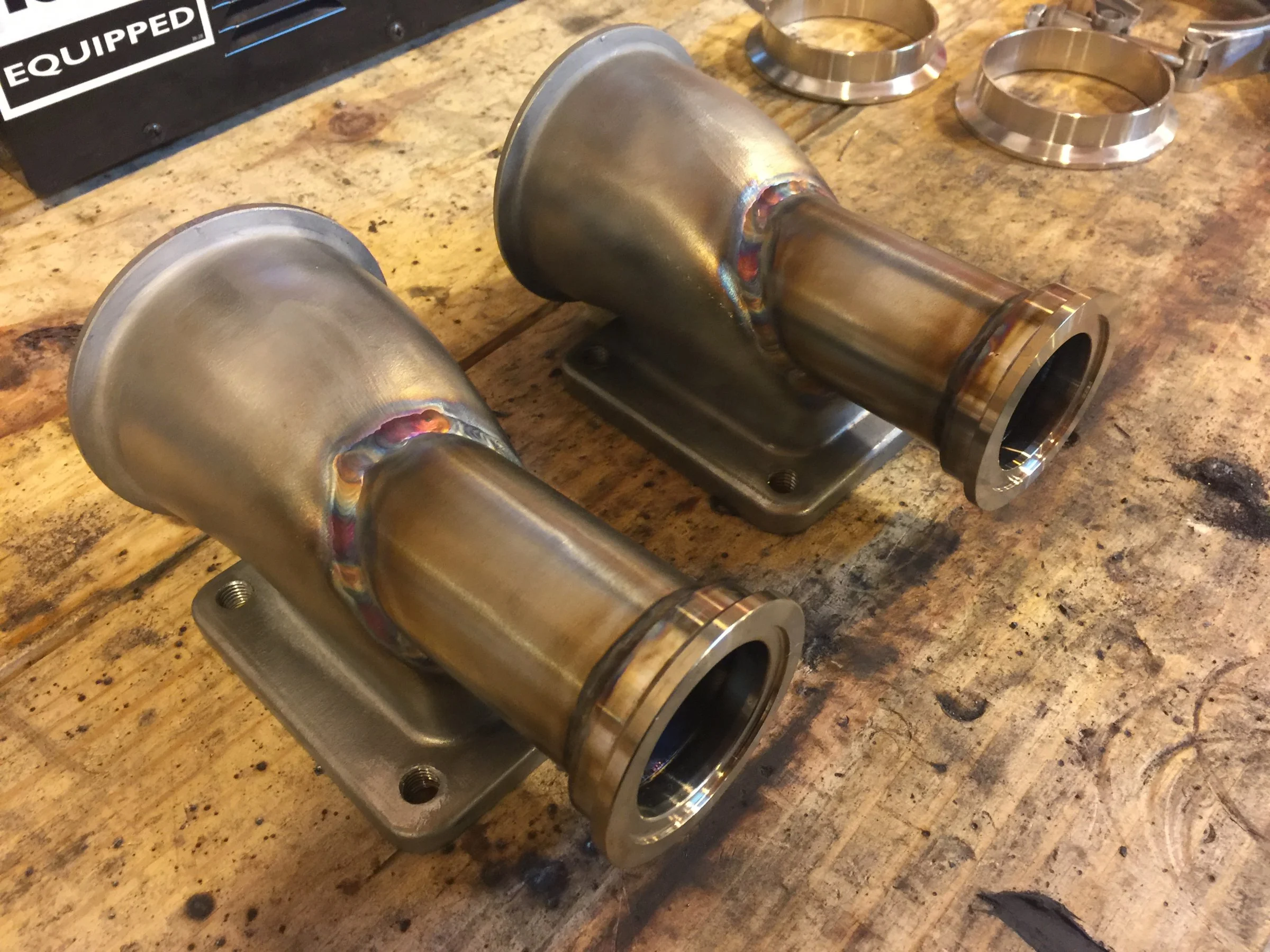

They let me stick weld with Jet Rod at work every so often and if you want to really give yourself a false sense of skill that's the way to go. You could weld a brick to a tree stump with that stuff. No cleaning, no real prep. Looks like a stack of nickels.
Yet my flux core stainless today looked like a large bird took a dump through a screen door
Key words: flux core. Throw that crap away.

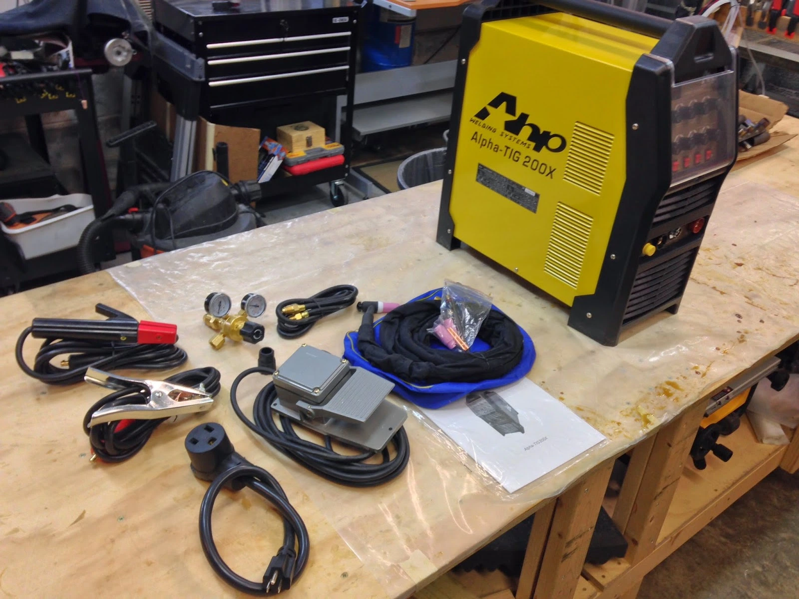

Well I did a thing. Ended up going with an AC/DC machine like everyone was trying to tell me to. It has some nice features for not a whole hell of a lot. It's a China machine but has a pretty good reputation. I watched a ton of review videos on a handful of them which kept me up until 2am.
Won't be here for a few weeks which sucks but I'm pumped to get back into TIG welding. Will be able to do some cool stuff now without relying on someone else's time and hourly rate

madmike1157 said:
which china machine?.....seems to me you'd be posting a pic of your newly acquired path to shocking the sht out of yourself for the rest of us to see.
AHP AlphaTIG 200
(Not mine obviously)
Does TIG and stick, 110/220 so I can use it while I procrastinate the 220 wiring in the garage. 2016 model comes with a flex head torch and a foot pedal. I learned on a foot pedal so I'm more comfortable with it than the hand control for now. Has pulse settings for the AC. They're $800, found one on sale for $670 so I pulled the trigger

tannerc91gt said:
AHP AlphaTIG 200
Dude. That is a smokin deal on a very capable machine! Pulse settings, foot pedal, ac/dc. Sweet! You can weld anything you want now, literally.
I'm jealous! Congrats!

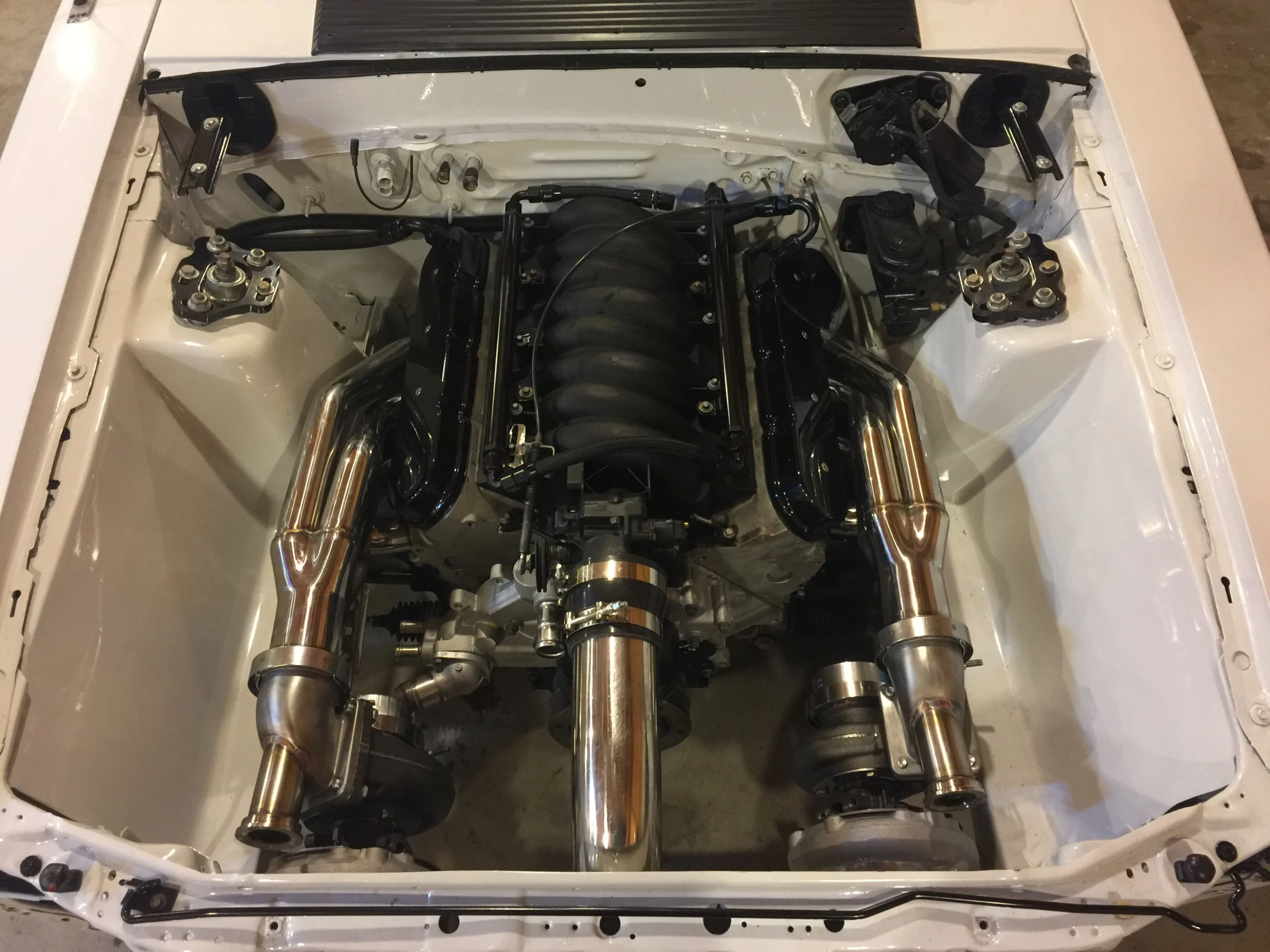

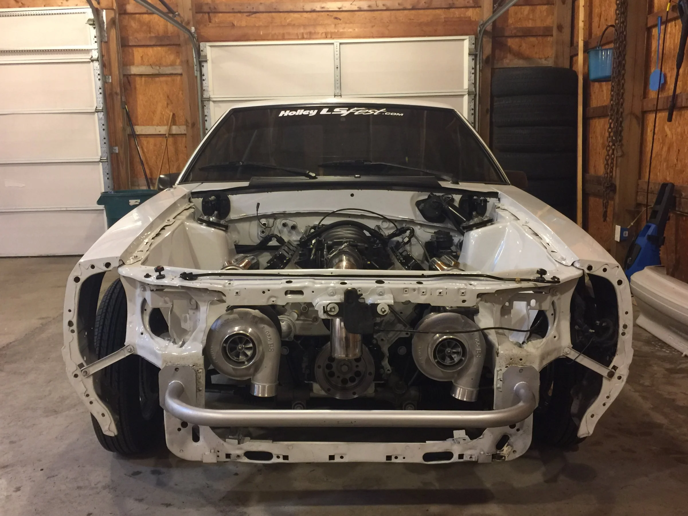

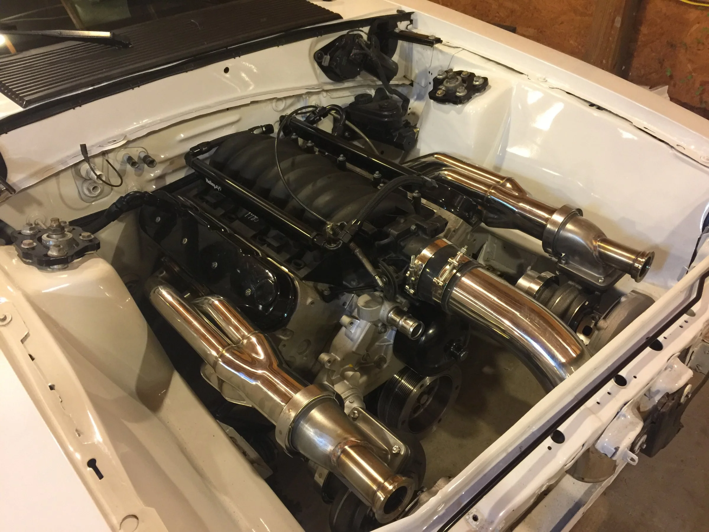

Reactions: a91what, skyline247, hoopty5.0 and 4 others

Jesus. It's like a triceratops of awesomeness

Looks like a car you would see at SEMA.
I'm trying my hardest to keep it like that. I like the symmetry

Looks just f***ing bad***!
Please please see this car through to completion. I want to see it run/make some passes.
