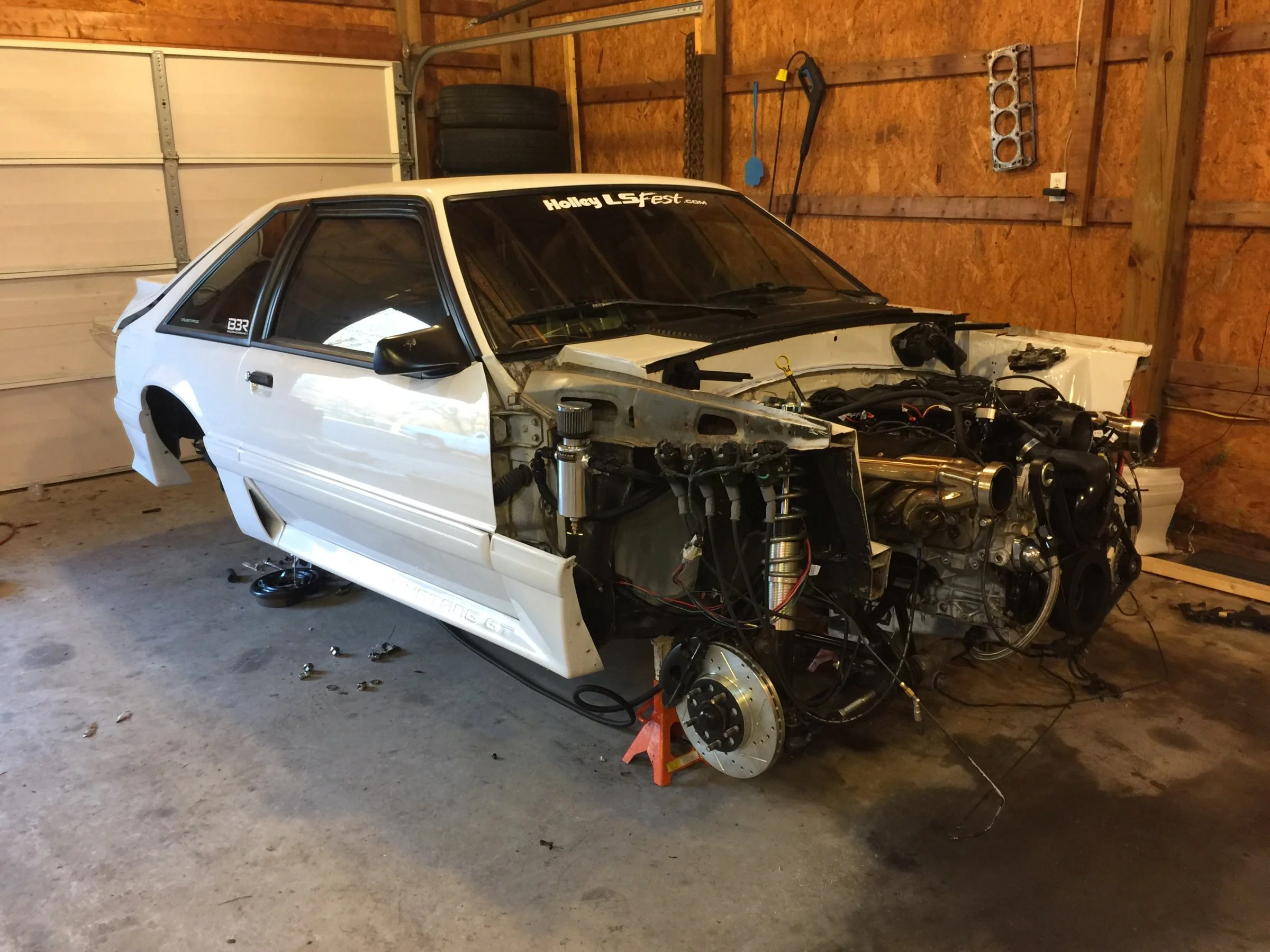

Time for a more official State of the Union.
I've been fighting this non-running-pain in my ass car since January.
Switched to Holley EFI, got the car all wired up the other day.
Still won't run. Pretty similar circumstances.
Fires, immediately dies.
I chased my tail a good bit. Rewired damn near everything, which needed done anyways.
Logged a ton of attempted starts. Just didn't see anything weird.

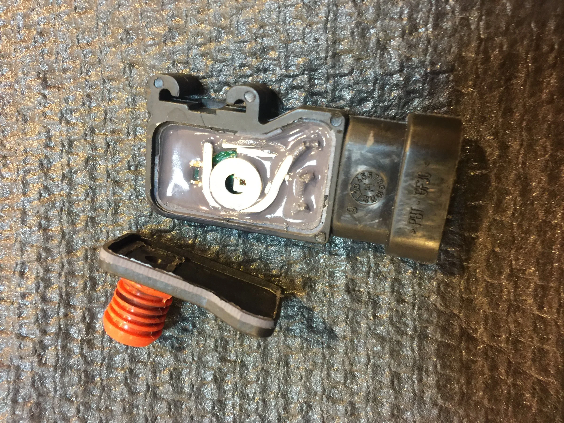

Until today. The map reading dropped to 0kpa. Logged a few more attempts, and saw it again.
I decided to remove the map sensor and check it out.
Mystery solved. This is a 3 bar map setup to fit an ls1 intake. I've heard rumors they're prone to splitting and doing goofy stuff. Rumor confirmed.
Yanked the 1 bar map off my truck and it fired right up. A buddy is sending me a 3 bar Holley brick-style map as a replacement.
Commence major idle surge. Like car is running, nearly dead, running, nearly dead type surging.
These new injectors are relatively large, even more so on pump gas, and they're basically shutting off attempting to idle.
Going to go back out shortly and clean it up, hopefully get a good idle video for the first time.
In a few other aspects, I've grown to hate a few things about the setup.
The turbos are too close to the engine, the dump tubes can't go anywhere but where they are, the coolant lines are too close to aforementioned turbos and dump tubes, etc etc. Basically 10lbs of crap in a 5lb engine bay. Just not as proud of the final outcome as I had hoped to be. Needs fixed.

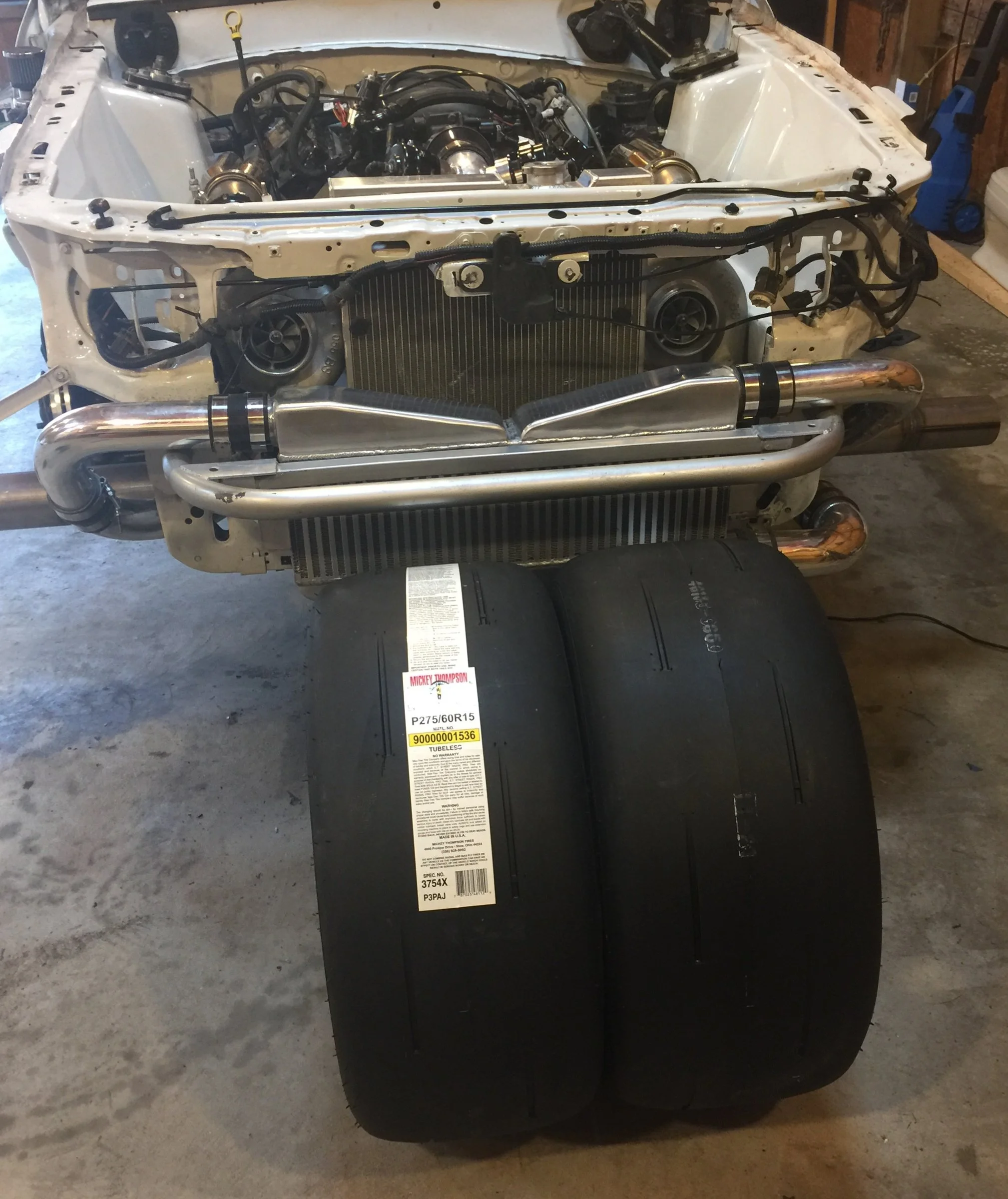

I'm sure some of you have heard of the new raffle craze going around all the Facebook parts pages. Today I won a set of Mickey Thompson 275 pros. Which is great because my 555rs are spent and a :poo:ty tire to begin with.
The other thing I won last night was an $800 tubular front end from 417 motorsports. I might have mentioned theses earlier in this thread.
So with next to no investment from me, I'll now be able to move the turbos out, fix the dump tubes and coolant lines and tweak some of the coldside to better fit.

Hmm you should have been able to see the bad map sensor in datalogs or on the sensor readouts. The fact that it ran at all with either system is crazy. Better now than later.
So you think the injectors are to large? I don't buy that, what are the injector milliseconds during idle? With very large injectors multiple firing events can sometimes help.
I don't think the MAP sensor came apart until today. It acted pretty normal up til that point. I think it was a bad sensor calibration for most of the time. I know I tried a few different presets today with drastically different results.
