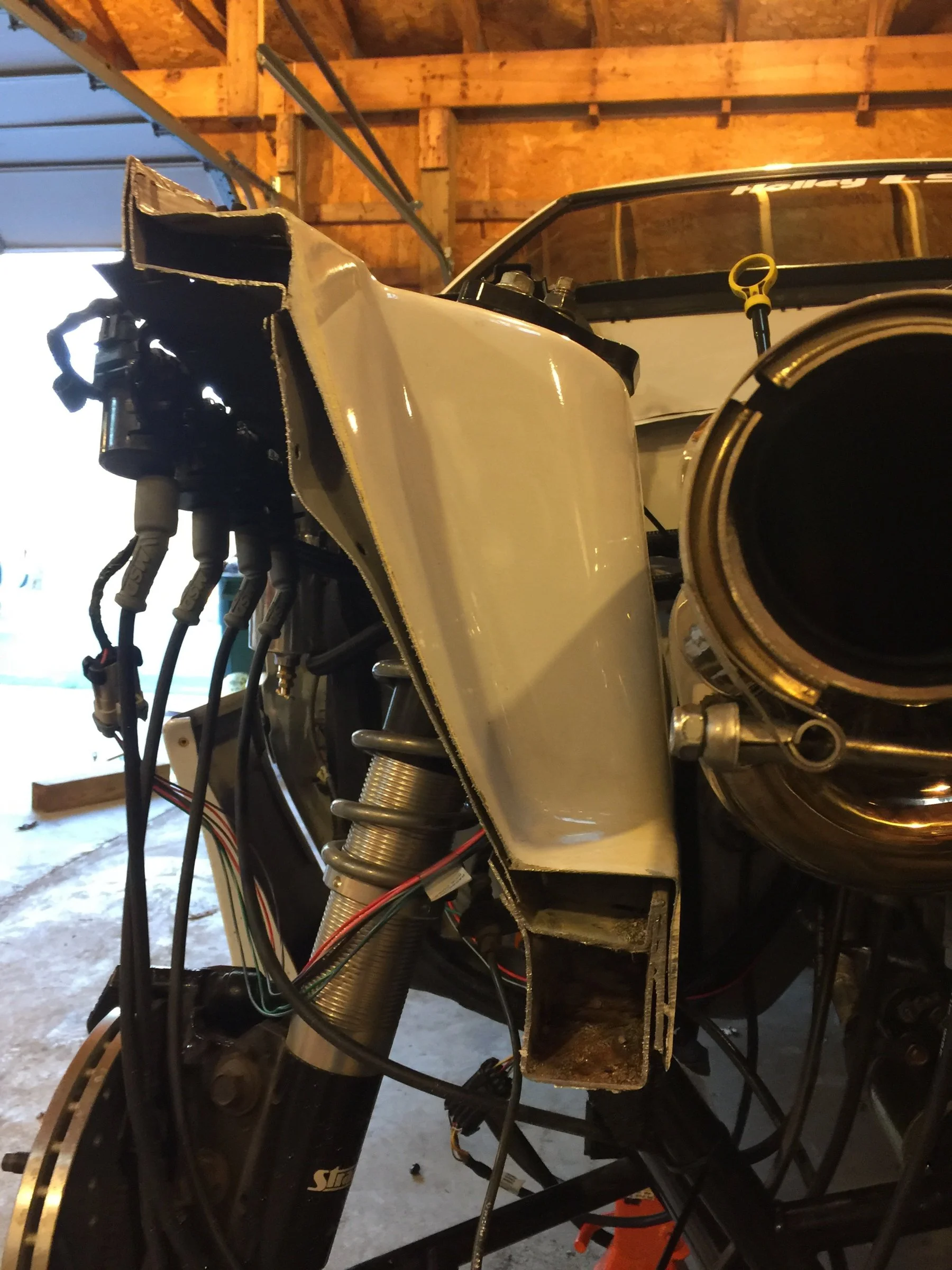

So much for the hours spent smoothing the fender aprons....
I spent 0 hours smoothing the bay. And the guy that did should have spent about 100 more. Did a :notnice: job.
Gobs of bondo (which had chipped in a couple spots)
The panels were laid over the original aprons, leaving me with less space than factory would have left me. Mig wire in the wheel wells where they welded them on. Sandpaper marks in the aprons where you could see they should have finished it out better.
Looked great in pictures and not too bad in person.
The strut towers will still be smooth and clean. It'll look good and leave me the room I need. Just my opinion :shrug:

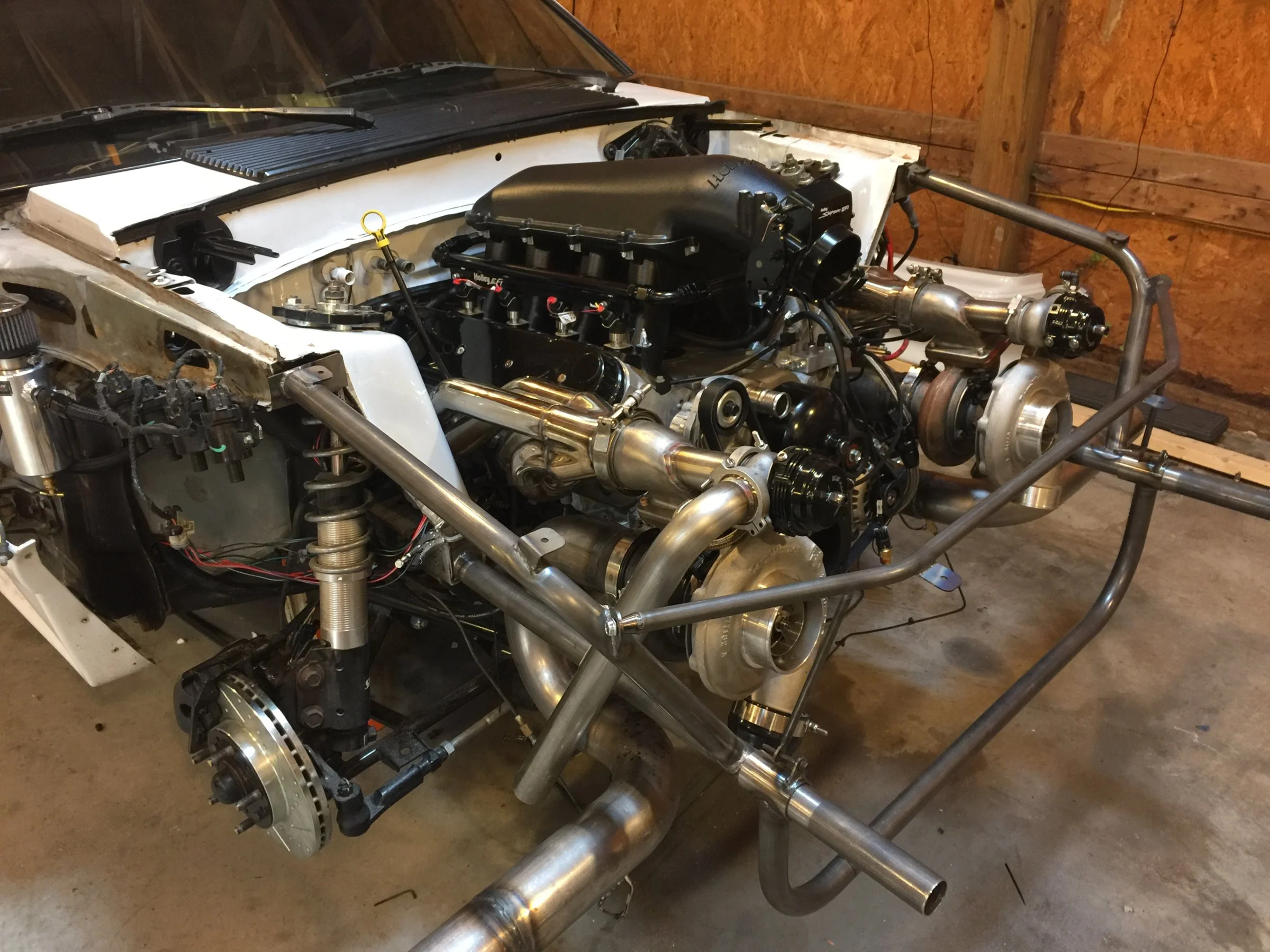

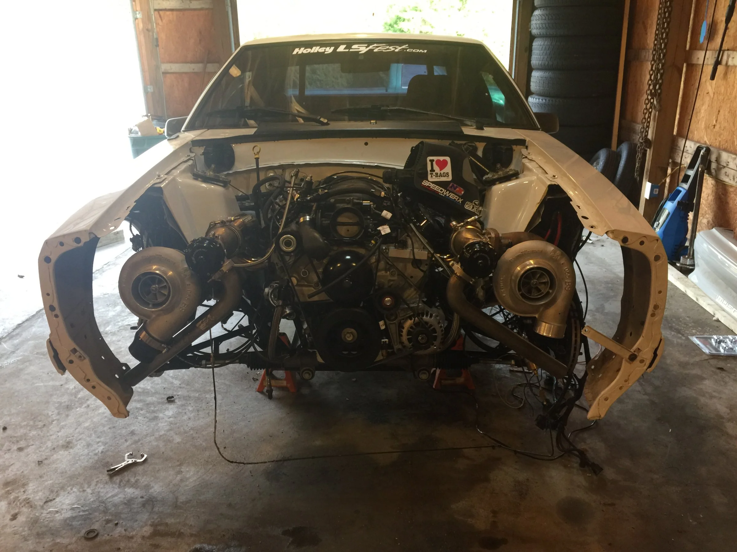

I'm very interested in seeing how the tubular front end works out.
The likelihood of me doing it is still slim on my car, but if I find a wrecked body its an awesome possibility.
Reactions: Davedacarpainter
Hopefully have the materials in time to do it next Wednesday. Looking forward to it myself. Guessing I'll have to change quite a bit of the turbo kit

I actually think the way the guy did the inner apron is just fine. It's the way I did it when I smoothed my bay on my old coupe. The inner apron is your finished panel that looks good in the bay and the old stock apron is there to attach all the wires, coils, fuses, cables, horns, etc via welded brackets, hangers, or screws.

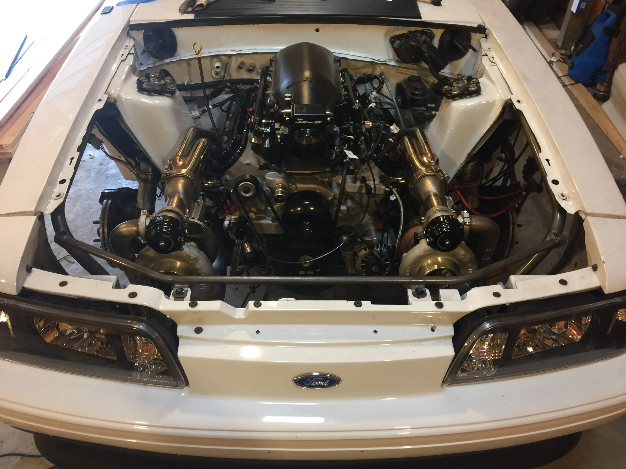

It's coming along pretty good.

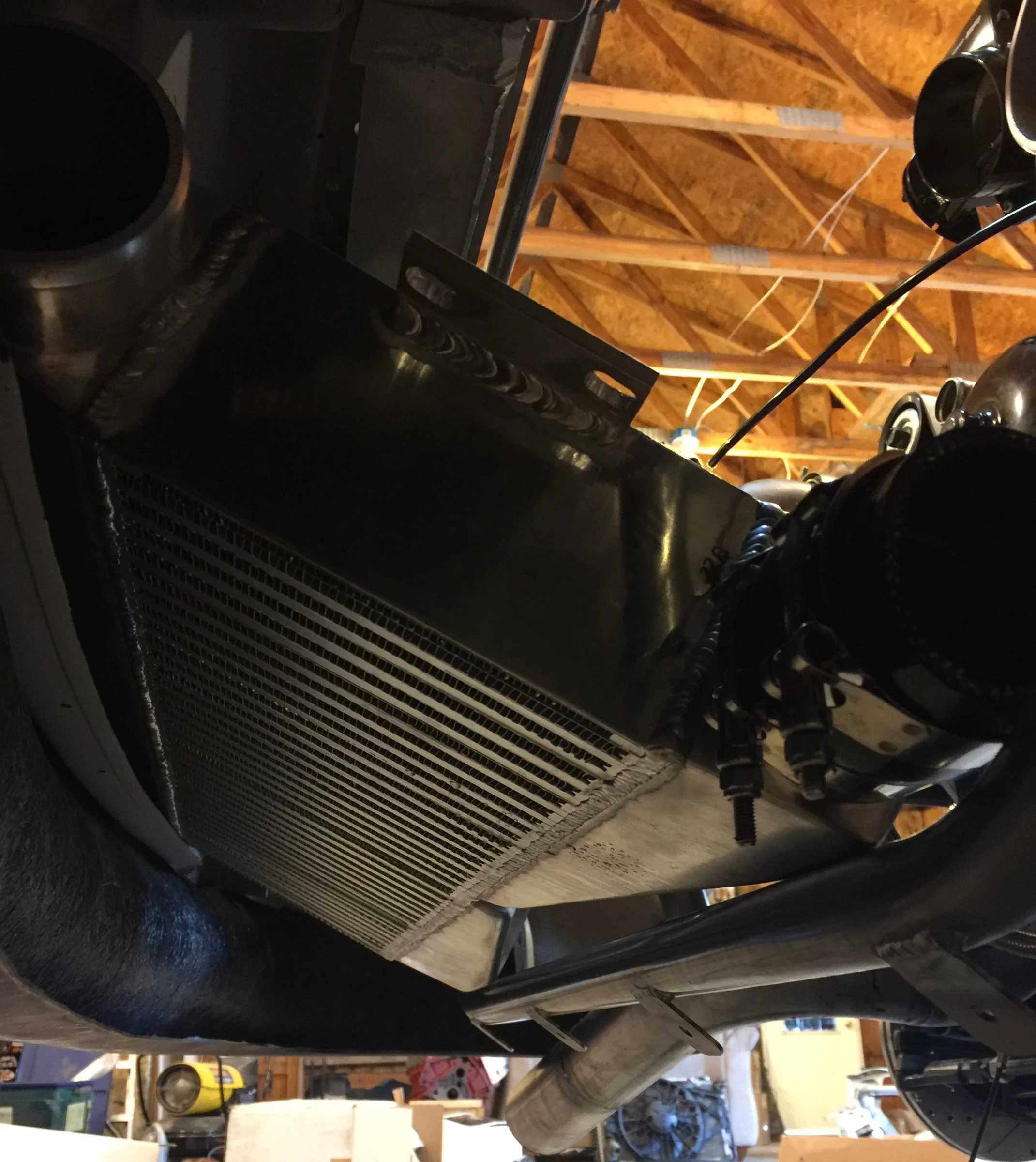

Plan right now is to lay the intercooler forward and maybe build a scoop to try and direct more air. Don't want to cut up my valance.
Wanted to go a2w but its not going to happen this year
Front end is welded on and I've started building the brackets for the intercooler. Waiting on my radiator mounts and doing some strategizing right now so progress is slow.

That looks really good, and way less crammed in there than before...You should name your engine Evil-ene
*spin on evilyn,....get it..
You can't use Evilyn, Dave's already using that name for the engine in Robby.
