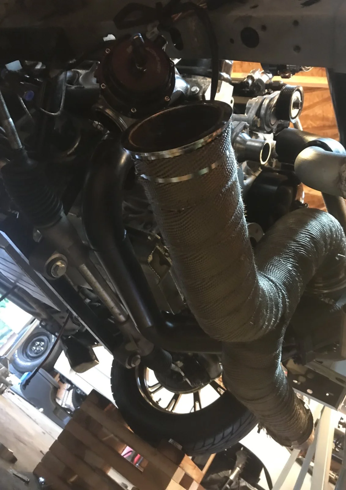

Recently ran into a Turbo Camaro guy with fender exit exhaust-he was rocking these tiny race bullet mufflers-slip fit style-with them off there was a noticeable difference.
I was surprised lol
Figured I’d mention just in case you need a slight silencer down the road
https://www.summitracing.com/parts/wlk-24249

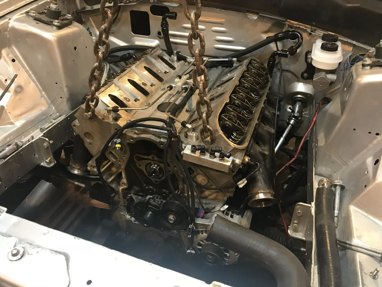

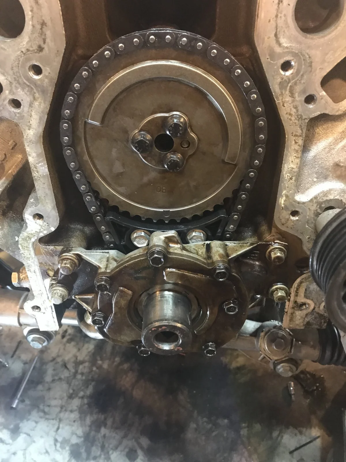

Took over a week to get the cam swap mostly finished. Still need to hammer down the oil pan bolts and put the accessories back on.
Went ahead and tore into the pickup tube/pan setup trying to hunt down my oil pressure issues.
No pinched o ring but I did find the pickup tube bolt down tab was contacting the windage tray and not fully seating so I think pan/pickup clearance could have been a hair tight. Also redrilled the motor mounts and moved the motor back 1”. Will have to redo the trans mount tabs again but driveshaft engagement is better and it gave the turbo some breathing room so I’ll call it a win.
Then I decided I’d go ahead and throw a new timing chain and dampener on while I had the front of the motor apart. Easily distracted as usual.
It’s buttoned up enough to let it go back to sitting for a while

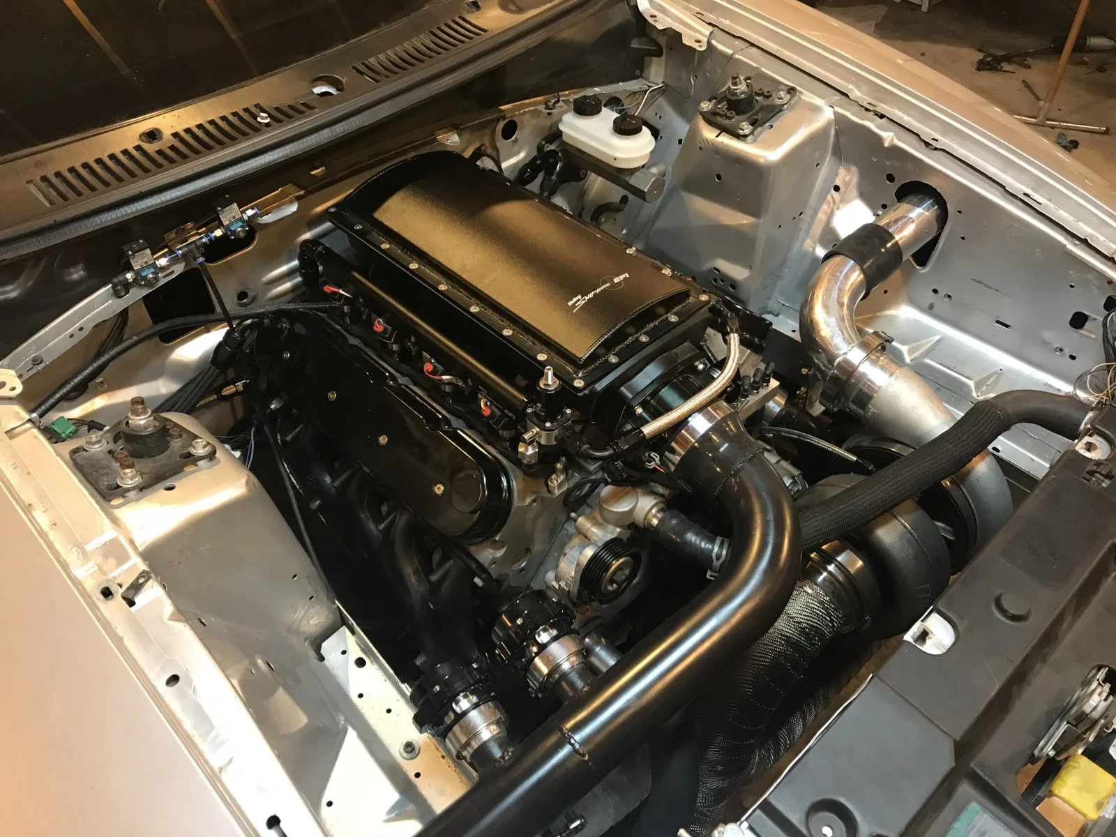

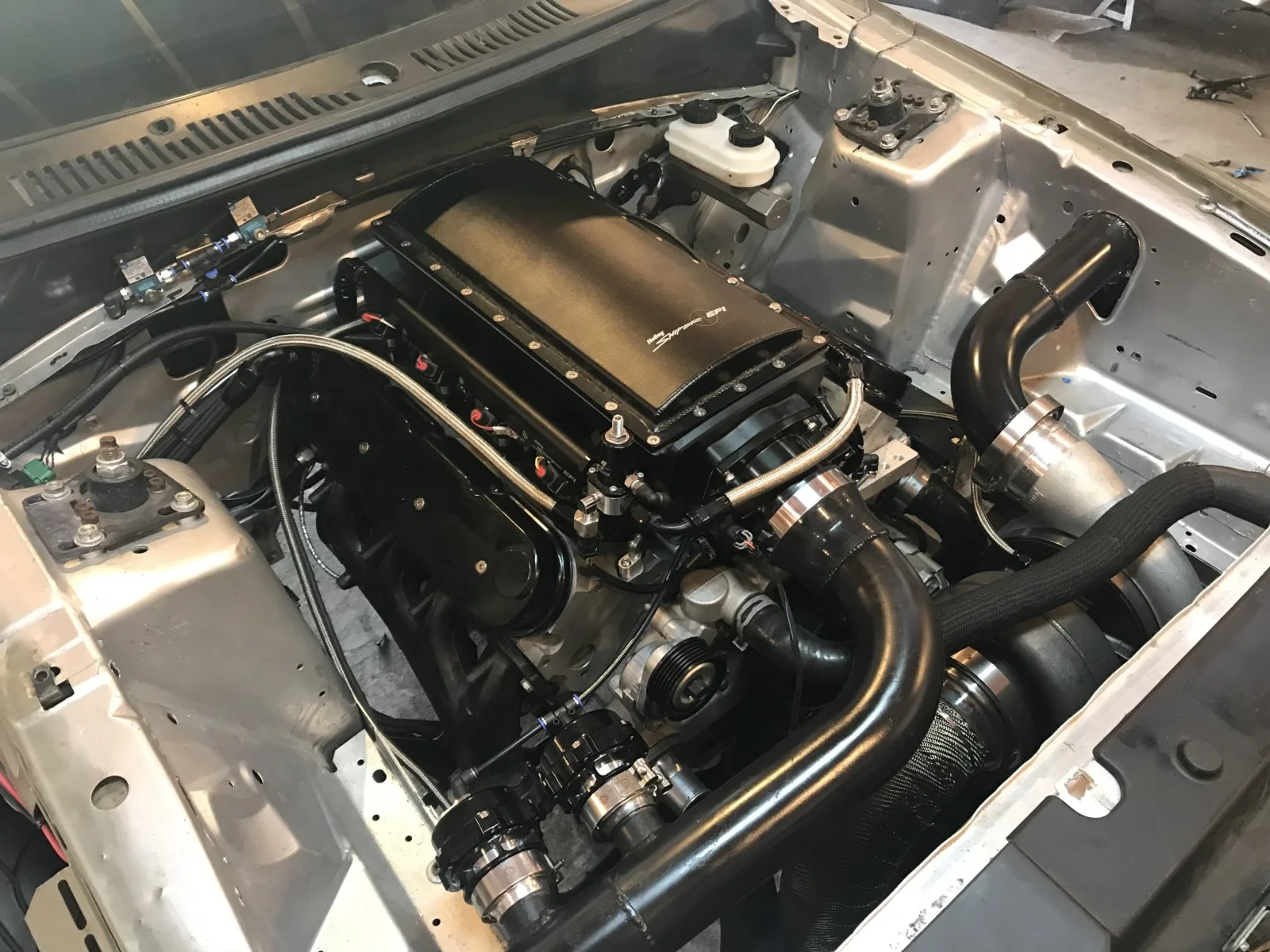

Got the new end tank welded up on the intercooler. Also got the motor buttoned back up and the turbo kit bolted back on as well as the first coldside bend welded together.
Even had a visitor come out and check on the progress
Reactions: JoeDaddy, Flatfoot, 90sickfox and 5 others

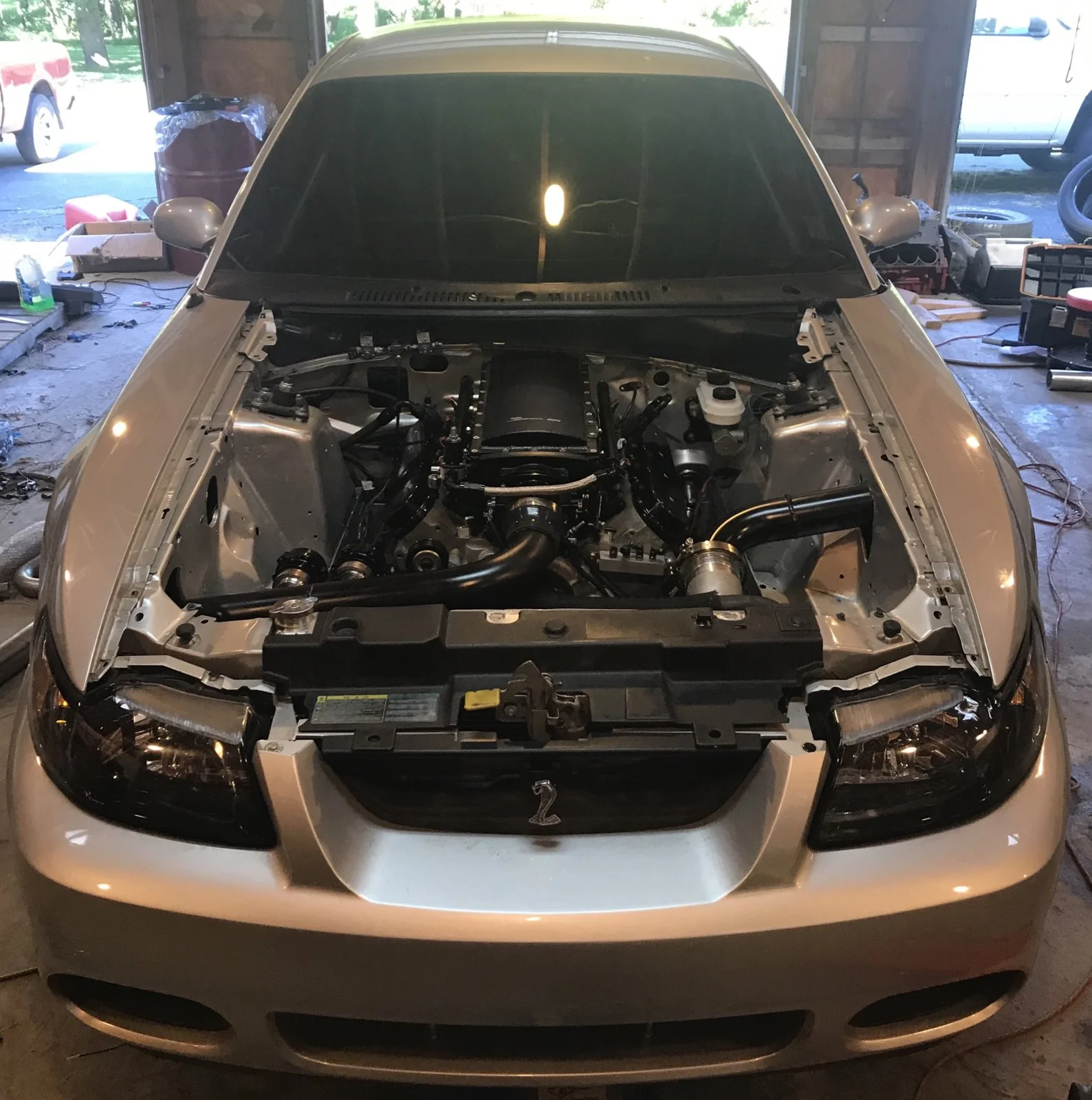

Man you have made some serious progress. Looks close to running

That looks really clean Tanner, nice fab skills brother.

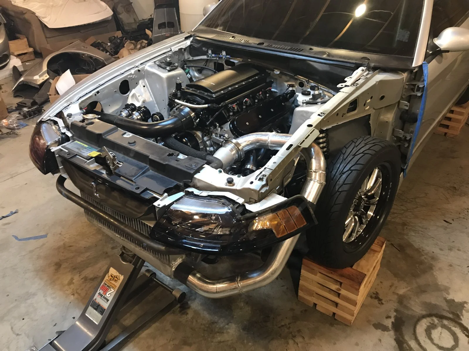

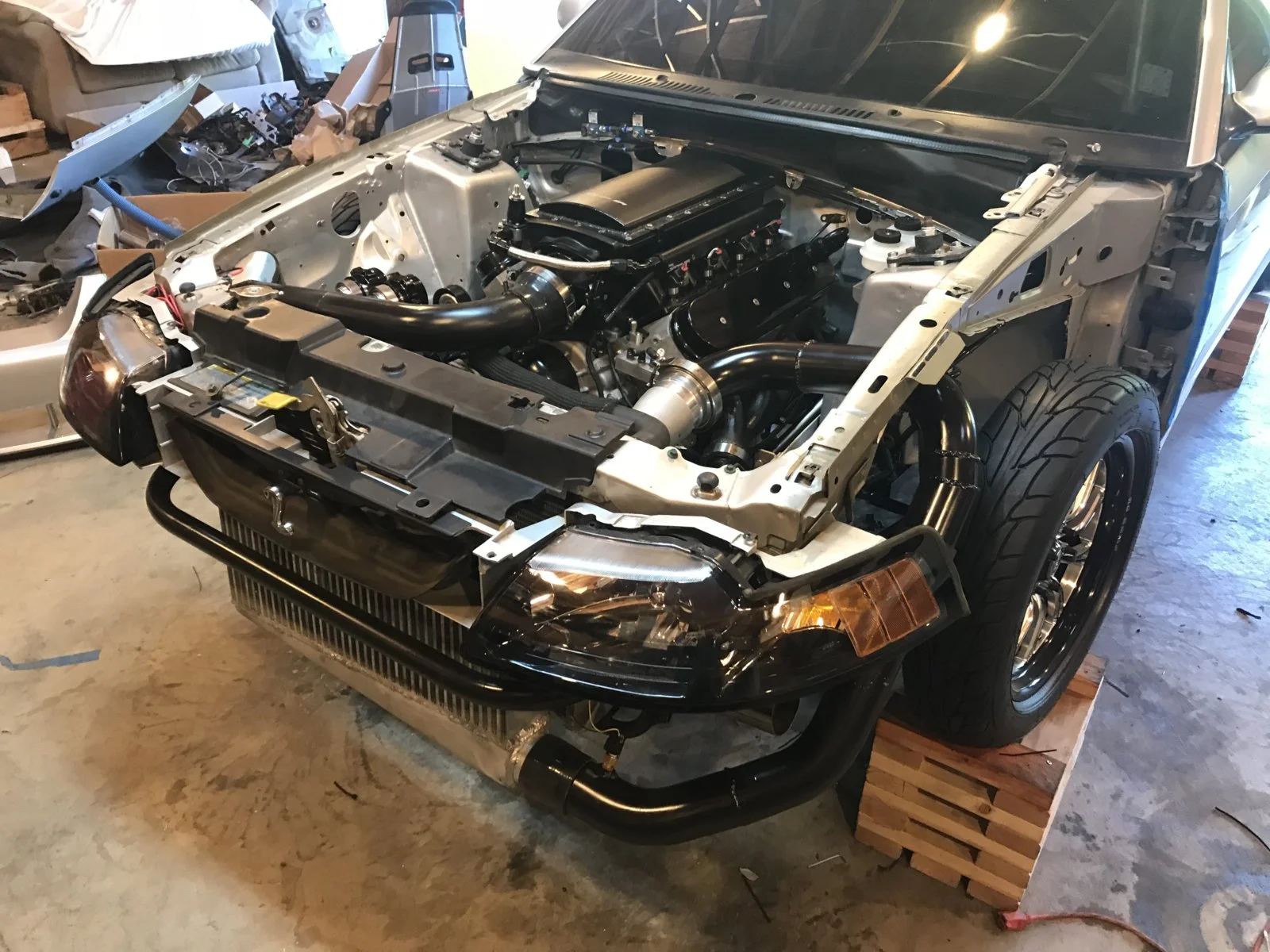

Coldside done other than making mounting tabs for the intercooler
Reactions: 95BlueStallion, RaggedGT, 90sickfox and 1 other person

Intercooler mounted, bungs welded in for a couple IAT sensors and a boost reference. Got the coldside painted up and fitted. Also got the boost controller plumbed. Thinking i can retire the welder for the rest of this deal.
Reactions: RangerJoe, RaggedGT and Davedacarpainter

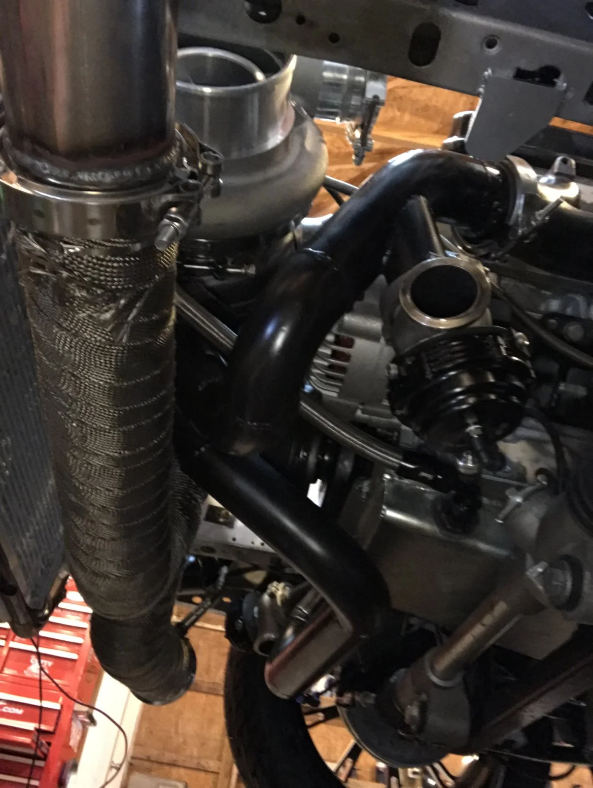

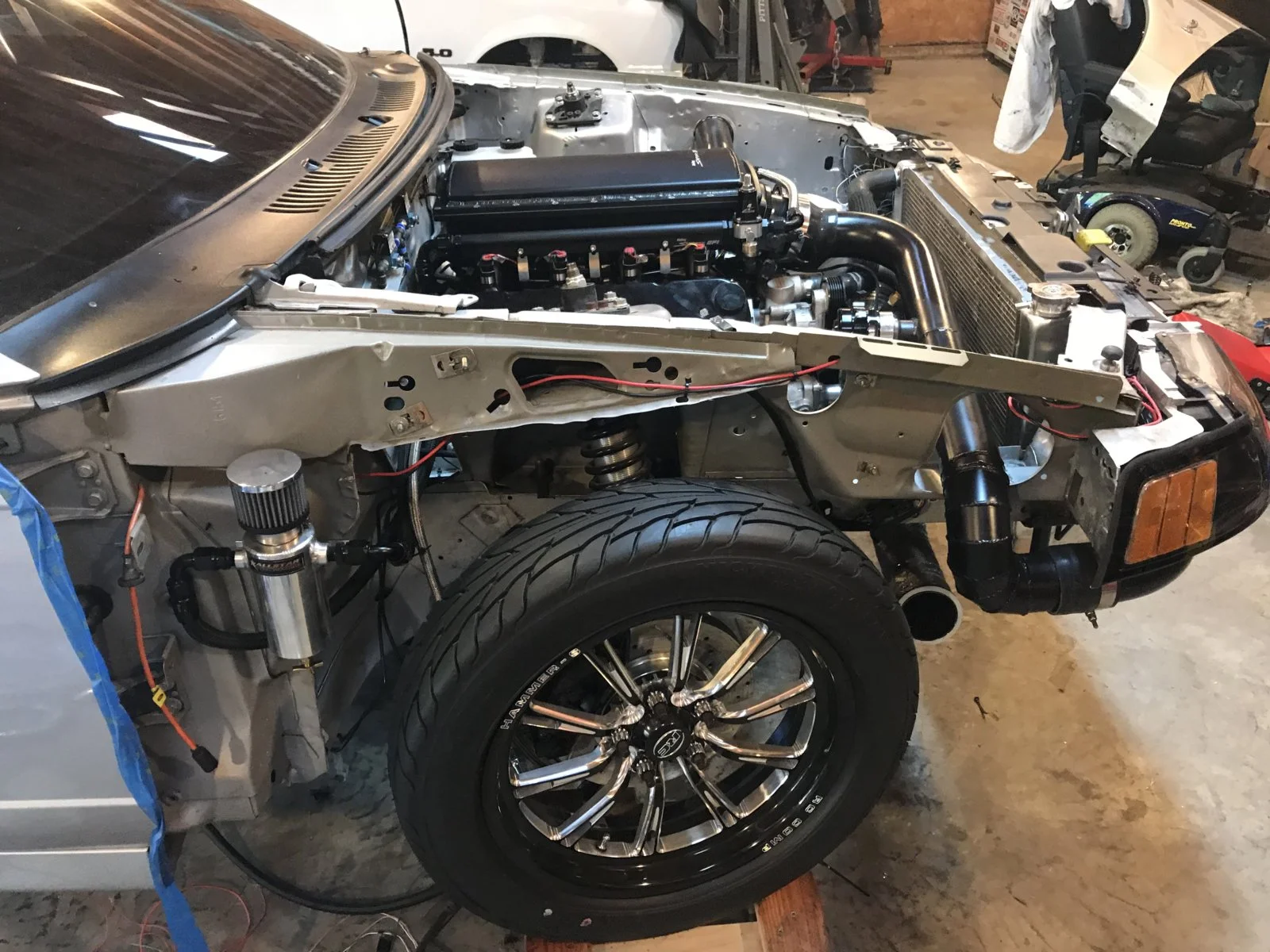

Plumbed the BOVs (which worked out in a way that pleases whatever mental disorder I have). Ran the front brake lines and the return fuel line, FPR reference line, and a few other odds and ends.
Pretty good work for a weekend
