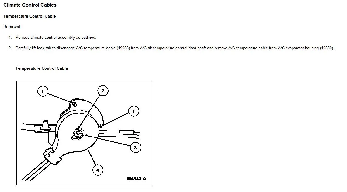

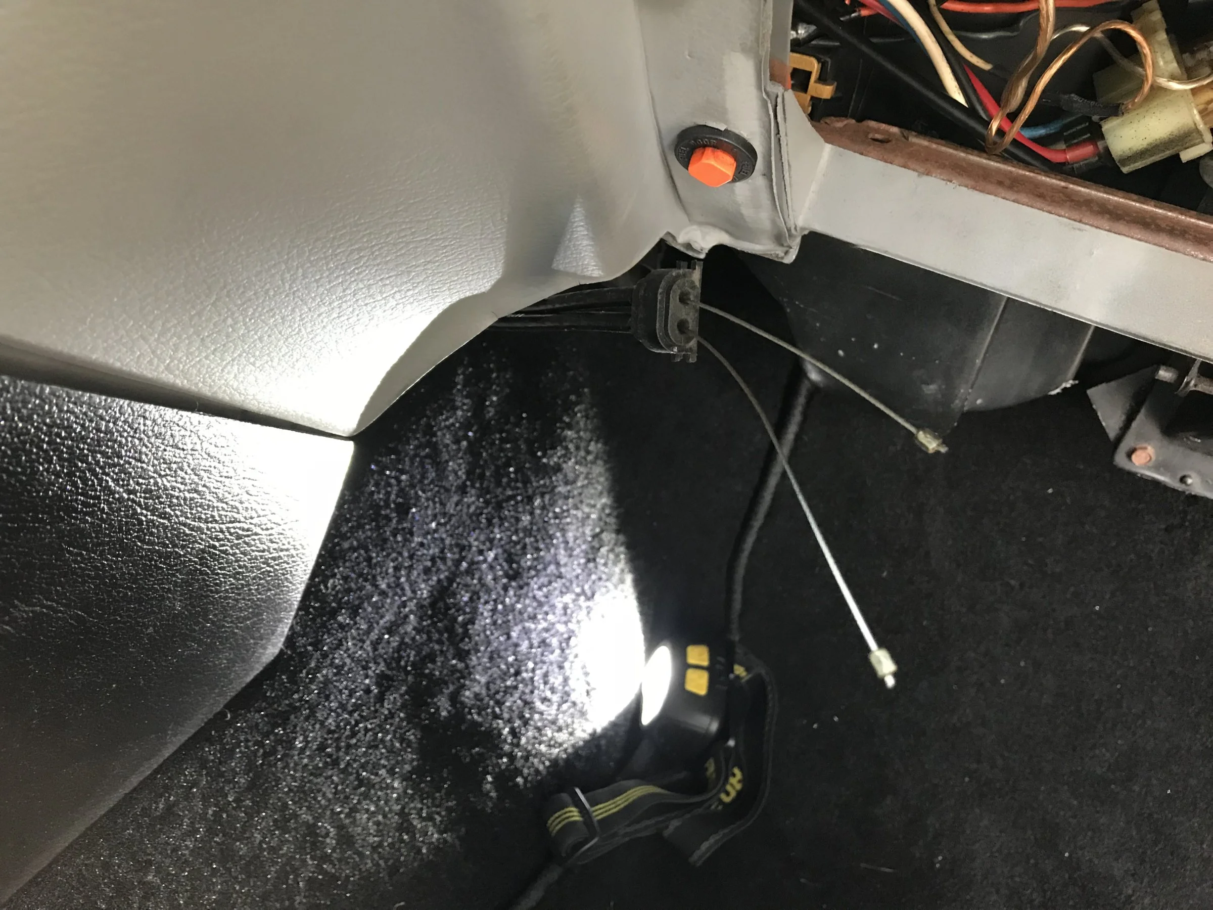

@karthief , this is what the temperature control cable looks like. It should be connected to the heater box
I appreciate the help, kartheif. I could be wrong, but I'm pretty certain that cable adjusts the temperature on a sn95. Being broke off like that makes it FUBARed, though. I just want to manually turn the temperature to heat. It's hard to clear a windshield on ac
Thanks
Jim
The alldata shows the doors on the 98 dash hvac are vacuum operated so I don't know how thats going towork with a cable, it did't show anything cable operated, I have found that I am not that proficient with this alldata stuff. I did print up a couple pics and I'll post them in a few. I'm still in research mode.
@karthief, yes that’s a great illustration. To add to my misery, the actuator for the temp blend door looks like a Fox-style operator, that is, it slides back and forth and does not rotate. This car is really blended (pun intended). Thanks for the illustration. From what I can see, it looks like there are parts of a sn95 heater box put on a Fox box somehow. It is really difficult to see back in that area, as there are ears of wiring not bundled in my way

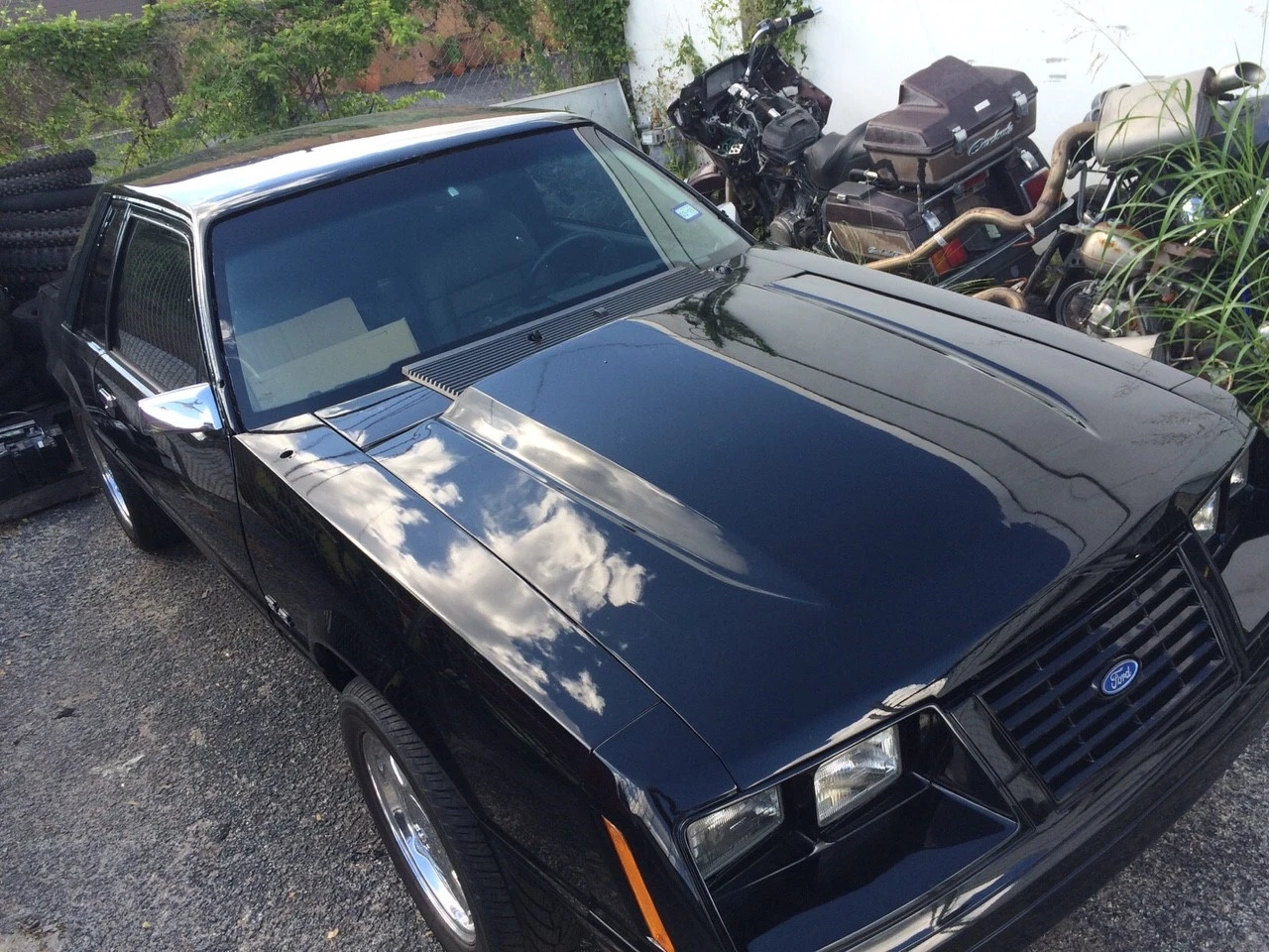

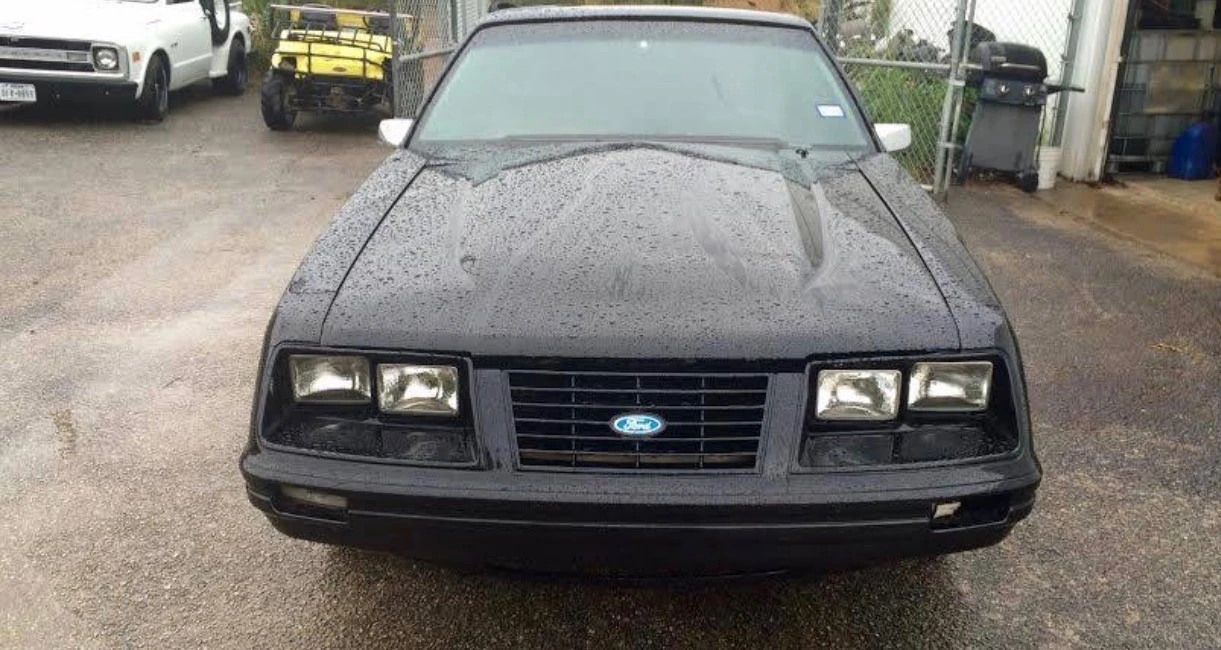

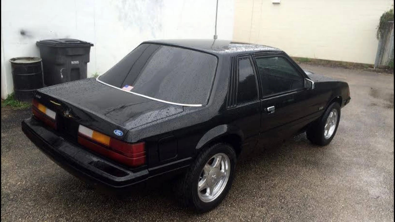

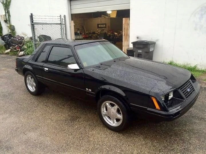

These are photos of my son's recent purchase. We'll do a ModFox using my old 96 GT as the donor car. This was a SSP coupe out of Austin, TX. Not much SSP stuff on it now. The PO was going to make it into a pro-street, I think. He boofered it up pretty good, so we have some work to do. Paint is pretty nice, though and I get the interior and wiring for my 84 coupe.
He wants to put an 85 front bumper on it, so I get the nice front bumper for my 84. If anyone would like a nice 84 1/2 GT front bumper with fog light mount, I have one
