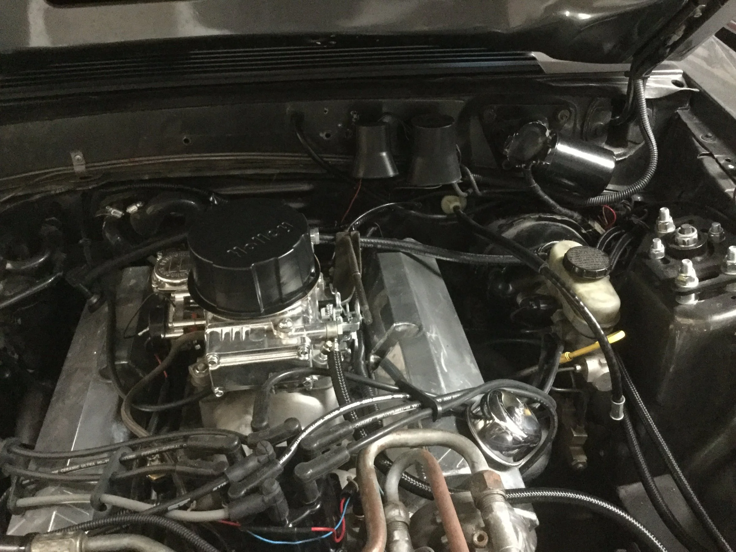

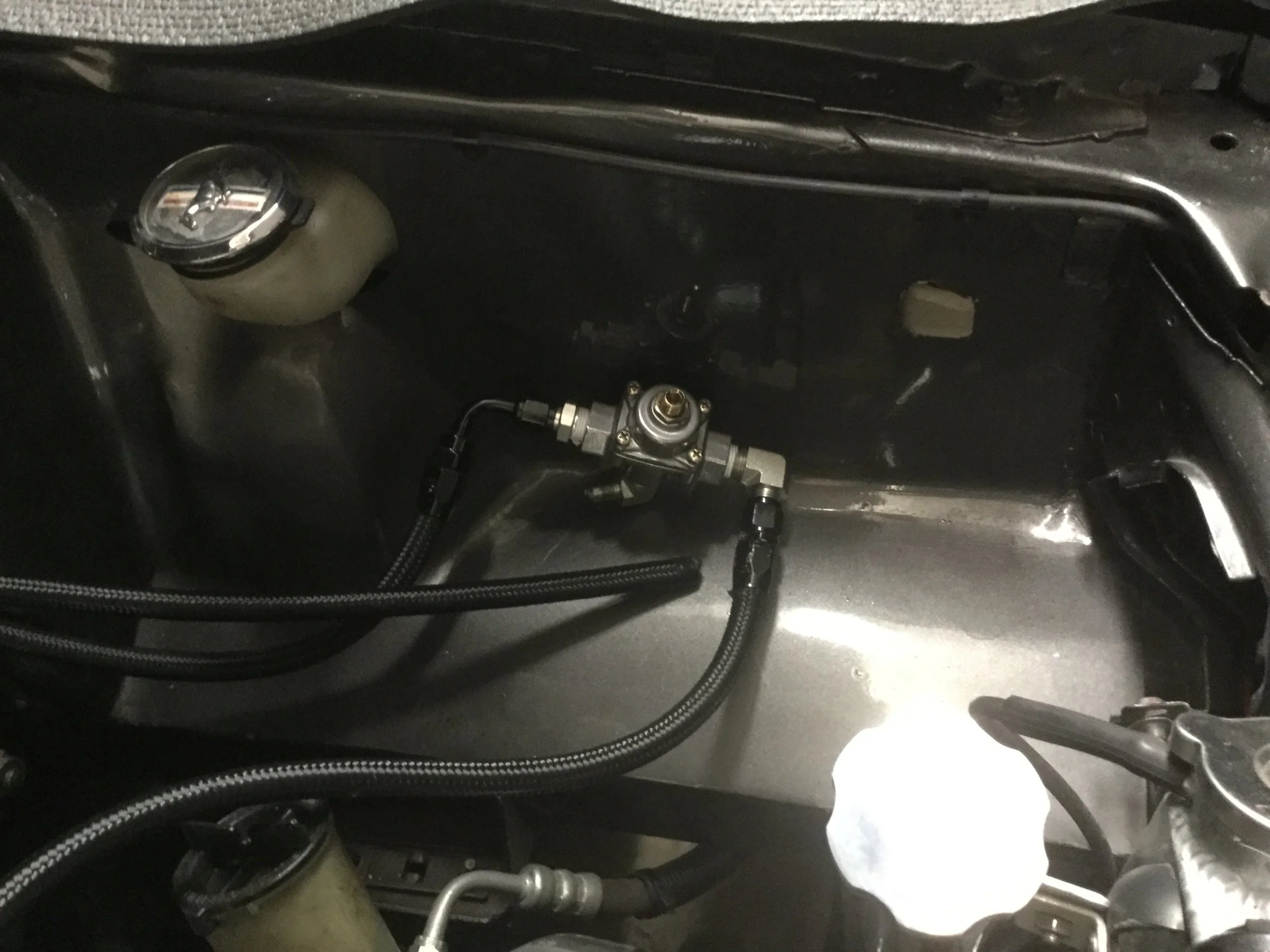

@Gear grabber , I moved the fpr to the left fender skirt. I’m surprised it would reach. I need to buy a -6 AN fitting for the return line, but other than that (and a mounting bracket) it’s pretty much there.
Hopefully, this will keep it cool. Lousy bracket that Holley provides is mostly so they can say they give you a bracket.
So, I mounted the second alarm horn where I had the fpr mounted. Whoever did it before me just had cable ties holding the horns and fpr together at the firewall.

Got the 85 started this afternoon. Turned out the distributor was clocked correctly; I had no spark. I had power to the ignition on RUN, but not on START. I took a wire from the ignition terminal on the solenoid to the positive of the coil and it started right up. I’m not certain what the fuel pressure is. I don’t have a fuel pressure gauge. The Aeromotive regulator had a port for a gauge,bu5 this Holley doesn’t. I think I may see about an in-line adapter to splice into the line to the carb.

If you're using the same non-return Holley reg they supply with their blue pump, you'll just have to get a fitting to go inline that has an 1/8" npt port in it in order to accomodate a gauge. When you first turn on the pump, the gauge pressure will display at actual, then proceed to spike from there. The needle on the gauge will more than likely bounce if you try to check it running.
Your turd carb wants between 5-7 p.s.i,...and you'll wanna check ( and adjust) float level on the turds only adjustable float level in front to be sure it's where it needs to be.

I have the Holley fuel pressure regulator that has a return for the electric in-tank pump. I must have bought the low-end fpr, because it has no port for the gauge, like my Aeromotive had. I guess at some point I'll get a real fpr that isn't so chincy, but right now I just need to get things sorted. At some point I'll convert the secondaries to a center hung float, so I can change out the jetting. Thanks for the heads up on the fuel pressure and float adjustment, Mike.

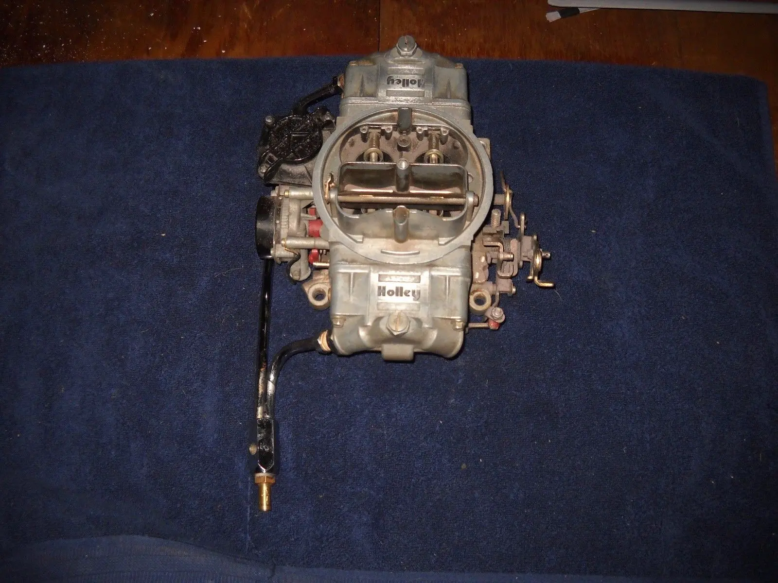

@madmike1157 , I found a Holley 670 Street Avenger that has the center-hung floats and dual feed, single pumper and electric choke. I may have to put a kit in it, but it was cheap, cheap.

Well,...I'm tempted to say good for you.
A used Holley is like a used BMW. Sometimes, you'll be alright, other times the carburetor will be possessed.
There are always reasons why the previous guy sold off his old carb...and it wasn't because he liked how the old one worked/performed.
