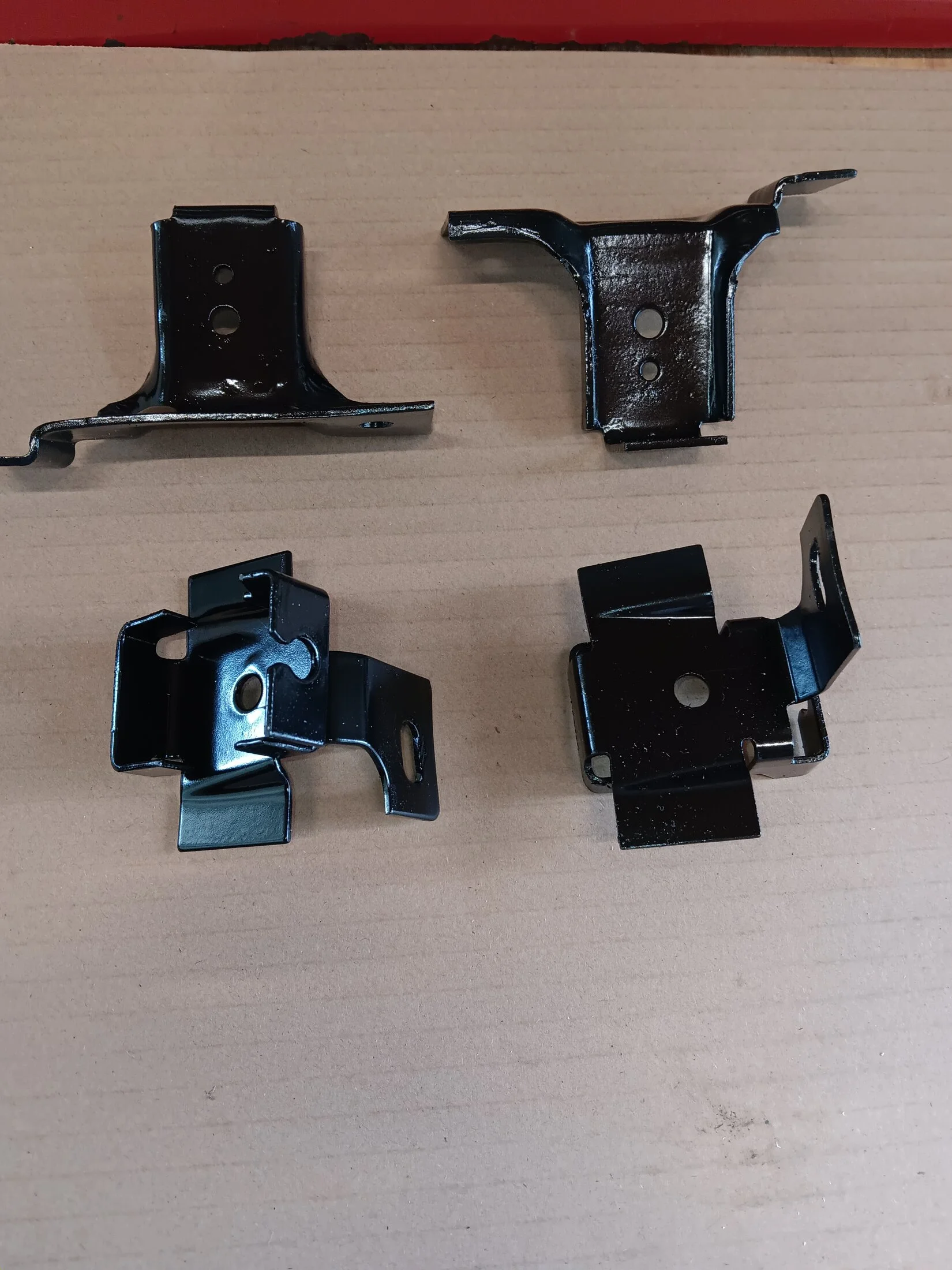

Didn't let them soak long enough! quick wipe down with laqure thinner and primer/paint.
bolt it all up with the AC condenser in place.

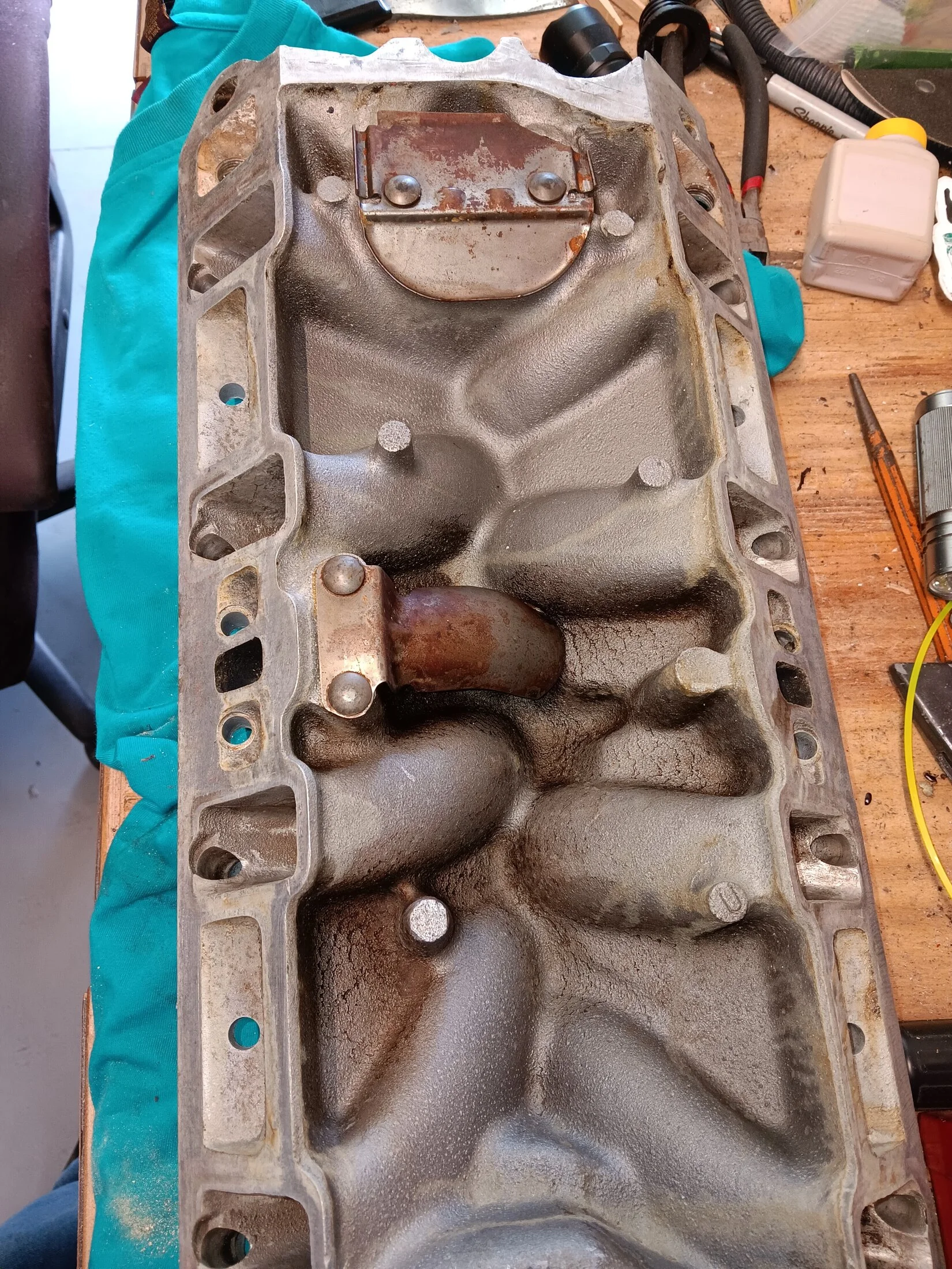

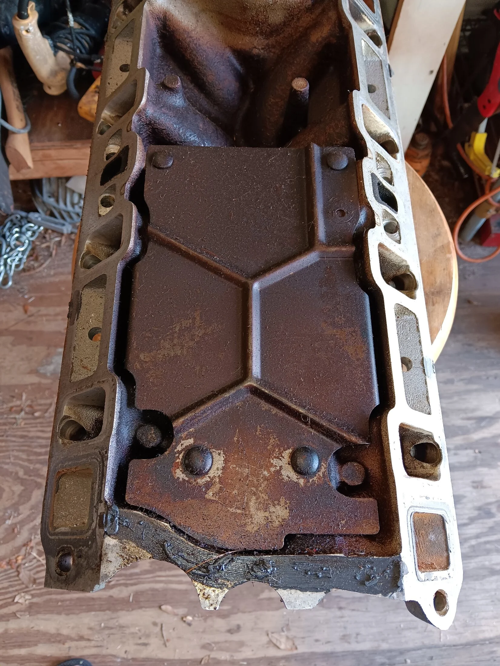

take this weeny PCV shield off and install this:
I had asked about doing this but got no opinions so I'm doing it. I've noticed several upper intakes that I have removed from several engines and they all had two things in common, the weeny shield and black oily residue inside so it's gotta be better right?
RIGHT??
Gonna have a machine shop drill/tap the bosses for screws and glue them in with some blue Loctite. Those rivets that hold them in from the factory are hard and I don't have a tap(or the patience)

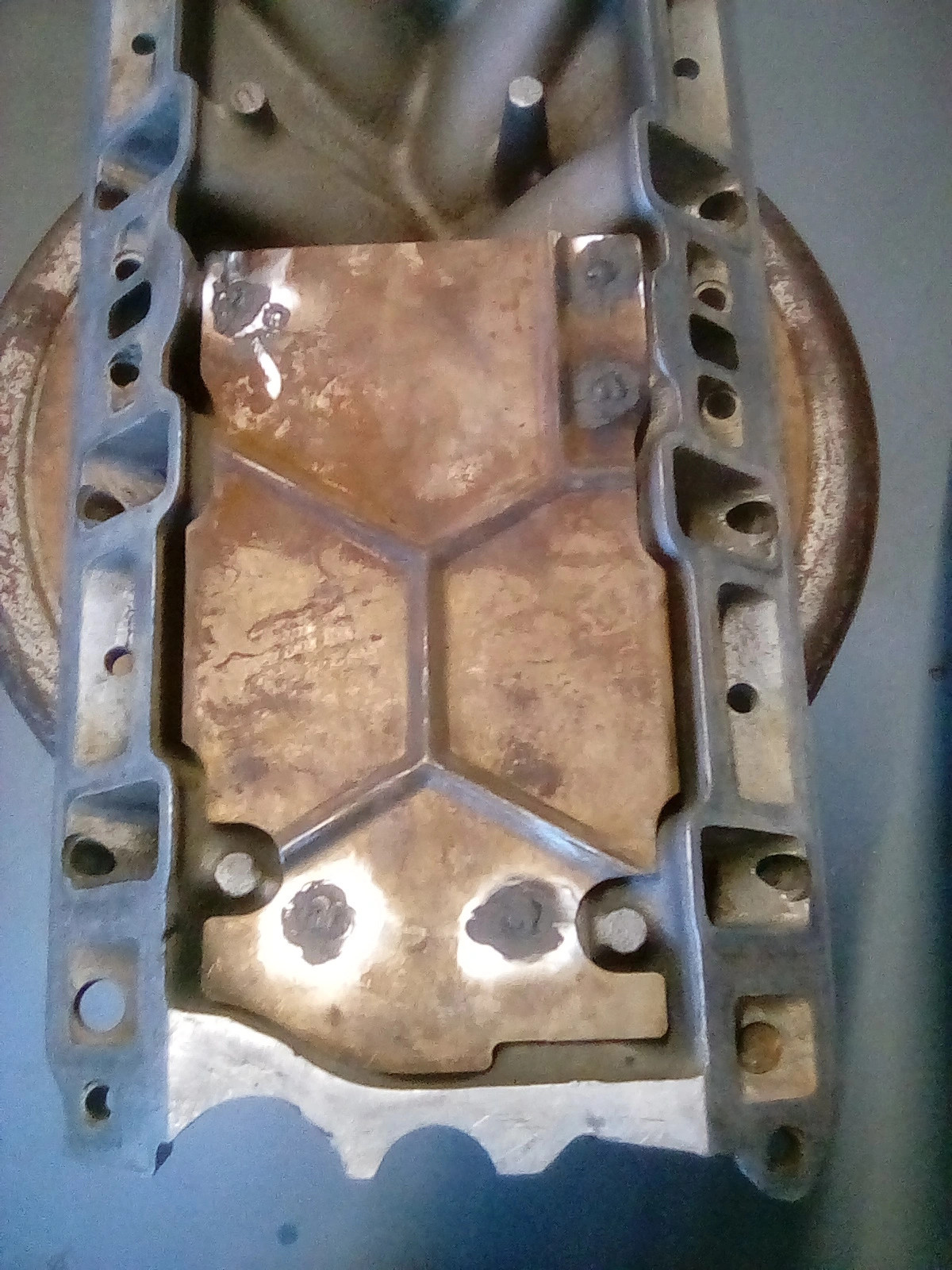

I wasn't gonna show the booger job my machine shop did but I'm committed to show'n y'all the GOOD, the BAD and the UGLY, lots of UGLY !
I love my local machine shops, there are two I deal with. One old school, one more modern, I went to the modern, big shop, told him what I needed done, well he said "how bout just tack weld the baffle to the steel pins?"
20 bucks and 20 minutes later I'm on my way home.
Now I can glue some of this engine back together
You should of made your own shield and covered the whole bottom, it keeps the whole intake cooler.
The bow tie crowd can buy valley shields to use , I haven't seen ones for us blue ovalers.

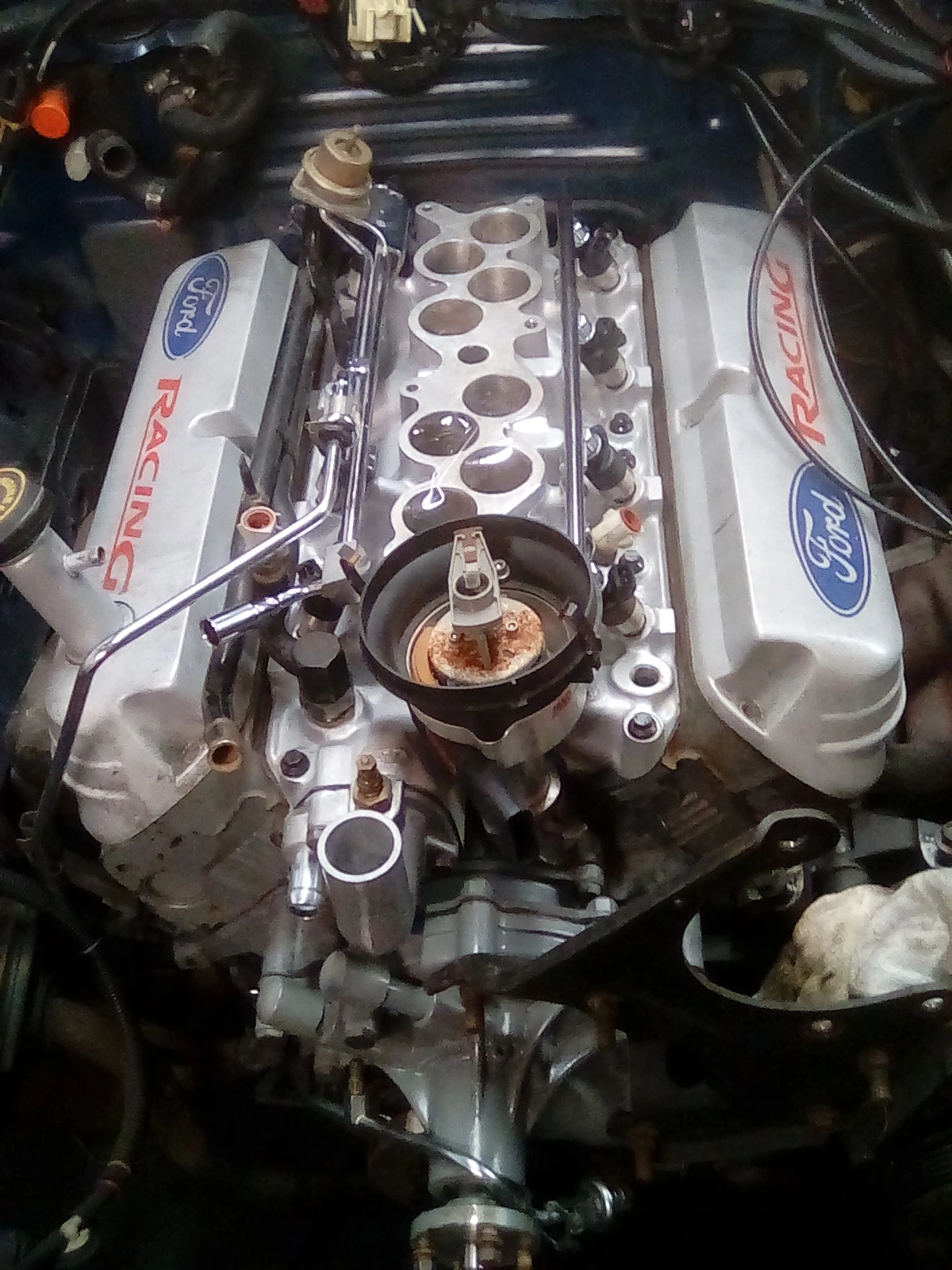

Putting parts and pieces together, fixed some of the tape that was falling off, yeah that was a disappointment, tossed that roll of junk into the neighbors back yard.
Intake, squirters, rail on permanently (I hope), heater hose tube with temp sensor mocked up, distributor set (I hope), PS/AC bracket on with PS pump loosely mounted.
