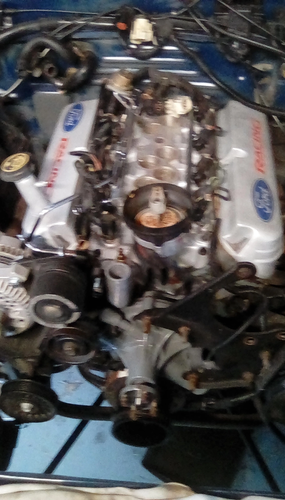

A quick pic of the dog house, stuff buttoned up and I even lowered it a little closer to the ground, getting a few things done, need to decide if I'm going to get a kit for the 3G wiring or build a harness.
Man, that came out crappy, I'll take some better from my fone.

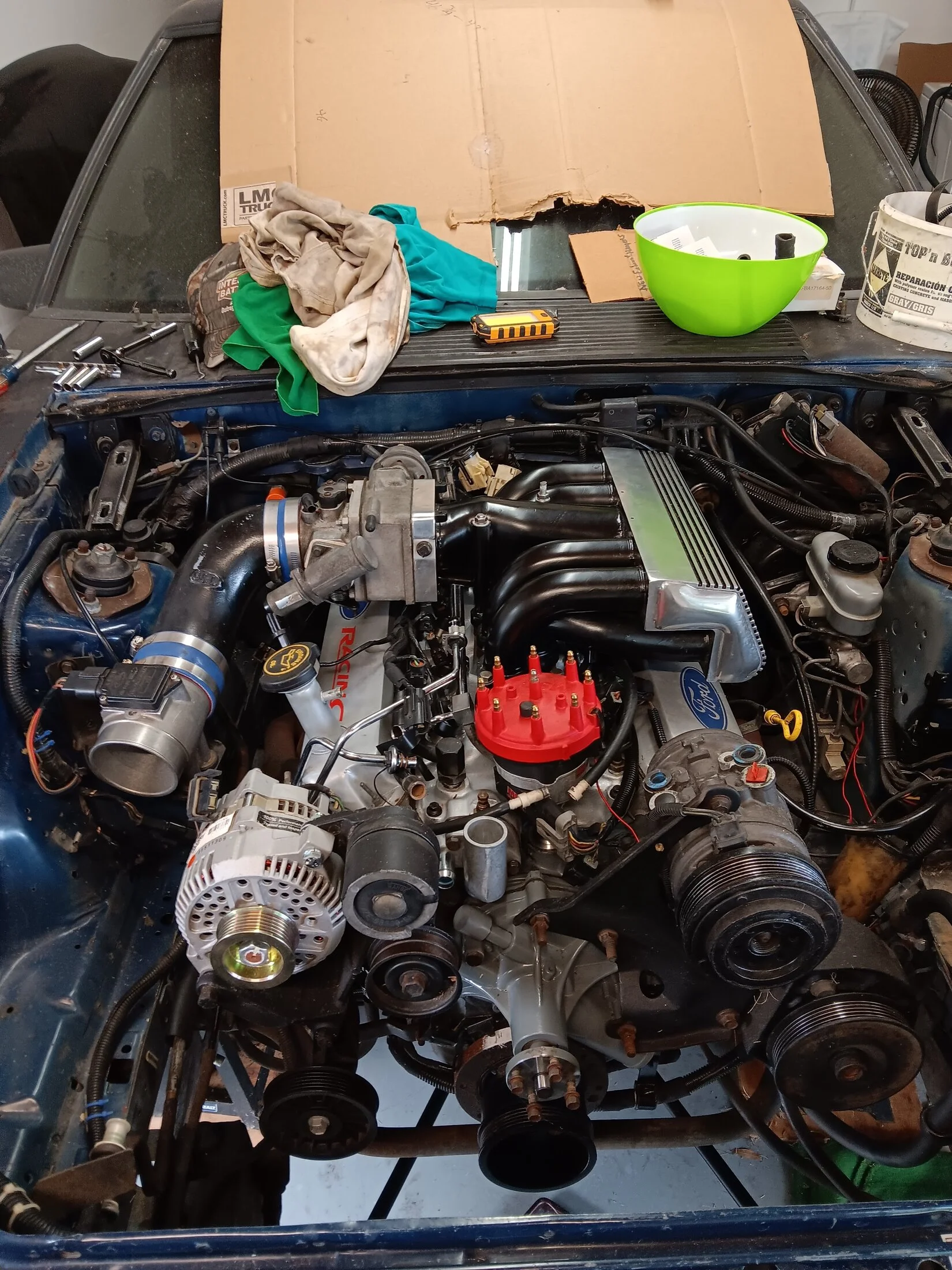

ANYWAY, a couple pics to show the latest.
everything here is mounted on the engine, working on an airbox, not the stocker but something I stole from a member, pics on that later. gotta get the alt wiring sorted, AC lines mocked up and buy a radiator and battery.
