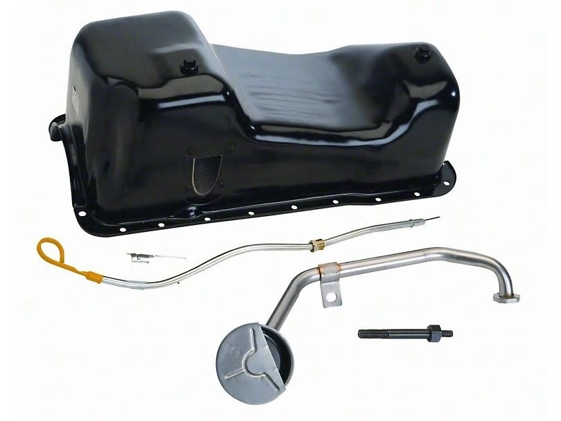

Your friend is probably talking about the difference between the later roller 93+ F4TE blocks and earlier non-roller blocks. Yes, you will have to know which block you have and which lifters to run. If you want to run rollers in the earlier non-roller blocks, most people either run link bar retrofit roller lifters or a small base circle cam with the block tapped for the spider and dog bones to run rollers. I haven't looked at sourcing an OEM F4TE for years but know they used to be a little harder to come by then an earlier block...
The oil pan is a rear sump design. Like most 302/351 oil pans in a mustang, you will have a front and rear "sump" area that will need to be drained, but the pickup is in the rear.
