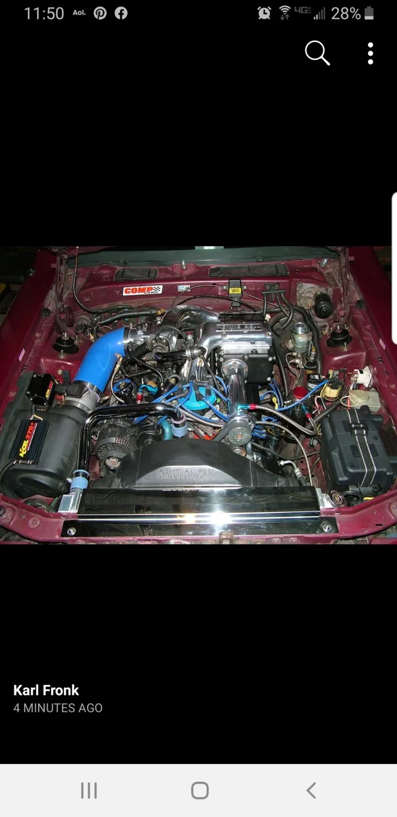

Yeah from what you're saying it's not cut-and-dry it almost sounds like you're saying play it on a tube needs to be the same size on the throttle body hand and the mouth and the meter and. A guy just chimed in on the groups on Facebook told me he bought a March box Ram air box that protects the filter inside the bay and so I'm waiting his reply on how cool to fix the filter. If I like what I hear from him I'll just put the fender in the bay with that box and run probably the spe tube and just use the first portion of the tube coming off the throttle body

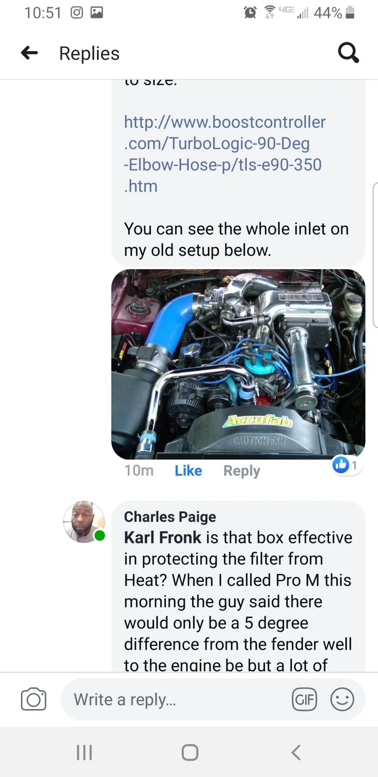

are you sure you're not over thinking this? Without going back through this thread to see what you are trying to do let me say the best air intake system for a mild street build is the stock air box with a k&n filter.
i will call bull on the 5* difference between the engine compartment and the cavity inside the fender when the car is in motion, maybe setting in traffic at a light with extended idle time the temp between the two can get close to the same. It also is dependent on filter container too, if you look at the pic of the air box on the facepage you posted I bet it is thin plastic which offers no heat insulation at all where as the stock air box is a thicker fiber type material. You could also wrap the pipes between the air box- to maf and the maf to tb with something like dynomat to lower the intake temp, in reality you will not notice a difference unless your engine compartment is on fire.

No it's naturally aspirated and the design of that box from what the guy told me it's still pulls air from the fender well. I would say it's pretty thick because he looks like he has an ignition box mounted to the top of it. One thing I have to consider is if I used the silicone hose for the tubing like he did I'd have to see how I would Mount the ACT sensor. With a metal tube of course I would drill and tap the hole for it
