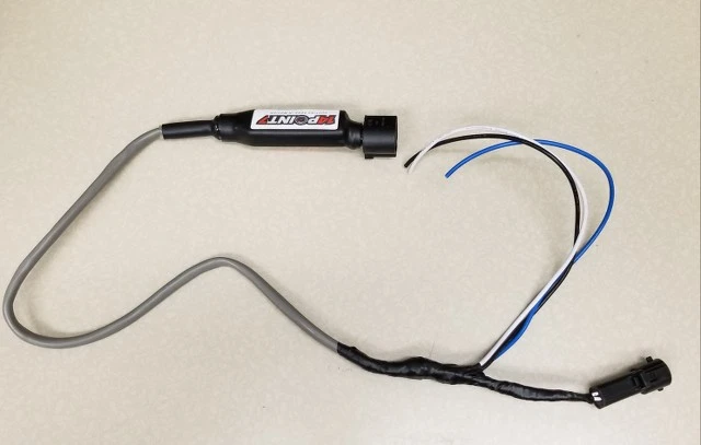

Found some time today to get my wideband wiring harness done. I wired it into an old 02 pigtail and will plug it into the 02 harness. I also ran a separate wire for the power, ground and signal out of the harness which I will send in to my A/F gauge.

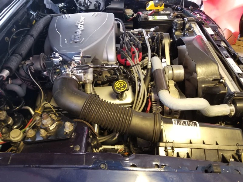

No real issues other than it needs a tune badly and I still need to learn that aspect. My initial feeling is that this is an amazing product. I was just really happy when it fired up and ran. Yes my exhaust is quiet. Shorty headers, catted high flow h pipe and dynomax mufflers. Sounds better in person than on the video.
