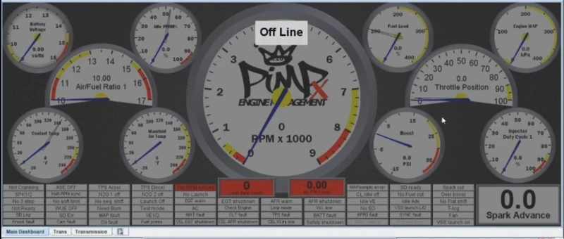

It’s on the thumb drive included with the controller. There are a couple different ones on it, if I remember correctly.Does anyone know where I can get this dashboard? I'm not sure if this is a custom dash that someone made or not. I like the layout.
