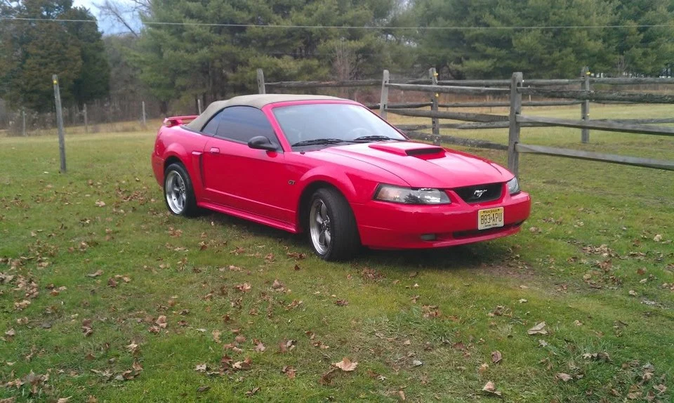

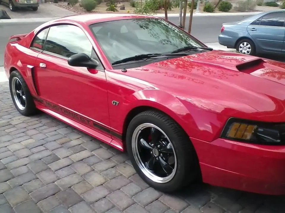

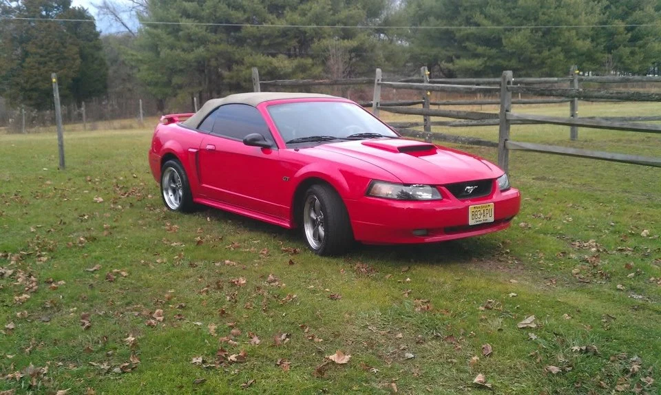

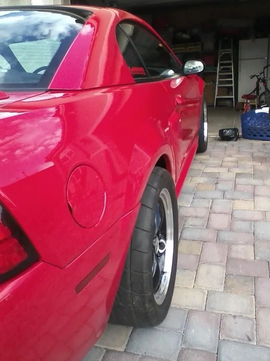

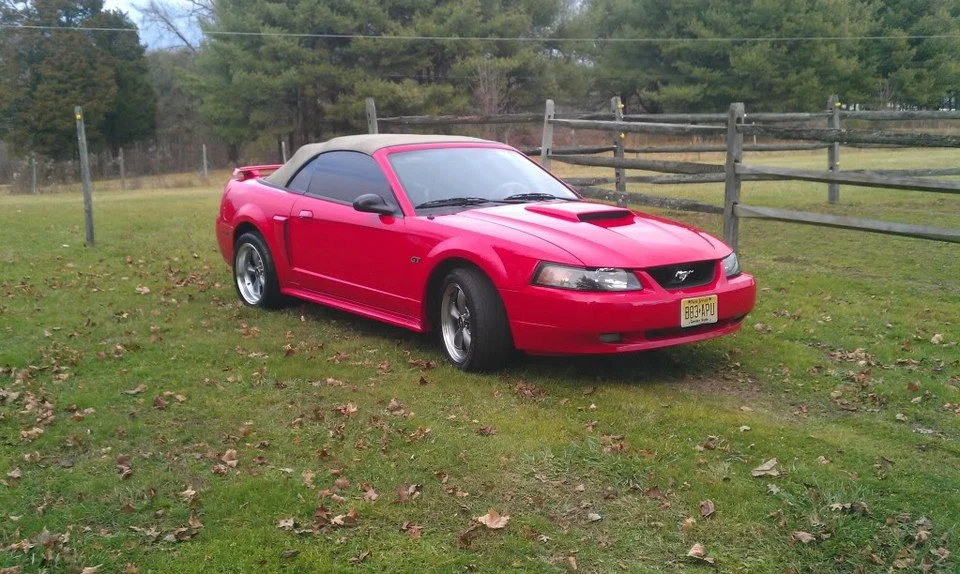

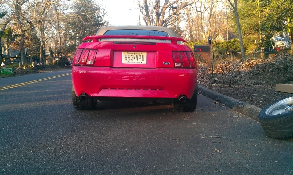

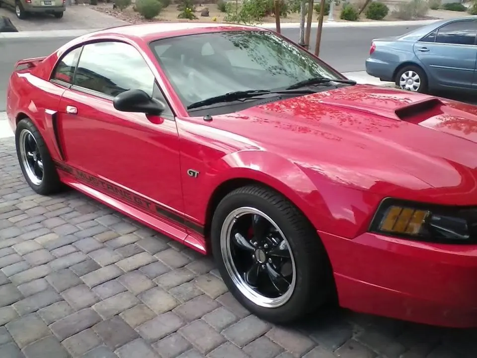

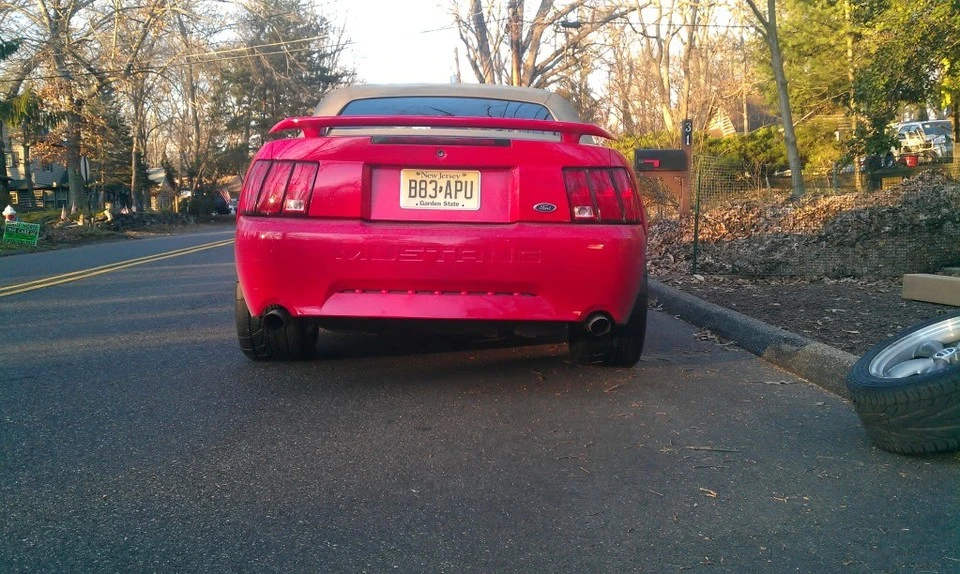

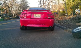

I have the 315 555 Nittos as well no rubbing they look great. The only conplaint I have is the stick out at the bottom of the rear bumper like 2". You just got to keep ur car clean. As far as too much tire, I still break first gear loose with stock gears.....but they do grab like hell when theyre hot.
Hope these work.

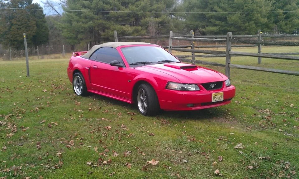

My old 2002 GT with the 'original' bullitt rims - American Racing Torq Thrust IIs. I had Mach 1 springs with a half coil cut up front and 3/4 of a coil cut out back. Such a beauty; I still miss how sweet this car looked when it was clean.

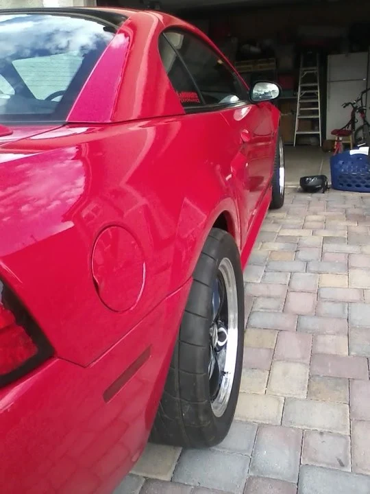

I hope I don't sound like a thread hi-jacker, but I guess I would like to know as well as to how much I would be able to lower my car since I actually purchased it with Bullits on it, 17x9 front, and 17x10.5 rear. I know I would most likely have to roll the quarters.
you'll be fine with h&R super sports or eibach sportlines and they give around a 2" drop.... you wont have to even think about rolling fenders unless your completely tucking tire and running 335's, which i doubt thats gonna happen...i can only fit 1 finger in between my rear tire and fender and have no issues whatsoever and i have 17x10.5's with 315's :nice:
