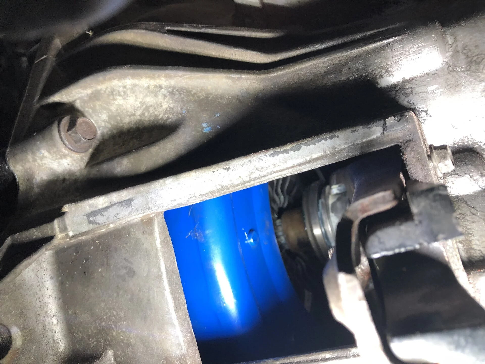

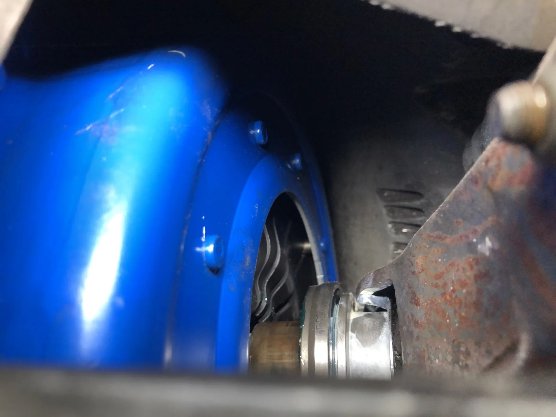

Just finished installing new clutch in TR-3650 (2002 GT), but there seems to be very little clearance (About 1/2 inch) between the clutch fork and the transmission housing (see first pic). Is this normal? Seems to be very little throw. Wondering if I did something wrong during install. Any pictures on an installed clutch fork on car would be helpful as well.

Those clutch cover fingers look awfully compressed to me. They are usually out more toward the cover than what I see. I'm not saying you didn't, but is the clutch disc in the right way? Or, the wrong parts? Did you check disc/cover depth to fork ball?

The clutch disc was in backwards. Since it was aftermarket, the engine side wasn’t labeled like the factory one. Upon removing and comparing to the other original, it became obvious.
