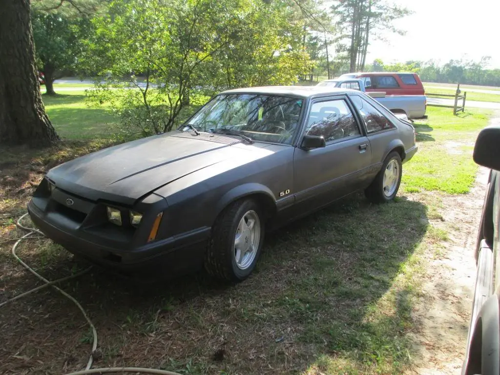

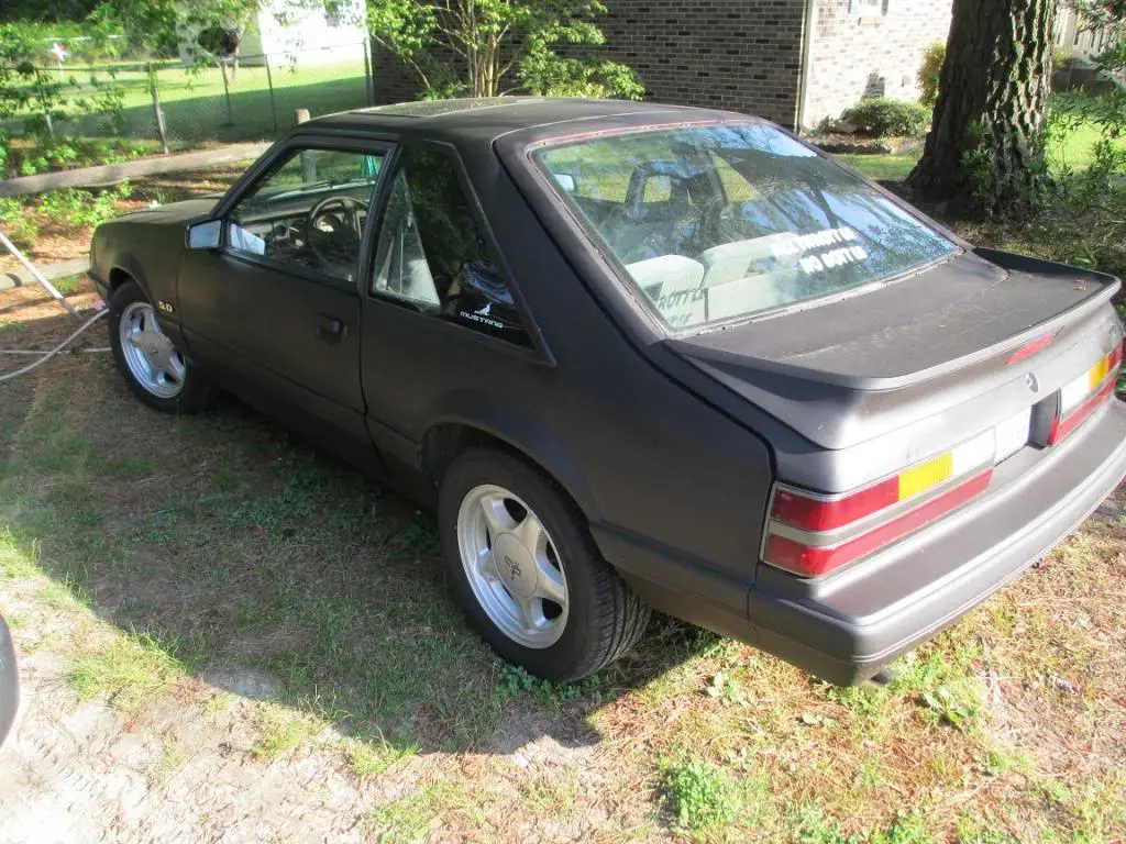

I bought this car in March of 2010, on my wife's birthday of all days. I intended to get it running and driving within a few months, and play around with it. It snowballed a little, got put on the back burner a few times, and now is finally getting close to completion.
I never started a build thread for the car on this site, but I have posted pics of it a few times through its stages. So I decided to start this thread to document the progress (and lack of progress) over the last 6 years.

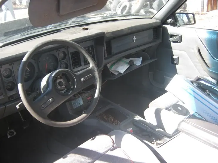

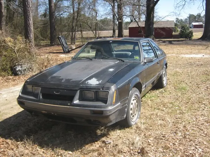

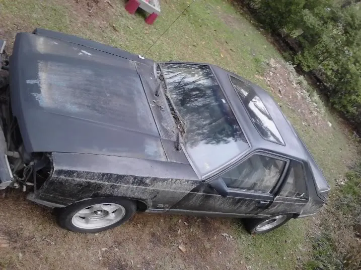

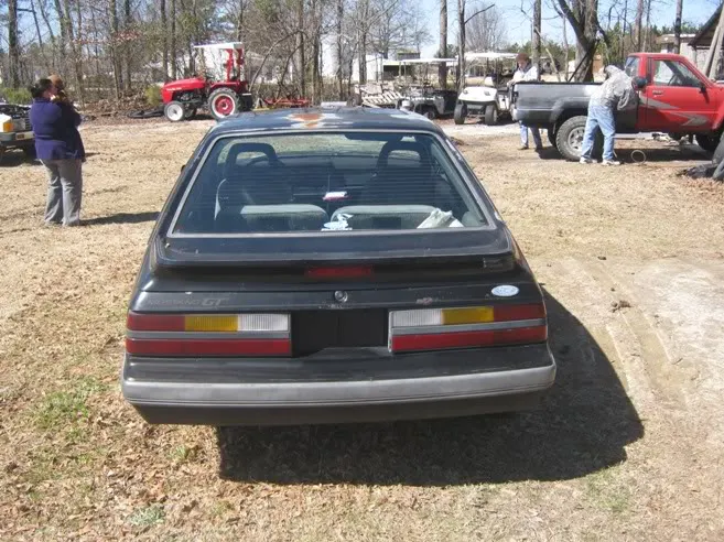

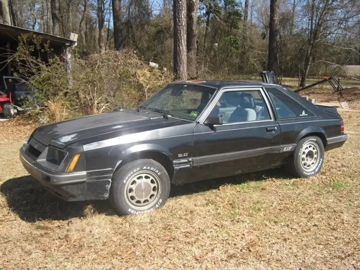

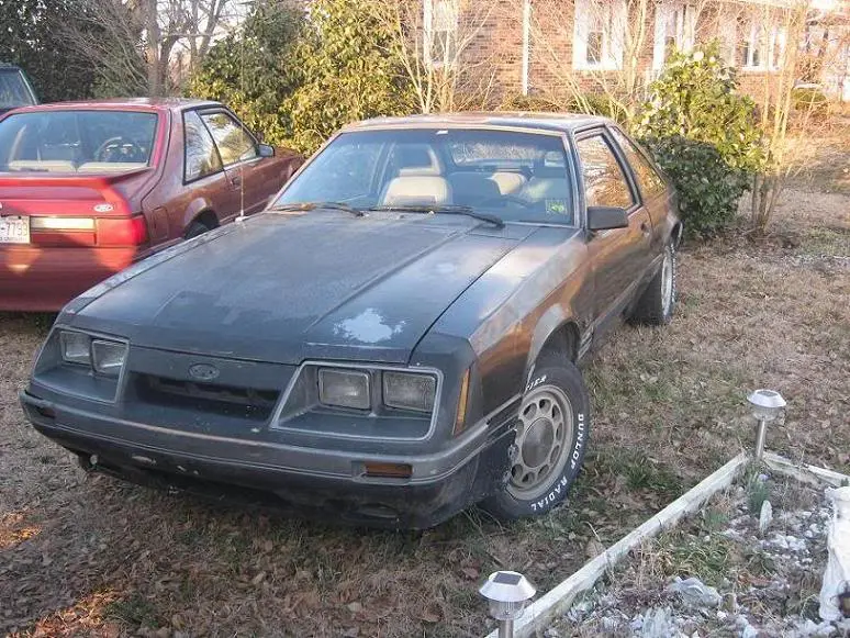

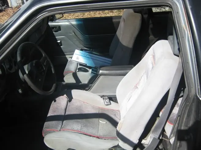

I bought the car from a friend for $400. The engine was intact but had a rod knock, and the trans was missing. Car was a factory black 86 GT with gray interior and 5speed. High mileage and in kinda rough shape, But with no rust underneath and very sold floors and chassis.
This is a pic of the car the day I went to look at it.

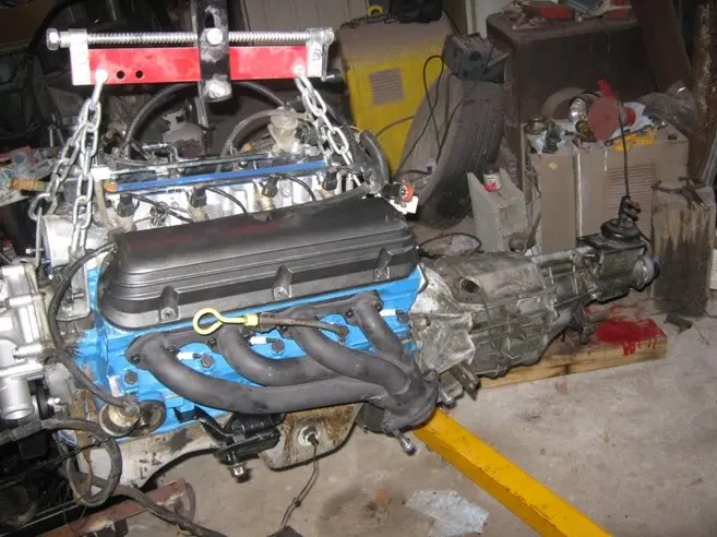

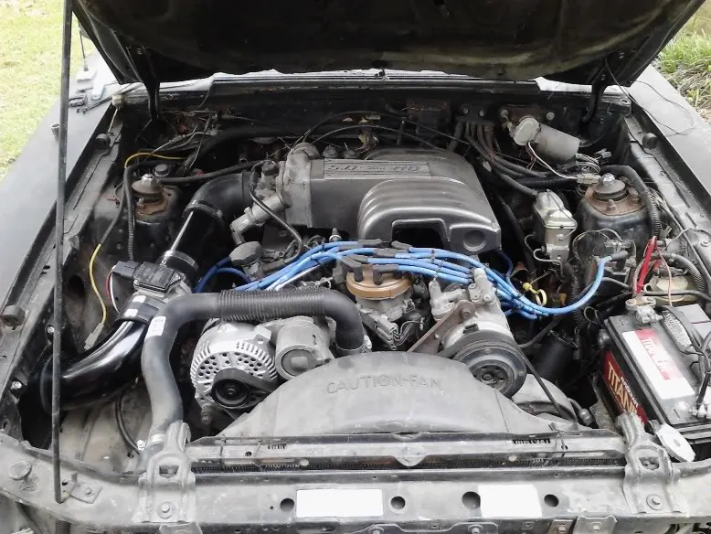

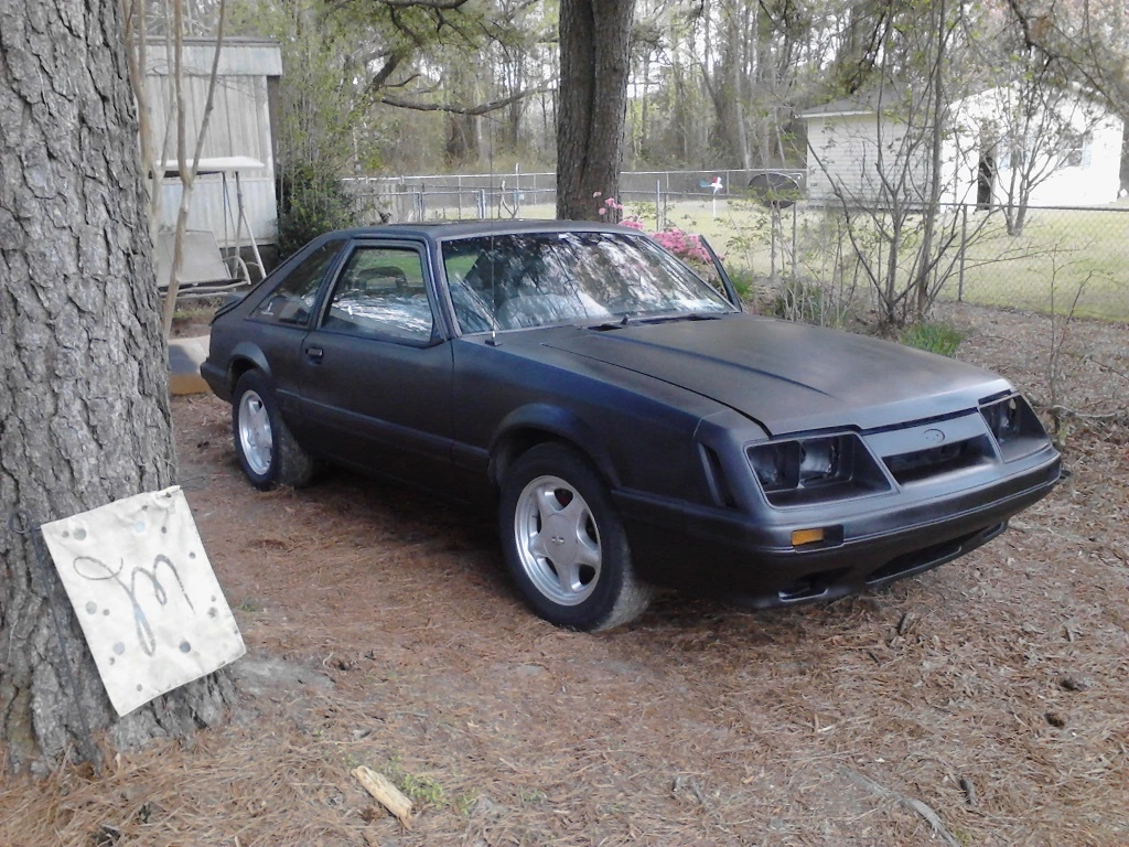

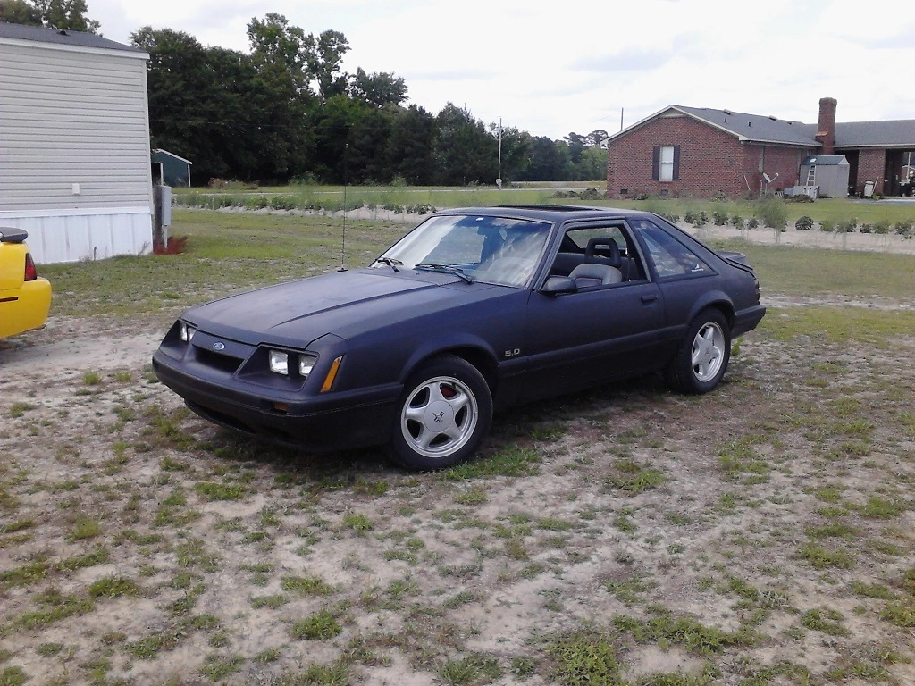

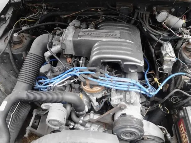

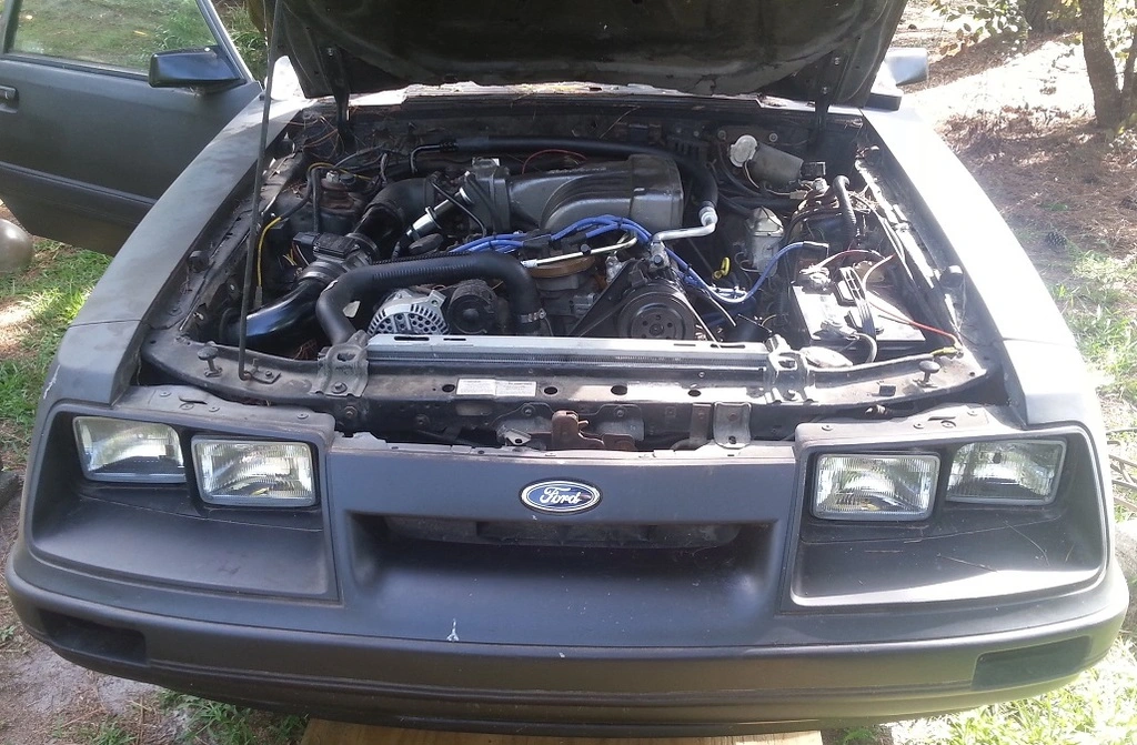

Then I dropped in an 87 GT engine that I had put new rings and bearings in, and a T5 that I had to get it moving under its own power,
Just a stock engine with mildly ported e7's and flowtech shorty headers.
After that it I changed jobs and it kinda got pushed to the side. Over the next 2 years I worked on it a little at a time and installed 87-93 front brakes with Hawk HPS pads, a new master cylinder, and new shoes and wheel cylinders out back. I also put on a Flowmaster cat-back and a set of Pony wheels I picked up.

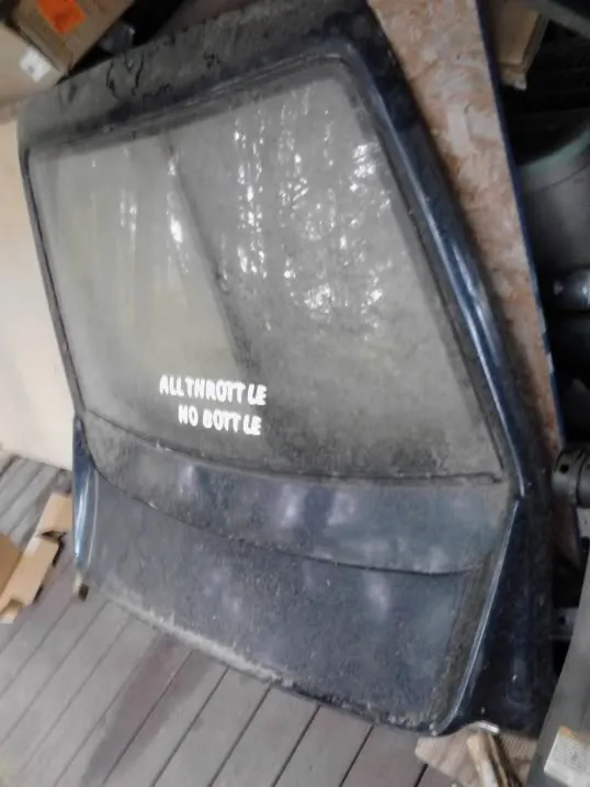

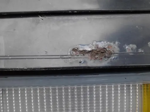

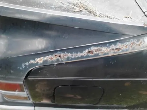

The hatch turned out to be shot. Full of rust and rusted through in a couple of places.
But the guy I got the car from, gave me an extra one with the car.

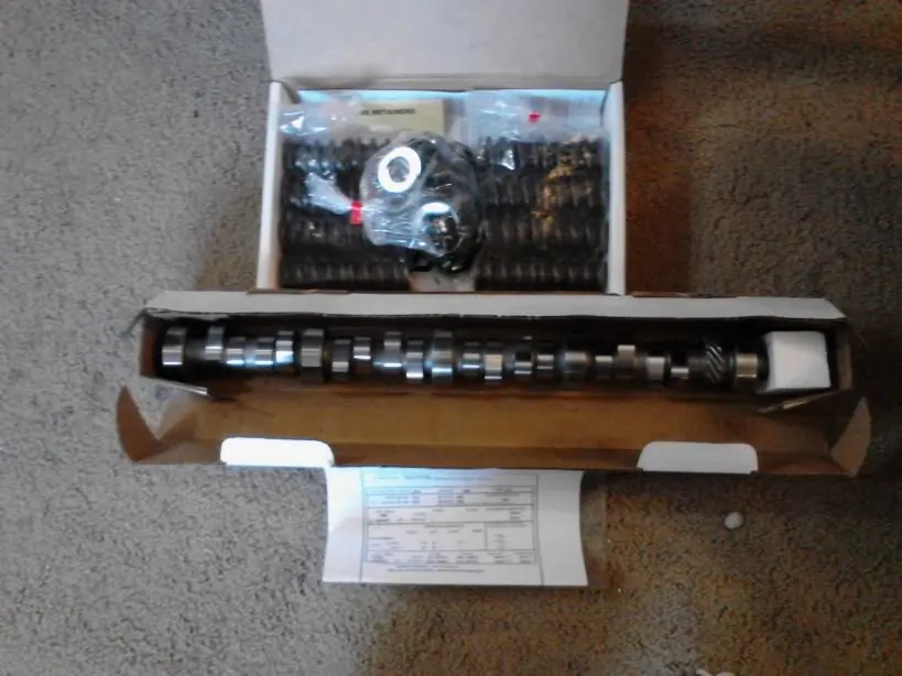

A TFS stage 1 camshaft and springs

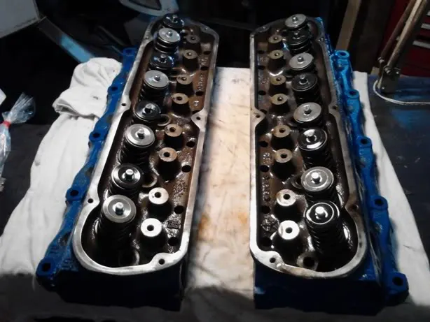

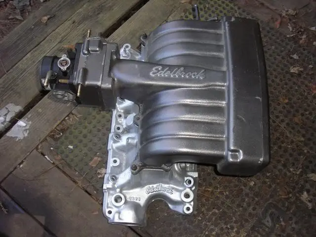

Picked up a complete 96 explorer 5.0 for $150. Cleaned up and sold the explorer intake for $150, and modified the TB linkage to use the 65MM TB on my car. Also cleaned up and did a bowl blend on the GT-40 heads to use on my car.

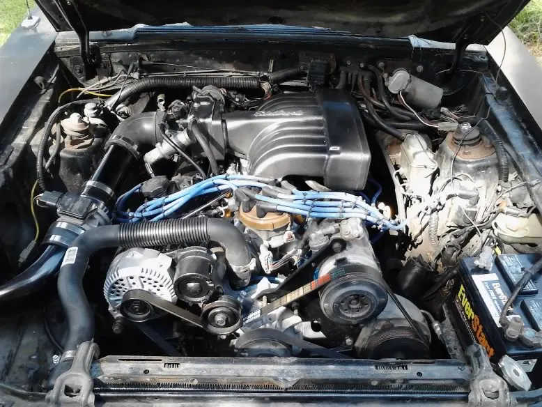

Picked up an A9L and fiveology racing Mass Air conversion Harness along the way, along with a stock MAF. Also got the stuff to do a 3G alternator upgrade, and an electric taurus fan.

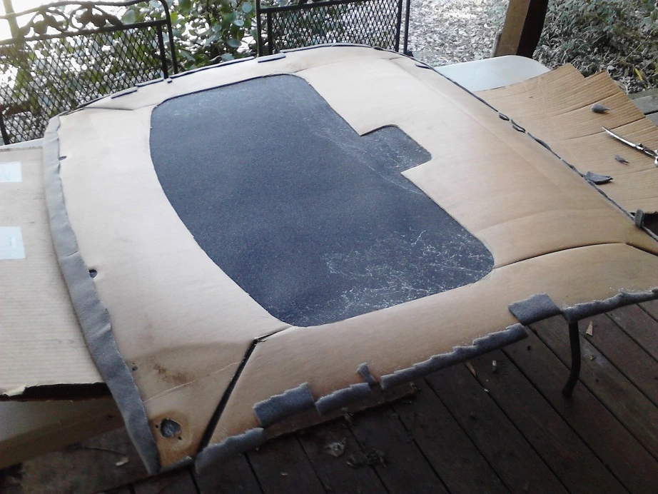

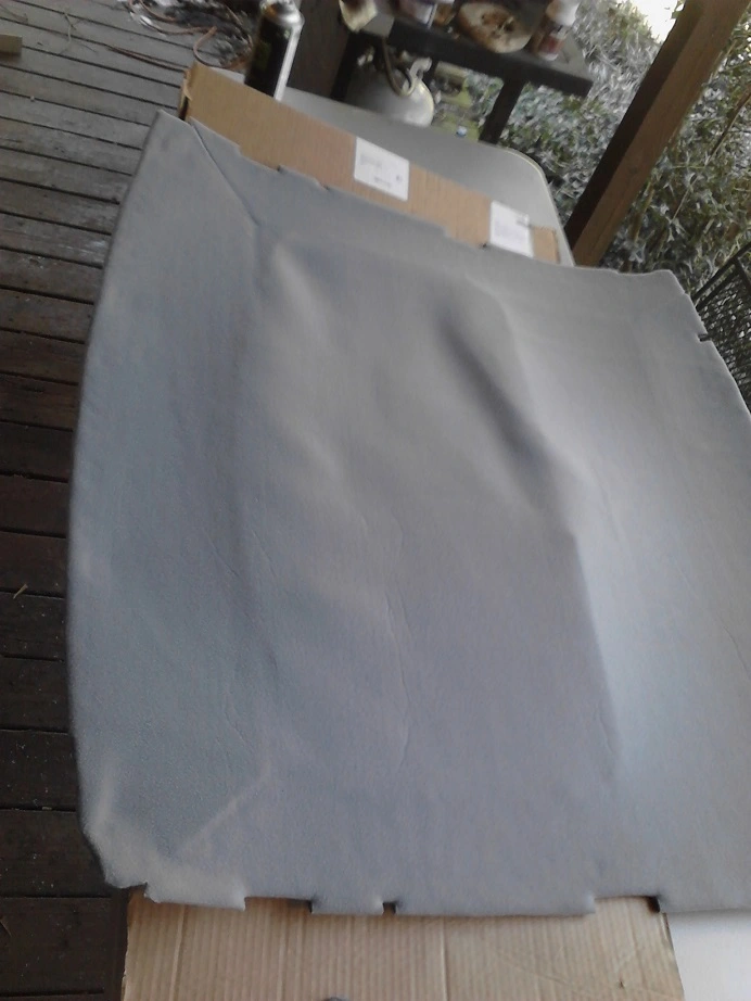

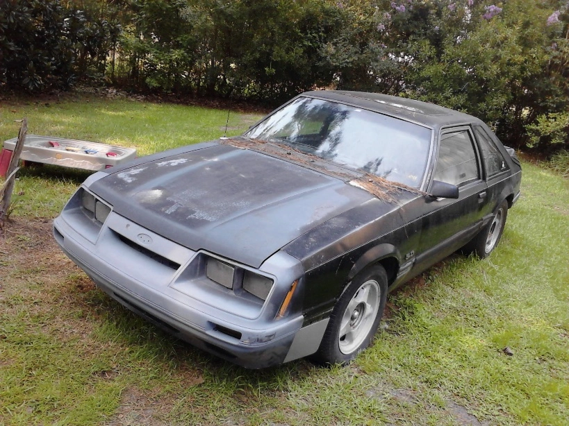

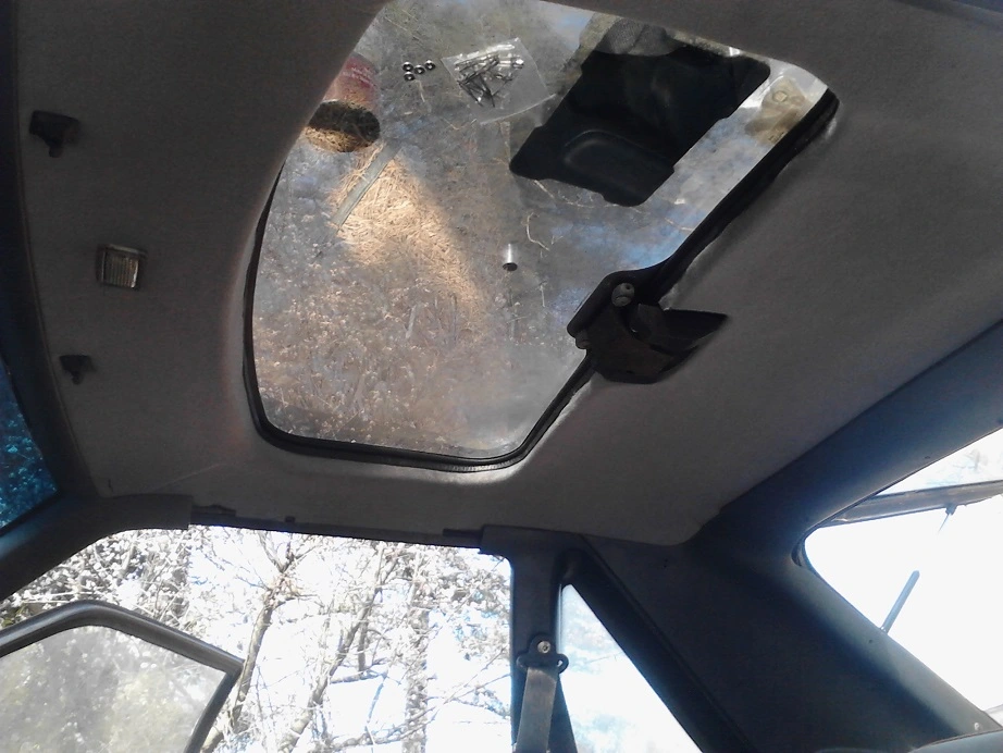

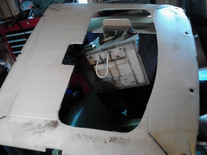

I also decided to try something. The headliner was missing when I bought the car and I couldn't justify spending $200 on one. So I went to the junk yard and picked up a headliner board from a hatch for cheap, and cut out the hole for the sunroof. Then I got some headliner material from the local fabric store and covered it. turned out pretty good

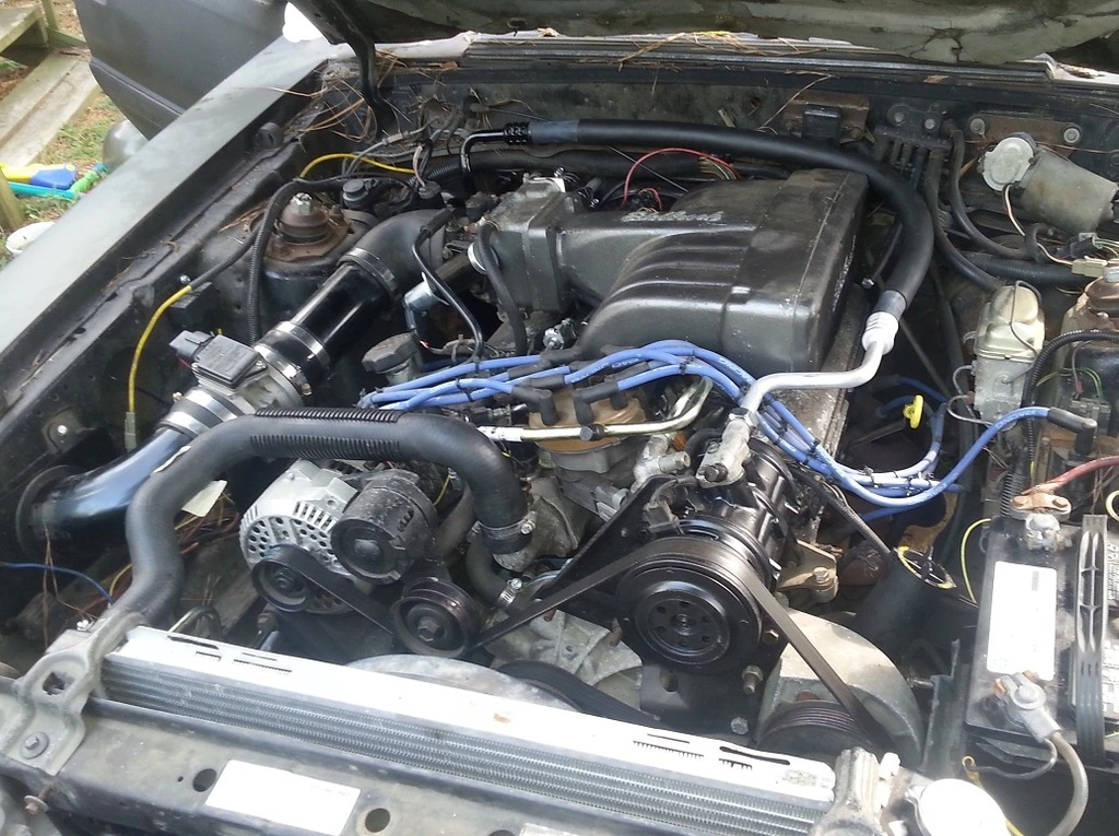

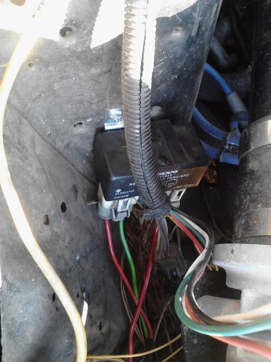

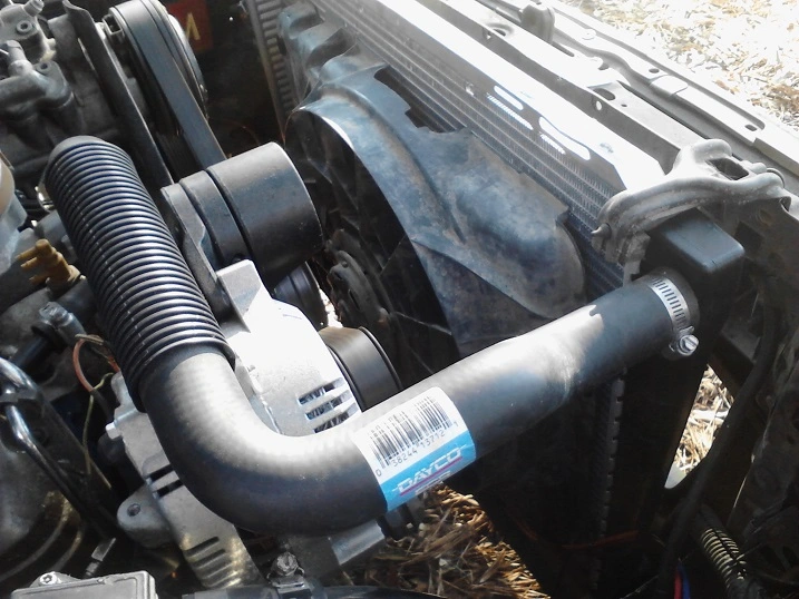

I mounted the Taurus fan to the radiator and wired it to a Volvo controller. The controller is pretty cool as it has two inputs that when grounded turn on their respective circuit. I've got one circuit hooked to the low speed and the other to the high speed on the Taurus fan. I got a Derale temp switch from summit that turns the low speed on at 190* and I wired the other so that it grounds when the A/C is turned on.
Here's a shot of the fan, I should have cleaned it before I installed it, oh well.
Volvo controller mounted on the shock tower, Disregard the "performance pine straw"

-A/C Kit (compressor, condenser, evaporator, and hoses)

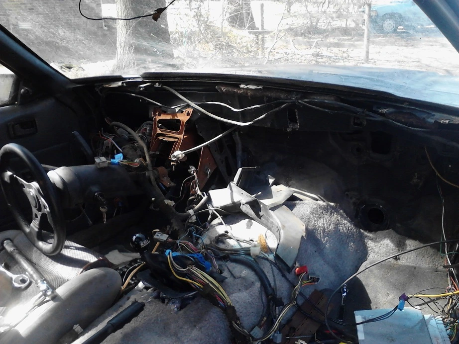

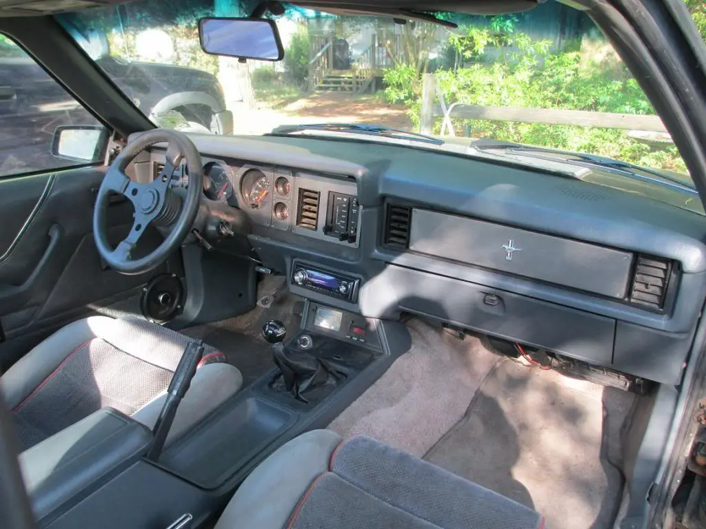

Then I pulled the dash for the heater core/ evap core install

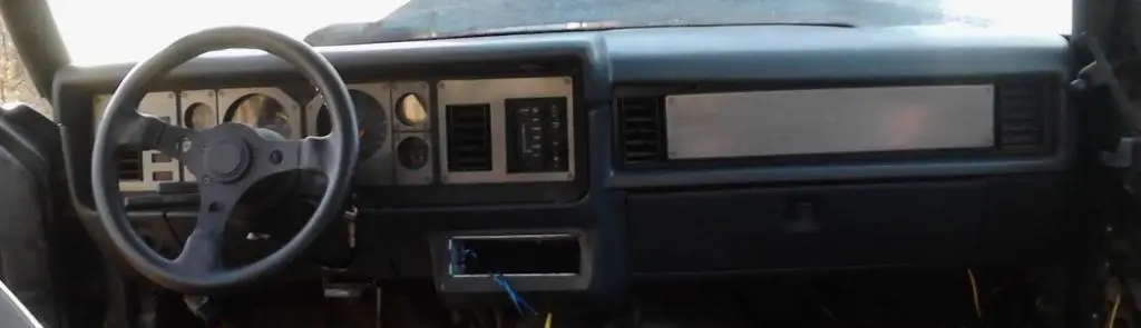

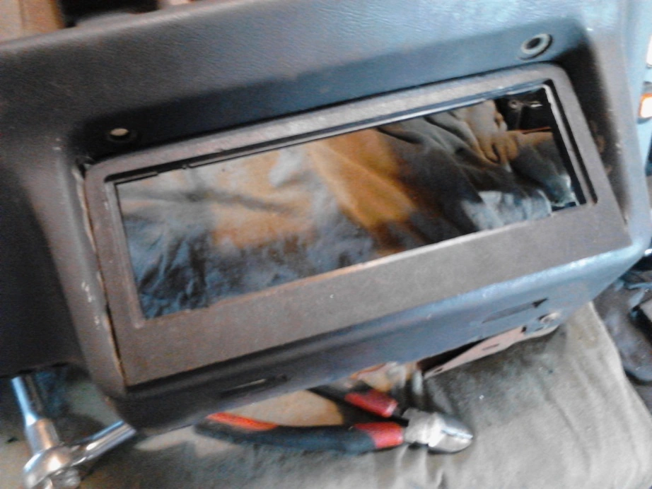

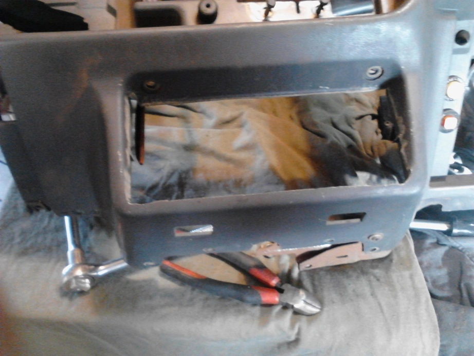

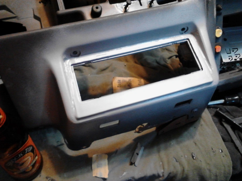

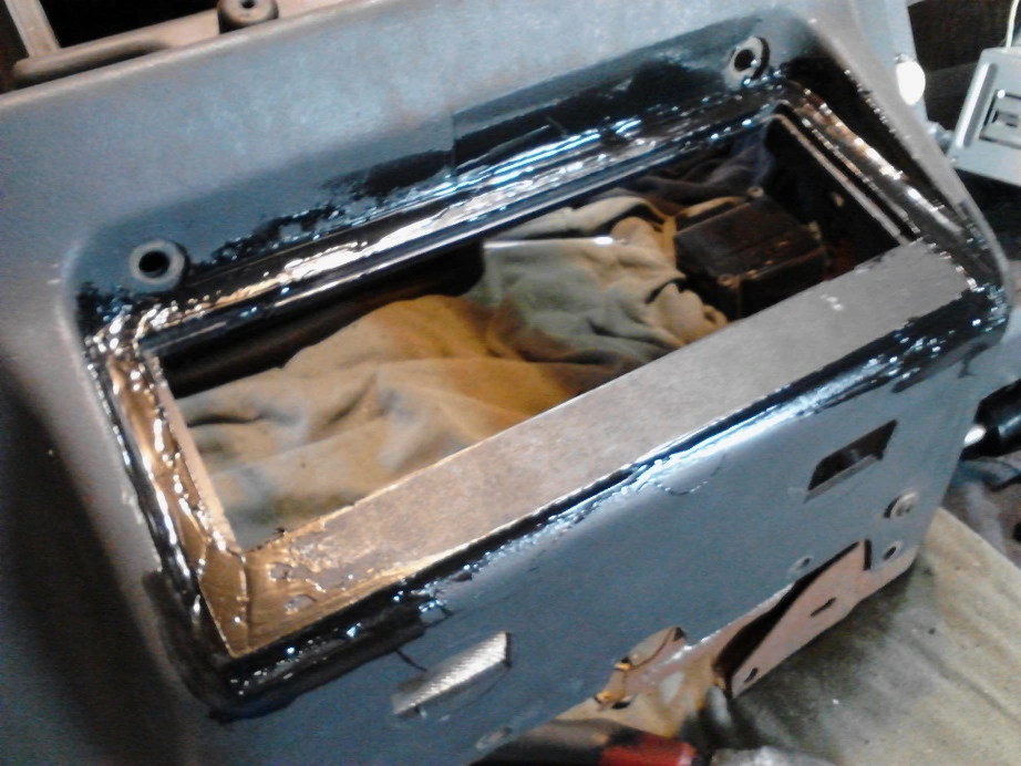

one of the po's hacked a huge hole in the dash where the radio goes.
I didn't have the funds for another dash. So i set out to fix it. I have a few panels laying around from various aftermarket install kits. I found one that was close to the opening and trimmed it till it fit.
Then I took some of the 3M flexible bumper repair epoxy that I had left over and filled in the gaps.
After a bit of sanding and a coat of filler primer. Needs a little more sanding and a coat of SEM but It doesn't look too bad. Not as good as factory but way better than the gaping hole anyway.

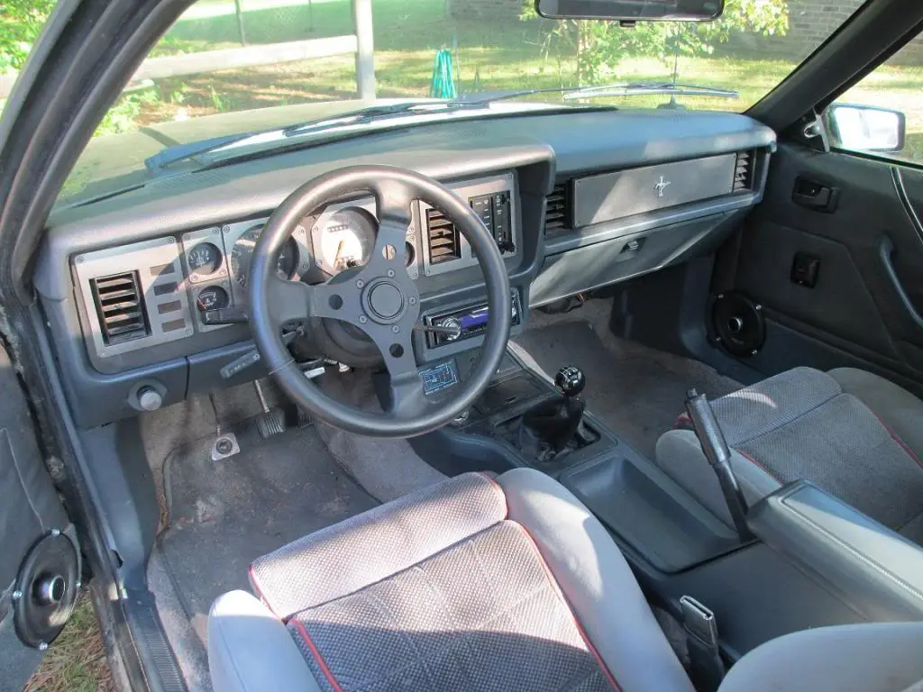

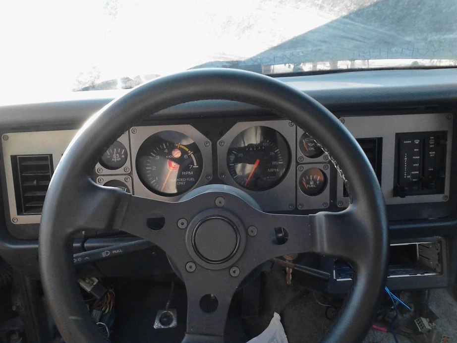

I installed a dash pad cover while I had everything apart, and painted the cover and the dash with SEM 15303. I also painted the gauge surrounds and passenger dash plate dark graphite metallic, but it looks almost silver in the pics for some reason. I think it came out really well overall.

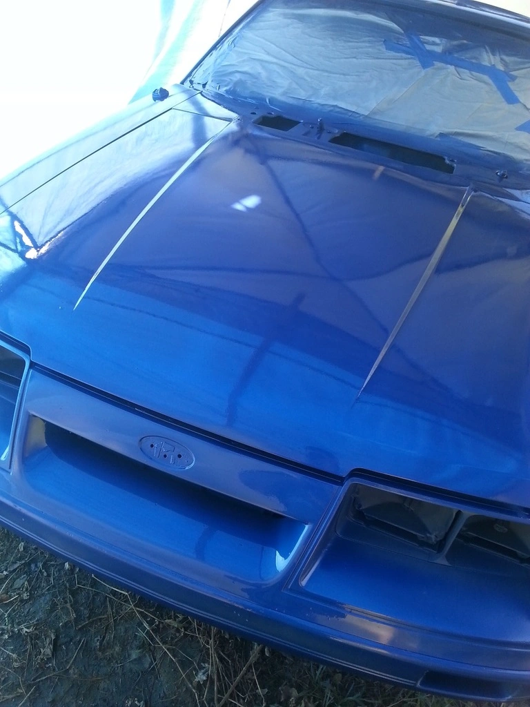

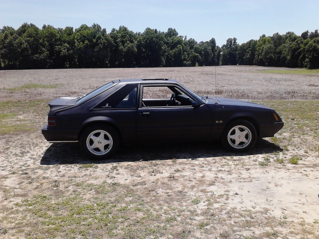

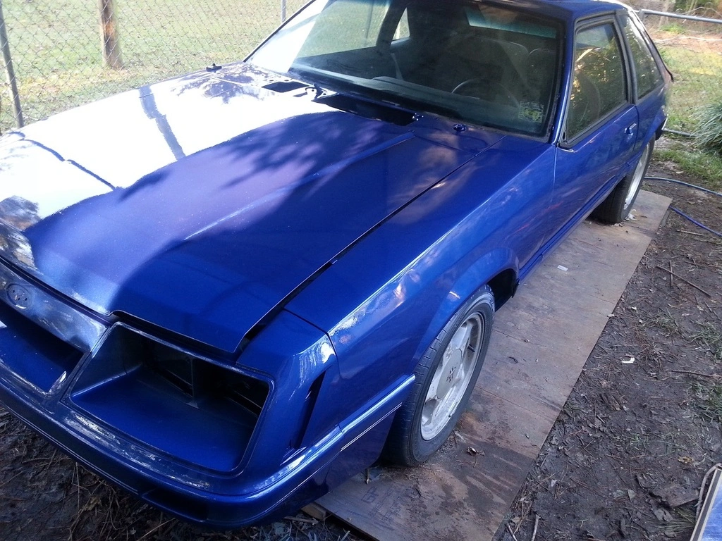

I drove it a little over the last year, once every week or two. A couple weeks ago I decided it was time to paint it.

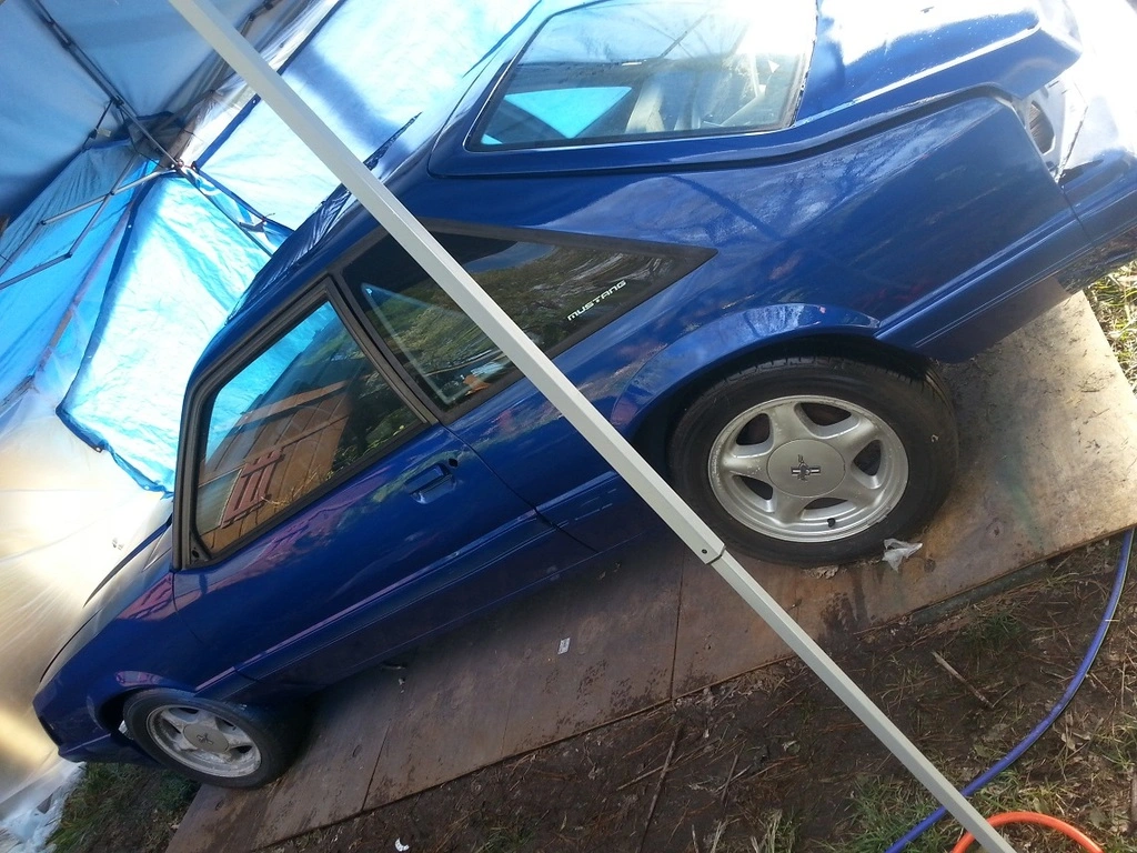

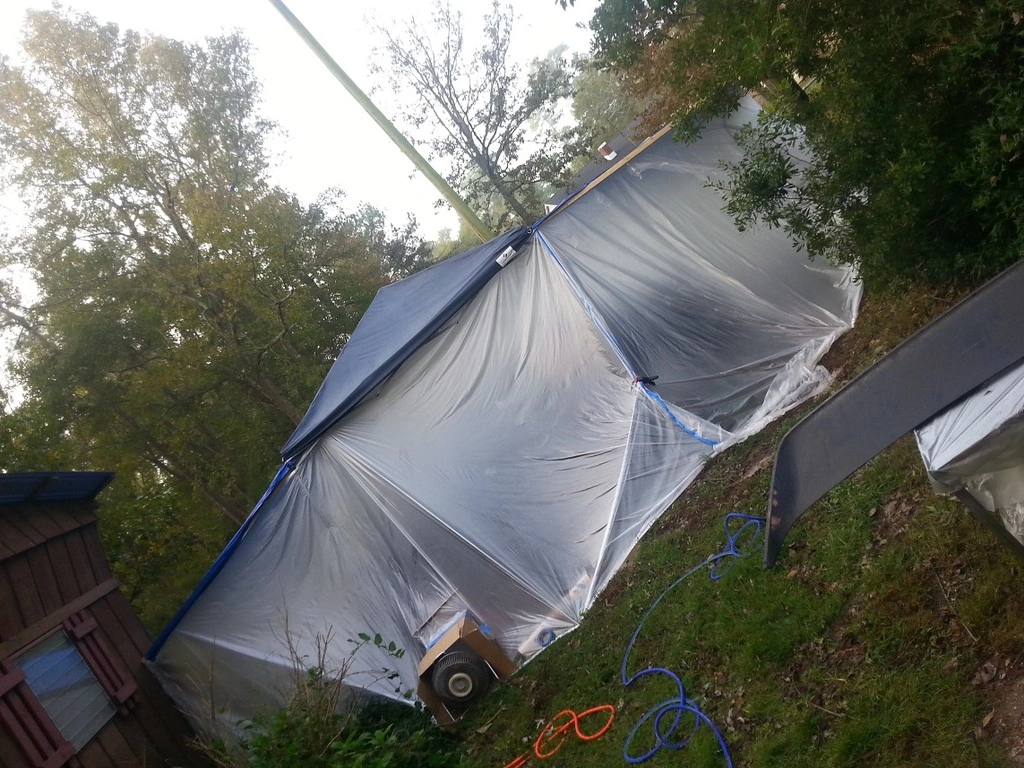

I didn't have the extra cash to sink a few grand into a paint job, so I decided to do it myself. I've primed a couple of cars before but never painted one so It was a learning experience. I'm not a body man by any stretch, mainly because I lack the patience, so the car is far from perfect. There are some imperfections showing through where I didn't do a good job sanding or prepping. Also some orange peel, one run in the clear on the pass door, and some trash in the paint since I basically painted it in my backyard with my "booth" consisting of a pop up canopy, tarps, and plastic sheeting. I'm pleased with how it turned out considering the investment. It should be a solid 30 footer once I get the trim and wheels painted. Might even be better once my brother in law helps me wet sand and buff it.
At any rate, It has finally got color on it!!! haha.
My "Booth" (I use the term very loosely)
few pics of the car, masking came loose from the wheel while spraying, got a little on the tire..
