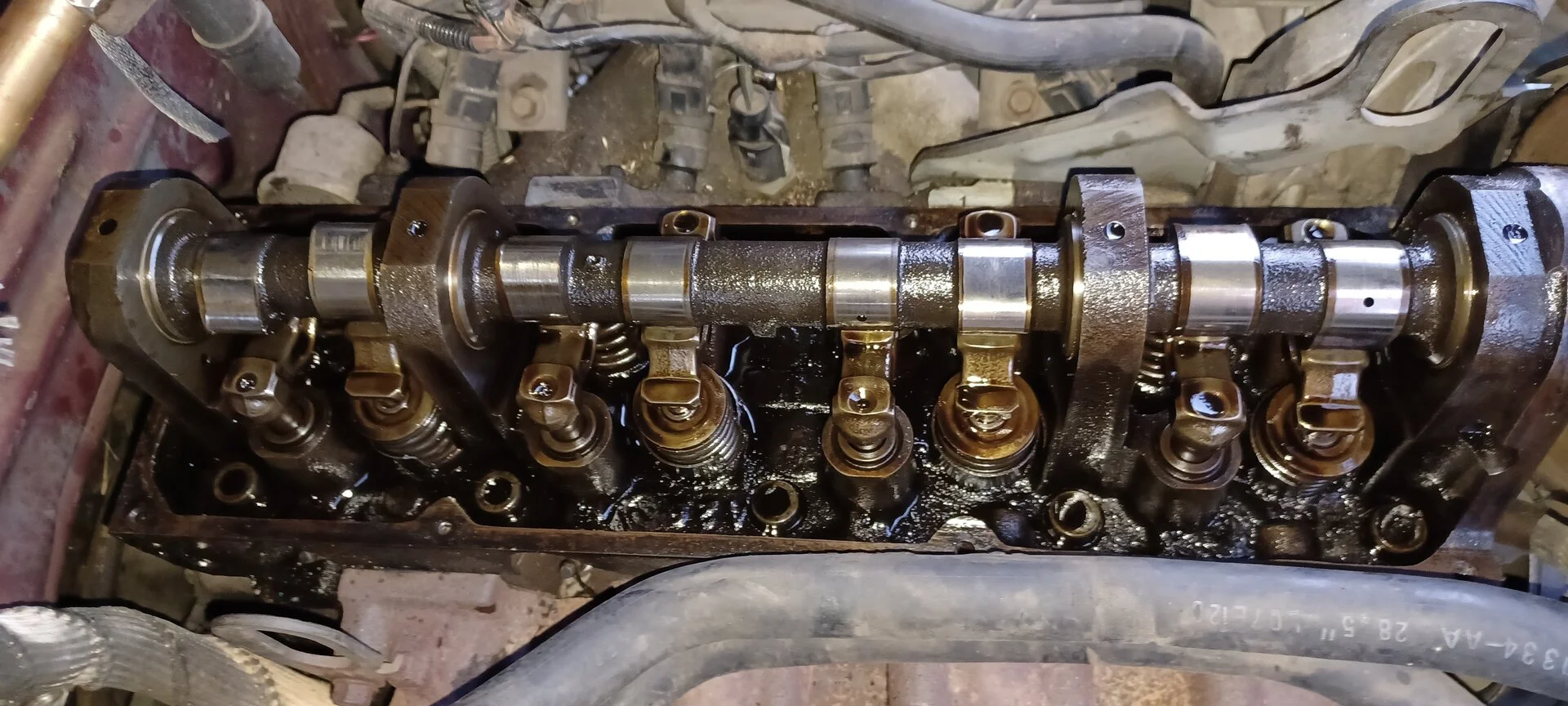

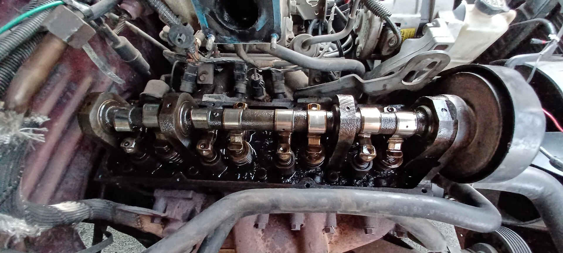

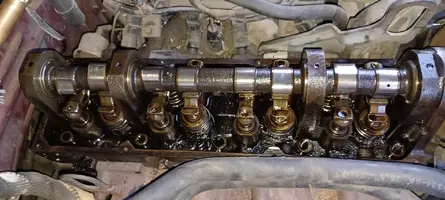

So today i replaced my valve cover and inspected the camshaft and lobes and anything else i could look at. Unfortunately i have some unsettling information.. my cam lobes are worn and grooved (ill send pictures aswell) and the followers under it have a little bit of play. I dont have the tools to check how much play there is or see if there messed up but i think that may be the reason i have a issue in the top end, cam and followers.

Kind of hard to tell in the pics but I have seen way worse.
As for the play, unless you have a bad HLA, the slack goes away once the engine is running and the HLA has oil pressure.
If you just want to go roller you can put a ranger cam/followers in. If you want a better cam then check out Boport's cams.

yes, looks like you have the infamous 2.3L Lima ditched camshaft. Appears to be a slider cam (non roller). The changes made in engine oil a long time ago are not condusive to "life" of a slider (non-roller) camshaft and that's what you end up with, ditched lobes. When the lobes wear down the HLA's will come up out of their bores a little bit, and can contribute to valve train noise. Usually the noise from ditched sliders is more like a sewing machine noise rather than a slower frequency tap-tap-tap-tap.
The good news, find a 90-94 2.3 in a junkyard and rob the cam and followers. It works fine with speed density and MAF. 95 (IIRC) they changed the valve stem diameter and the followers were a little different and won't work on earlier 2.3's. Using the roller cam and matching correct followers rewards you also with a few more horsepower (like maybe 10hp) and a better/more stable idle. I like it.
