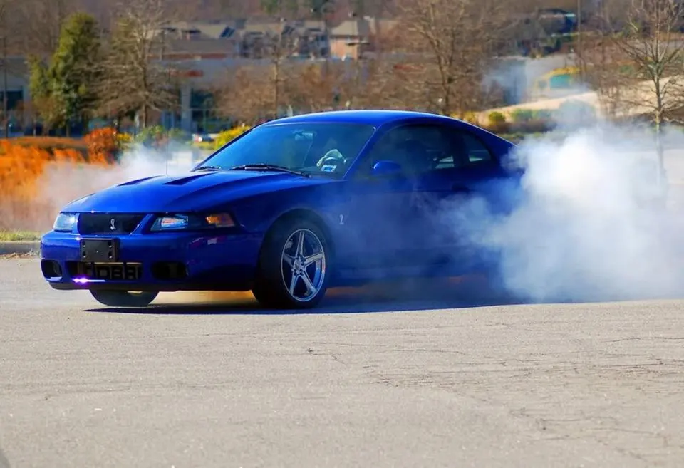

my turd

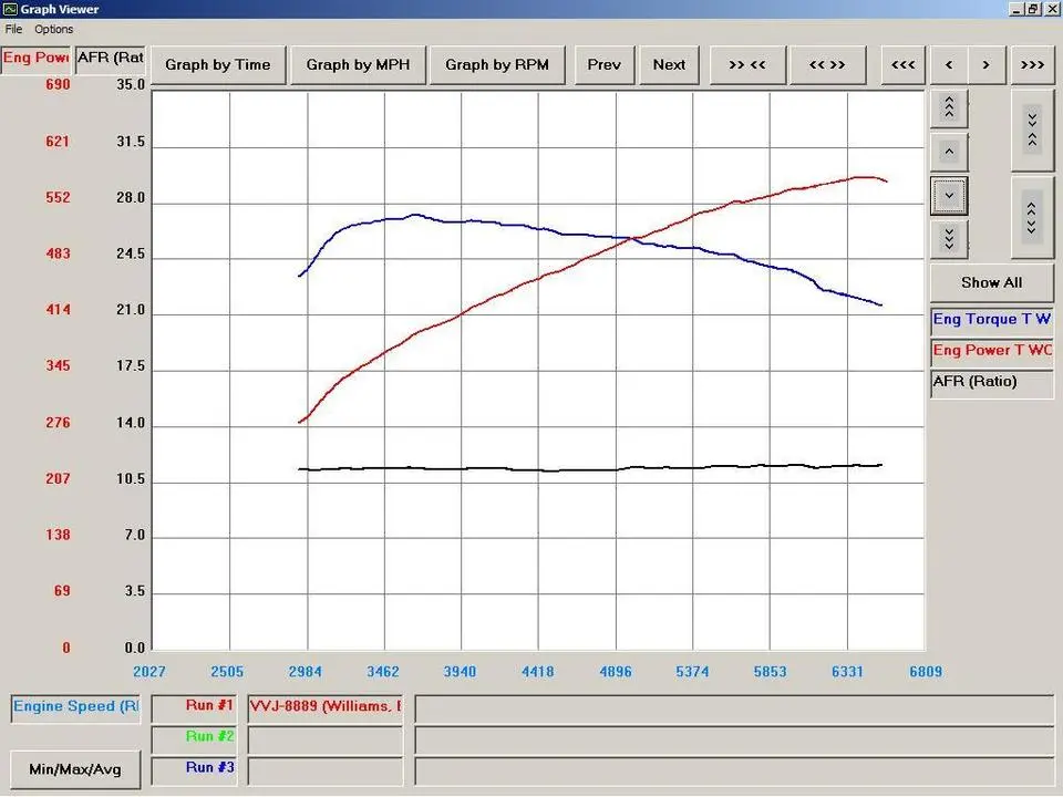

it makes 591hp 565tq on a mustang dyno was even 94degrees out hehe
its got 17degrees of timing and a 11.5ish afr. I could run 19degres of timing but whats the point? Id prolly crest 600 but meh it runs great. this is an old graph with afr around 11.5 and i think 17 degrees of timing after few pulls the tq started to drop off pretty good from heat soak. As you can see a nice afr line in the 11's
