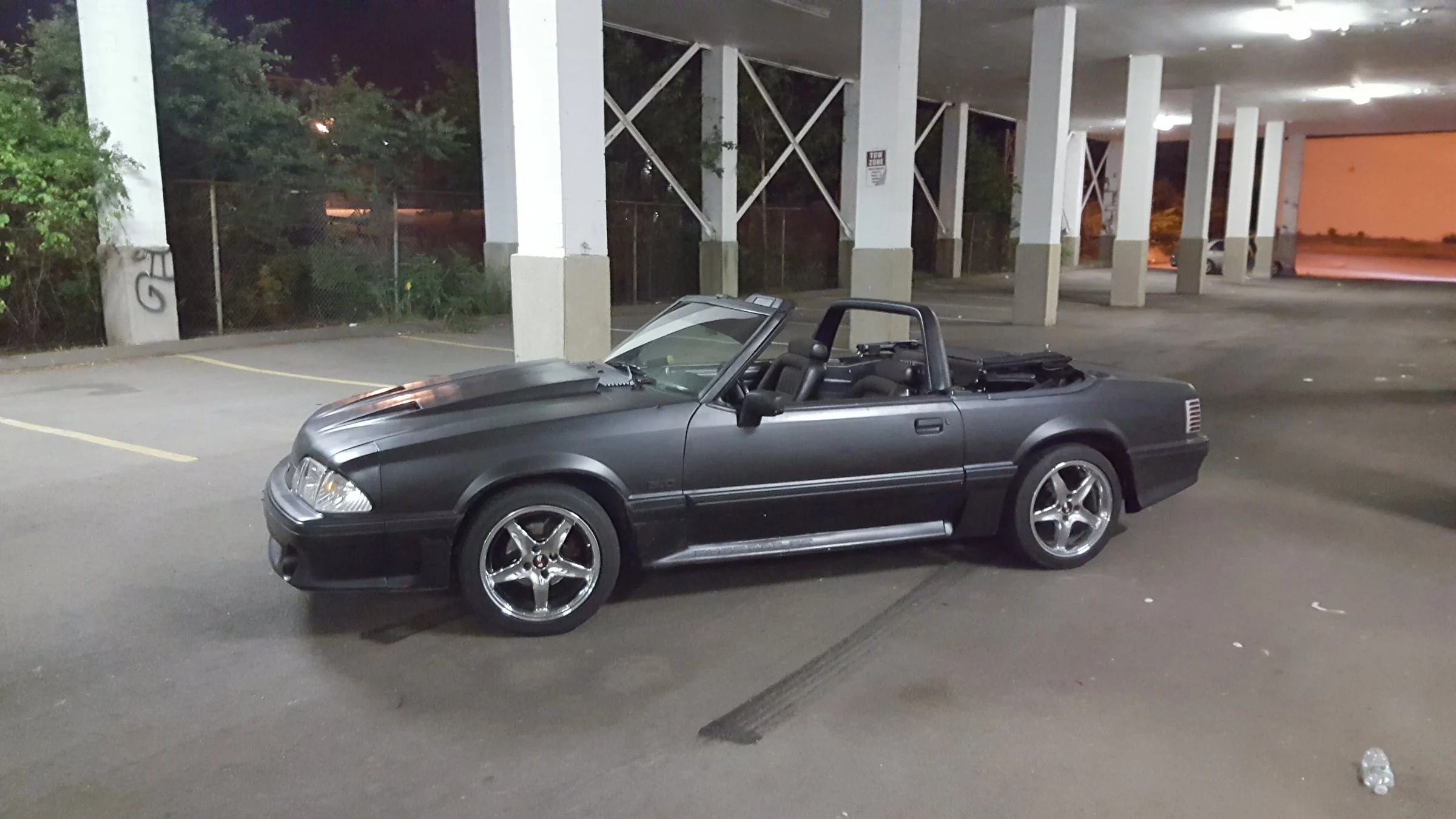

Hey, new to the forum. I have a 91 gt with gt40 heads, 1.6 roller rockers, and a f cam. Have underdrive pulleys and small stuff like that with 24# injectors. Anyone have an idea what intake would work best for me? Over the winter i am upgrading to 30# injectors and twisted wedge heads. Thank you
No forced induction yet..but i am going to throw a 100 shot of nitrous in it so figured i would have to move up on the injectors..been told 24# injectors are good to 350hp which inwill be past.
