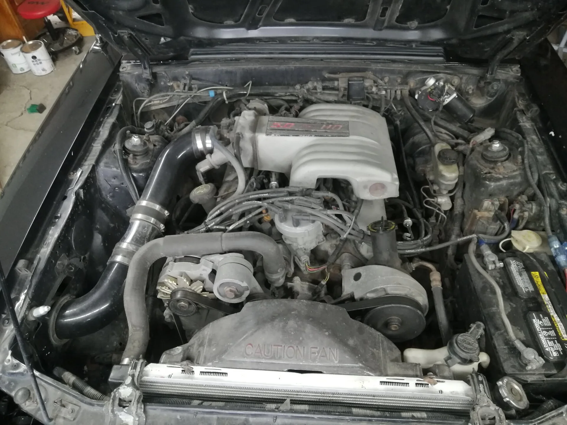

Wow really . They put a 87 ecu in a 89 or its not a real 89
So it’s entirely possible your ‘89 has been swapped to a speed density setup.
To answer your initial question, the VSS is not used at all with speed density other than with cruise control.
As to why the car has been swapped, someone probably did some hackery in the past maybe using a donor 87-88 and a roller 1989. Wouldn’t surprise me
On your VIN, the 5th to 7th digits are P4x, what number is the x?
After those three there is a letter, what is it? If it is an E the car was born with a 5.0, if it is an A then you have a 4 cylinder car someone did a 5.0 speed density swap.
