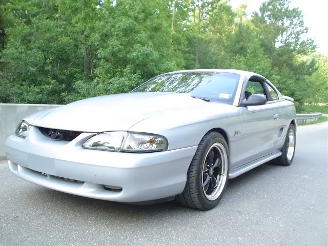

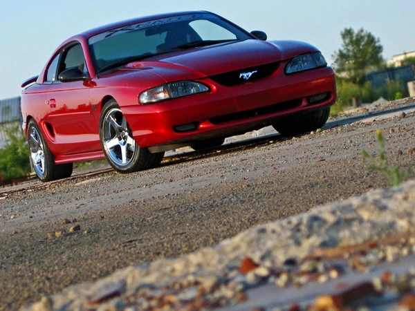

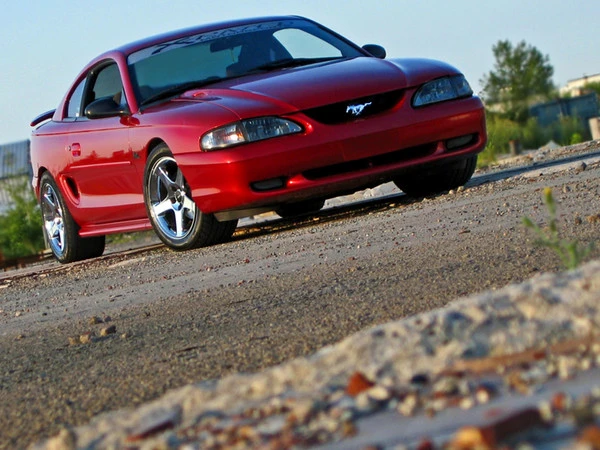

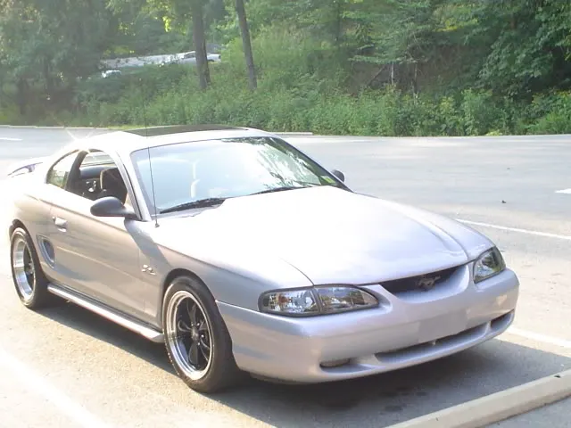

Here's a pic, I love the staggered look... I wouldn't even concider running anything but a 315 out back. Wide is mean as hell looking.

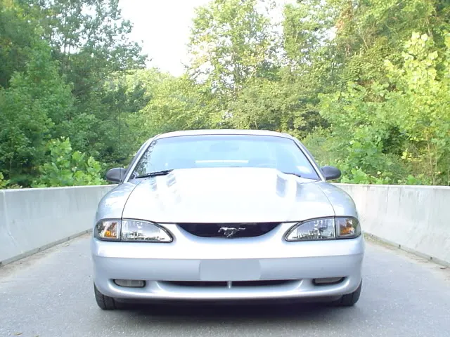

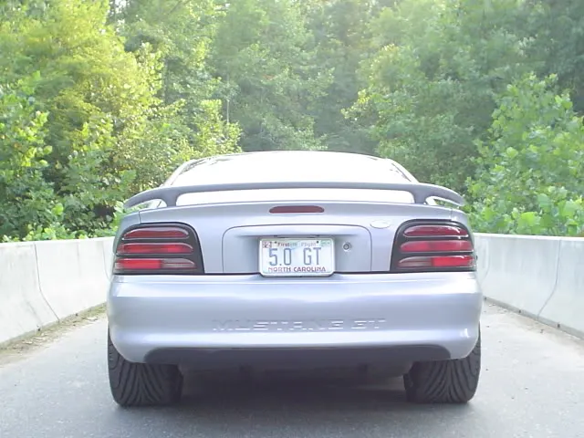

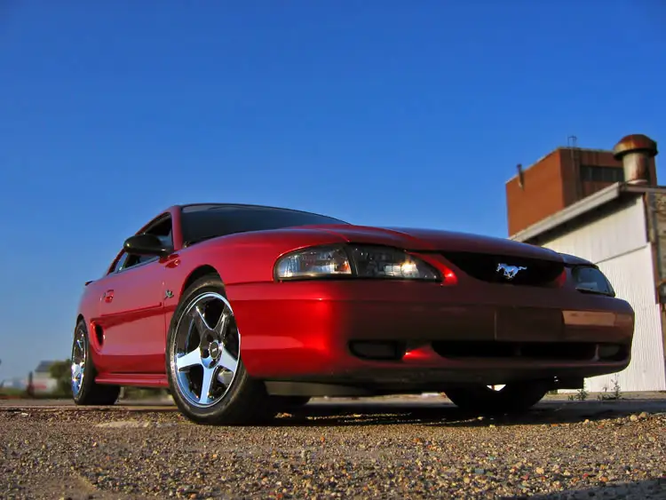

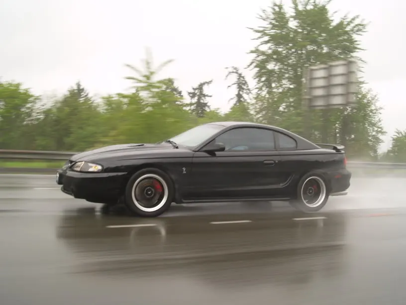

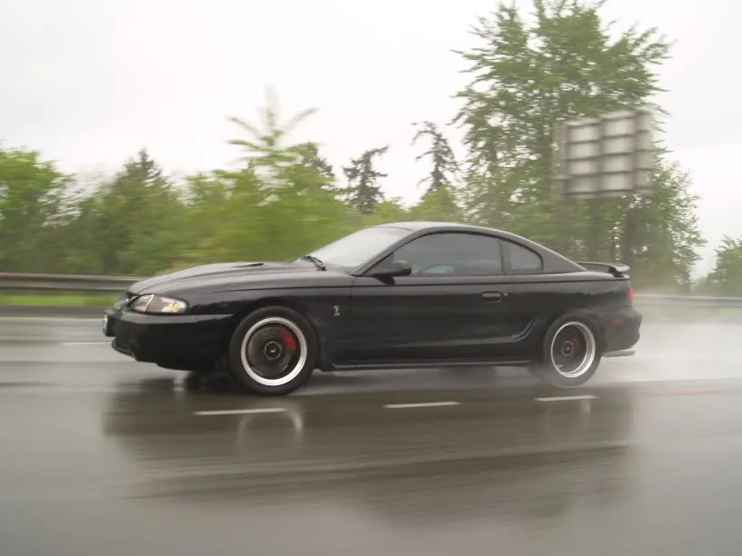

Cobra R 17x8 front, 17x10.5 rear
That pic is the front wheel, I beleive the back ones will be DD unless they are made like the '03 Cobras. My '95 Cobra R's are DD.
Most people have to flip the quad shock, you wont have to remove it, just flip it so the fatter part is on the other side so the wheel dosent rub. I personally did have to flip mine. And I havent heard about but maybe one person having tail pipe problems. I have turndowns so I wouldnt know. the only problem i had was that a weight on the back would hit the e-brake cable bracket. I just bent it in a little and its perfect.

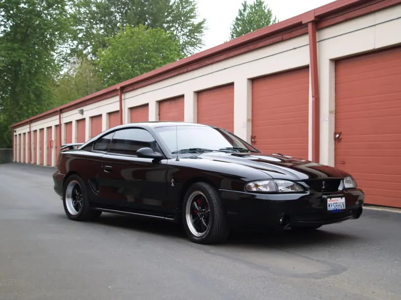

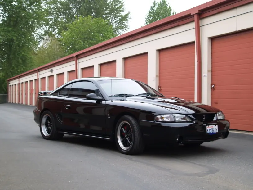

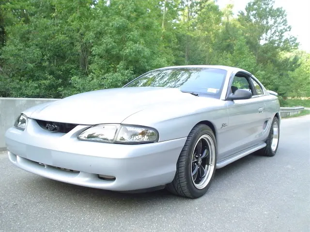

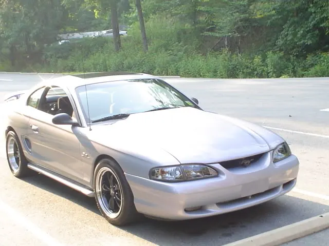

Here are my street rims 17x8 in front and 17x11 in rear American Racing Torq. Thrust II's, with 275/40/17 in front and 315/35/17 in rear
back
front qtr shot
I agree with killer, the 275 is just too wide for my liking, I think I will go with some 255's to narrow it down alittle. Car is lower now since I addad bullit springs.

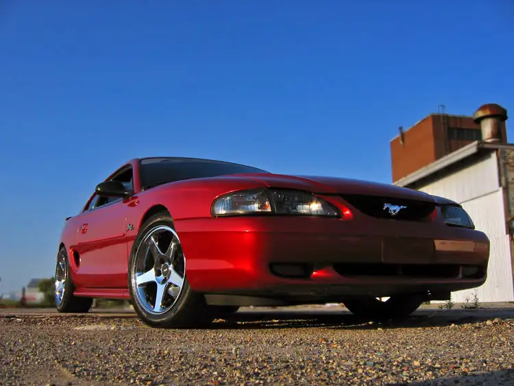

If you go WIDE .... you will NOT regret it. I love it!

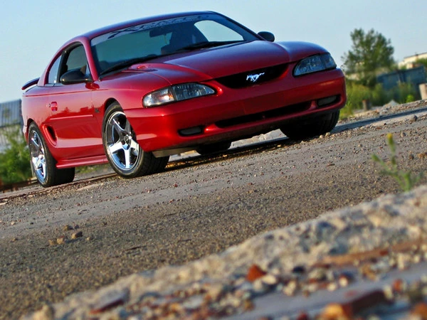

Currently 255/45/17 in front (going to 265/40) .... hard to tell in this pic ....

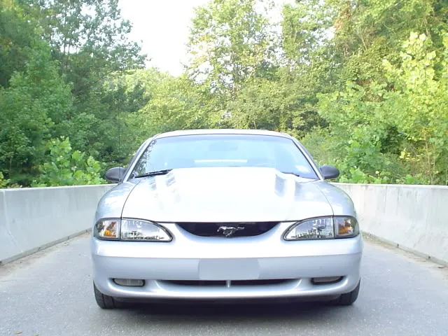

This is my wife's 96 Cobra.

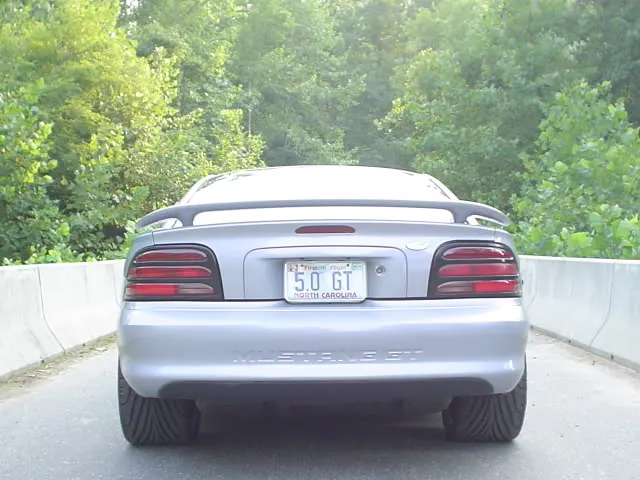

I put 17x8 Bullitts on the front with 255/40's and the rears are replica Bullitts in 17x10.5 with 315/35's. The tires are Eagle F1 GS-D3's. Fitment was very easy: I flipped both quad shocks. On the right side I had to rotate the tail pipe (SLP cat-back) a little inboard. The inner fenderwells required a little bit of massaging with a BFH to alleviate a slight rub on hard cornering. The tires sit flush with all four fenders and the stance is great. The traction is outstanding.
