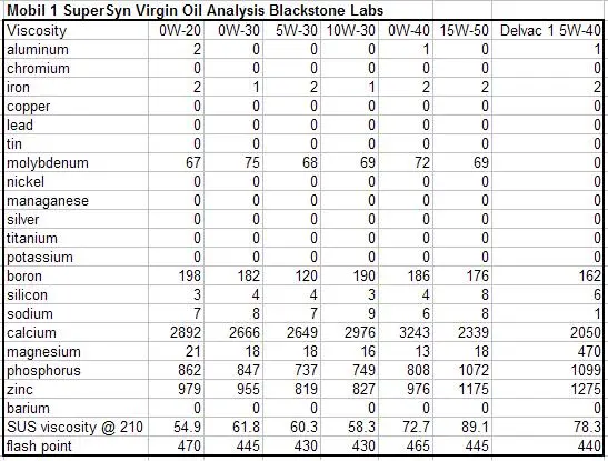

mobil
TBN's not shown here, but they are 10-12 TBN for these samples

Basically you want high #'s for TBN, boron, moly, calcium, zinc, and phos.
