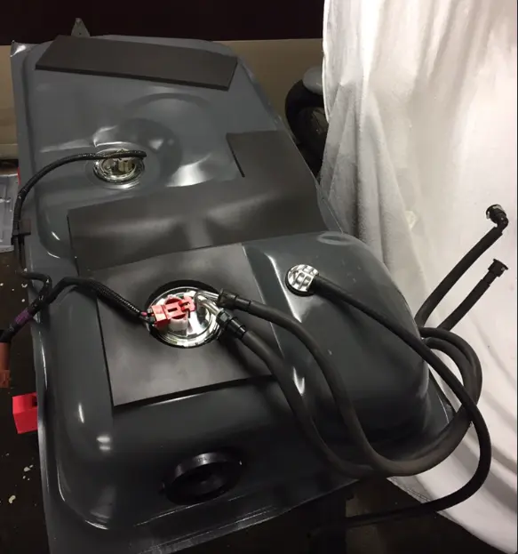

Four things come to mind. The fuel sending unit gasket, the fuel pump hanger gasket, the tank vent gasket, and/or the filler neck grommet.
This is a pic from Mustang5L5’s car and you can see all four item I am referring to. Furthest one to the back is the fuel sending unit, one with the red plug is the fuel pump, white one is the vent, and black one on the side closest in the picture is the fuel neck grommet.
Well he still didn't paint his vent, tragedy.....really....
Where is the tank vent routed to?

Scott_S said:
I'll definitely keep an eye on it. It seems to have stopped, for now.
It goes to the charcoal canister at the front of the car. It is mounted on the passenger side on the inside of the front frame rail. Not my car but found this pic on a Google search. Mine is relocated due to the ABS pump.

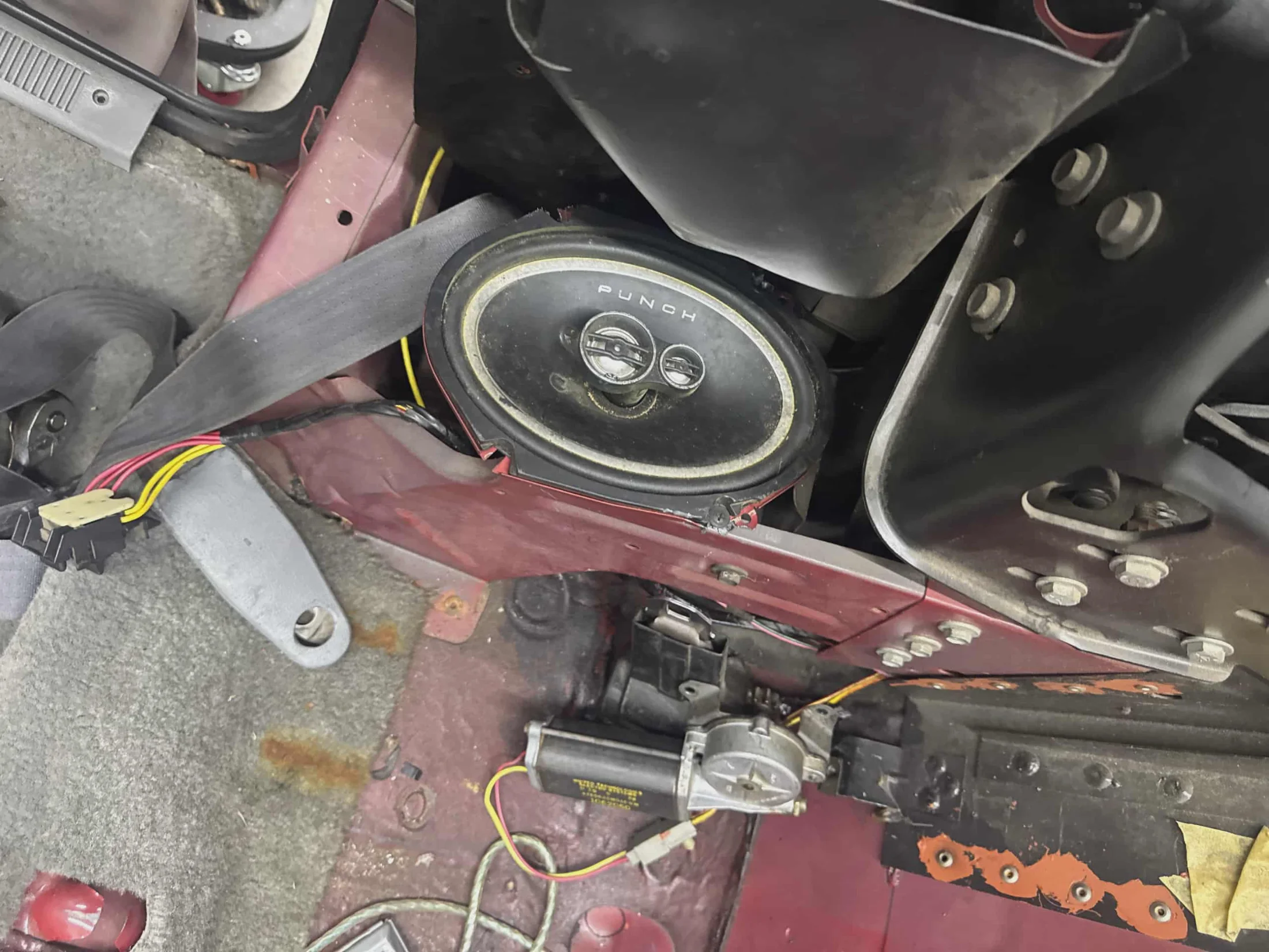

I've had the car with a local Foxbody guy who did the top on my buddies Fox. He's almost done swapping out the quarter window motors and top cylinders. The motors failed shortly after I got the car home. The cylinders worked fine, bug showed signs of weeping. No better time to fix them, right?
He's also snugging up the top and making a few fine adjustments. I also replaced some rubber while he's in there.
I also found these rear speakers, crammed in there and hold on with one screw. I bet that rattled like crazy!
Next stop is the stereo shop, so I can reinstall the interior, shifter, console, etc.

The crap people do when it comes to car audio.

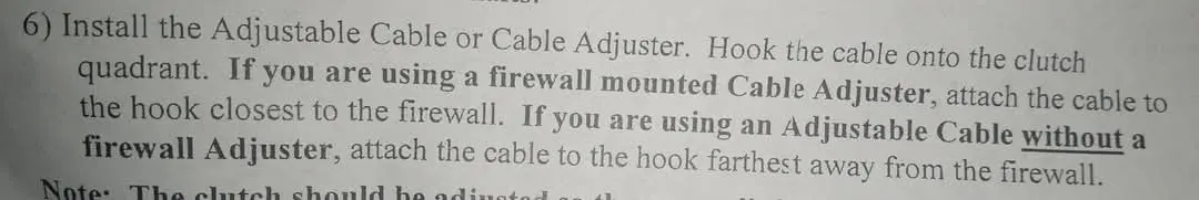

OK, so educate me here.
On one of the Facebook groups, someone shared this:
It looks like my cable is on the hook farthest away from the firewall. I haven't checked the end at the clutch arm yet. I'll probably have to get it checked when it's at the shop, on a lift.

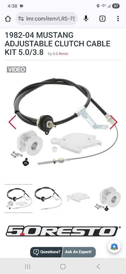

I don't know what kind of cable I have but I am assuming it's adjustable. The quadrant and adjuster look just like this kit:
IF the cable is adjustable, and since I have a firewall adjuster, should I change the attachment point on the quadrant?
Or, should I start with just a baseline re-adjust: screw adjuster all the way in, adjust cable at the clutch, fine tune at the firewall and leave the quadrant alone?
Oct 28, 2001
6,160
4,250
183
Claremore, OK
Oct 31, 2025
#80
  • Oct 31, 2025
  • #80
If you change the attachment point to the one closest to the firewall then you are going to have all kinds of slop in the cable. You are fighting a cable that needs to be shortened as it is so using the one closest to the firewall will make things worse.
