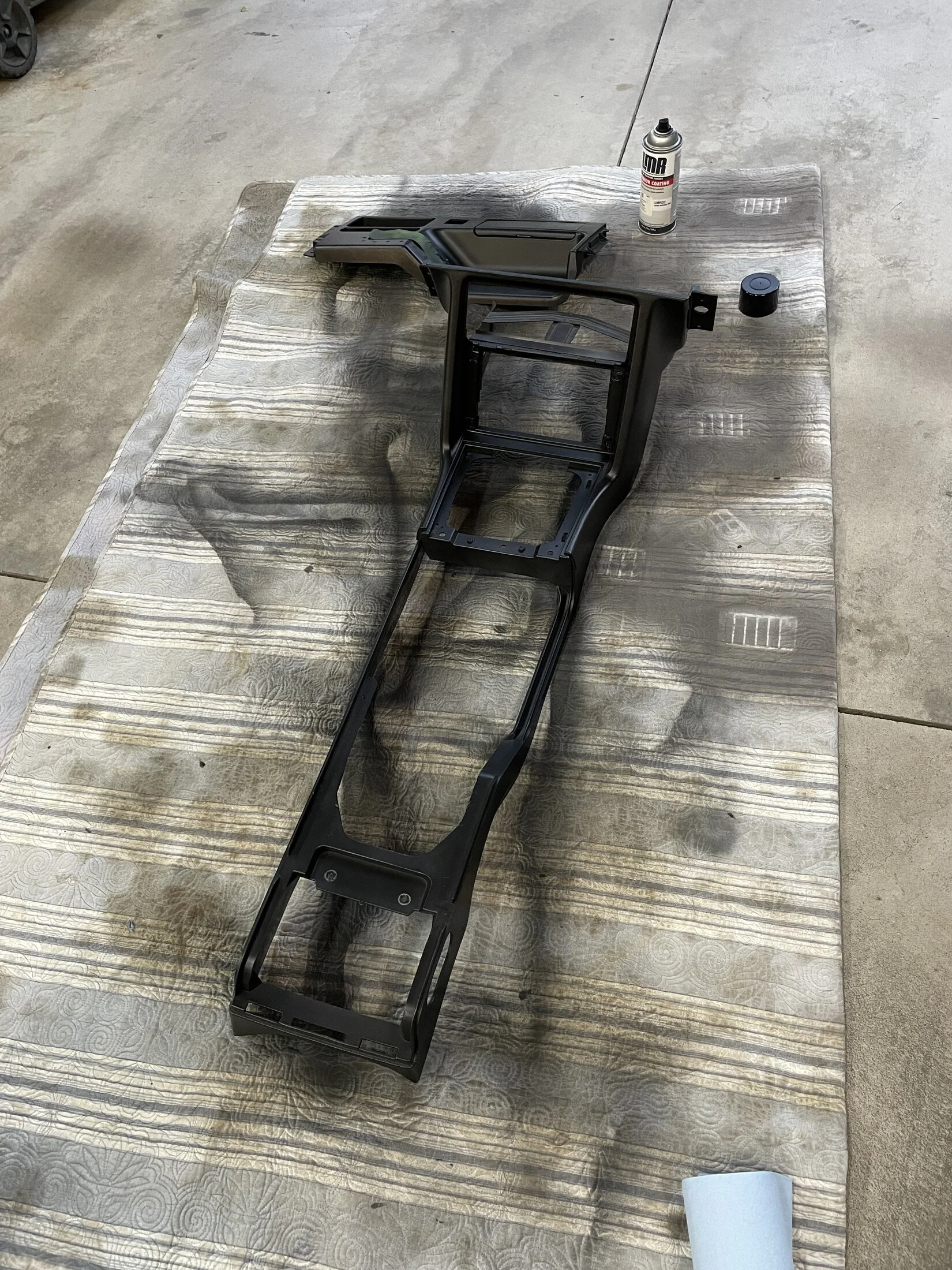

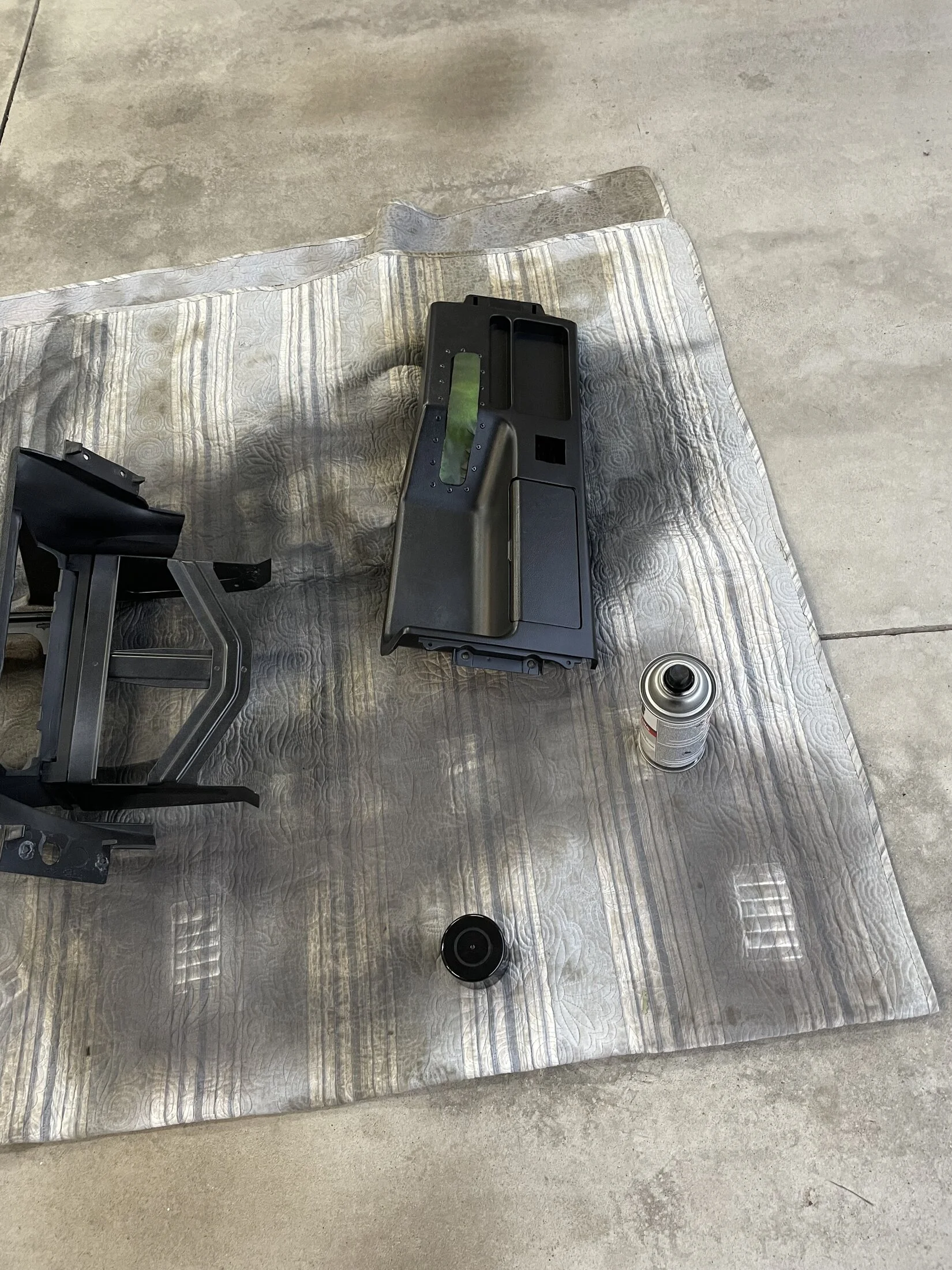

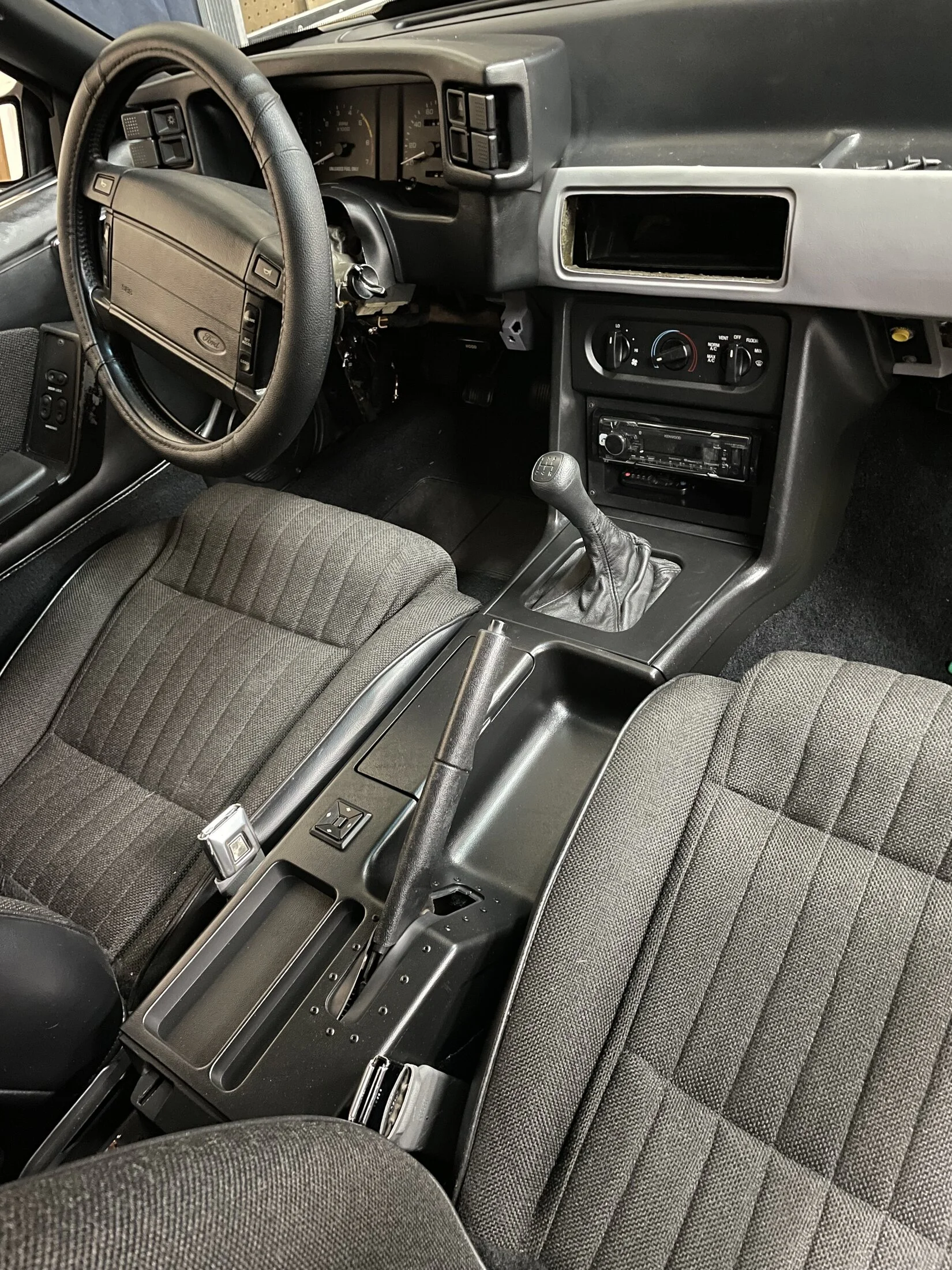

More interior dying today... Harmonic balancer should be here tomorrow. I'll be changing that and the front seal. Man, it would be nice to cruise around in it this weekend!
Center console will eventually get the cup holder upgrade.
Reactions: nicholase

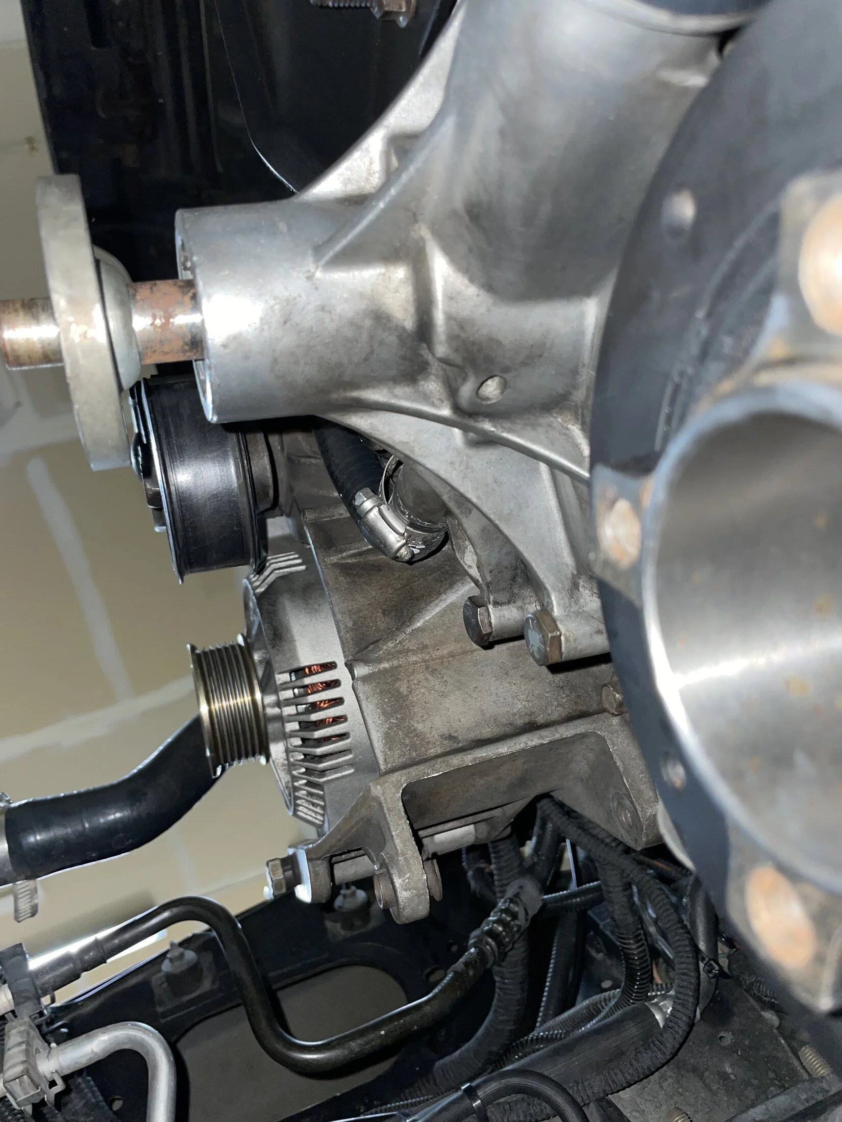

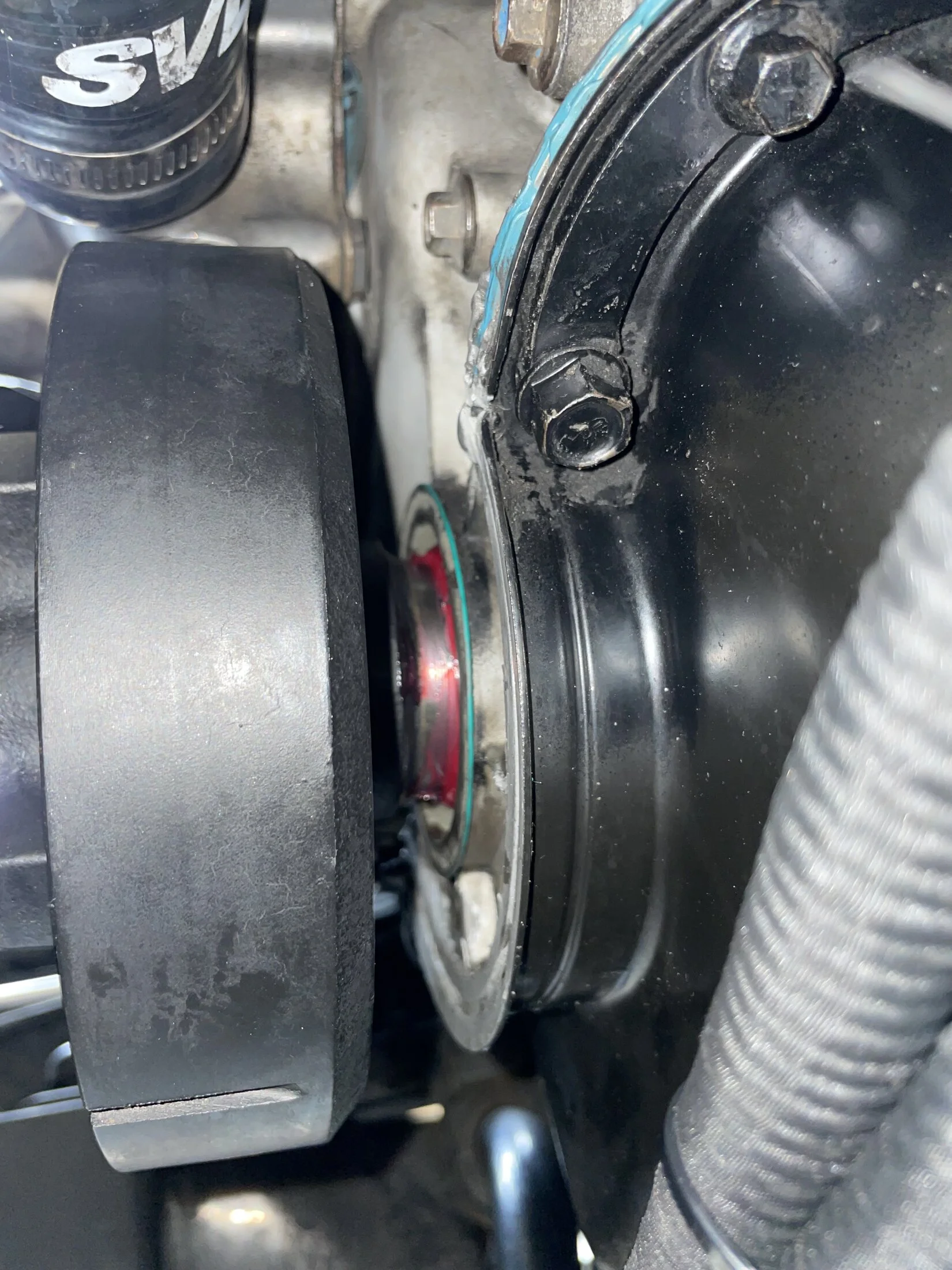

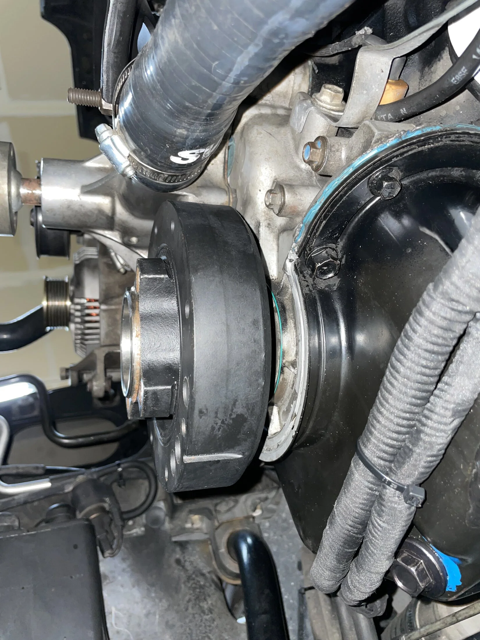

More progress today...replaced front seal and harmonic balancer. Water pump weep hole is dry, so that's good. Also installed the newly dyed center console. Considering installing the under drive pulleys that came with the car...

What was wrong with the balancer? wobbling?
My car had underdrive pullies when I got it. I didn't know and was always wondering why I couldn't get a normal belt size to fit.
It ran on the hot side and charging wasn't great even w/ a 3g alt. Maybe there are different ratios and mine were off or something? When i figured it out I put normal ones on and all those things went away.

Yep, balancer was wobbling. I wish I could post a video of it up here but the site doesn't like it.
