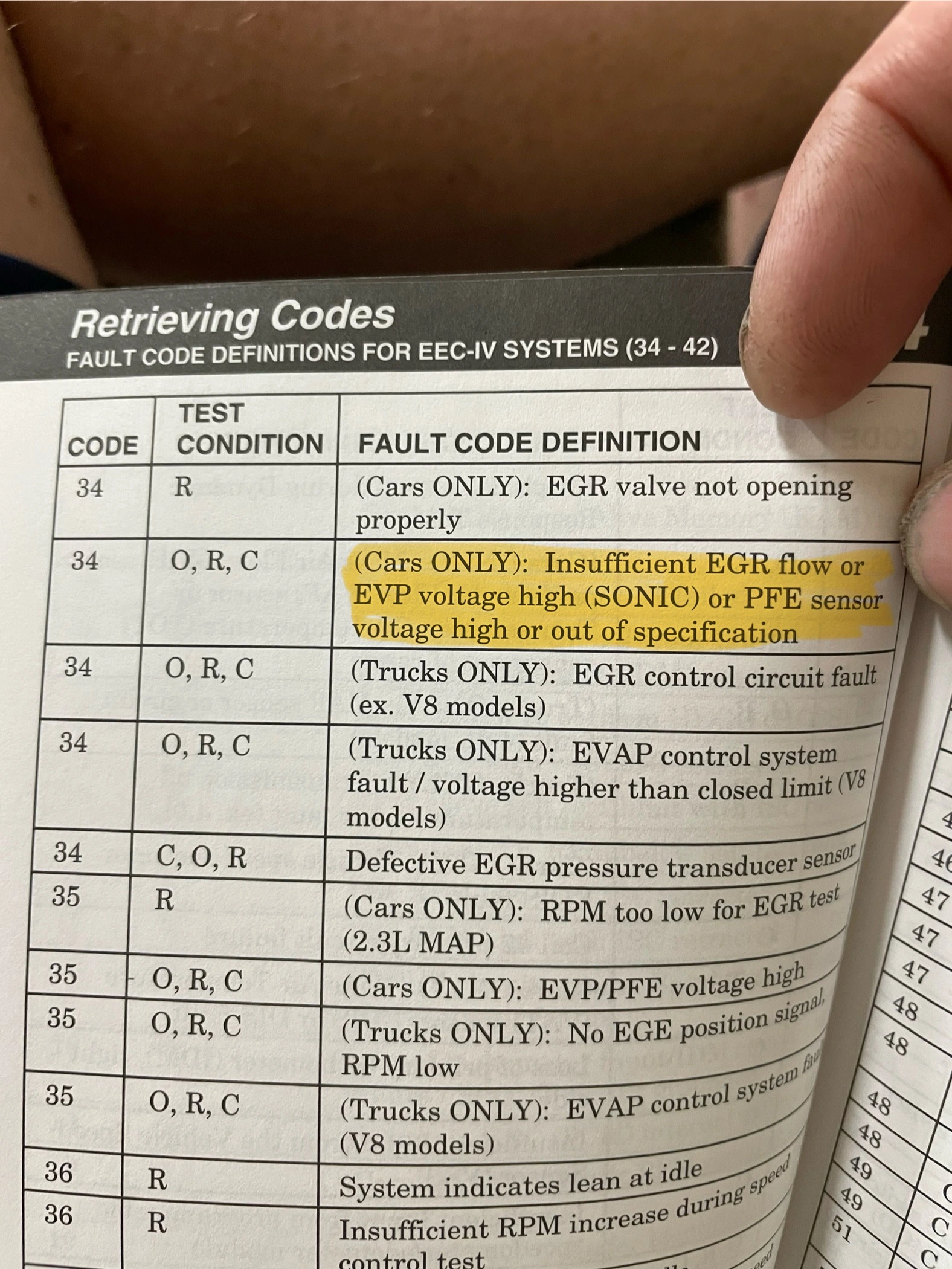

Pulled codes...
34- EGR not opening properly. Weird since I have one of those bypass plugs inserted.
67- Neutral safety switch. I know this trips unless you have the clutch pushed in when you run codes.
I get a code 31 with it removed and a code 34 with it installed. No CEL when installed. I assume the EGR characteristics will not activate with the code 34? Probably code 31 as well. I looked for answers here and it gets muddy pretty quick.
So...how come my engine freaks out when I run it without the filter? I'm just testing things. I have the cone that attaches directly to the mass air.
Pulled codes...
I'd have to think unless it was tuned or chipped for the EGR delete it's still gonna set the 34 because it's not seeing the resistance value of the EGR position sensor change when it tries to open it. It just sees the fixed resistance of the dummy plug. So it's trying to open the EGR and doesn't see confirmation that it moved. Then sets the code 34.
I think those plugs just keep the CEL off by not showing an electrical circuit open. So this probably isn't related or causing the symptons you are experiencing.
That seems normal too.
*Where it gets murky and just for conversation:
As far as when the ECC decides to ignore the EGR thinking there is a problem and abort any fueling or ignition changes I'm not sure. Even if the EGR is physically removed, blocked off, and a dummy plug put in, it still thinks it's there. So there is a point where the EEC decides when it's going to stop trying to open it or disregard any info sent from the position sensor or dummy plug in your case. I don't know when that point is.
A possible problem I could see the dummy plug causing is if it was wired for an incorrect resistance and was showing the EEC a value of partially open EGR and it was trying to adapt to EGR flow when there wasn't any.
a) I would think you'd have driveability problems all over the place because it would think it's always open or partially open.
b) I'm not sure the EEC does attempt to alter fuel / ignition if it sees the position sensor indicate flow when it is not currently trying to open it. That might be a point where it disregards because it's getting conflicting info.
I'm not thinking there is anything here. But, out of curiosity I'd probably unplug the EGR position dummy plug to force the code 31 and illuminate the CEL in an attemt to confirm it is aborting any fueling or ignition changes related to the EGR. Then take it for a ride and see if anything changed. If not move on to the next thing.

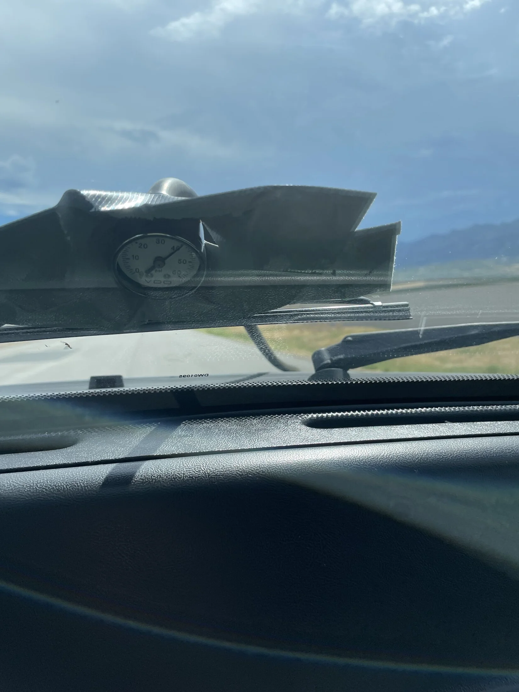

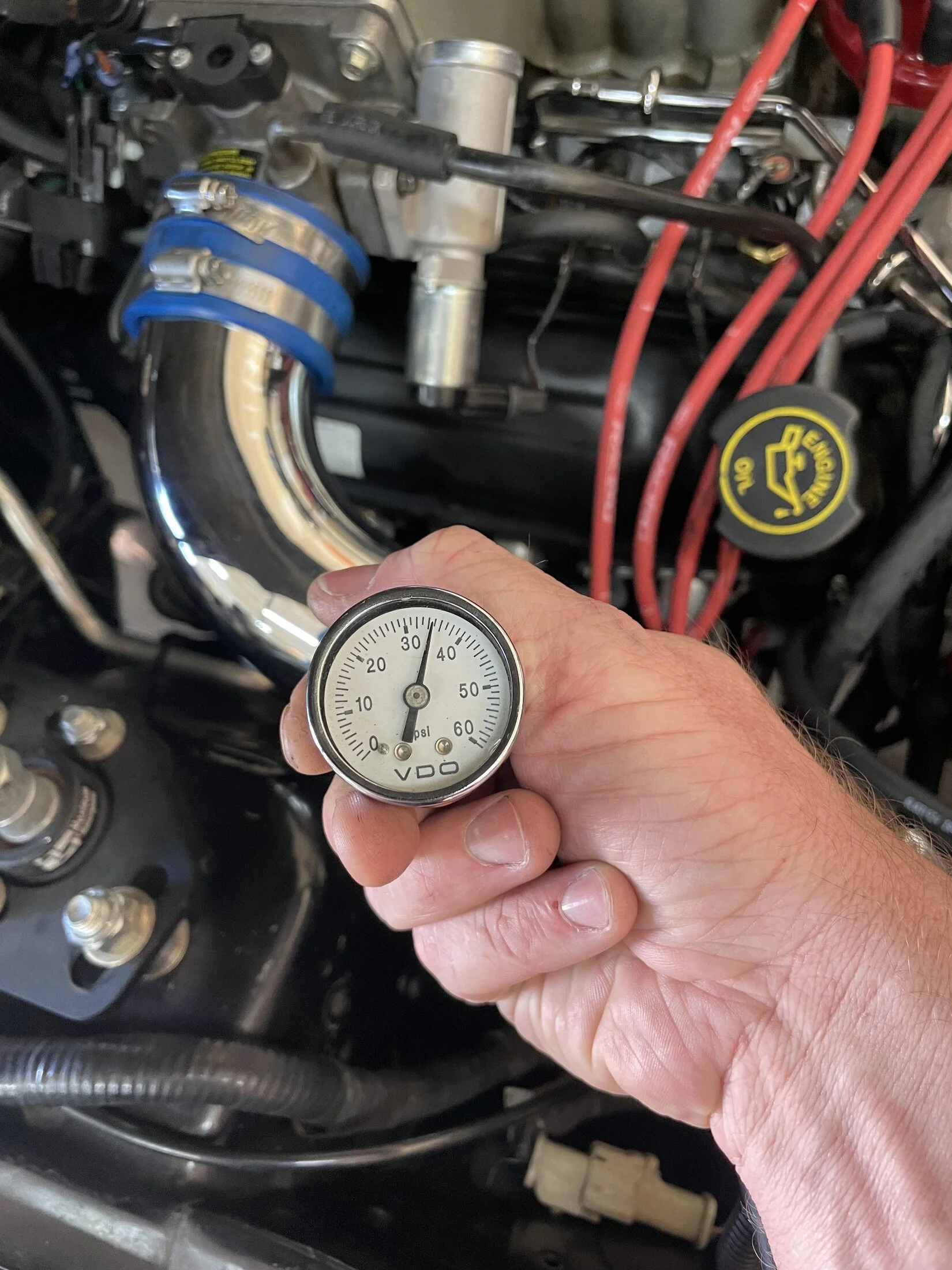

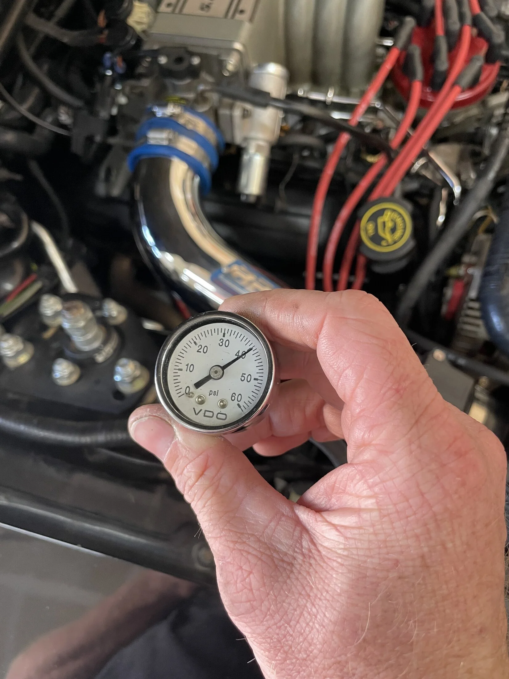

Update... Decided to unplug the EGR resistor plug and hook up my fuel gauge to a hose and went for a drive. Here are the results:
Idle with FPR vacuum line connected. 34 PSI.
Idle with FPR vacuum line removed. 40 PSI.
WOT. 40 PSI.
Man it really spits and sputters at WOT...crazy.
Thoughts?
WOT. 40 PSI.
Thoughts?

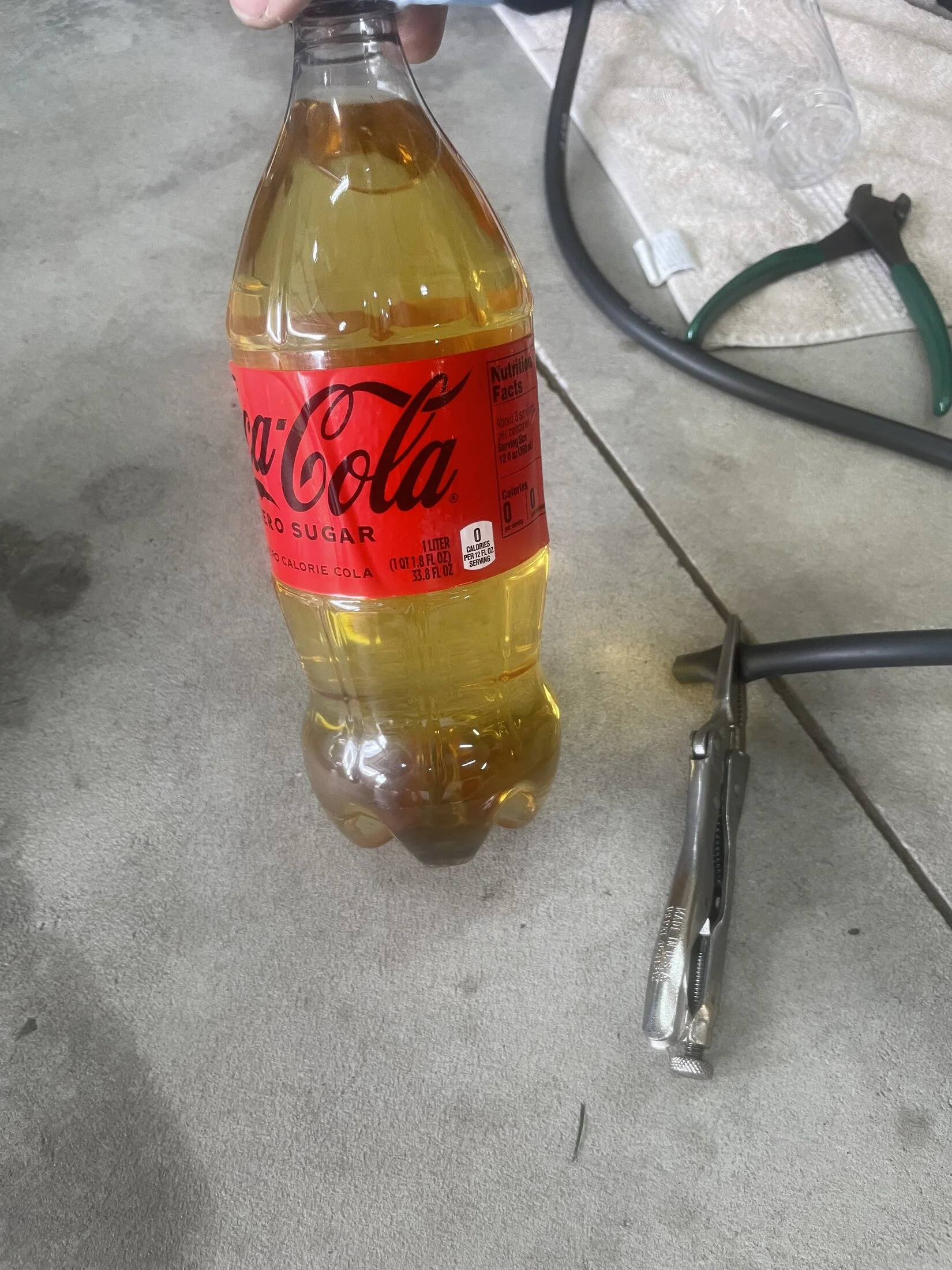

Just for kicks I measured the volume the pump produces at idle. I filled a 1 liter bottle in 15 seconds. That equates to 240lph. That's a lot. But not sure that would create an issue. Still has stock injectors. I bet the previous motor in this car made more power, so they upgraded the pump...just a guess.
