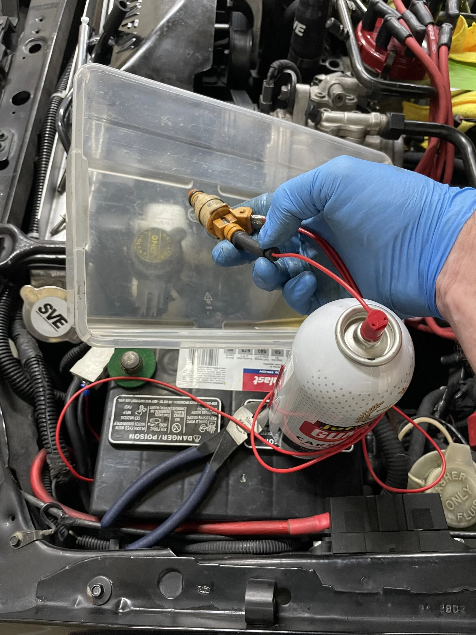

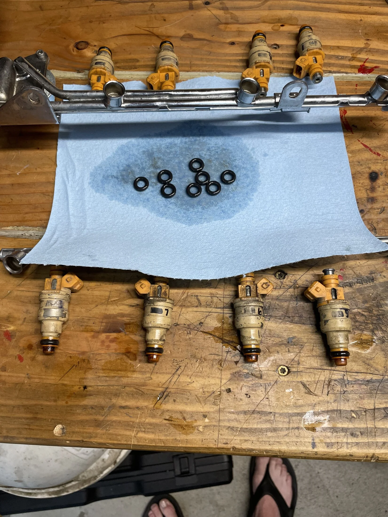

Nice...Cant wait to see if this is it.Well, I can't sleep so I decided to clean the injectors myself. Watched a few YT videos and the key is being able to build pressure with your cleaner and cycle the injector.
I used carb cleaner and was able to create something that would hold pressure without blowing apart in my face...took a few tries.
Hard to tell how bad they were because you have so many things going on at once with only 2 hands to control it all. Number 8 had some crud in the inlet screen. I cleaned it out and flushed it. Right now they all appear to have a nice spray pattern. I guess we'll see how it goes tomorrow.
Here's what I did:
I sprayed the rail and will let it sit overnight before I flush with denatured alcohol. I'll make sure to remove the regulator when I do that part. Orings are sprayed with oil for the night. I will clean the exterior of the injectors tomorrow and toss them back in.
