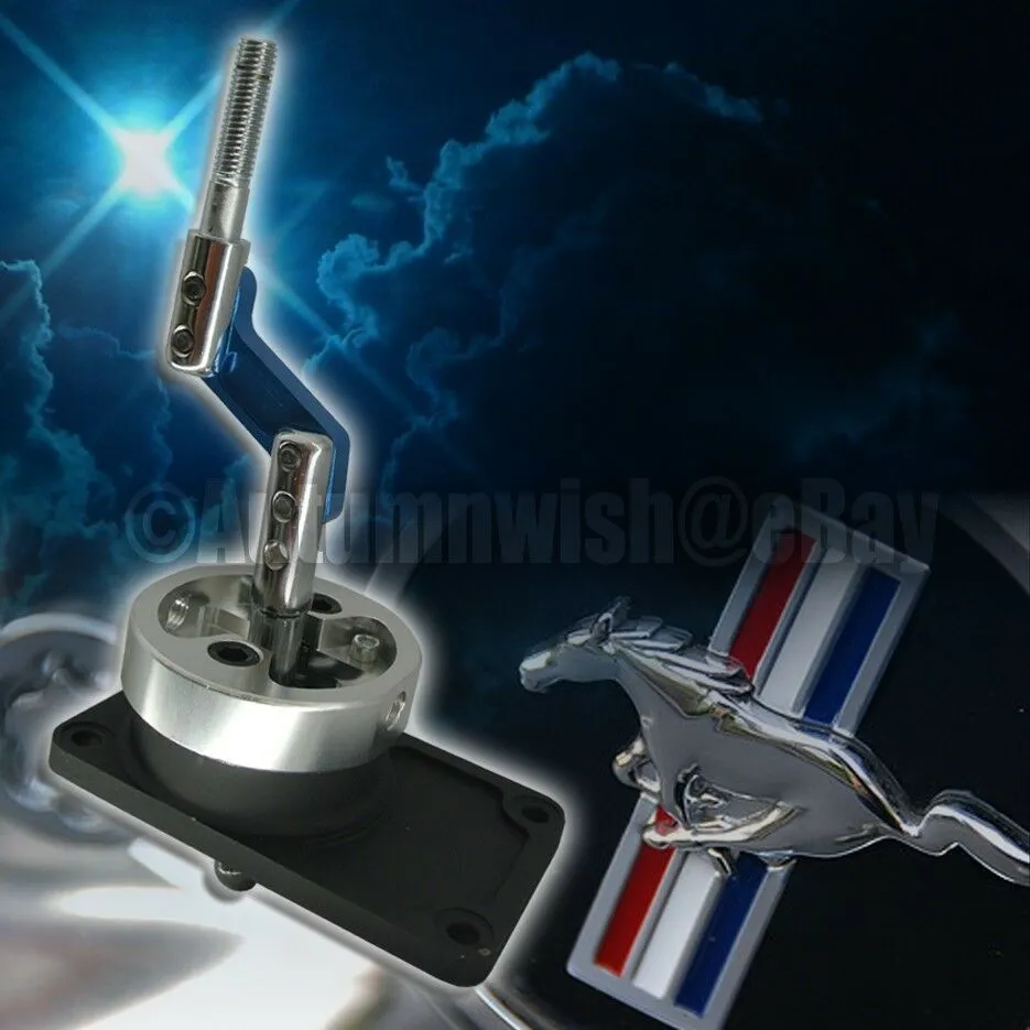

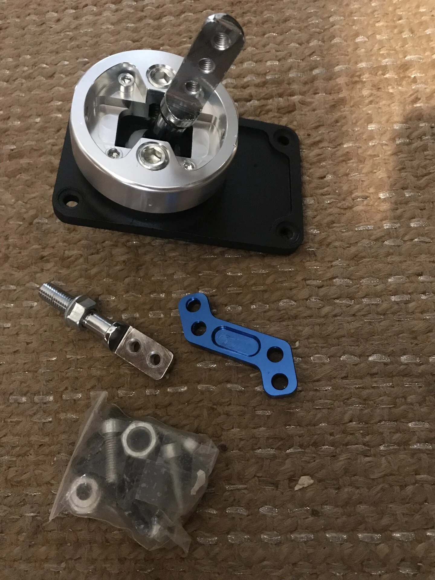

Got a neat~o shifter in the mail. Ordered matching shift Knob(read cheap).
Old trans cossmember has the stock y pipe (now x) bolted to it. The new crossmember will mandate some exhaust modification.
Will 5sp trans and clutch linkage clear with old exhaust Y or do I need to step up to headers now for this swap.
Also I would like to find a second drive shaft to modify for the T5. I think someone said my starter will still work with t5 but not with the headers.
List of still needed items;
Money(lots)
starter
Flywheel
Clutch, plate, throw out bearing
Fork
Fork cover
shifter boot
headers?
driveshaft to mod
Beer(lots)
But have a fun shifter for 42$ on door step (included dramatic ad picture)
Hope its not too cheap a POS but looks nice I'm a sucker for blue anodizing.
Money(lots)
starter
Flywheel
Fork
Fork cover
shifter boot
headers?
driveshaft to mod
Beer(lots)
I would think the stock exhaust would fit. I'm pretty sure the headers would have be be nudged with a hammer to fit. But my experience is with the stock bell. I don't know if the starters were different on a C4 vs. a manual transmission. I also think your clutch options are much better (cheaper) than with the stock. Did you figure out the tailshaft and speedo?
Reactions: 2Blue2

The stock auto and manual starters are different. They look identical but the throw is different. Not sure which pops out further but they are different. The starter depends on what flywheel and bell you use. Match it to whatever those two came out of. If using headers and money isnt a hinderance get a gear reduction starter no matter what bell. Easier to replace and more room for activities!
Headers depend on what bell you use. Iirc the fox and quick time bells need more adjustments to headers and some just don't fit. I do believe all bells fit with stock exhaust manifolds. I don't remember anyone mentioning a different y based on manual vs v8. My headers run below the fork. Your fork is clocked higher isn't it? I would be more worried about bell clearance vs fork. The headers hug my II bell very tight.
I don't have a decorative shifter boot yet although I do have the early fox shifter seal. It sits on the tunnel under the carpet and seals pretty well.
Fork cover is unnecessary weight. A nicety but not a necessity.

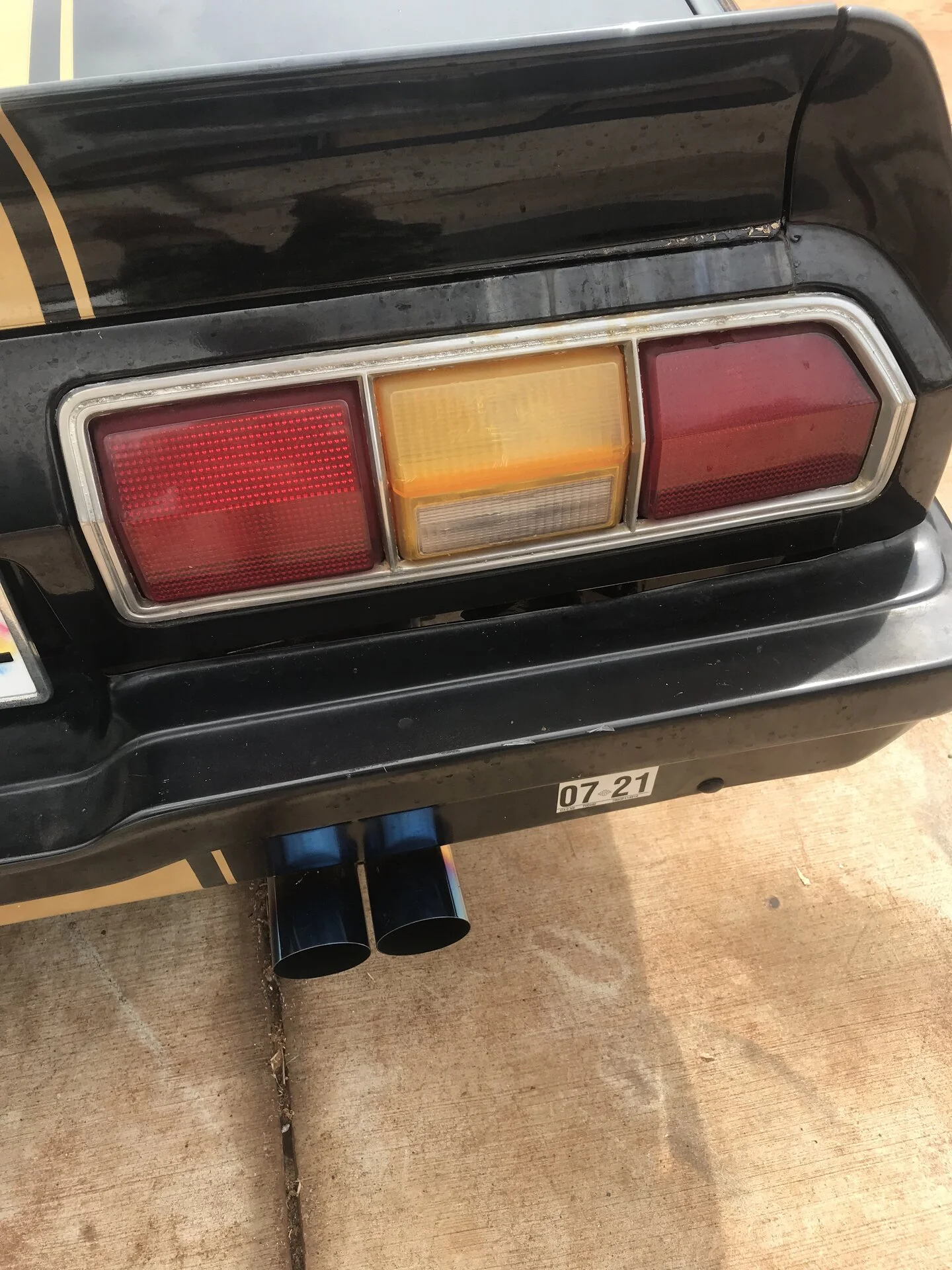

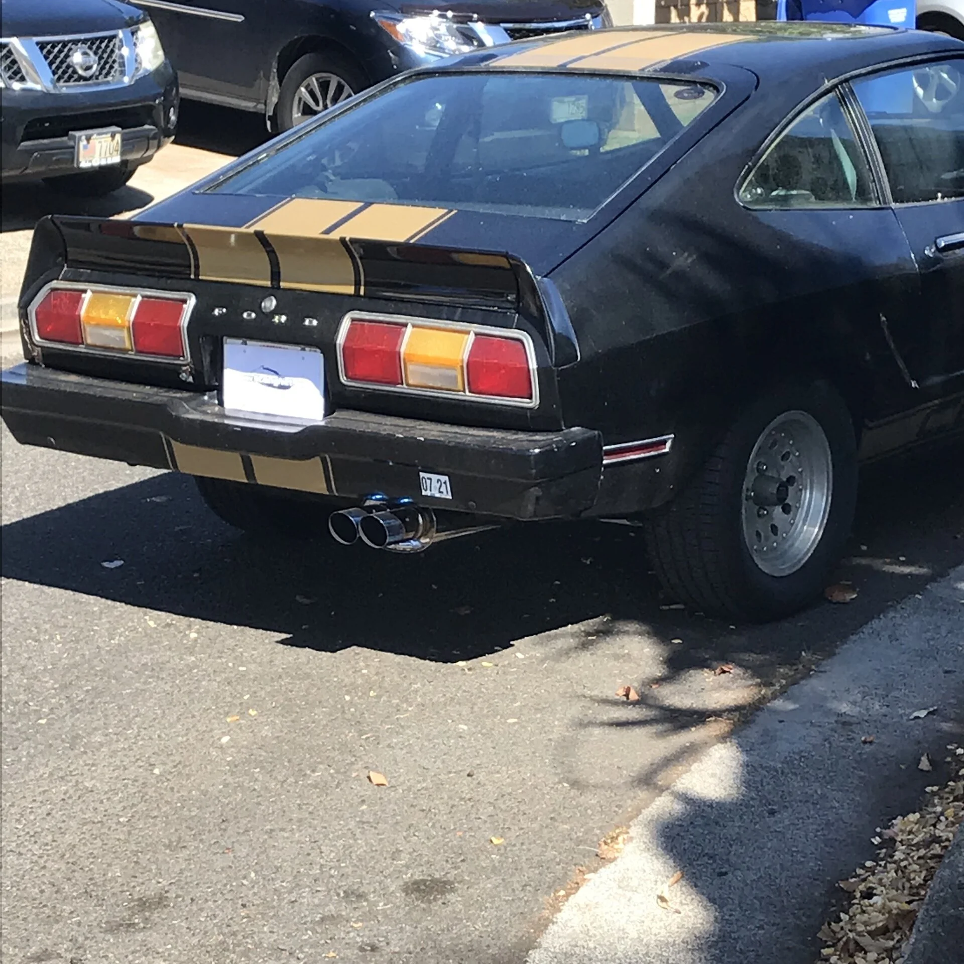

Shiny Muffler Its talking to the neighborhood these days, saying ~ vup vup vup vup VROOM! vup vup vup.
But car is covered in saw dust, its like some ones cut through a whole truck load of wood next to it. So annoying.

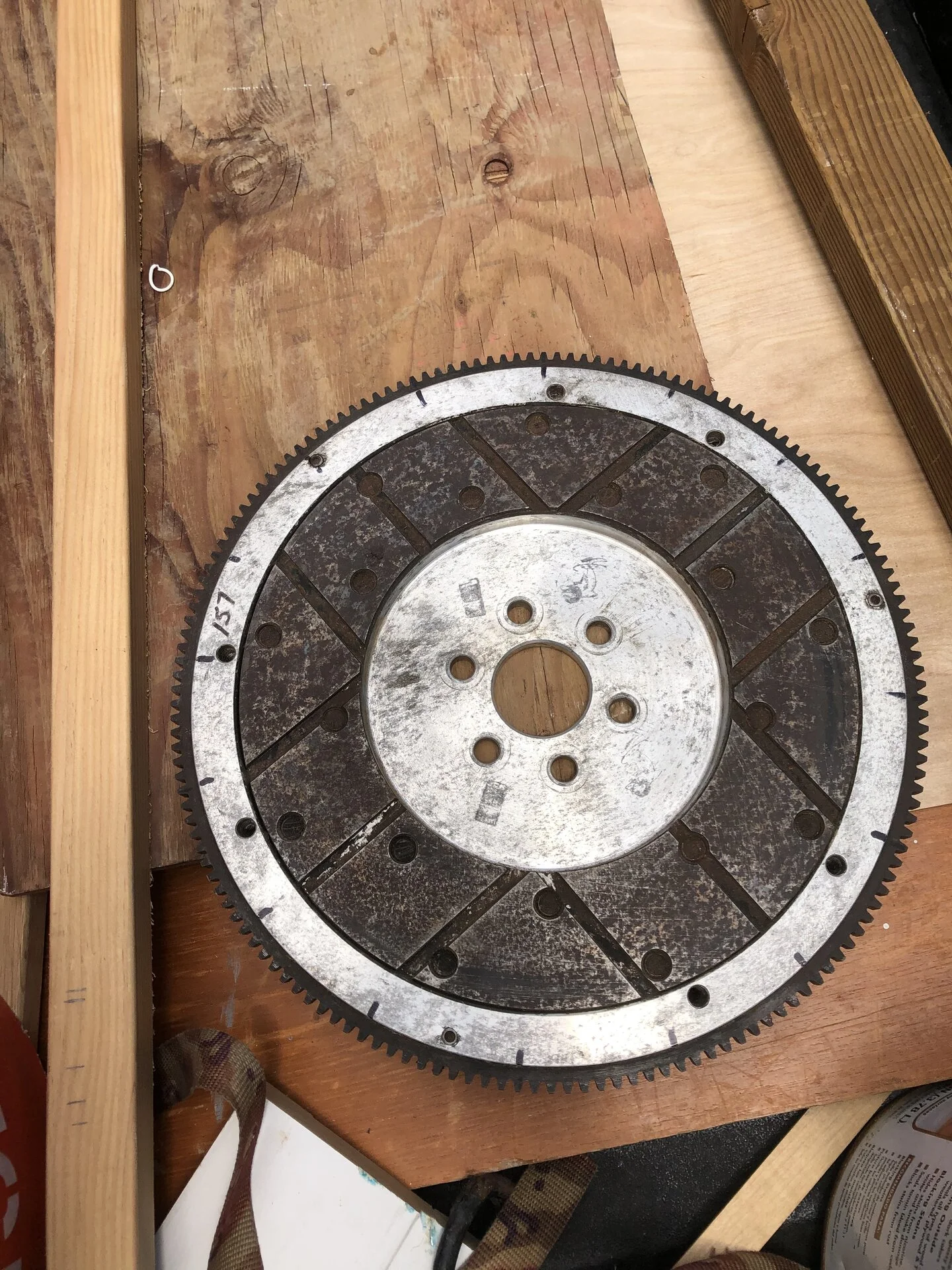

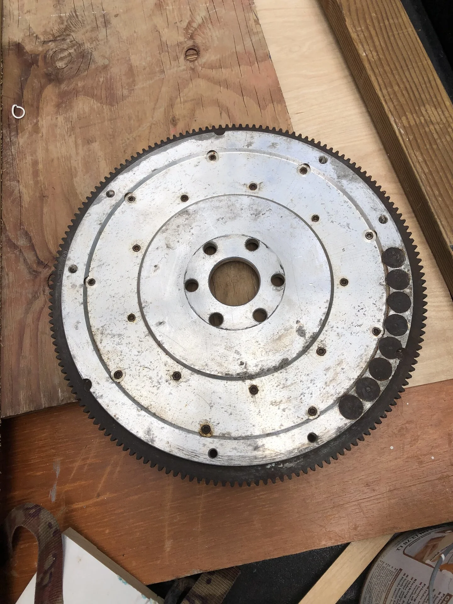

My buddy dropped of the Aluminum flywheel. What a guy! there will be a little something extra in his xmas stocking this year He likes Scotch.
I has one marking on saying " F 157" but no brand.
He got it from another mutual friend.
Both don't now nothing about its previous life, balance or anything.
Being 157 you'd think it was a 50oz balance, but seeing all the steel plugs worries me.
The guy i got it from stopped by the machine shop yesterday to see if they could shed some light on it.
They said they have no idea and were surprised by all the metal slugs in it.
So I don't know! Help!!

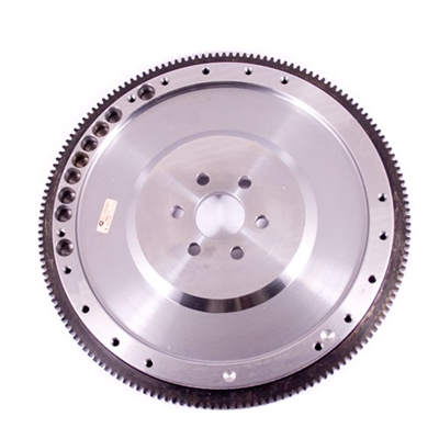

Looking for possible brands for Ford al flywheel
Hays
Ford
Fidanza
Scheifer
Ram
Centerforce
McLeod
SPEC
Ram with 28.8 imbalance weights ................Ford with 50oz imbalance weights

Would it be cost effective to have it balanced and resurfaced? Then you would know for sure the weight
I think it would have to be. There's a lot of work afterward only to find out it should have been re-balanced from the get go.

Yeah I don't think its a bolt and play item
