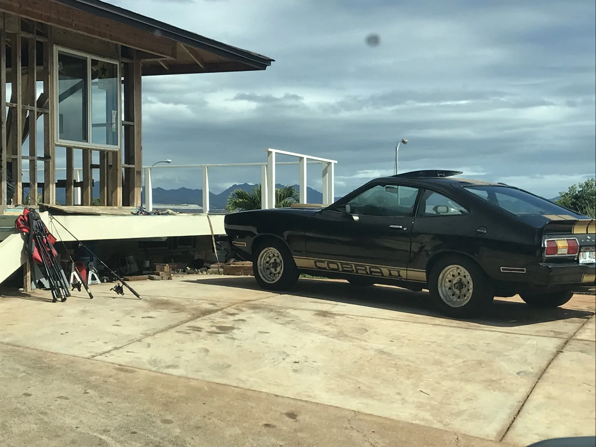

At least the sun's shining. Here's my view as of right now.

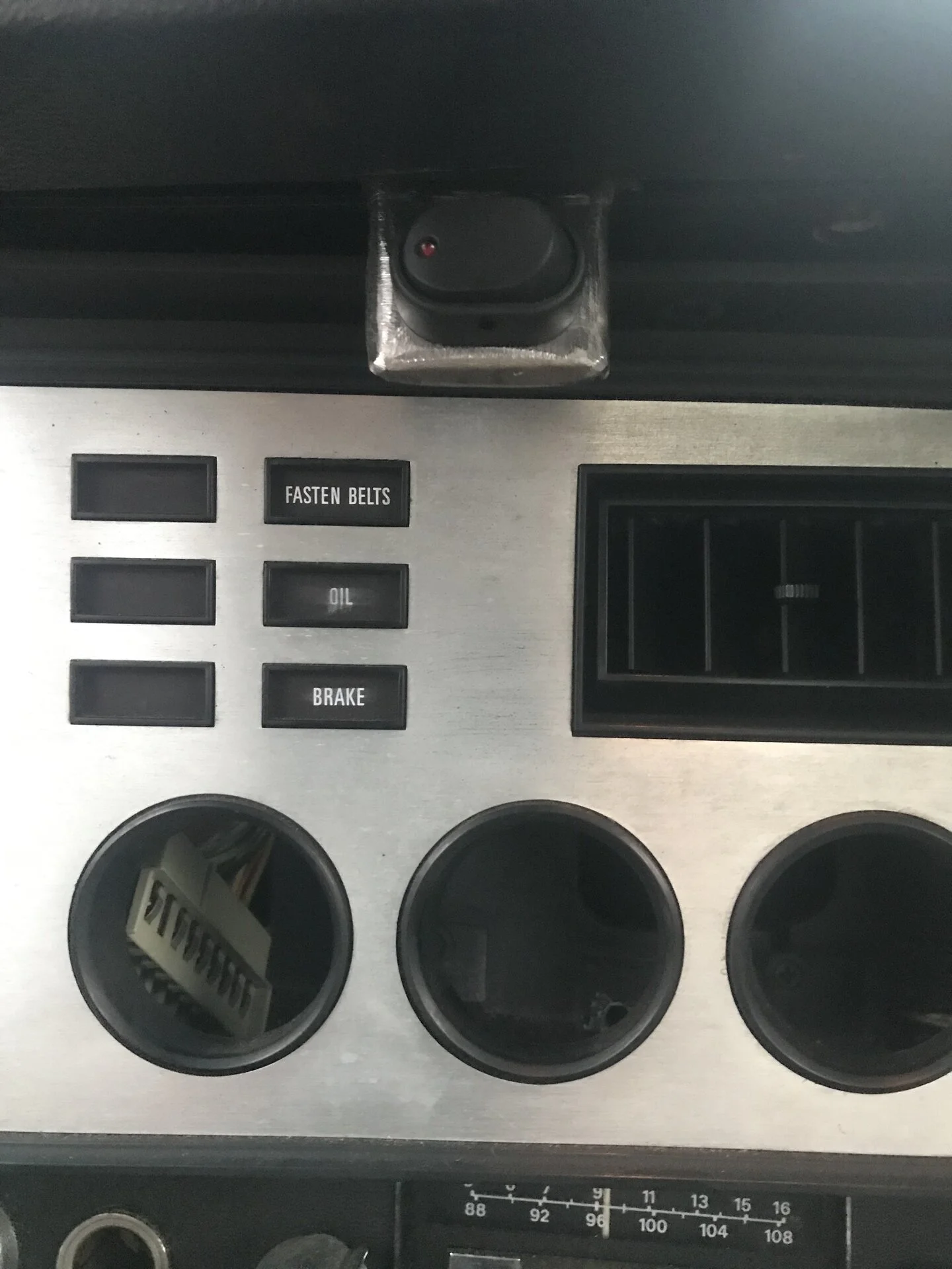

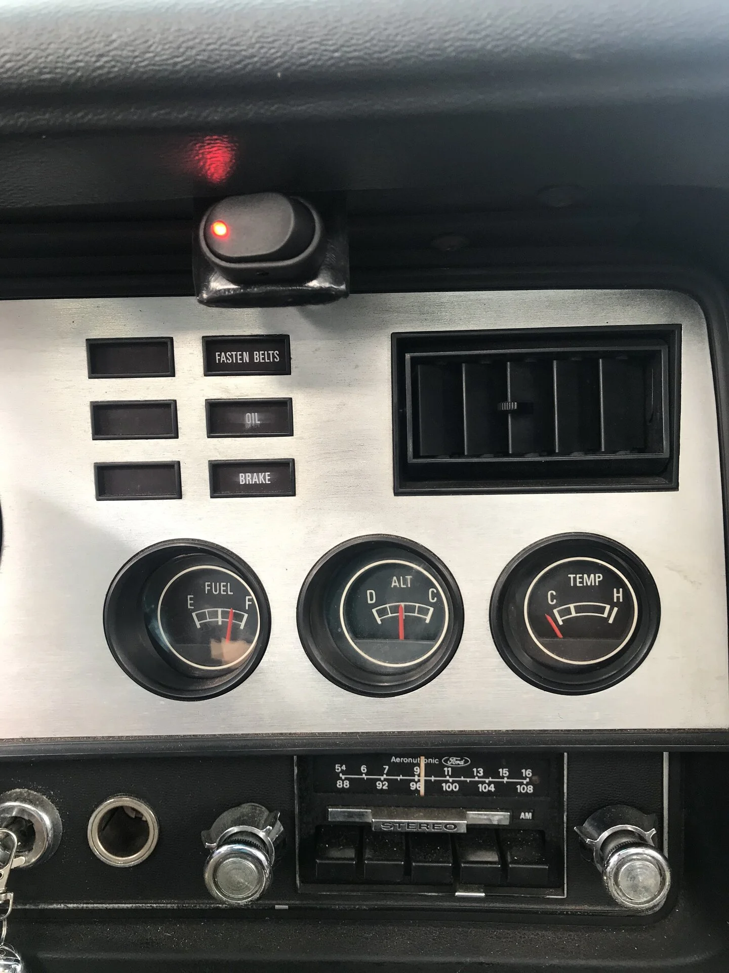

With house roof on and Solar panels reinstalled I can finally spend a moment with the Cobra .

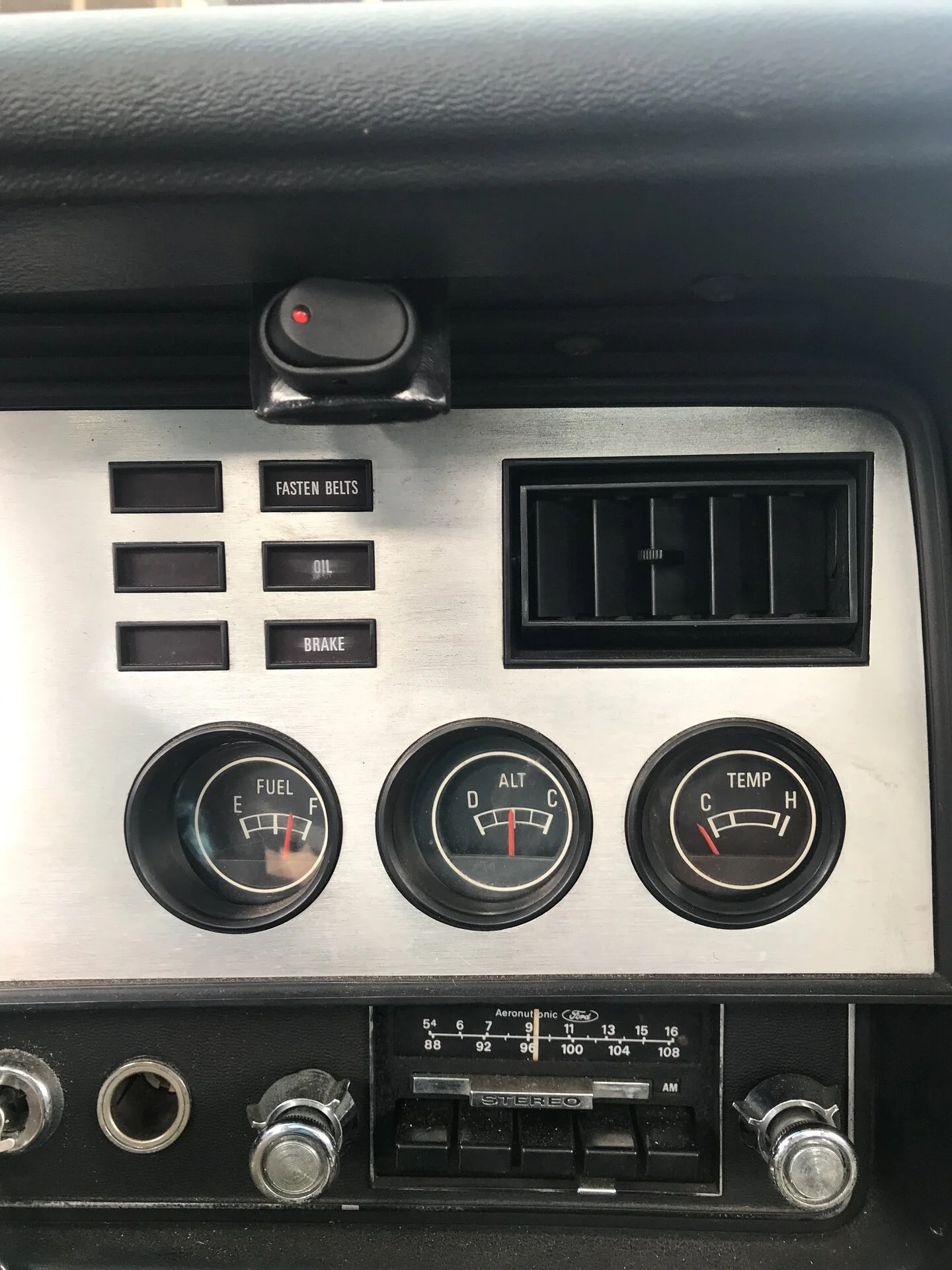

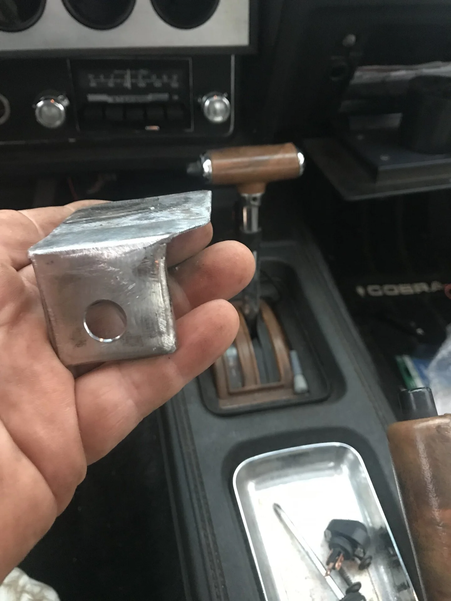

I want an arming switch for the line loc and cut out,
so no need to plug into cig lighter (you know unplug phone and all)
With a hammer and vise I made a little switch plate.
Took dash apart and it mounts with no mods to car at all.
Just sandwiches under dash pad.
Off to spray bomb it hot rod black and figure how to get wires to it without cutting car anywhere.
Gauges are out for mock up.
On!
Off!
On! ~ Off!
On,Off,On,Off,On,OffOnoffonoffon

That rust pocked faded oxidized paint looks ok from 20ft when you wash it.
Kids going fishing now.

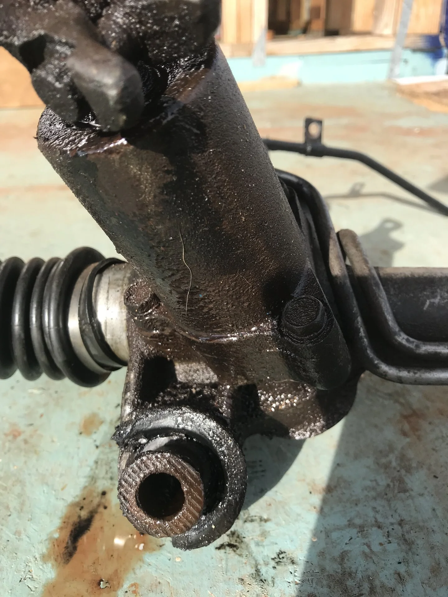

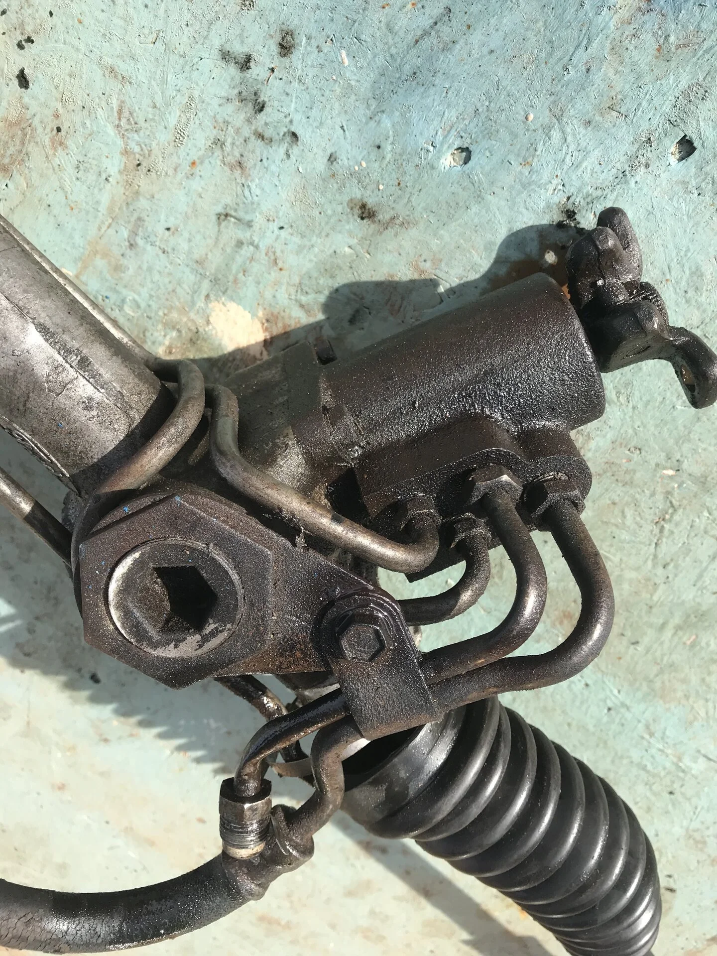

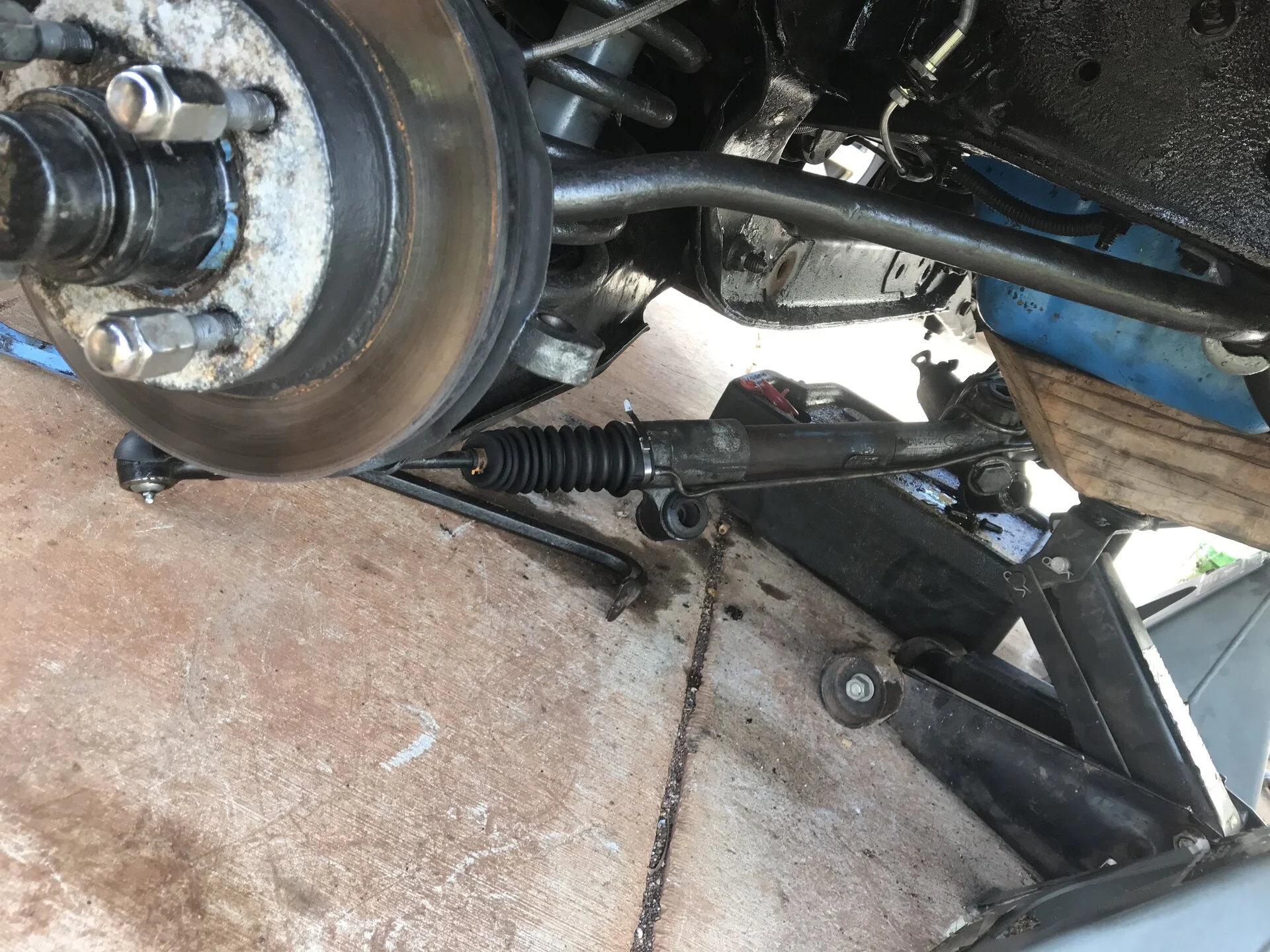

The right front still has a brake clacking sound.
After some disassembly and inspection it seems the movement / sound is in the rack itself.
You can pull the tie rod back and forth and get the movement / slop.

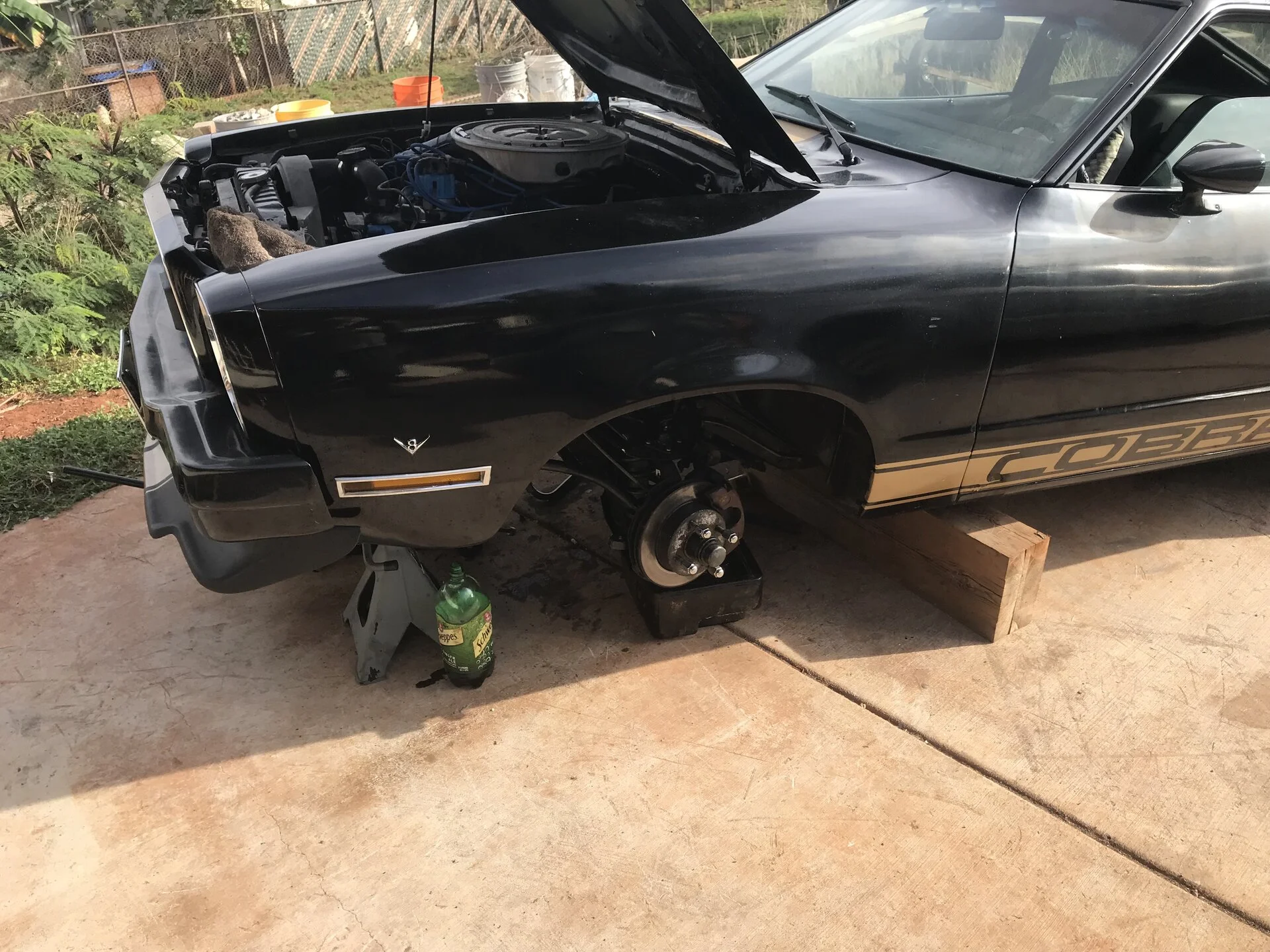

Also the instant power steering squeal every time you touch the gas or even start.
So jack em up and drain em a soda bottle.
Trying keep drive way clean.

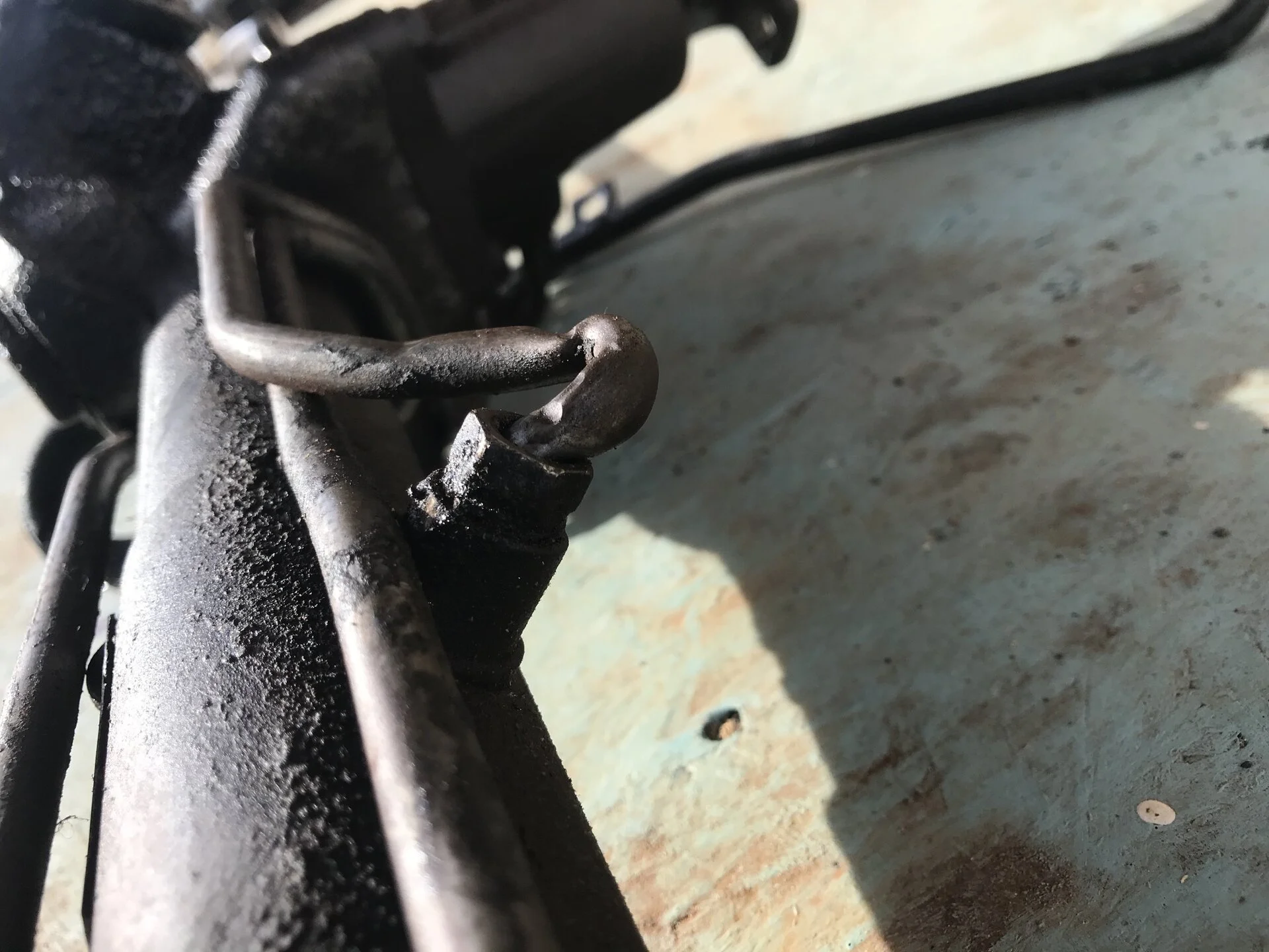

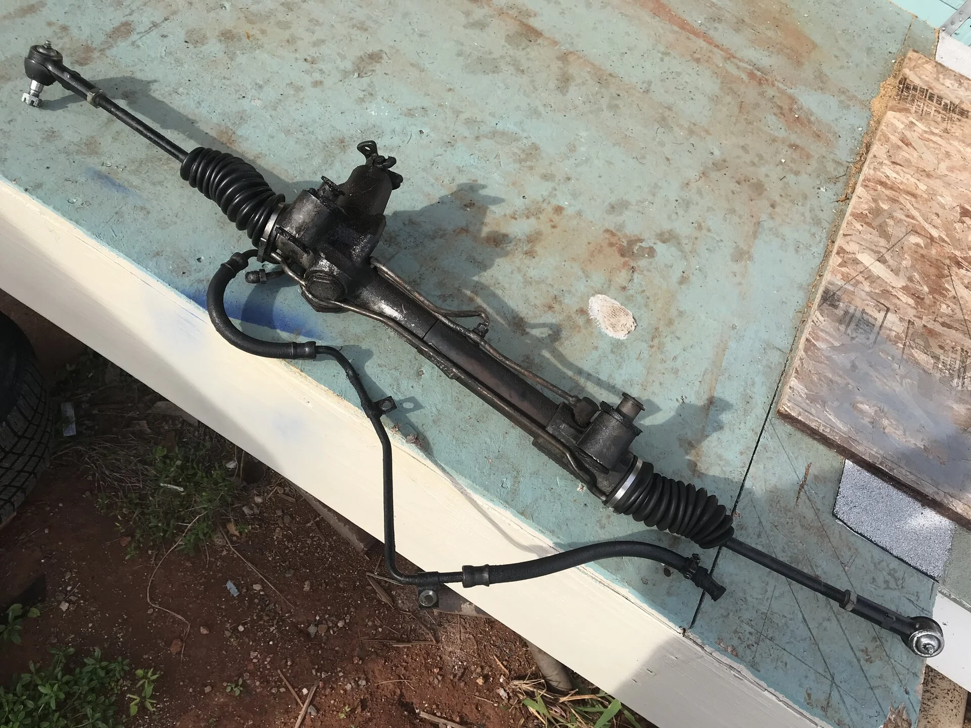

Rack comes out with out pulling oil pan but metal sleeve in bushing pulled part way out and had to jack engine to remove rack.
What evers it is out.
New tire rods, old rack.

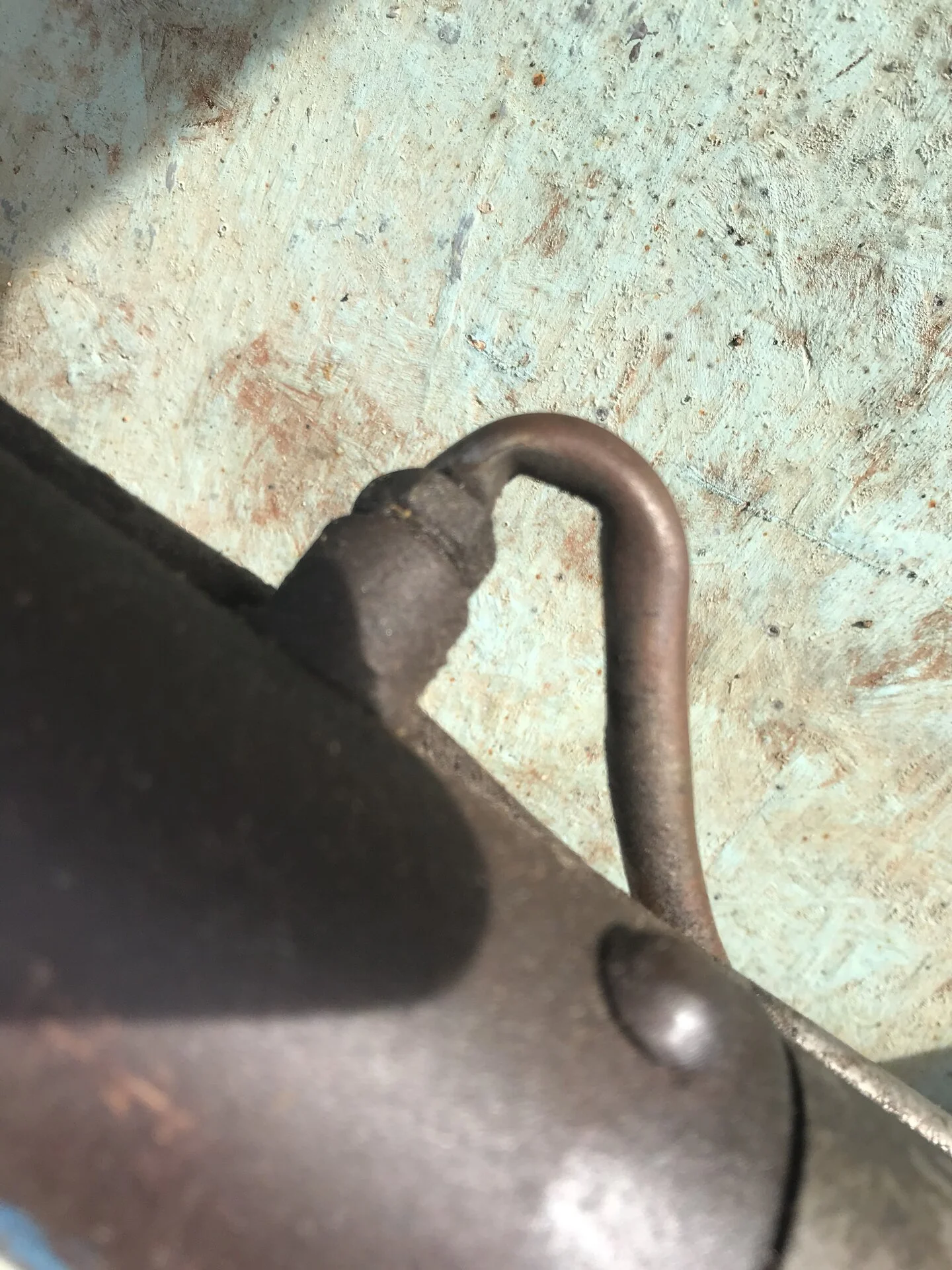

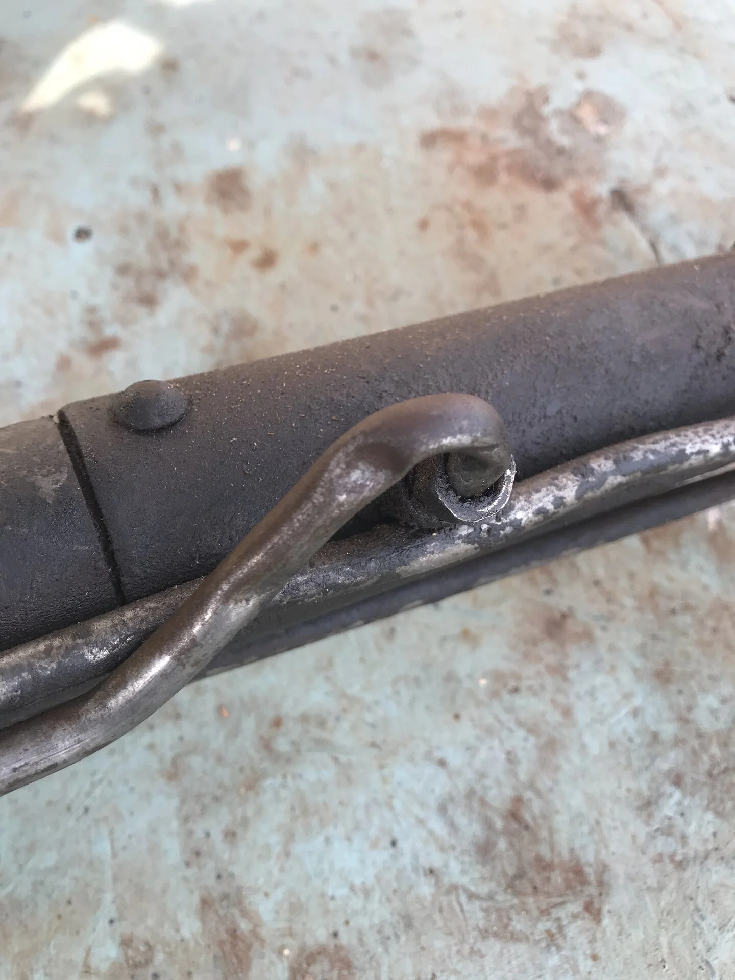

Found my perpetual leak.
Crimps and dents in tubes and they aint headers.
Bet that why the pump squeals.
That ones is flat.............................................................................................................^
Alright its a leaky squealy 44 yr old POS.
Gonna half to fix it somehow. Off to scan the internet for ways to spend money.
