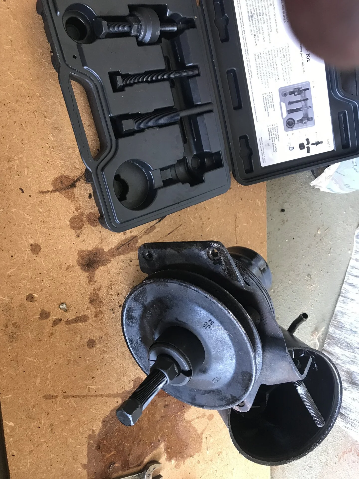

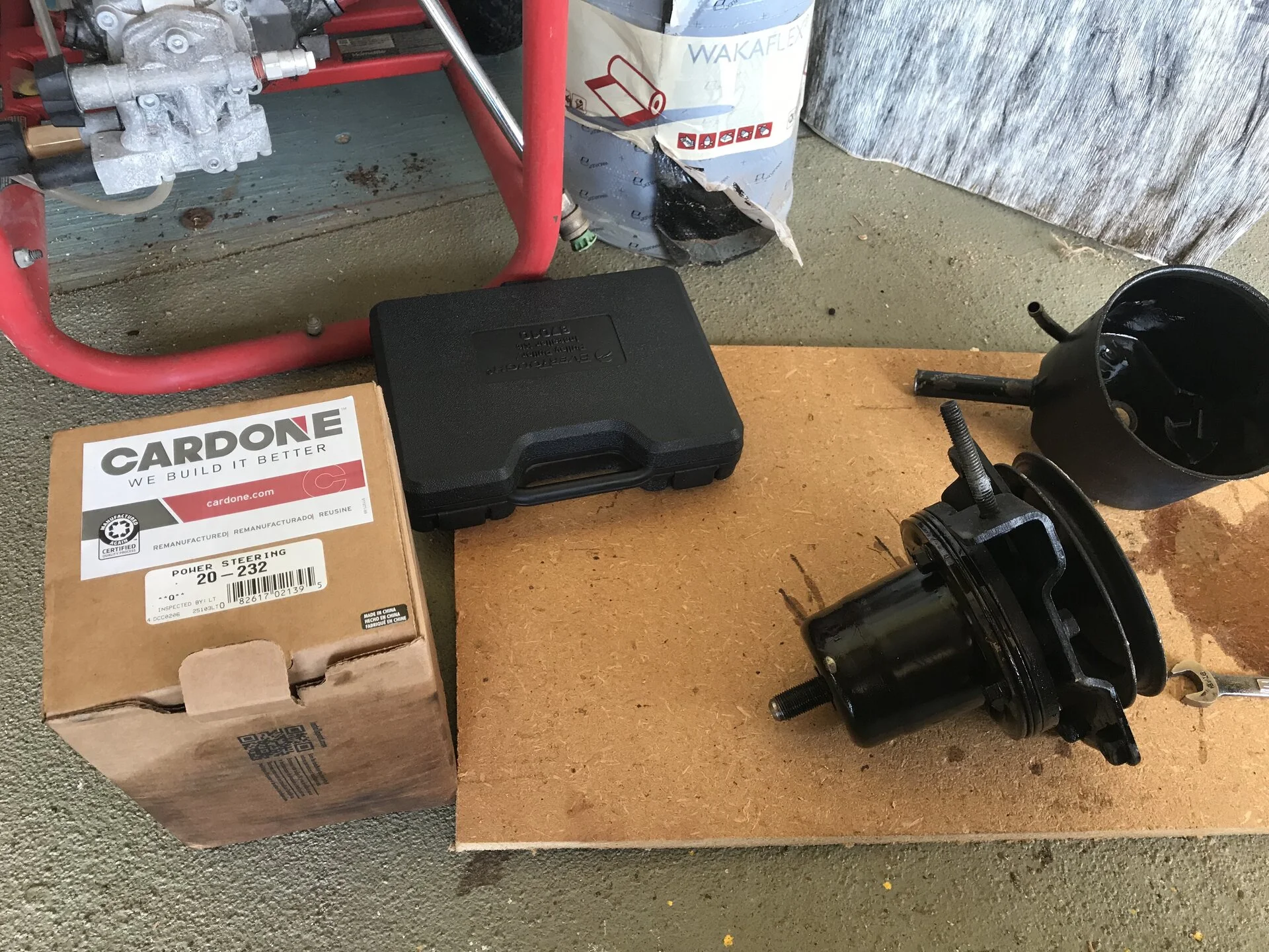

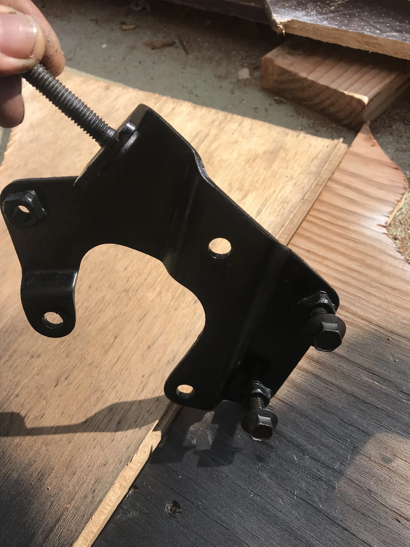

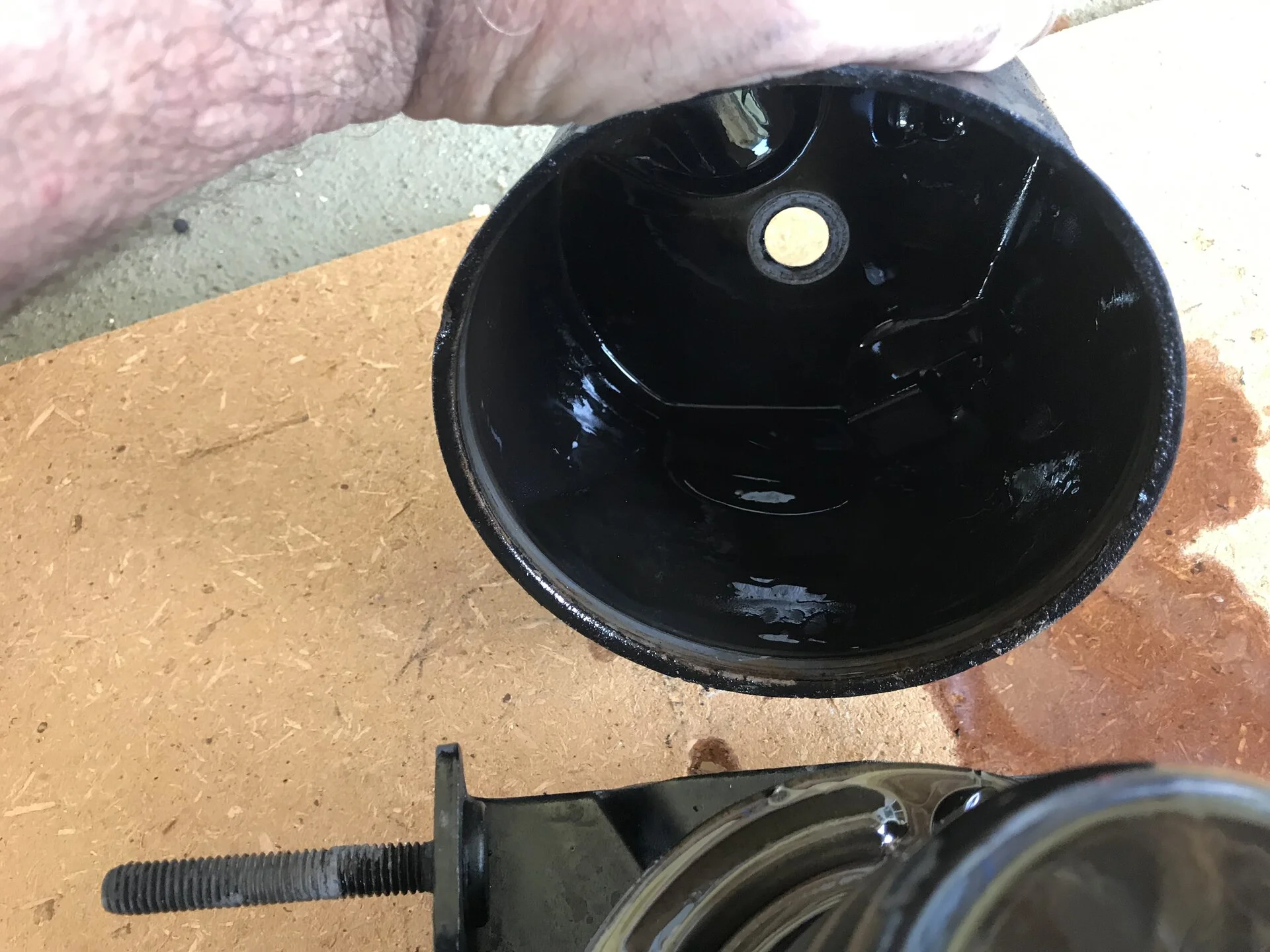

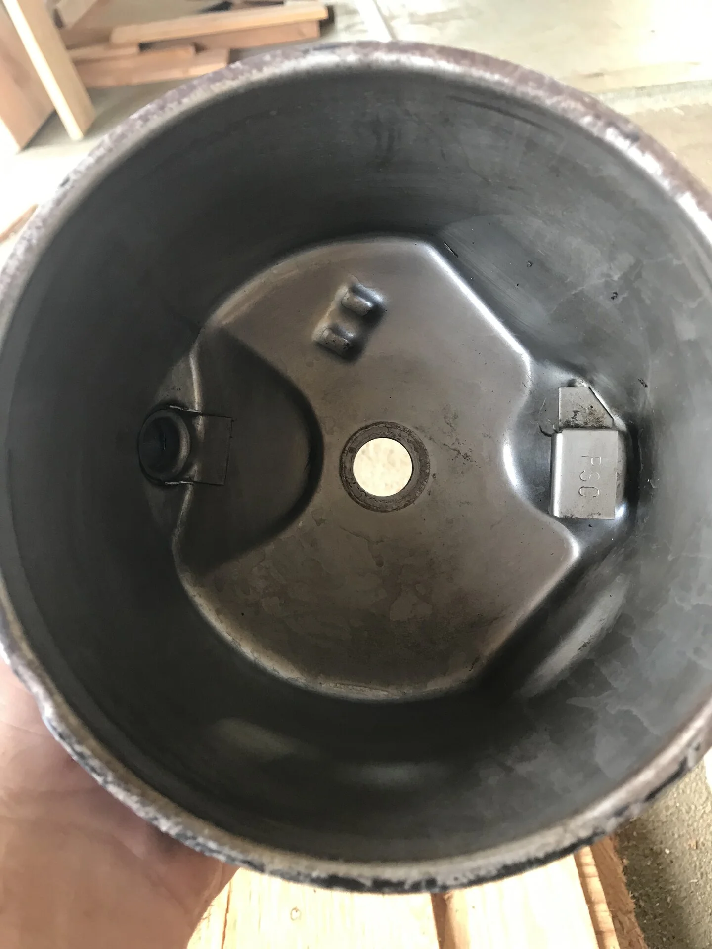

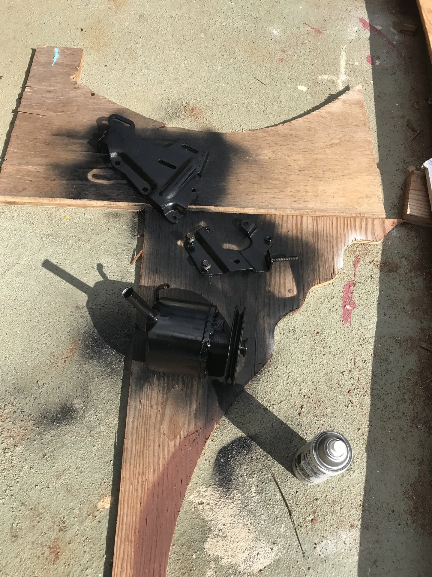

Second ordered PS pump is here!
So out of the car with the old and tear it apart.
Clean everything up good.
Housing Before + After
2Blue2
will be trying this sex one when I can find it
Mar 5, 2019
2,650
1,640
133
53
Oahu

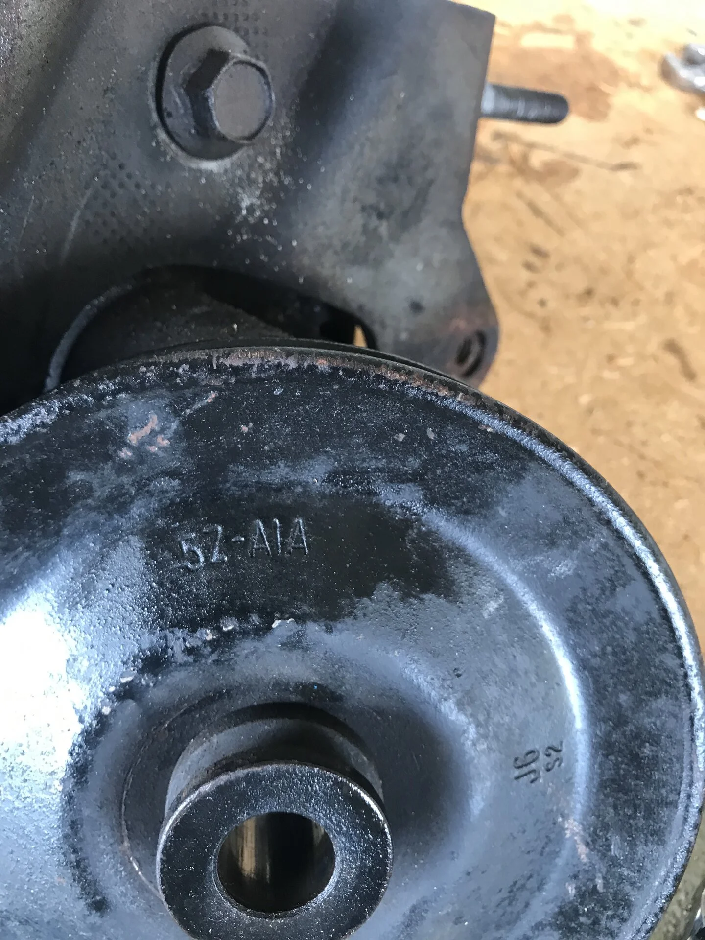

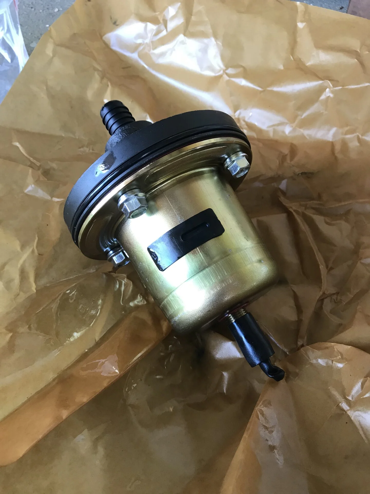

This new pump is supposed to have the 'Slipper Internals' upgrade.
Not sure what that means but it sounds good.
Old pump you can feel the notchy ratcheting semi frozen bearing when turning by hand
Best part is i get to keep the old parts number tag on the back of pump (but can't find the picture of it now.)

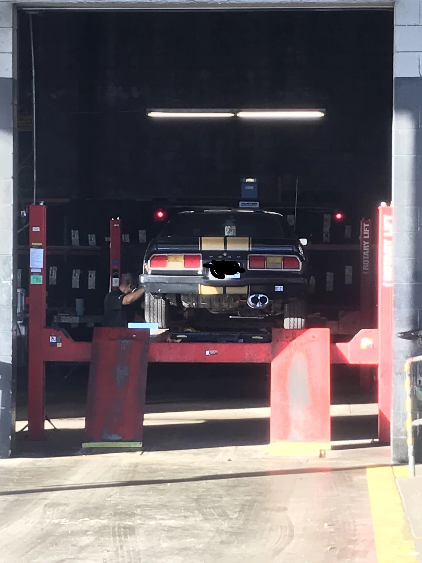

Frist drive went good
No more front passenger tire clacking at slow speeds.
Seems smooth as can be.

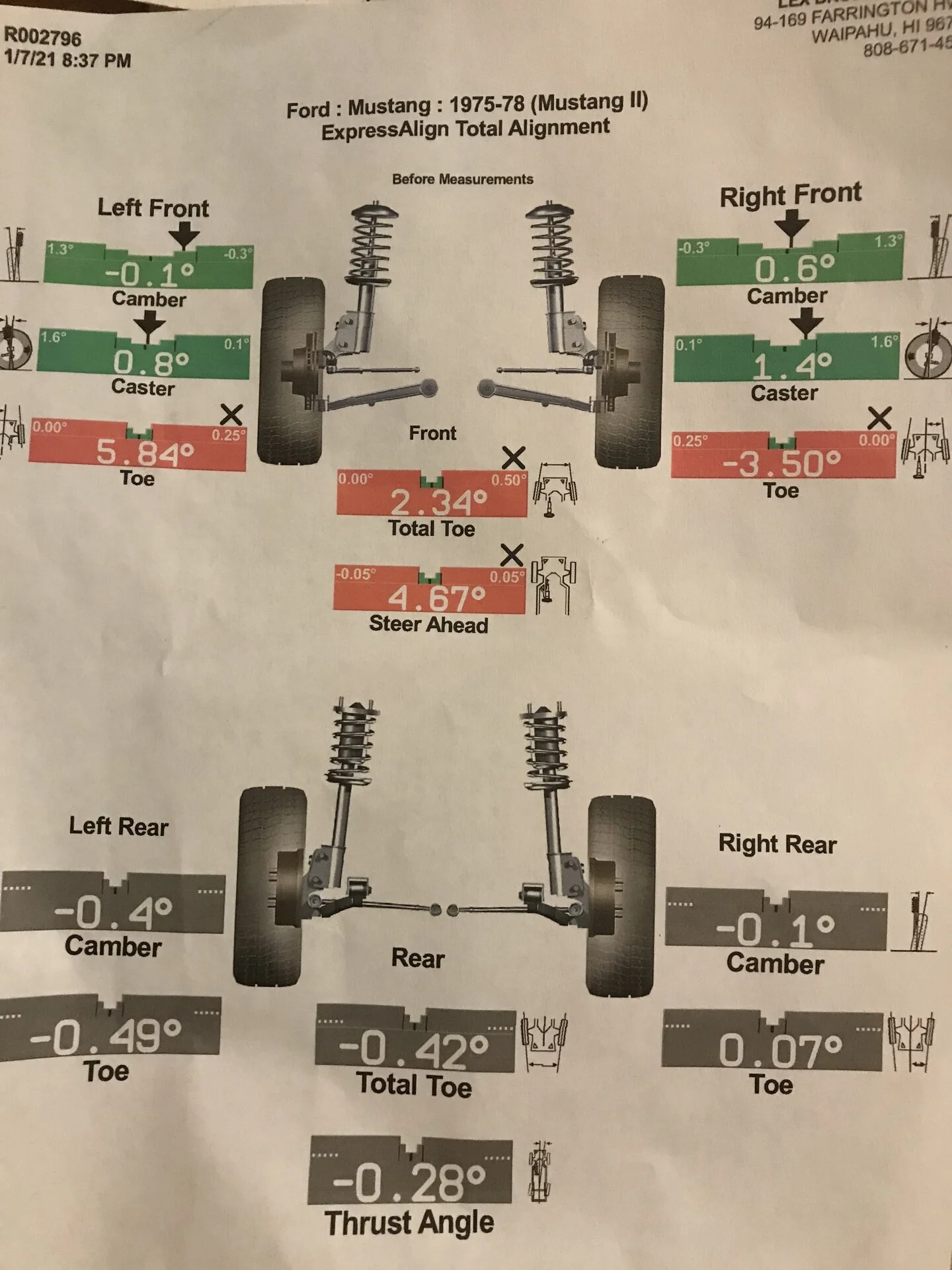

Second drive was to alignment shop.
Waiting her turn and on the Rack! Note Red Lasers( had to shoot multiple pics to get em while firing)
Alignment Tech said he couldn't align it cuze the steering wasn't centered.
He looked to be 20 yrs old. I said it should be easy toe adjustment and not to worry about steering wheel.
But he wouldn't.
So on the second trip to alignment shop, same machine different guy, he says no problem and was done in 15 min after starting.
What occurred was;
Old rack was 3.5 turns Lock to Lock,
New rack is 3 turns Lock to Lock.
It clocks the D-shaft to a different location than stock. Took it home and with a quick adjustment with the steering wheel puller, ;)
All good except now it rubs on rim at full Left lock.
Got to jack em up and grind offending metal out of the way

I'm pretty sure you could also install some limiters on the rack and you'd eliminate the problem that way. Either way will work though. :)

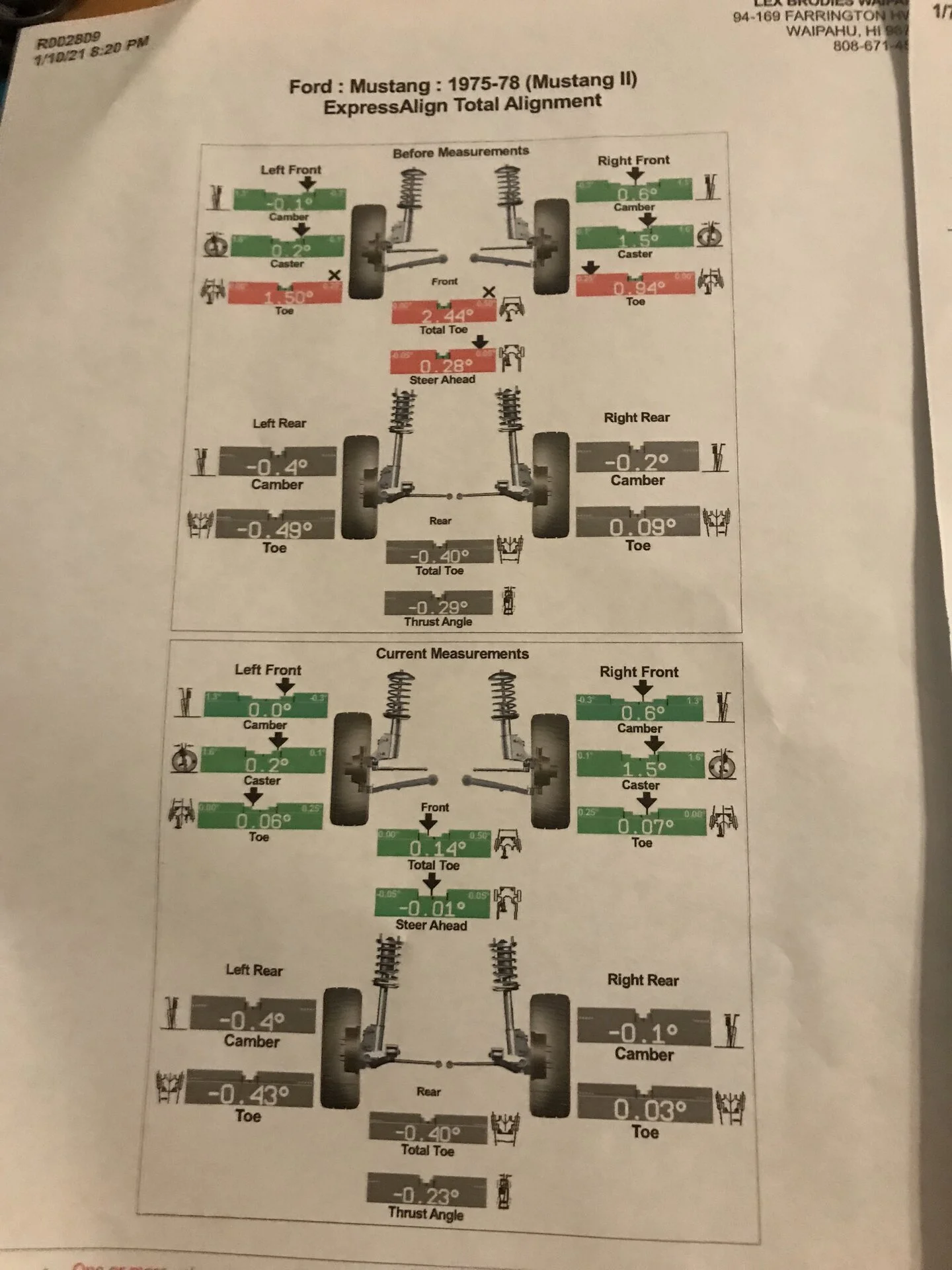

What alignment are you running on your car?
Yo Extra_Stout (Love that name)
Heres the papers from both recent trips to Alignment shop
First one don't count(before measurement only) as they didn't align it.
Second was only a toe adjustment .
Hope this helps some.
Reactions: extra_stout
extra_stout
Advanced Member
Aug 27, 2018
401
422
73
Germany
Are you happy with the handling?
I'm wondering a bit, that you have 1° difference in caster from left to right. Does the car pull to one side, when braking?
What is good on your setup, is that you are near zero regarding camber. I checked the shop manual and it says that camber should be more like 1° positive. Not sure why, but it seems that this is related to the tires that where use back than. My research (and experience on my 66 coupe) is that more like -0.5° to -1° camber is suitable for modern tires, if handling is more important than wear.
I found a post from Alcino (seems he knows what he is doing), where he says he is running -1.5° camber and +4° caster.
I want to do the alignment in the next days/weeks and I'm not 100% sure what I want to setup initial.
At the moment the left front tire has -1° camber and it looks nice. So I think at the moment I will target for -1° camber and +3° of caster.
If any one has ideas to that, please let me know :)
Haven't really had a chance to wring it out yet.
I think that will be a fine place to start.
Caster +3* to +7*
Camber -1.5*
Toe 1/8 in
These are pretty standard suggestions for hot rod settings, but depends on suspension type, use, etc.

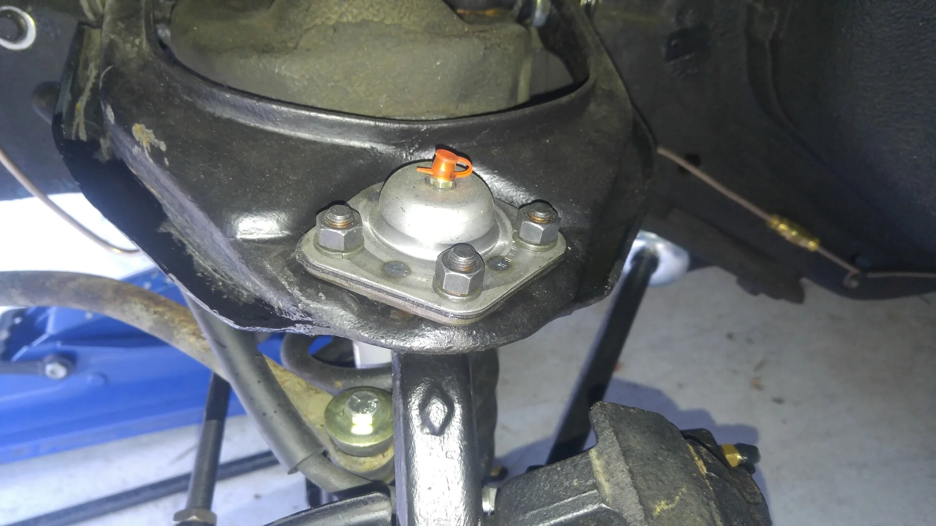

What is rubbing on the rim?
Hey buddy, like this.
Drivers side control arm front edge.
Wheel rubbed a spot...........................................................Ground square corner to a taper and masked it up for spray paint.
Hope it is enough to solve problem.

Didn't we do this once already?
Guess I didn't do both sides...
Ready for a real test drive but its raining now.

I cut the whole front edge, but I'm planing to run more caster than you (and I have a diffrent backspacing I guess):
