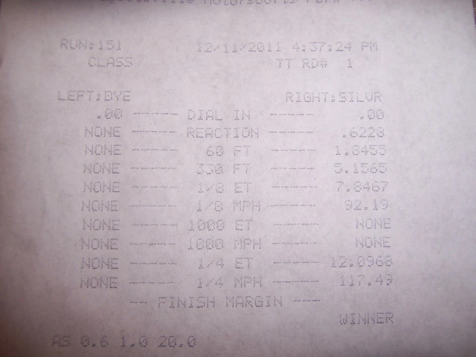

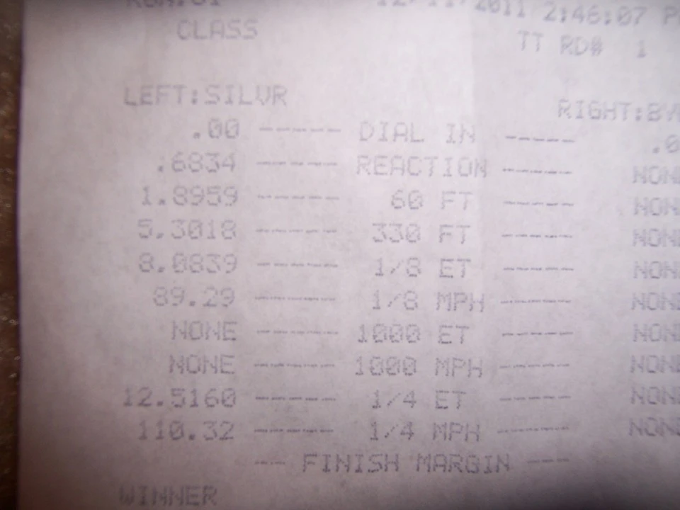

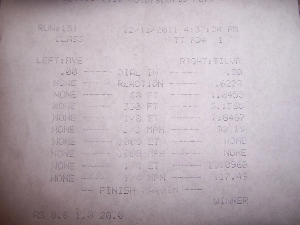

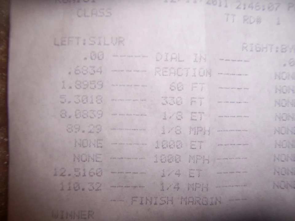

It shows on some setups. You gained 80 rwhp; Winters has showed nice gains on his Vette; I know others that have as well. But it simply does not show on some setups. I just went and looked at my dyno graph from when it was tuned; I gained 13 rwhp and 0 rwtq on the methanol. However, on the same tune, same car, same weight, same track, same time, same EVERYTHING except the flip of a switch, here is what my car did:
No methanol:
With methanol:
Yes, that's a full 7 mph and .4 second difference. 13 rwhp my ass.
We did some tweaking on the tune (added timing in down low) to get it to come out of the hole stronger, and picked up another .15 seconds and 1 mph a week later.
Couldn't agree more on comparing different cars on different dynos. Apples to oranges.
Also agree on running more boost, but only if he actually is cooling the temps down. I'm spraying 14 GPH methanol on 8 pounds of boost, which cools it down perfectly, but most people don't/won't spray that much (for whatever reasoning).
