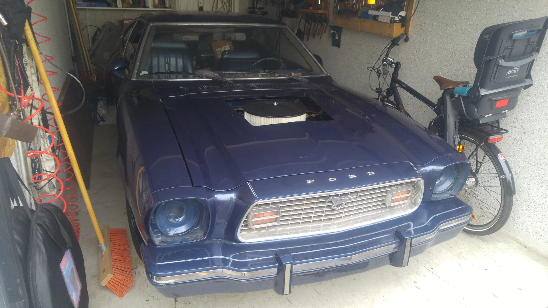

Together with my wife I did get the initial ignition timing setup somewhere around 10° BTDC. Now it runs quite good. It idles at around 750 RPM (around 1000RPM with a 6 cylinder tacho), starts when warm. Cold start idle RPM still needs to be setup.
MY CAR IS NOW ABLE TO MOVE OUTSIDE THE GARAGE BY ITS OWN!!! And reverse works, too. Clutch feeling couldn't be better. That is a big win!
The heater core is leaking and the carpet was wet (and you see water under the car in the video), so I utilize the new ability of my car and removed the seats and carpet outside of the garage (small garage).
Power steering works too without leaking, but feels flimsy. But the tires are completely new and the garage ground is slippery, so let's see how she feels, when I'm on the road. But with some wear on the tires and smaller steering wheel it feels perhaps alright.
The fuel pump relay works too (only when the engine is running, the fuel pump runs too).
And as you can here in the second video the e-fan also works.
Quite successful, even when the heater core is leaking. I leave it perhaps disconnected. Does someone has experience with good quality replacement heater cores?

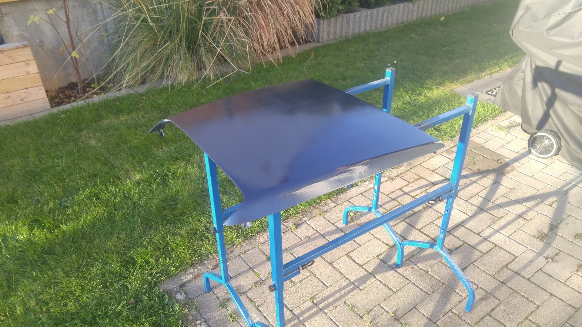

I was off work yesterday. It took the whole day to get the hood measured/marked and cut for the hood scoop.
Today I polished to hood and prepped the scoop for painting. Tomorrow it will be around 55°F and sunny, so I should be able to get the scoop painted.
Perhaps the scoop will be bolted to the hood and the hood bolted to the car again on the weekend...

The scoop needs to be wet sanded and polished. But I will wait till next week, till I start this. The hood is back on. Carpet and heater arrived last week, this will be the task for Wednesday. Thereby that I'm off work every Wednesday till Christmas, I hope to get most of the interior back into the car and the scoop done till end of the year.

Wet sanding and polishing wasn't a success at the scoop. The color doesn't mach perfect and at the hood it is more than noticeable. So the scoop will be painted black, when the weather is getting warm again. No problem for me, because I like black scoops on blue cars. Will look perfect when the black decals for more HP will be added also :jester:
