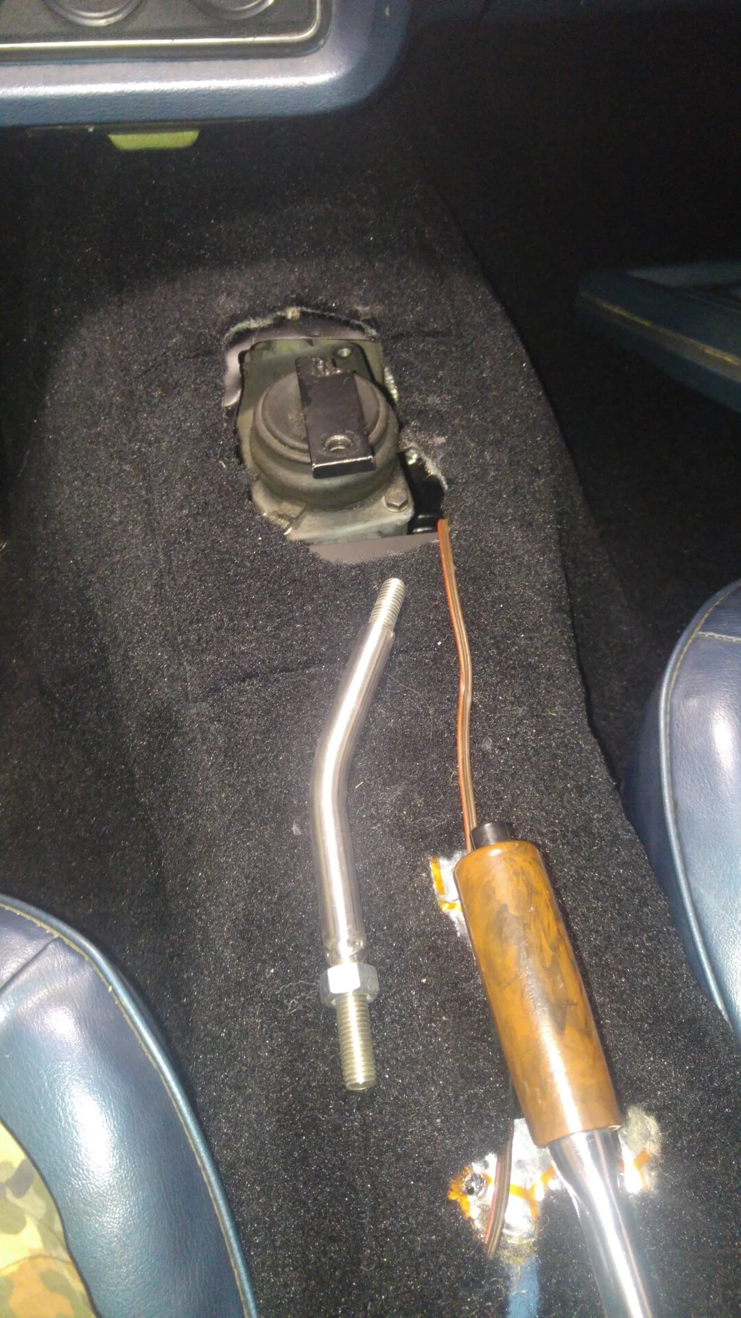

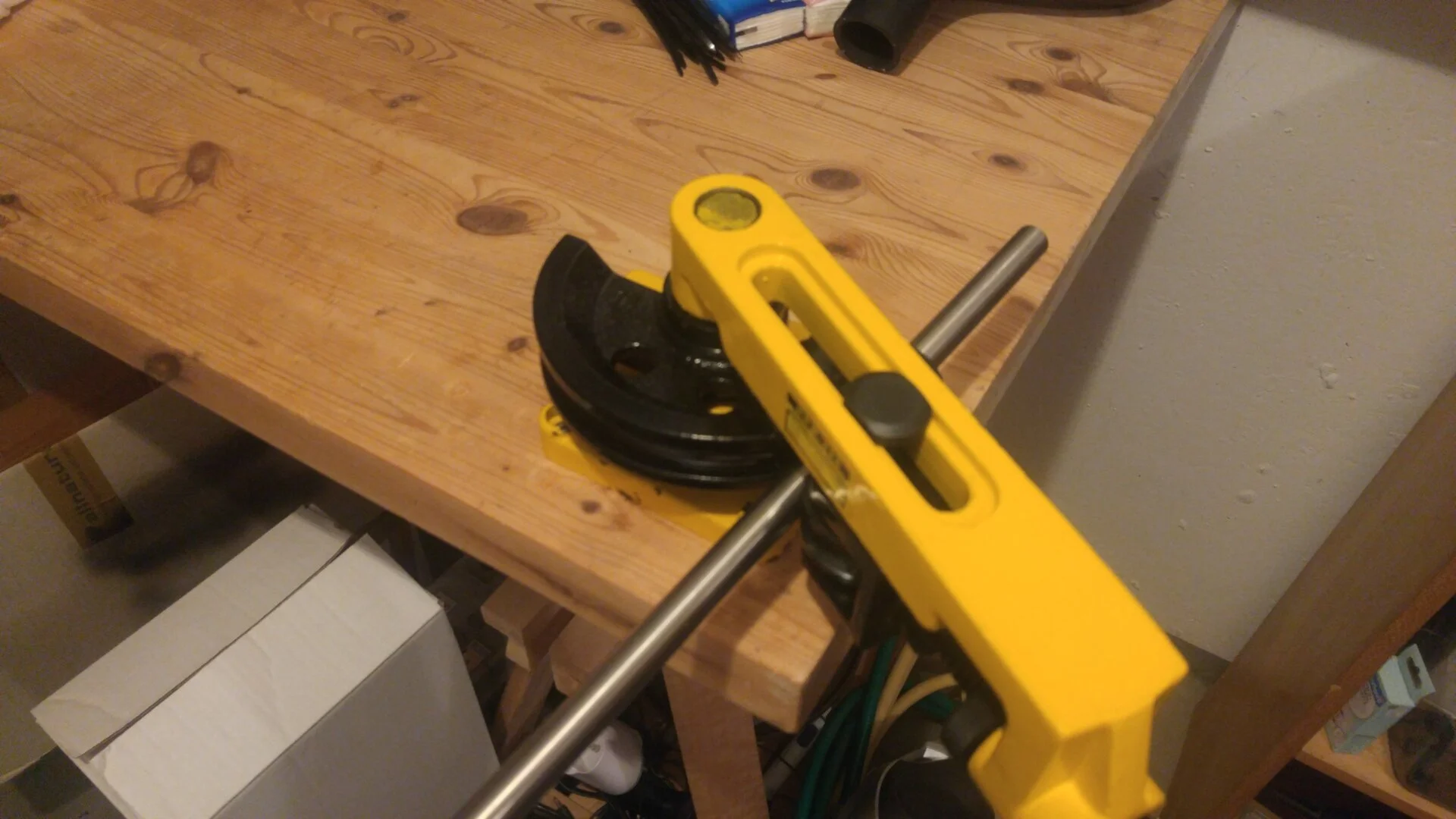

Bought a manual pipe bender, which looks quit okay for the price I paid:
Did the job of bending my shifter stick:

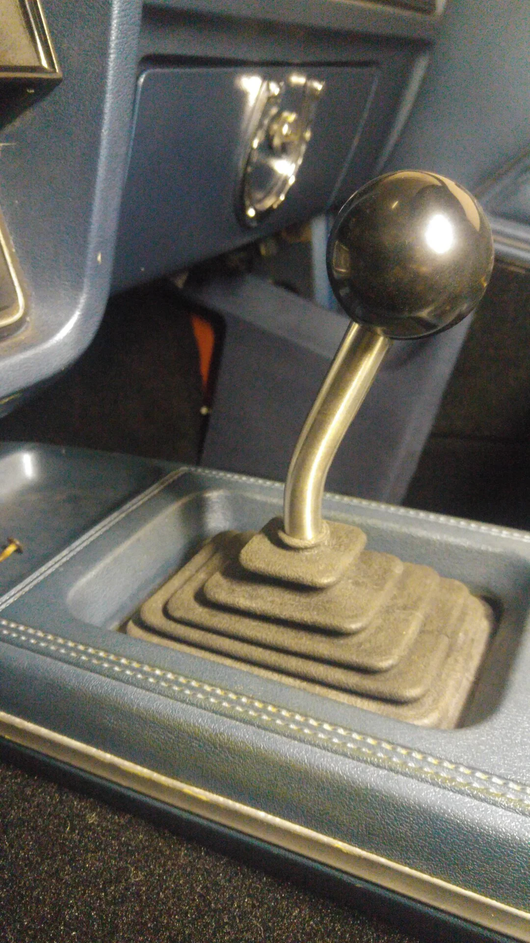

And here is my shifter with console installed. Could be stock... quit happy with the result of using a 66 mustang shifter boot and welding a extension to the stock T5 shifter to compensate the different transmission position.
The black ball is a standard part DIN 319 (here in Germany), very cheap. Can't understand why paying the price of a aftermarket shifter ball, if you can get it in an tractor supply for 3€.
Pipe bender and SS pipe was cheaper than a shiny hurst shifter stick. Beside it wouldn't fit my extension.
Used the same method for my 66 coupe, but at the bottom I made the pipe flat and drilled it for the stock T5 shifter.

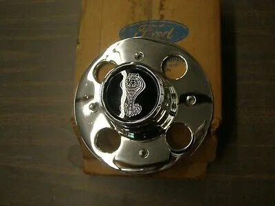

Goofy '78 wheel center snake was the main change before going back to the one we know I think.

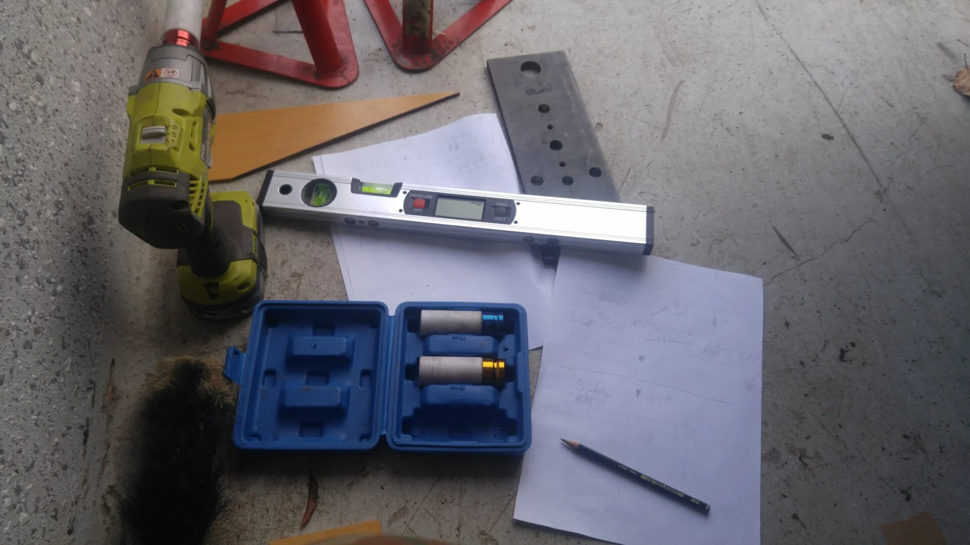

I did the alignment of the front suspension backyard-style:
Right side was (that was a good guess, when putting together):
-1° chamber and +2,5° caster
Left side was:
0° chamber and +3,5° caster
I adjusted the left side to (at the first go):
-1° chamber and +3,0° caster
I need to set toe-in, but therefore I need a helping hand. I do it with a measuring tape. With the semi-sicks it is easy, because they have one deep groove in the middle, where you can put the measuring tape easily.

Just a heads up, with a rack-and-pinion front end, getting your camber and toe set will usually put your caster within spec.

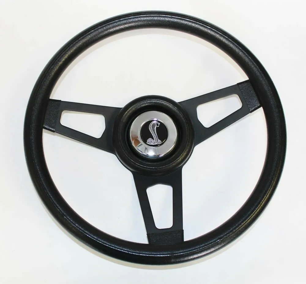

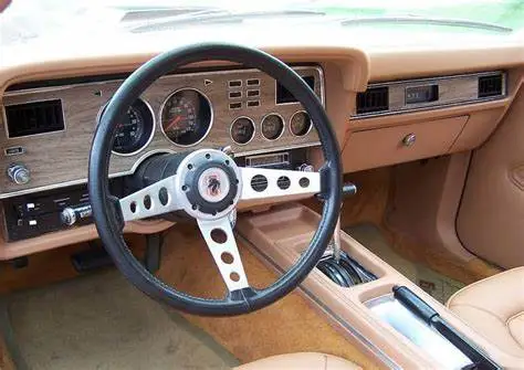

Steering wheel is nice. The horn button mechanism looks a bit wobbly, but I think it will be alright, when installed. Now I want to install the steering wheel, to see how it looks, even when I need to change it back again. Also I want to know if everything fits.

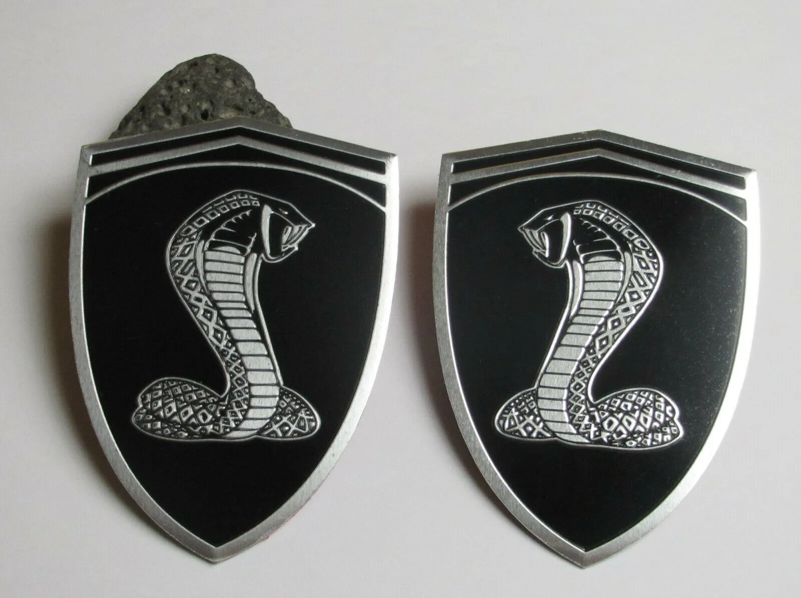

Fender badges are also nice. In between I thought I should have ordered more original snakes like you can buy for the fox mustangs, but it is obvious (to mustang guys) that the car is not a original cobra and I like the style of the emblems with the black background (wheel be awesome, when the scoop is also black).
