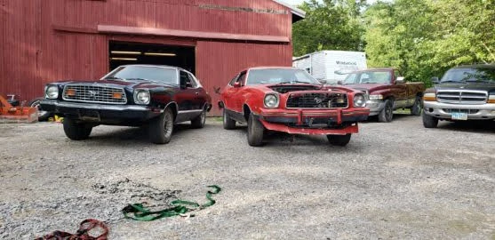

The bracket bolts to the underside of the bumper. Sorry this is the only pic I have that shows them still on.
