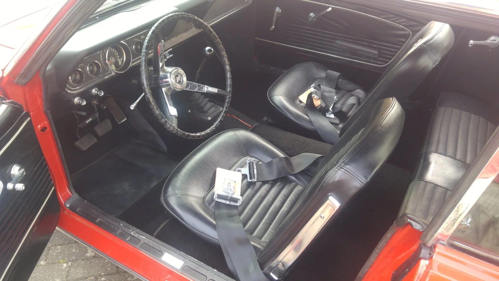

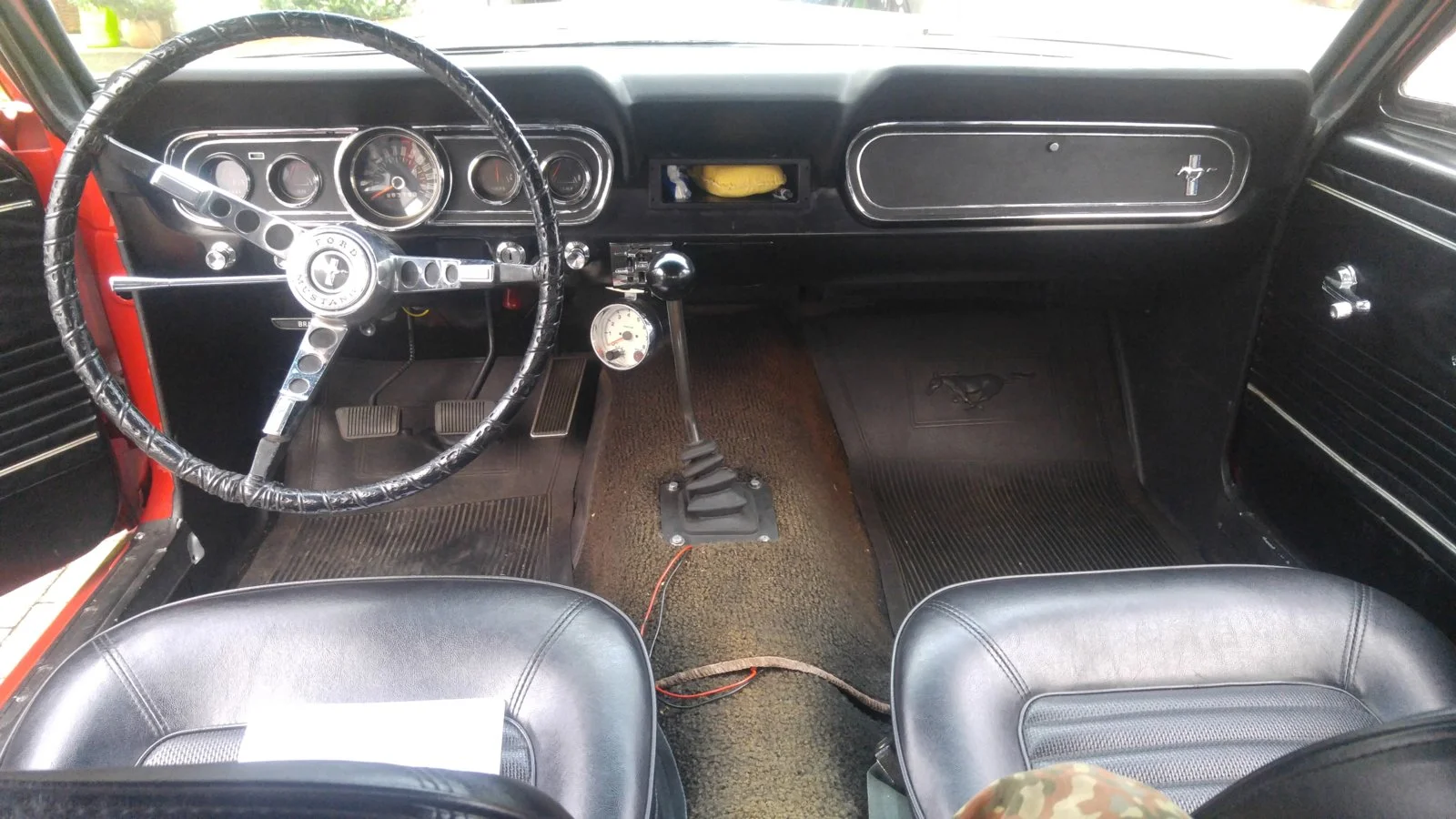

I recolored the carpet of my 66 mustang. It's the original carpet (it was black!) that I cleaned with vacuum cleaner and used carpet spray can that was "brushed in" with a 120mm wide paint brush. Worked great. Had to make 4-5 layers color onto the drive shaft tunnel, but now it looks well. Especially with new saftey belts :cool:
