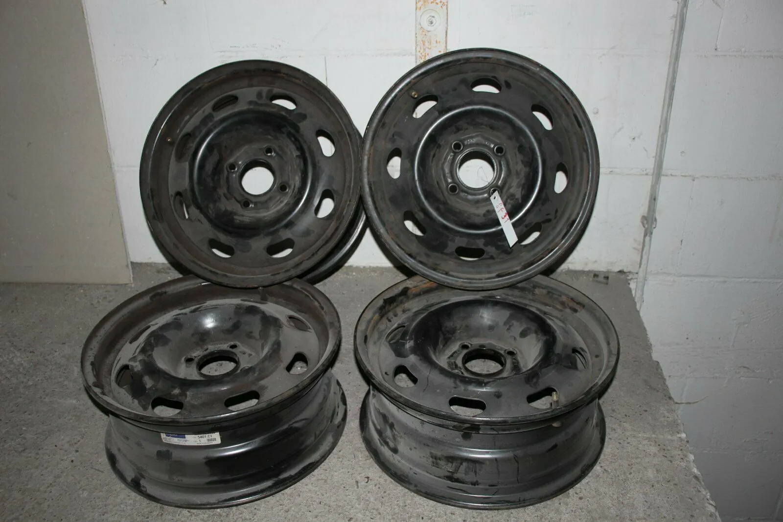

bye bye minilites, welcome black steel wheels from a random french car.
The advantage: I save a lot of money.

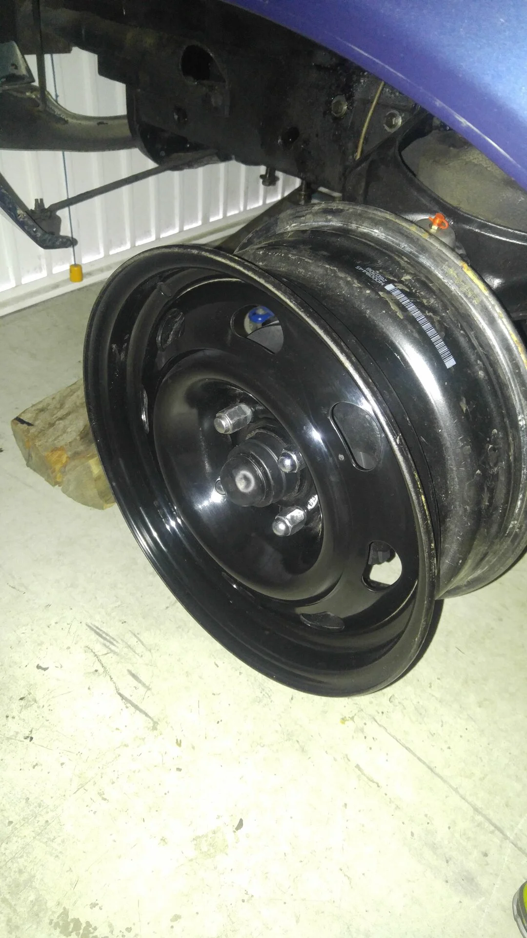

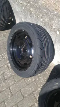

I picked up the steel wheels yesterday. They fit very good, though a bit less backspacing would look nicer. But I'm happy with the D-shaped holes.

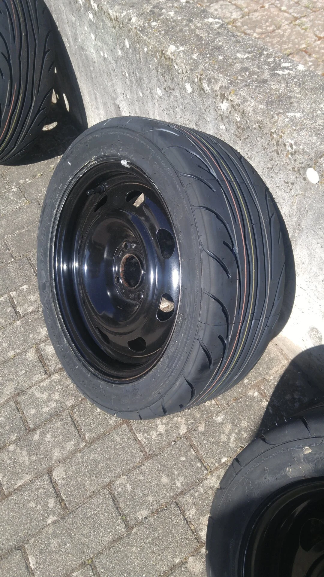

I ordered also some sporty tires :rock:

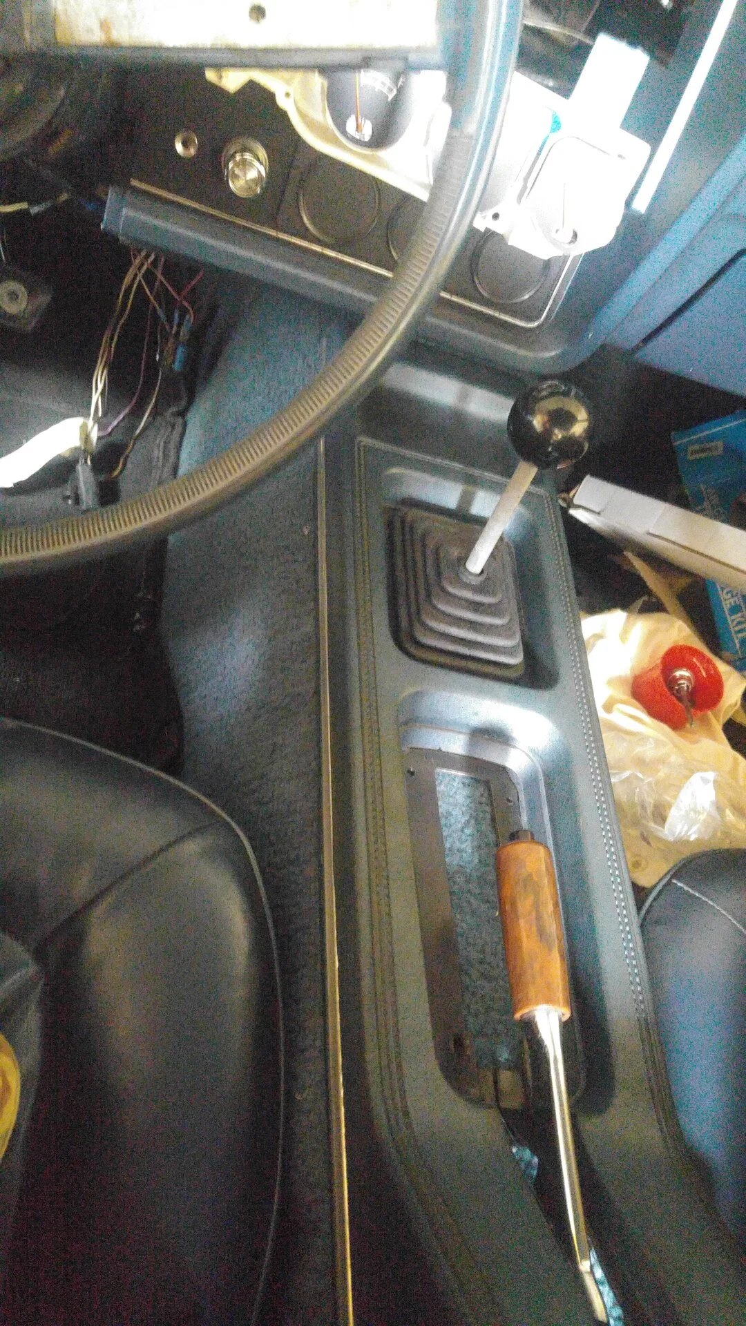

And I fiddled succesfully with the console and the shifter boot of a 66 mustang. The console is now in stock position again and I cut and welded an lever to the T5 shifter to get the shifter rod in the right place. The threaded rod will be replaced by a stainless steel pipe later on with a bend to get the shifter knob 2-3 inches backwards. When I have it all apart again I will make more pictures.
Ordering the tires was a complete disaster, but now I have a semi-slicks (for a semi-daily driver; i hope you get it).

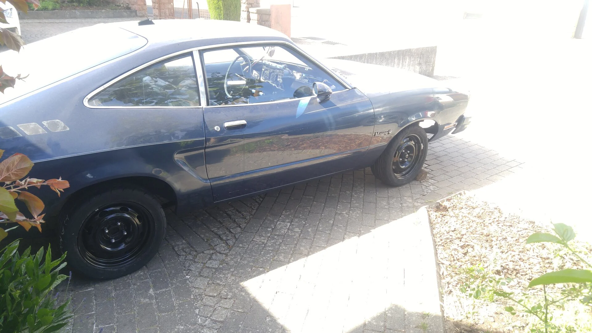

I like the low tire height on the 15'' wheels. If I would use 20mm spacers on all 4 corners, it would look perfect. Also lowering is needed if the car is registered and approved by TÜV. Also the black steelies look is quite okay...

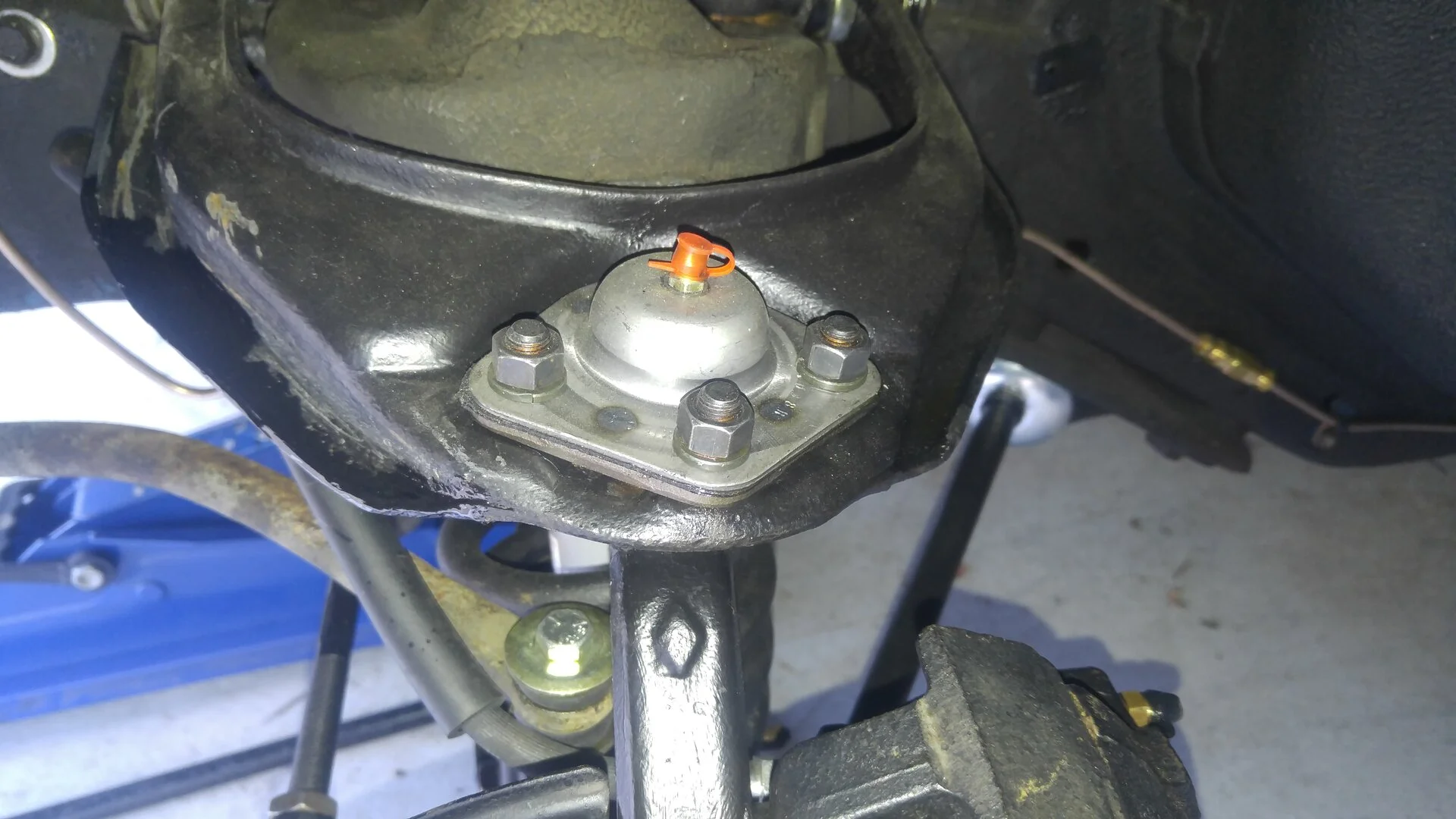

I had to trim the upper control arm just a little bit on the front side:

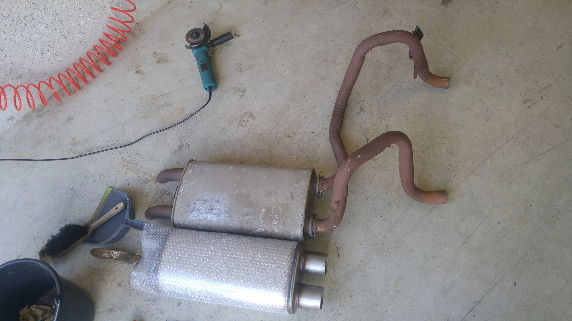

And even start to think about the exhaust options again:
Using the old over axle pipes with the old muffler and everything upfront 2 1/2'' stainless, which has the downside of beeing very small (46mm outer diameter) in the back. The upside is: easier to get TÜV.
Other way would be to build also the over axle pipe in 2 1/2'' stainless from scratch and use this SS muffler with x pipe inside, but the is a PITA.
I tend to use the old exhaust part to get this car done and TÜVed. If the car has already TÜV, redoing the exhaust for a "dumped" setup is an option.

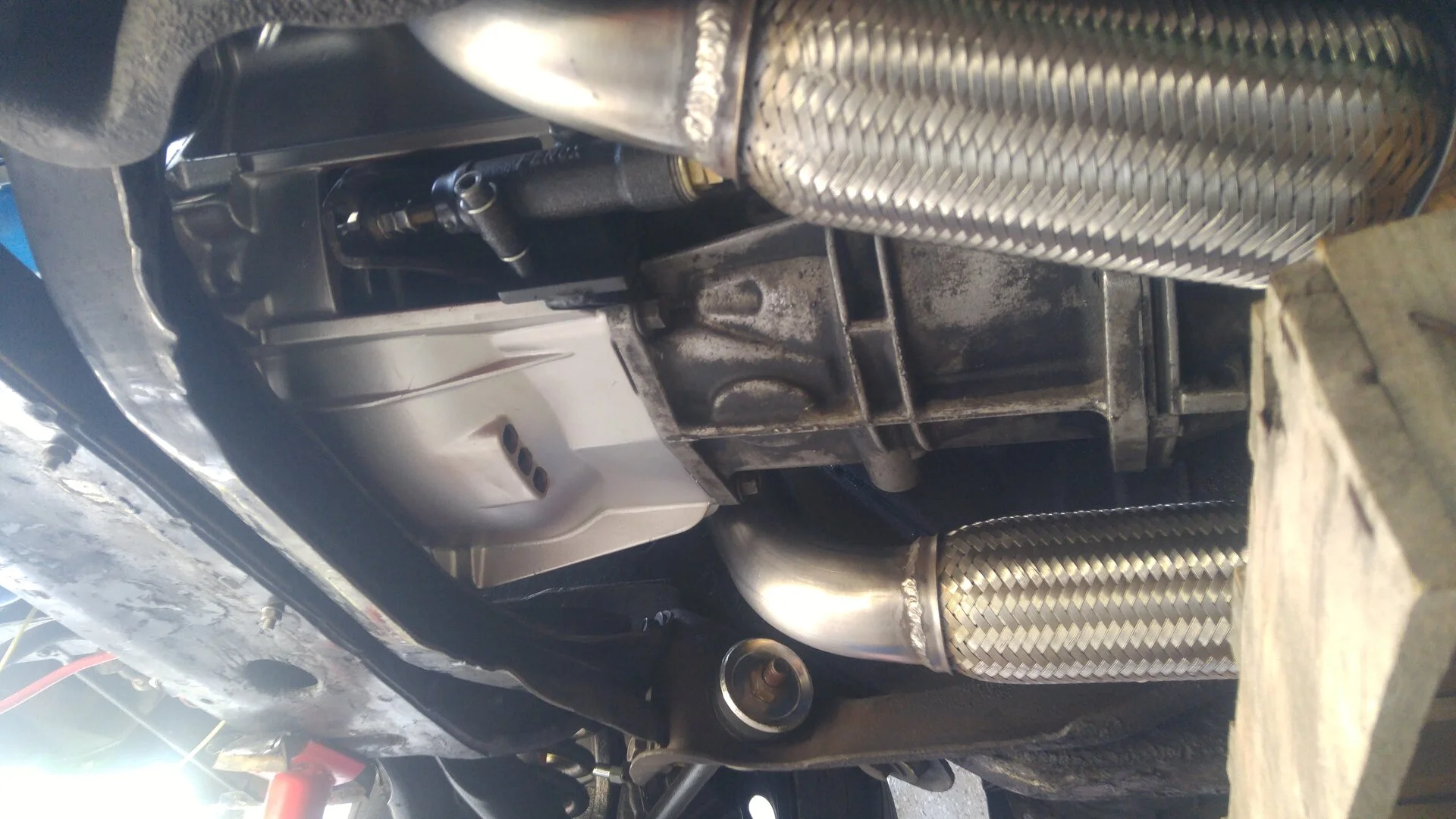

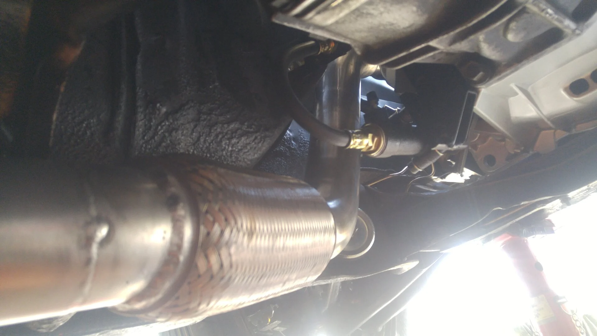

The pypes downpipe for 66 mustang which i started as an basis is now modified. I wanted to have some flex pipe just in front of the transmission crossmember and the exhaust hangers will be mounted to the crossmember. This takes movment from the rest of the exhaust...
I had to cut up the driverside downpipe because of my hydraulic clutch setup. If it was a cabel clutch the downpipe could have fit without modification.
I tacked it with my stick welder in my garage, then at a friends place we (mainly ma friend) weldet it up with his TIG.

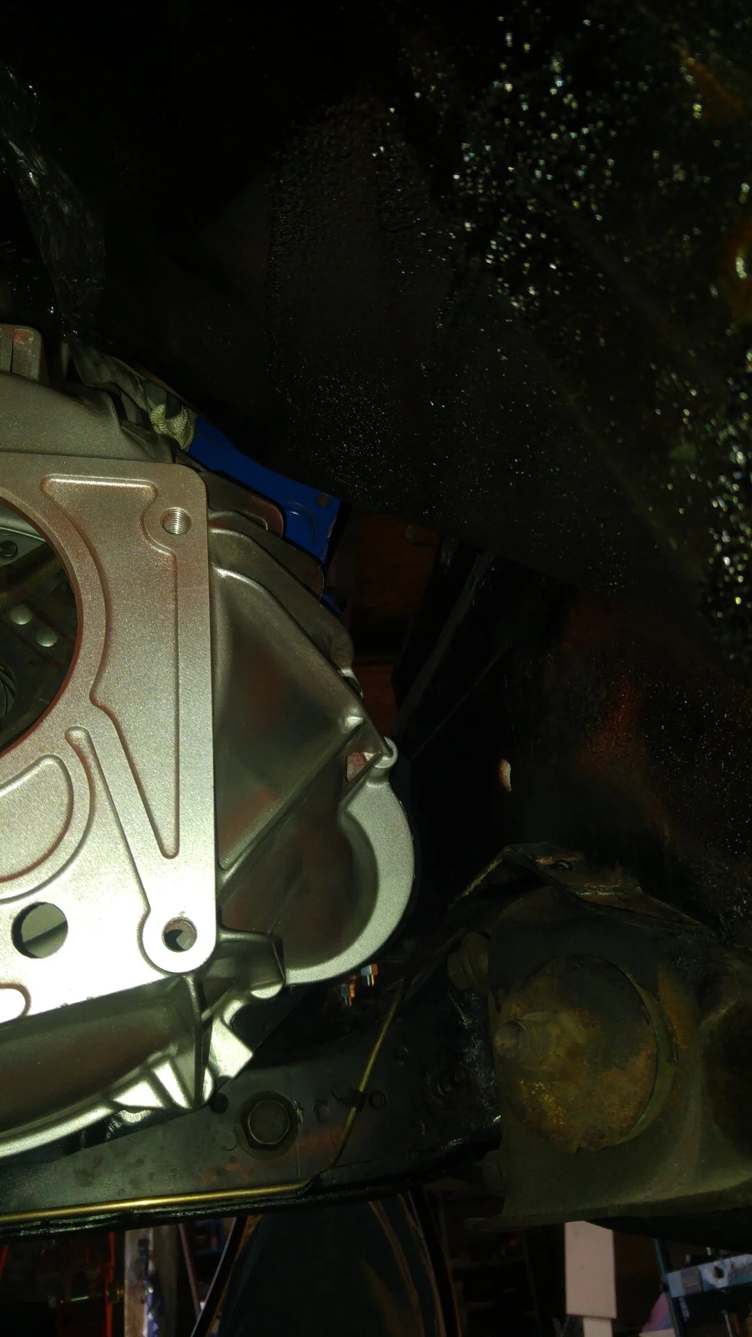

I just saw your post about the interference on your car. In your case it was just a tiny bit. In my case (because of the backspacing of the wheel), I had to cut much more away.

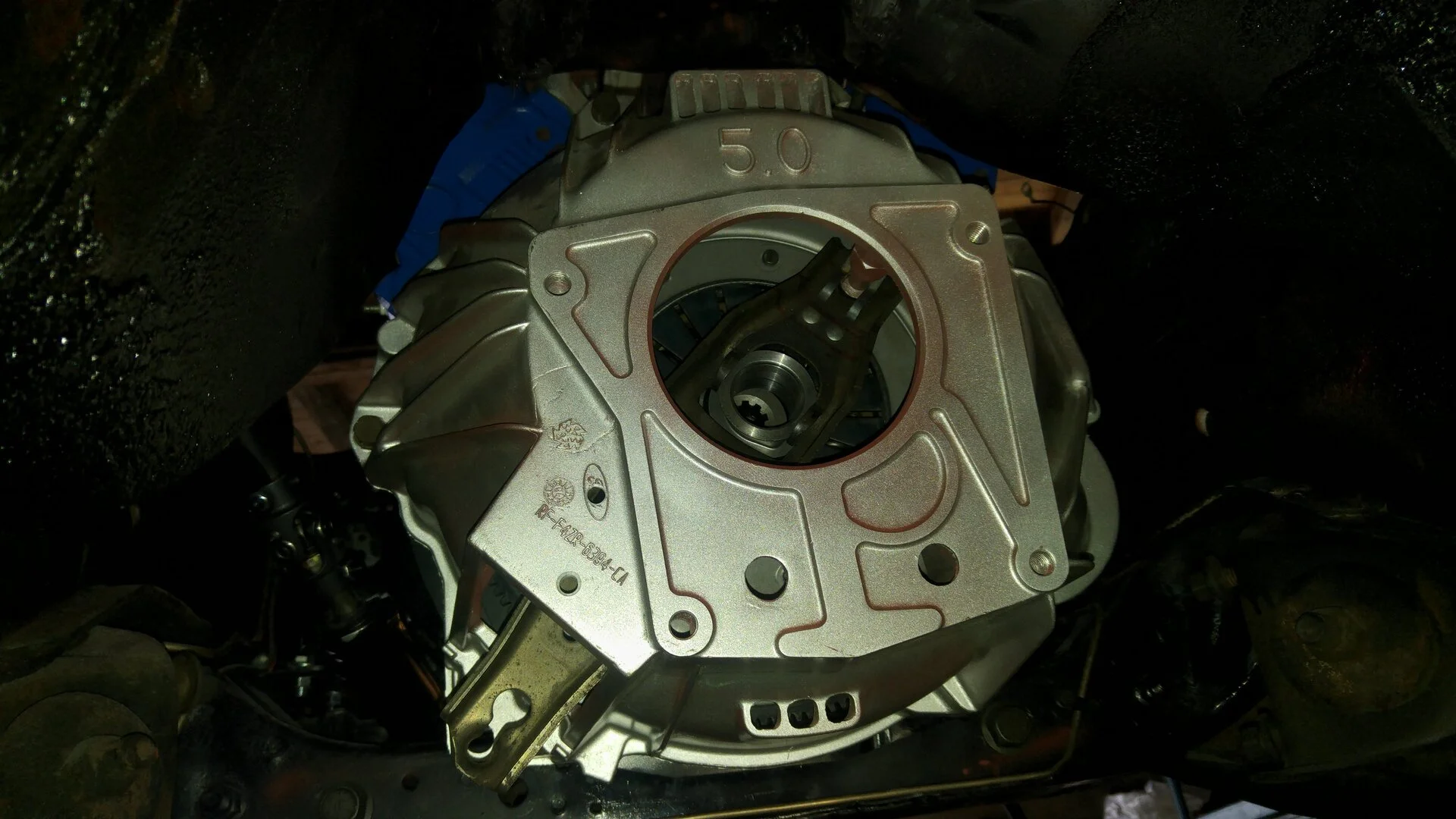

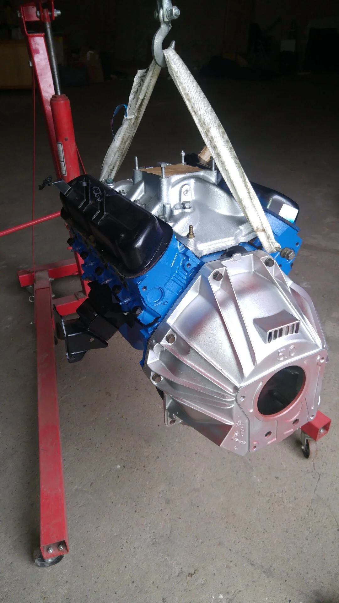

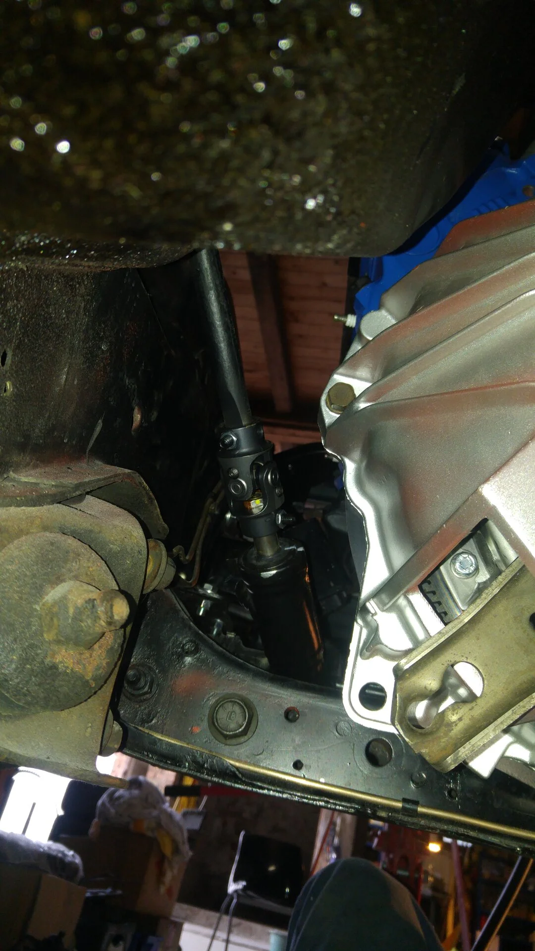

Here are some pictures of the sn95 94-95 5.0 V8 bell housing from installation. Again my engine doesn't sit in the stock location. The transmission mount sits on the same level as the C4 (but elongated backwards), hence the engine sits 1 inch higher to get keep the right angle of around 3° engine up. Also the engine is move a bit forward to keep the stock V6 drive shaft.

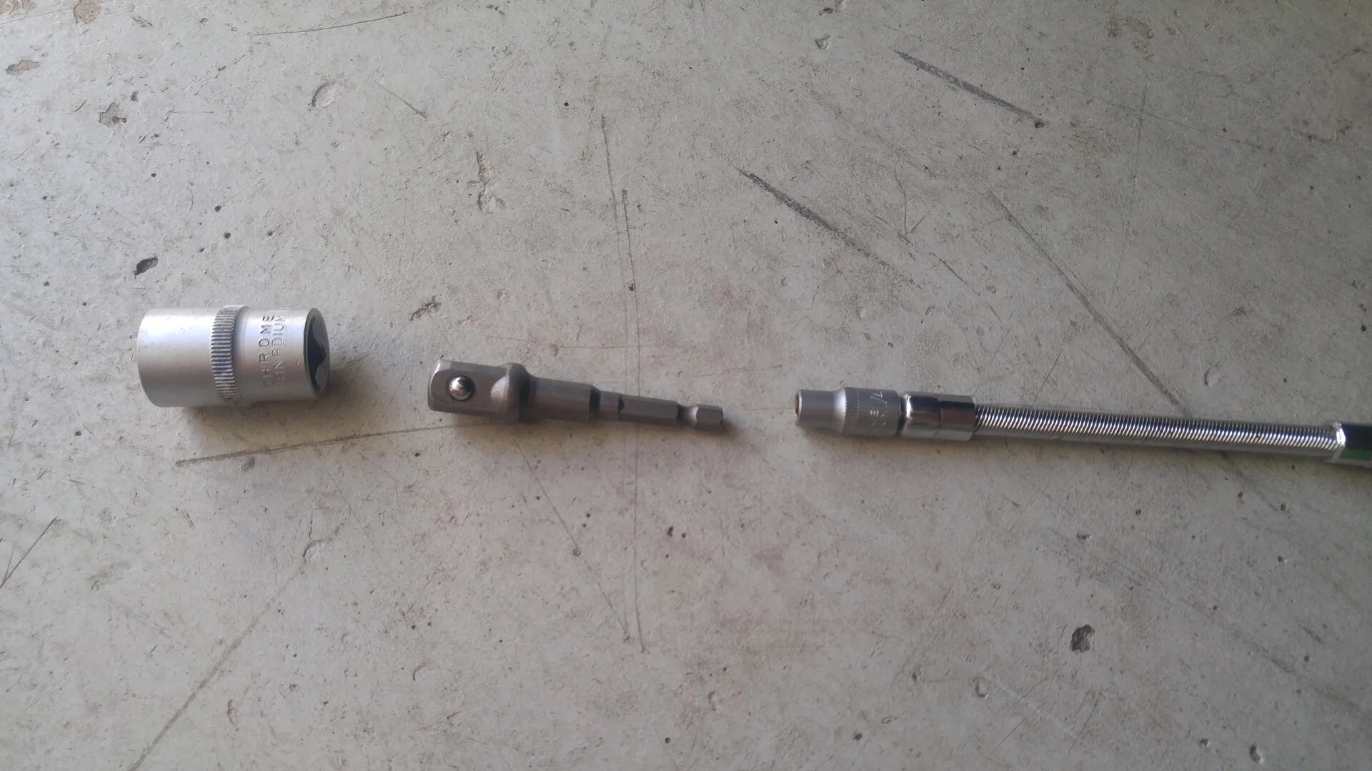

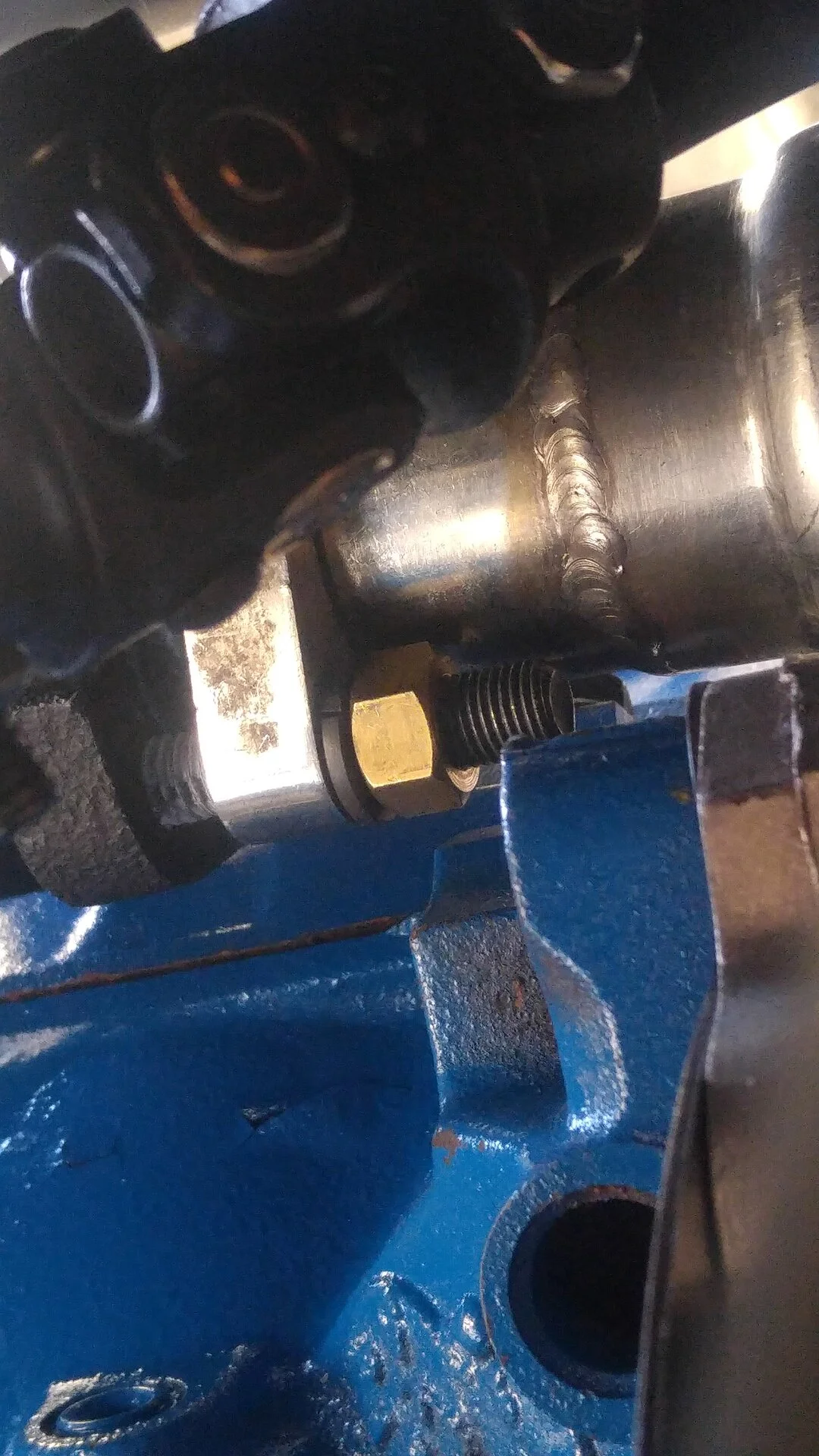

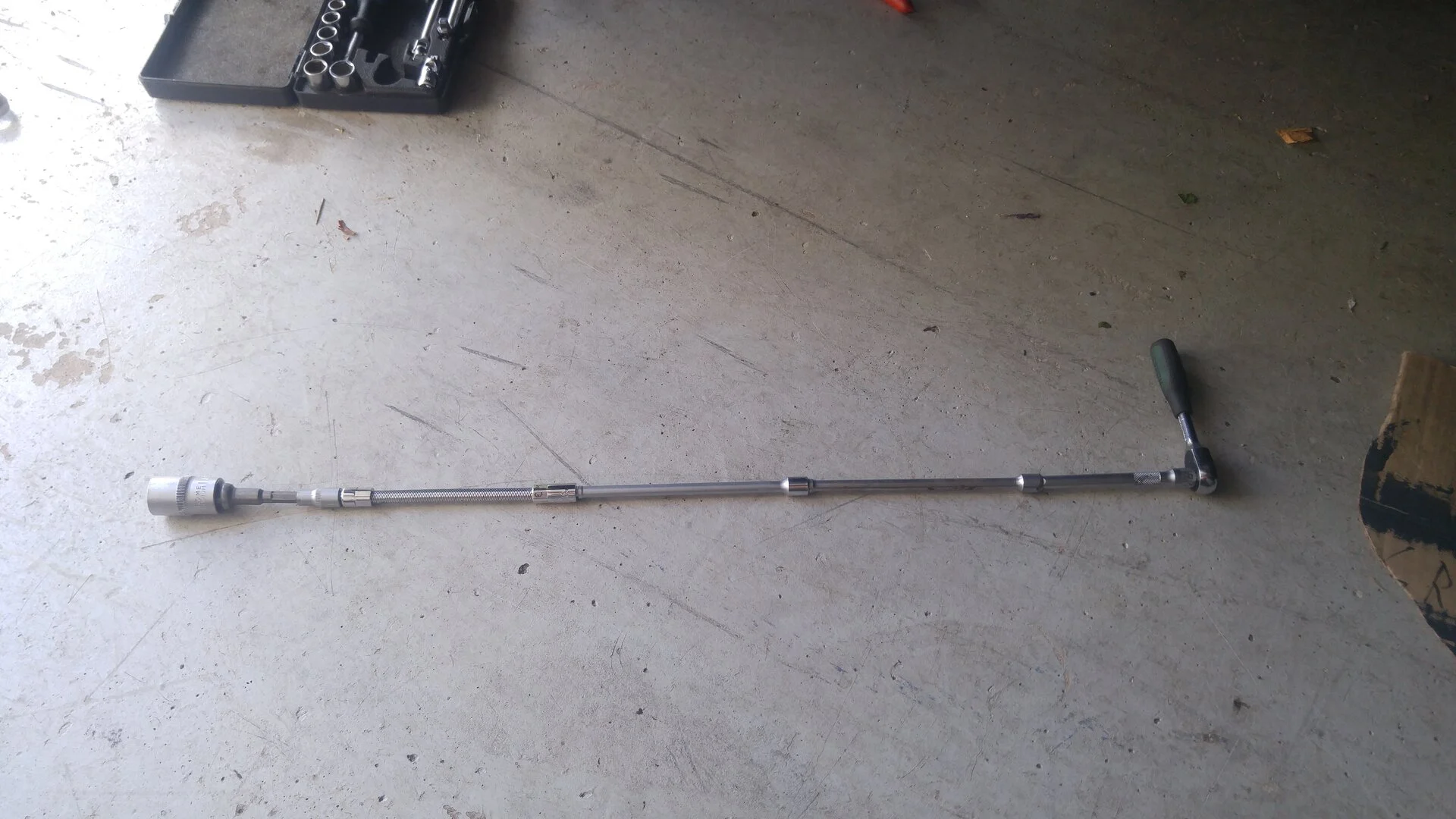

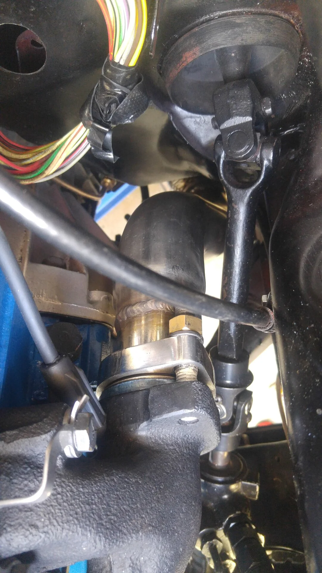

Installed today the downpipes. It take 2 hours to get the bolts from exhaust manifold to downpipe tightened. Driverside lower bolt was the hardest, but finally I did get every adapter and extension I have. Pictures are for my future me, when I need to undo them...
The block has there a kind of extrusion and a wrench doesn't have enough space.

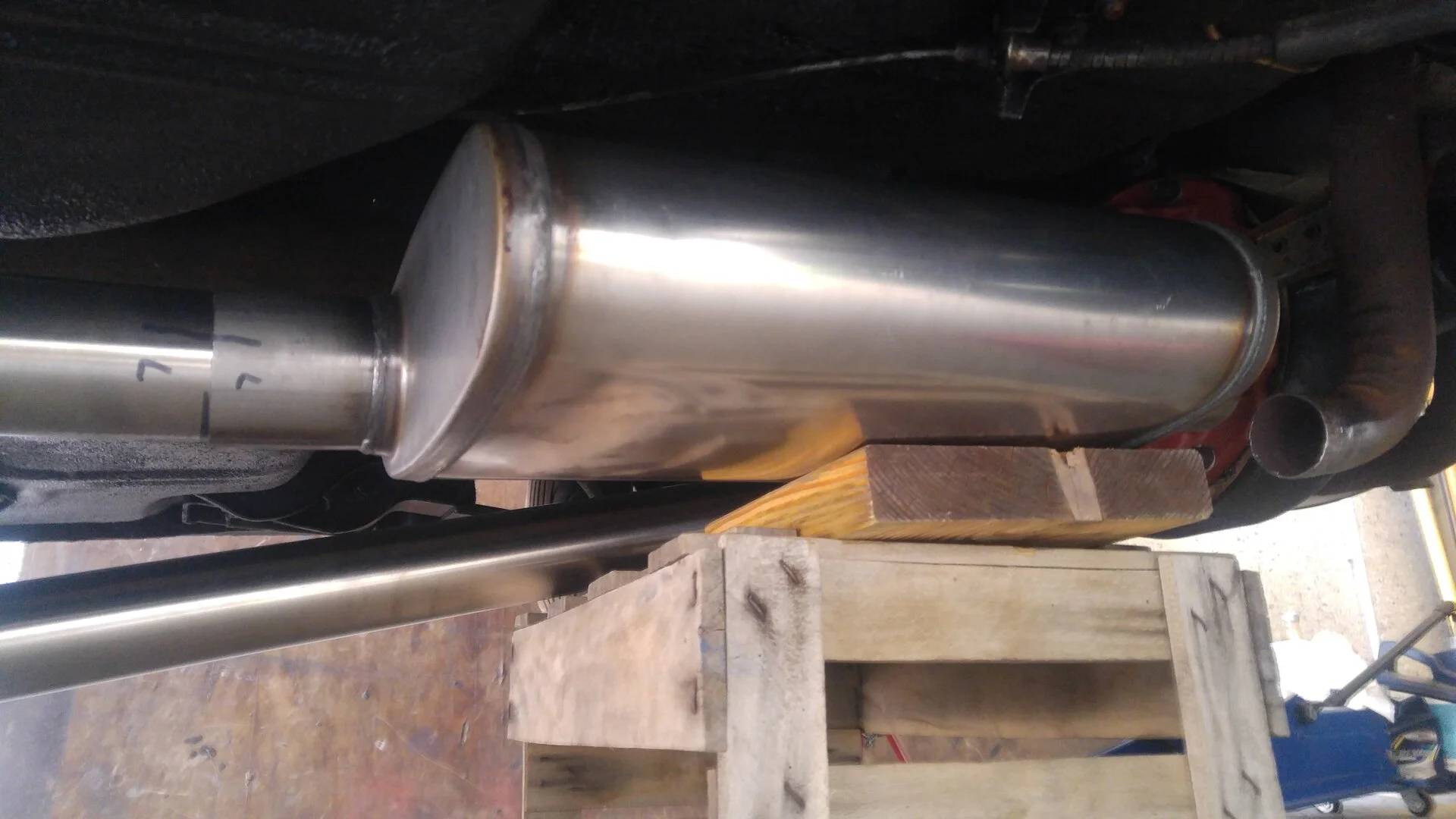

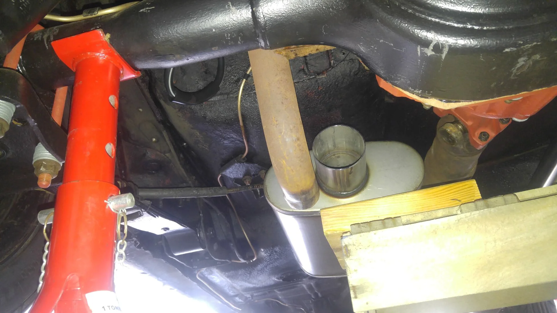

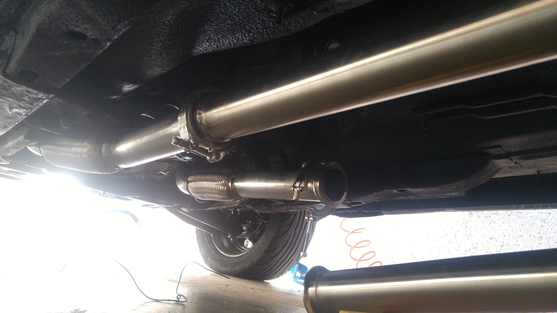

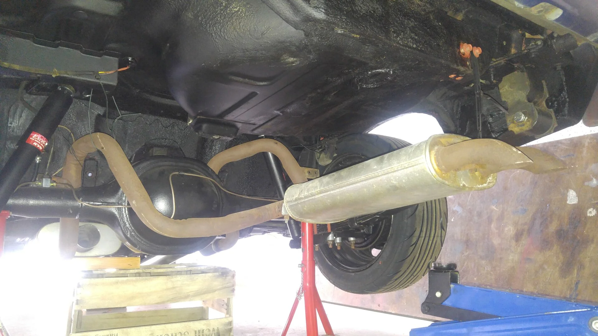

Mocked up the driver side rear muffler (actually more a mid muffler) and shortened the pipe to the right length. The old over axle pipes and rear muffler was still hanging in the rear. But I don't want to mess with it for now and will go dumps!
I hope I will get the inspection anyhow. If it's to loud I will put some DB killers before the muffler. The law says the exhaust must end at the rear axle or behind.
My final thoughts for today are: exhaust building on jackstands sucks.
