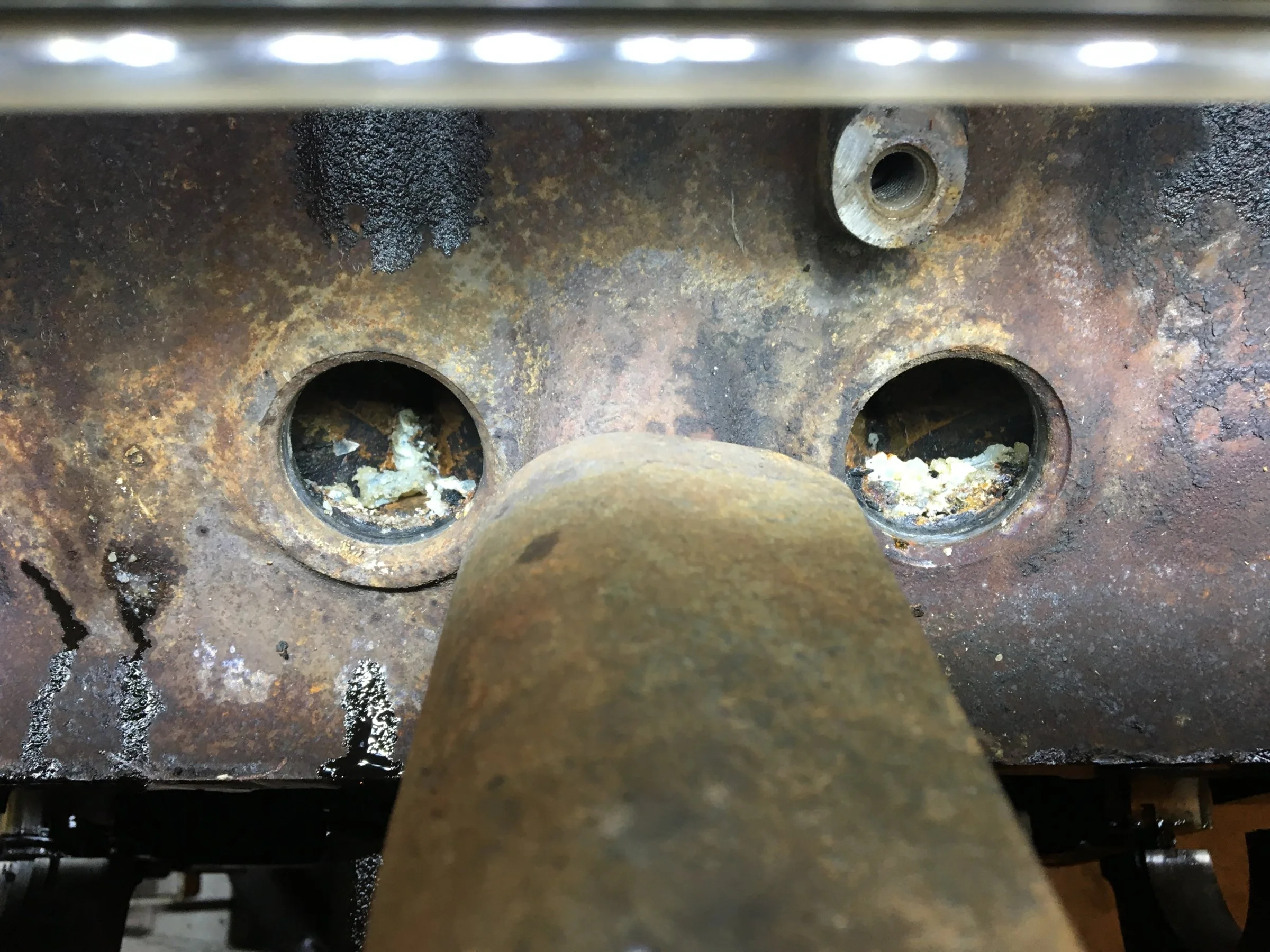

A very little thing tonight, I popped out the freeze plugs. Woohoo!:zombie:
Notice our little Stop Leak friend is there as well.

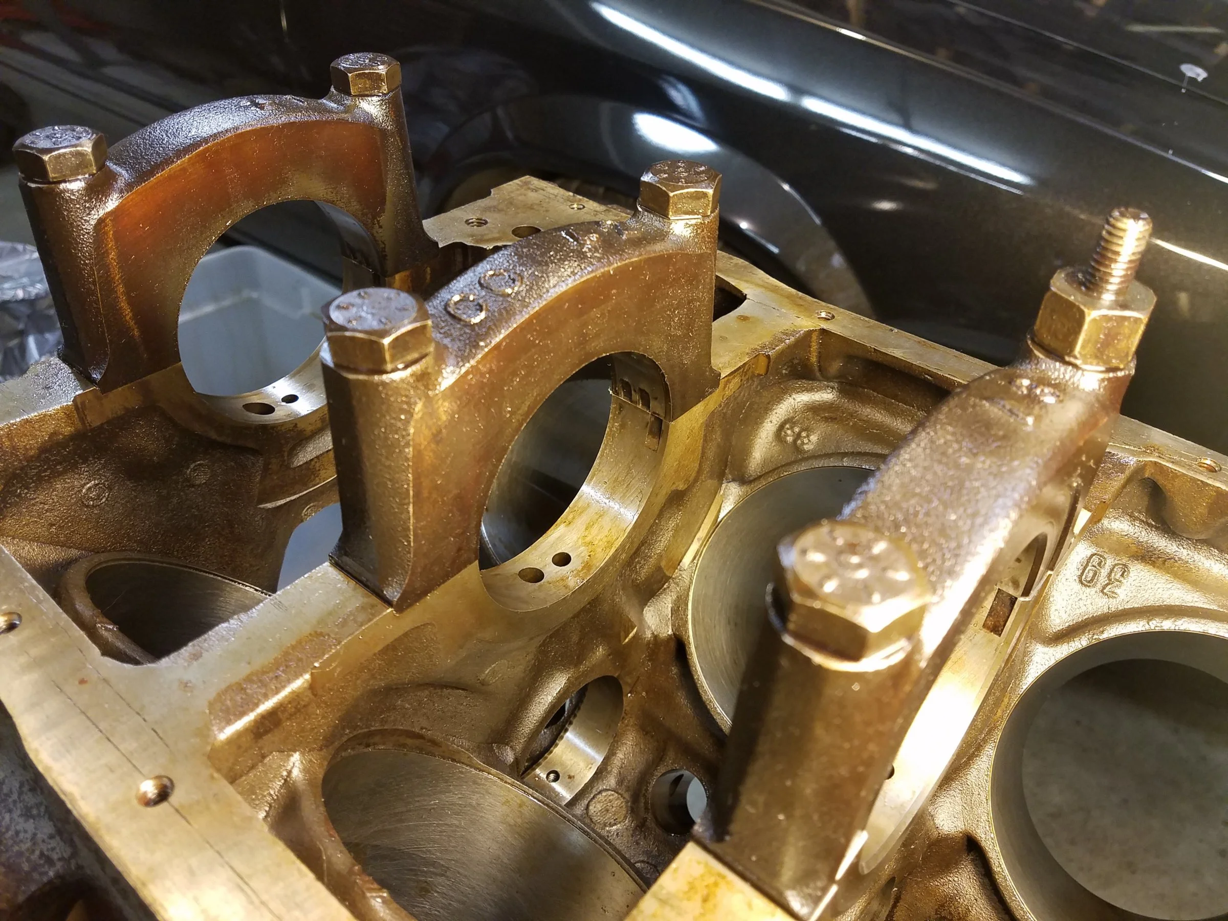

Dang Dave. You have accomplished quite a bit and this thread has taken a turn towards softcore ****! You just need a bore gauge (cheap is ok) and a good mic and you can measure you bore (holes) yourself. (damn now I am adding to this filth) :eek:
I would bet the max overbore is .030. Maybe .060 if you sonic check the block to check the cylinder wall thicknesss. Since that definitely isn't a thin wall casting, I would believe you have some room there. Probably want to bore to get a few extra cubes anyway and make sure the holes are actually round. No since cheaping out on the cylinders and having all that lovely boost pressure find its way past the rings!!!

While it is possible to check your cylinder bore yourself, it is one measuring device that I'd never buy because it'd get used once every 10-20 YEARS...
I agree Dave, @Davedacarpainter you're probably gonna wanna just go ahead and just consider having it bored.
The bore on the engine is 3.810...and from the pics looks like you could almost get away with leaving it standard,..but it's gonna take somebody with a dial bore gauge to tell the tale on that.
Here's the really cool part about boring the engine.
If the Pistons that you buy are truly " custom", they'll make them for your engine in any bore size that you dictate.
(Like .010 over 3.820 final bore)
As long as the cylinder will "clean up" at that minimal over bore, keeping it small has multiple benefits:
It'll leave more material, cylinder wall integrity will be greater. it'll stay round better, allowing for more boost, a better sealing ring ( more power, less blow by), and over bore room should some calamity occur in the future.
*The only limitation to that, is being able to get a good cylinder ring at your chosen bore size.
But guess what? A 3.810 Essex, bored .010 over uses the same ring that a Buick 3.8 uses when bored .020.
(Or Ford 2.3 4 banger bored .040 if it makes you feel better)

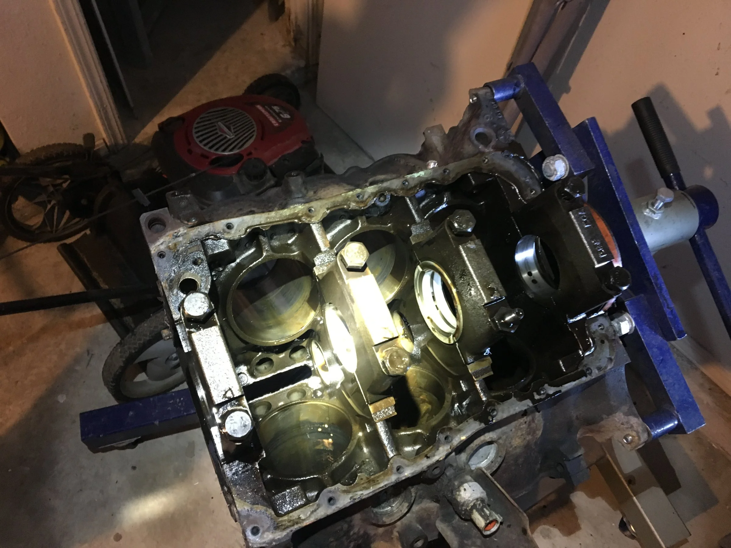

I'm still in limbo on exactly what i will do for the rotating assembly. There are lots of options. First though, I think I'll get the block dipped and have the sonic testing done. Then I can start seeing what it needs as in overboring, etc...
It's really freaking dirty right now and the cylinders are a bit crusty. With my cheap little digital micrometer I could check the size close to the top. They're roughly 3.805 with a questionable gauge that can't measure deeper into the bore. What does that mean? Pretty much nothing, I'll get the machine shop to do the measurements for me when I drop it off for the cleaning.
This means it'll go to the machine shop two times. Before you say how stupid this is, read my reasoning.
1. I won't be able to spend the big bucks on this engine until the end of January. So no rotating assembly till then. If the shop will require it to do the work on the block, that puts that on hold. Yet I will need a bore size to select the pistons. So it might possibly get bored out at the initial drop off stage. I'll have a long talk with the machinist.
2. Getting it cleaned will allow proper measurements of the cylinders to be made and get an accurate idea if it needs to be bored out and, therefore, of what sized pistons I will need.
3. Getting it cleaned, and decked too while it's there, and then getting it back will allow me to do some of the pretty making stuff I want to do to the block. Not painting it yet, that'll happen after the last of the machine work that might be required.
4. Sure, i could just wait and have it all done at once, and maybe I still will. Not doing anything right now is about to drive me insane.

You can only square deck the block, which will make for an unecessary process. Because you'll want to have them deck the block to zero deck height after that. And that can only be accomplished with the Pistons mocked up in the 4 outside holes..so bottom line...
You'll be waiting on that process ( decking) until January too.
Reactions: Davedacarpainter
So then, cleaning, checking the integrity of the block and measurements for the first trip.
