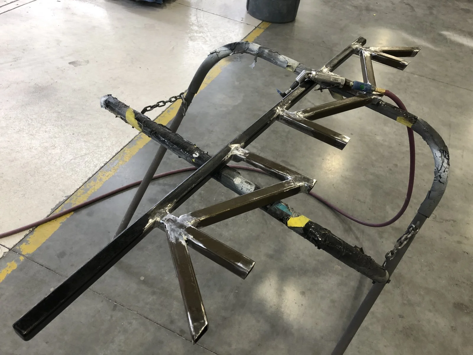

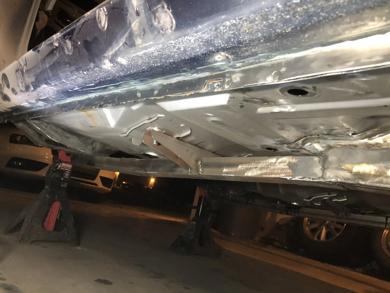

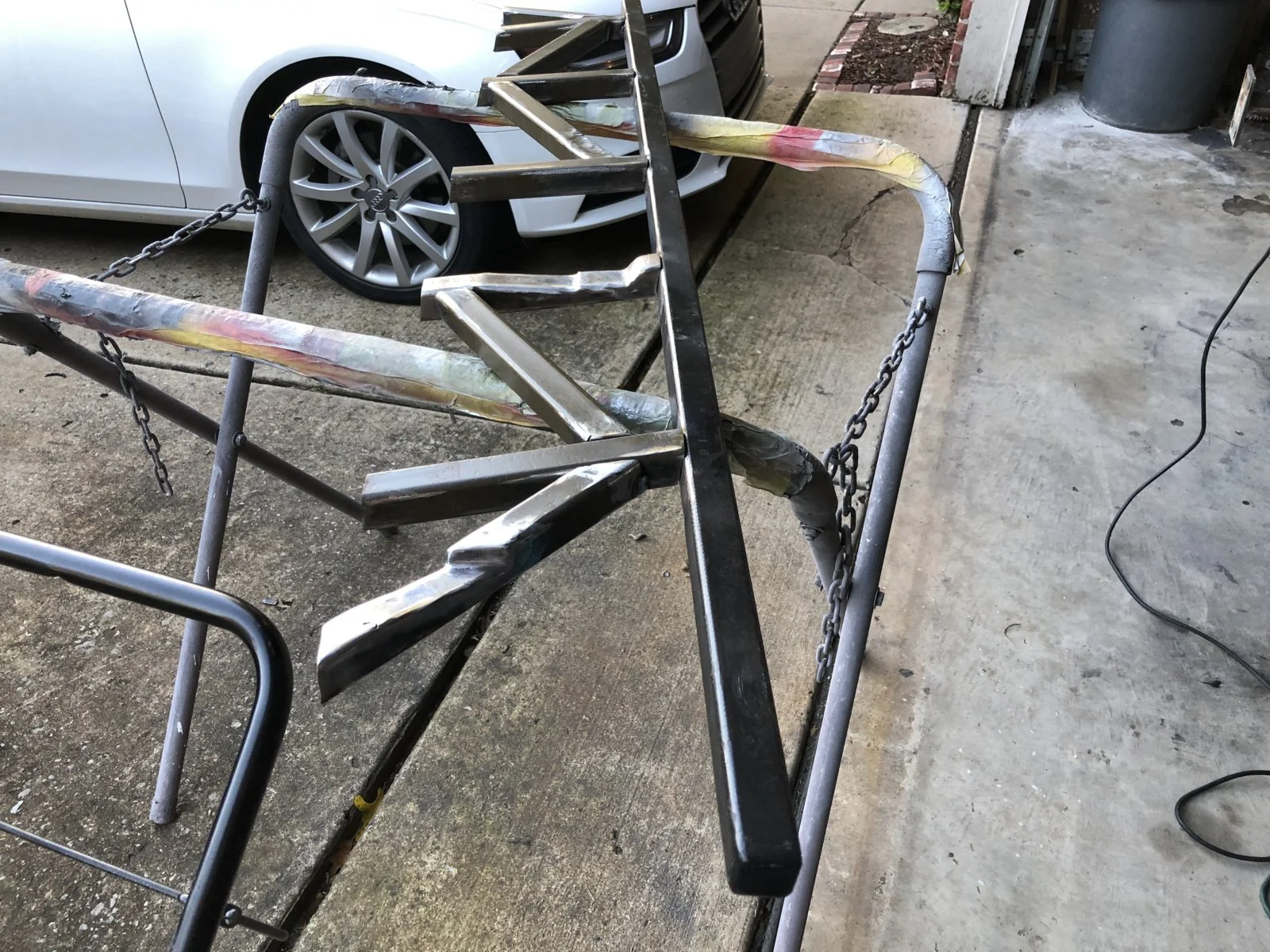

I got the diagonal welded up and dressed.
Then welded onto the cs.
I'll cut the tack welds tonight and drop it out and get busy on finishing this part up.
It's out.
I welded the perimeters of the tubes. Got a little sloppy at the end because my HF light decided to stop working:fuss:.
Whatever, I'm taking it to work tomorrow to do the dressing of the welds. That way those little metal shavings don't end up all over my garage floor just waiting for me to lay down.

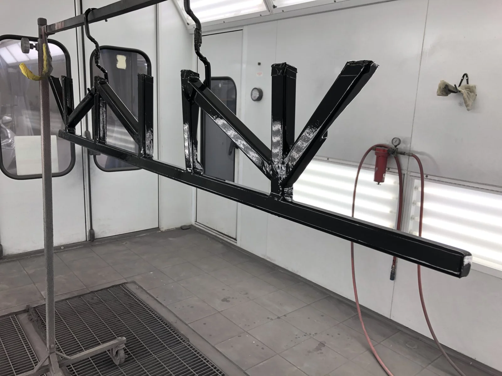

I got the welds dressed this morning.
I’ll sand it all down and get it coated with POR15 today.
My football games don’t start till 2:30 tomorrow, so I’ll have time to get the seam sealing done on the floor pan in the morning.
The reason I’m going a bit overboard on the web supports is that the t-top bar doesn’t offer much structural strength. Hopefully the some day engine will be in the 500/500 power range. I’ll want a little strength.
Looking good Dave! That should definitely help stiffen up the chassis.

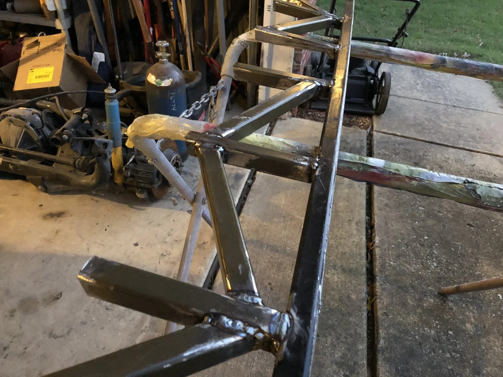

As soon as I finish the chassis support stuff I'm going to go back and finish the engine bay. Then I'll yank out my upper torque boxes, put the new support in, THEN i'll put you evil plans into action on my IRS.:eek:

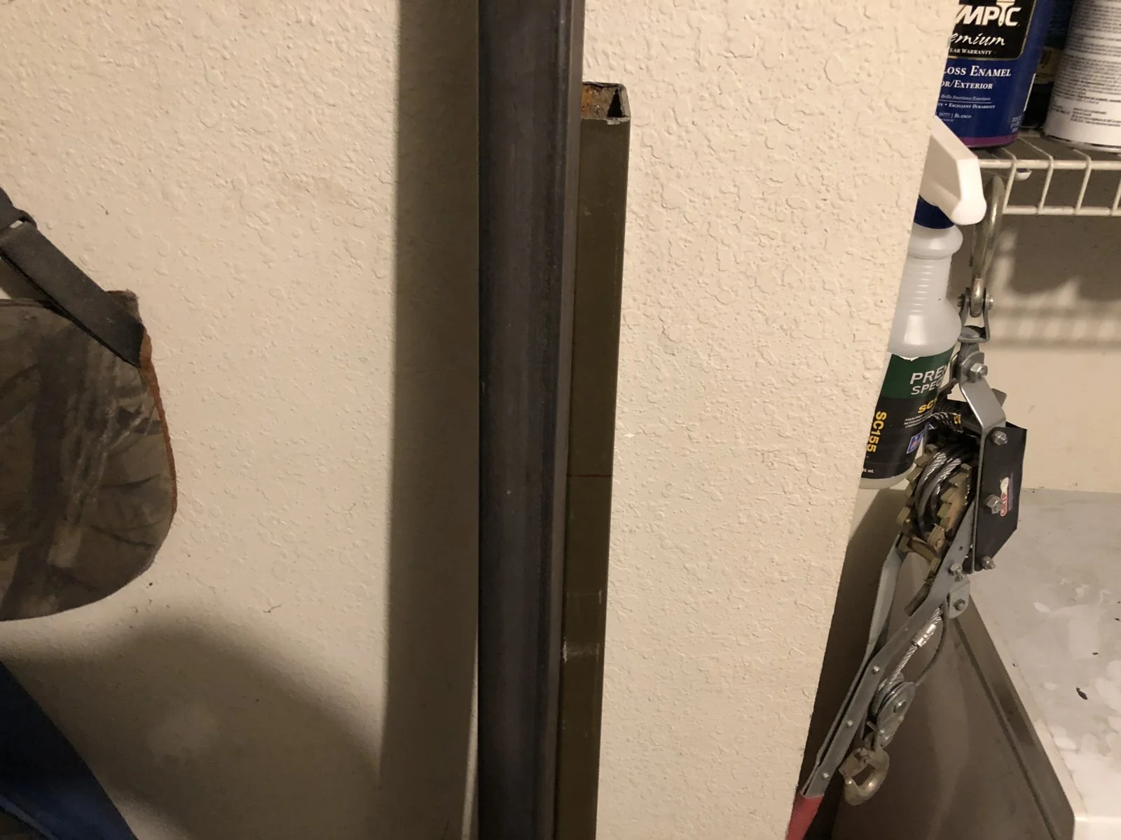

BTW Chris @Hoytster , I had this 1.5" square tubing given to me. That's it next to the 1" tubing I used for the chassis support.
I want to use it for the support that will replace the upper torque box. Think that'll be good?
Yep, that'll be fine. Being 1 1/2" will give you a little more room up top since I used 1 3/4 DOM and it was very close to the upper control arm mounts on the IRS cradle.

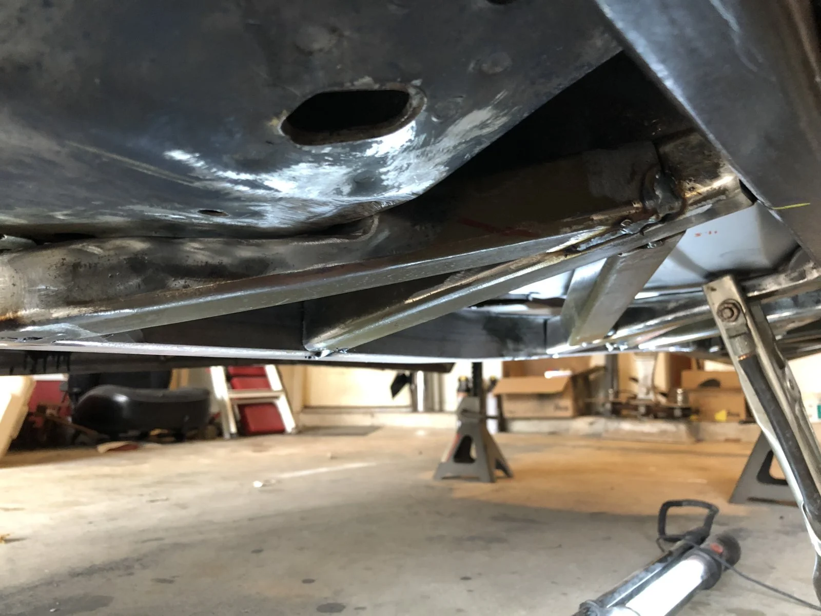

I got home from work, put away the fresh beer, and flopped down under Booger. I realized at this point that the passenger side wouldn't be as easy as the driver's side.
Apparently, the great land orca that used to own this mustang and destroyed it's original floorpan with their formidable tonnage didn't mind dragging the passenger side over every curb and speed bump along the way. I don't actually know the original owner, but I'm thinking their great big butt in this mustang may have been the original impetus for the cool look of a lowered mustang (Without lowering springs).
The pinch weld is FAR from straight, though much better than it originally was. I spent roughly an hour and a half just cleaning the metal. I spent all that time on the inside and outside of the pinch weld. It's not perfect yet, I will clean the edges better. The driver's side gave me fits when I welded the jr to it. I'm hoping this time it'll be nicer if I pay attention to cleanliness.

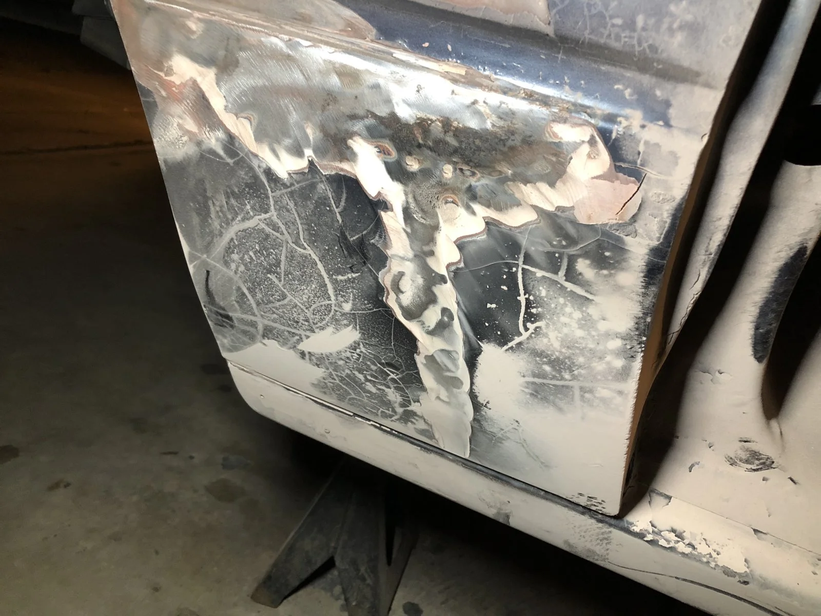

Just for kicks I ground into the lower front 1/4. I knew it had mud in it, I just wanted to get an idea how bad. I think I might order a lower patch from LMR. The area was fixed by drilling holes in it to pull the panel out. Then they filled the holes with mud:nonono:. It doesn't go into the rocker though, that's a good thing.
