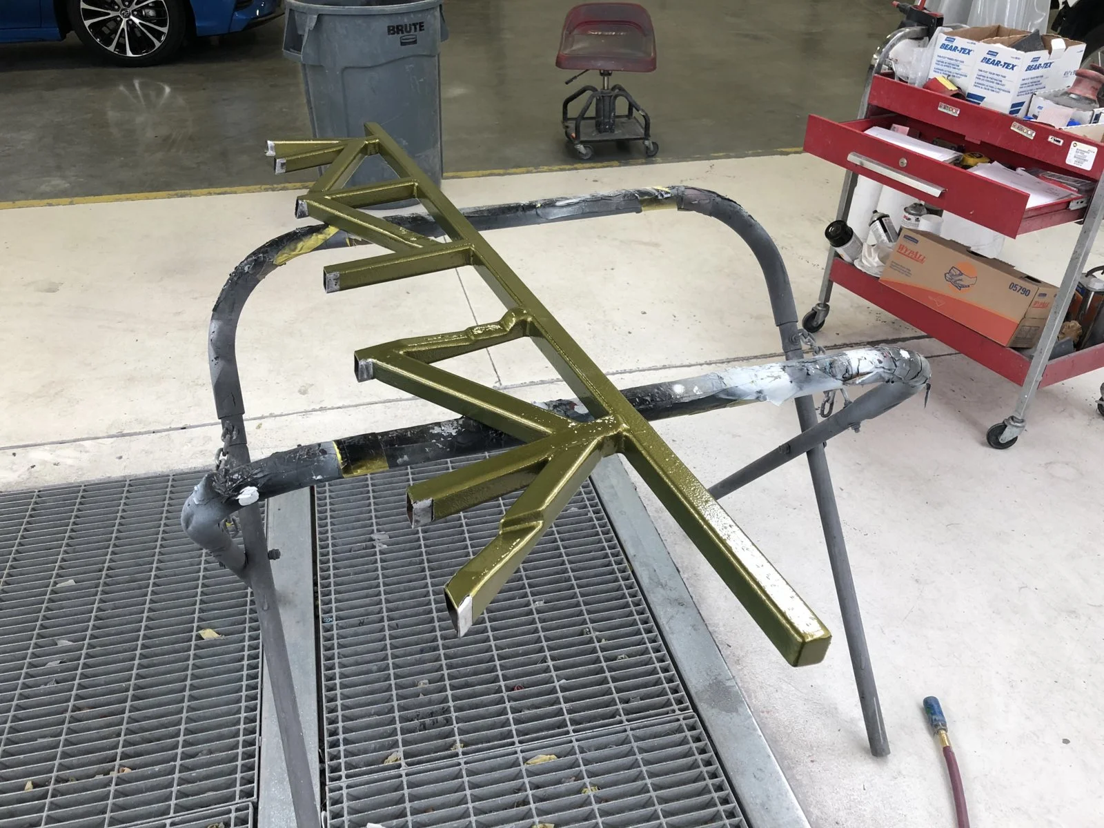

Chassis support, or we could call it a web support? Or we could call it Henry?
I assume you are referring to your matrix style SF connector as a "chassis support?"
You're just creating names for parts of your car that you have built then?:cautious:
And "Chassis Support" is the best you can do on a car you call booger?

It’s green and shiny, pretty exciting, huh?
The rocker chip guard is a nice touch.
Is there any possibility of moisture ingress on the top side of the open ends that will face the frame rail? I'm assuming you won't be able to get that area with a welder since there is paint all the way to the edge. Seam sealer?
Yes sir John, seam sealer across the top.
What I wanna know is, How are you gonna keep your pretty green paint "pretty" when you apply the heat that welding's gonna generate?
And...doesnt it make sense that if you're gonna over-engineer the hell out of that chassis support, aren't you cheating your design by not welding the jacking rail against the floor at the top, or spot welding through the floor on top of it?

I understand what you're thinking Mike. The strength of the rocker pinch weld area is the pinch weld itself though.
I agree there is the odd chance that the jacking rail could flex away from the floor and effectively "bend" the pinch weld area. I just didn't think it was too likely with the web bracing between rails and the welding to the sfc's.
I'm thinking I'm ok unless I go apesht and want to try four digit power.
Oh yeah, weld question. I'll sand those areas back down since I have to go back and paint the bottoms surfaces anyhow. I'll post pictures when I do that. Within the next month or so.
