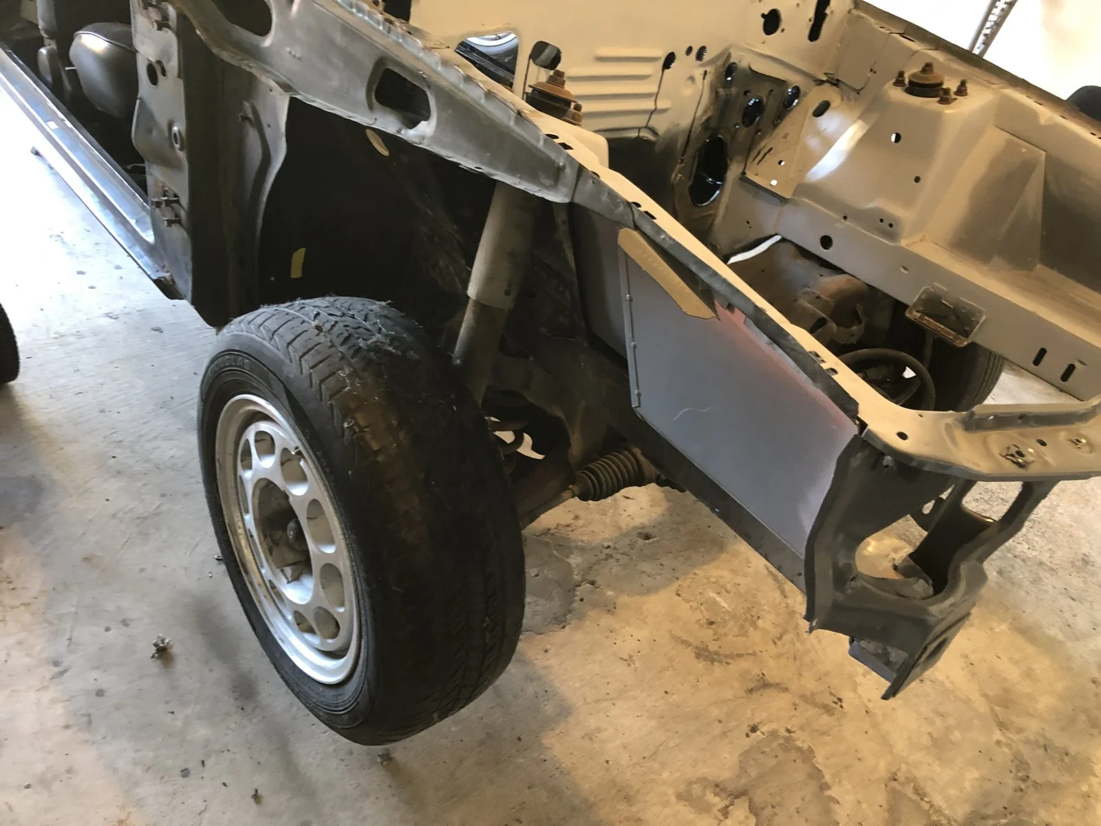

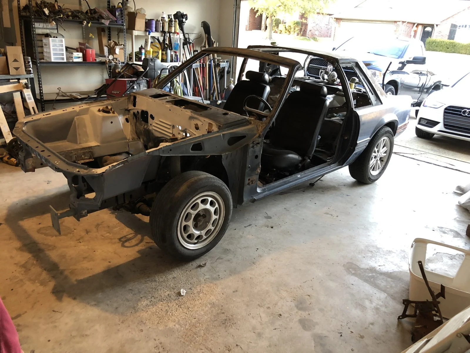

I worked on Booger today. I got to get him back on wheels to get ready for the big move.

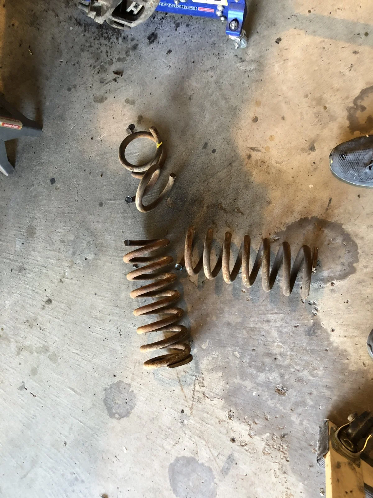

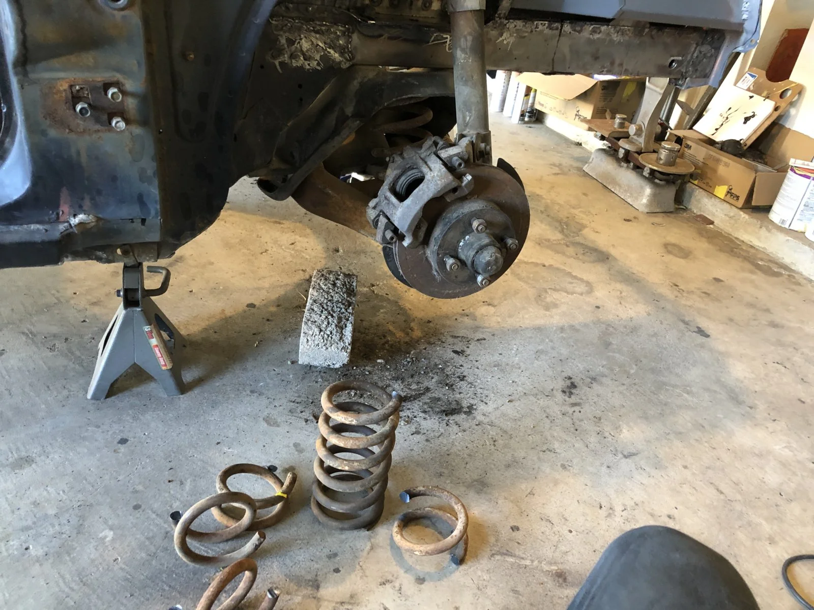

I started by dragging the K-member back under the front end. I had decided to remove a coil or two from the springs just to make putting it back together to move easier. I started with 1.5 coils.
That wasn't enough, with me and my boys sitting on the front end we still couldn't get the strut bolted back on. So off came another 1.5 coils.
This worked. It's a little much even, but who cares? It's just for temporary mobility.

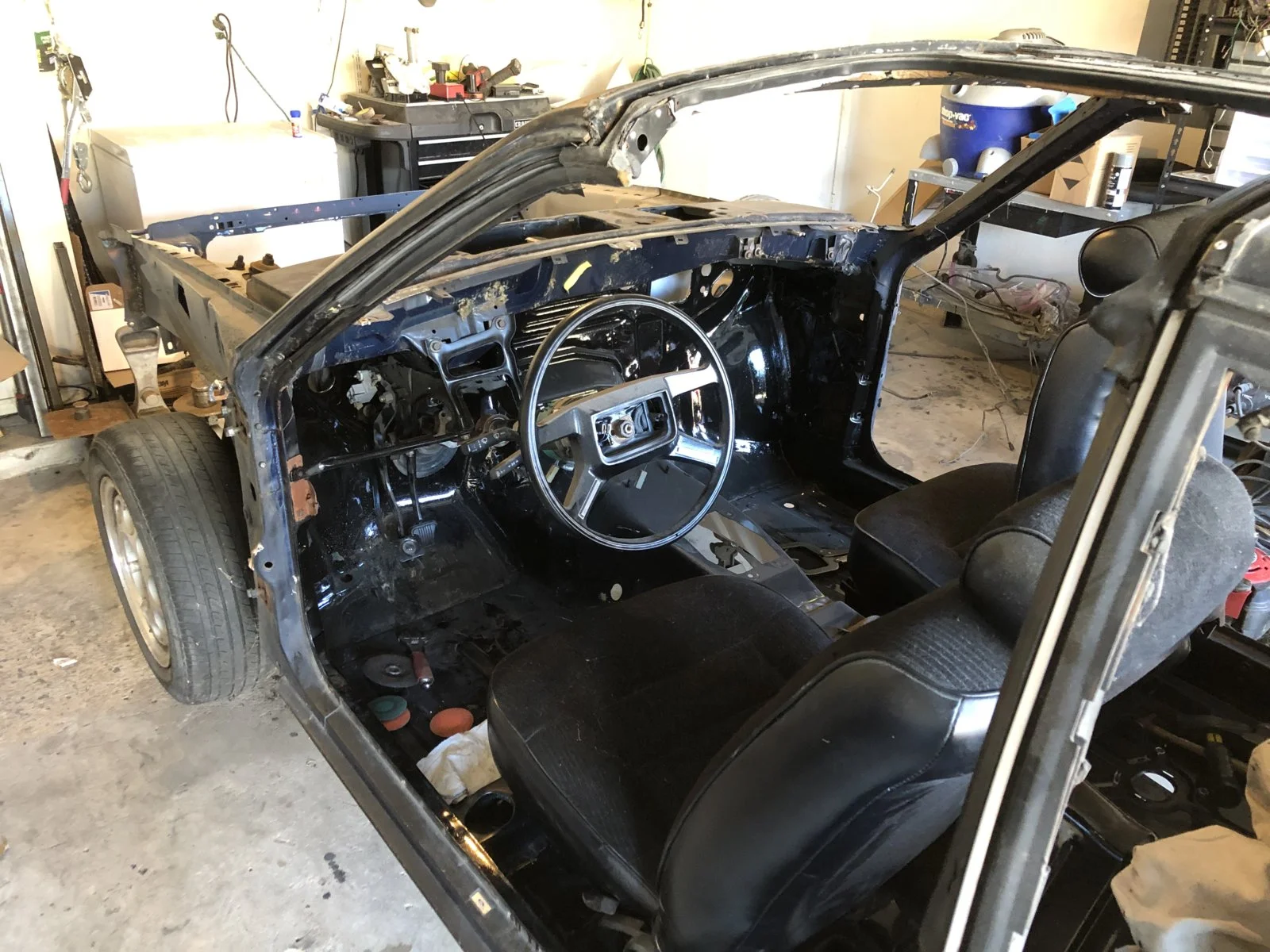

So I got the small crap done, brake booster, pedal assembly and steering column boot, shaft and column, and I also bolted down the driver's seat. This is the first time Booger has had a third pedal! Pretty exciting, eh?
BTW, this is the first time I sat in Booger with the reconditioned seats and a steering column. I'll need to be a bit lower or I'll have to drive in the winter with the t-top off, lol.
That took maybe a little over an hour.

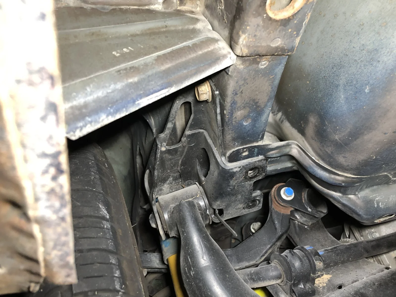

Next on the list is the IRS. I figured out a way to drag it under the vehicle by myself.

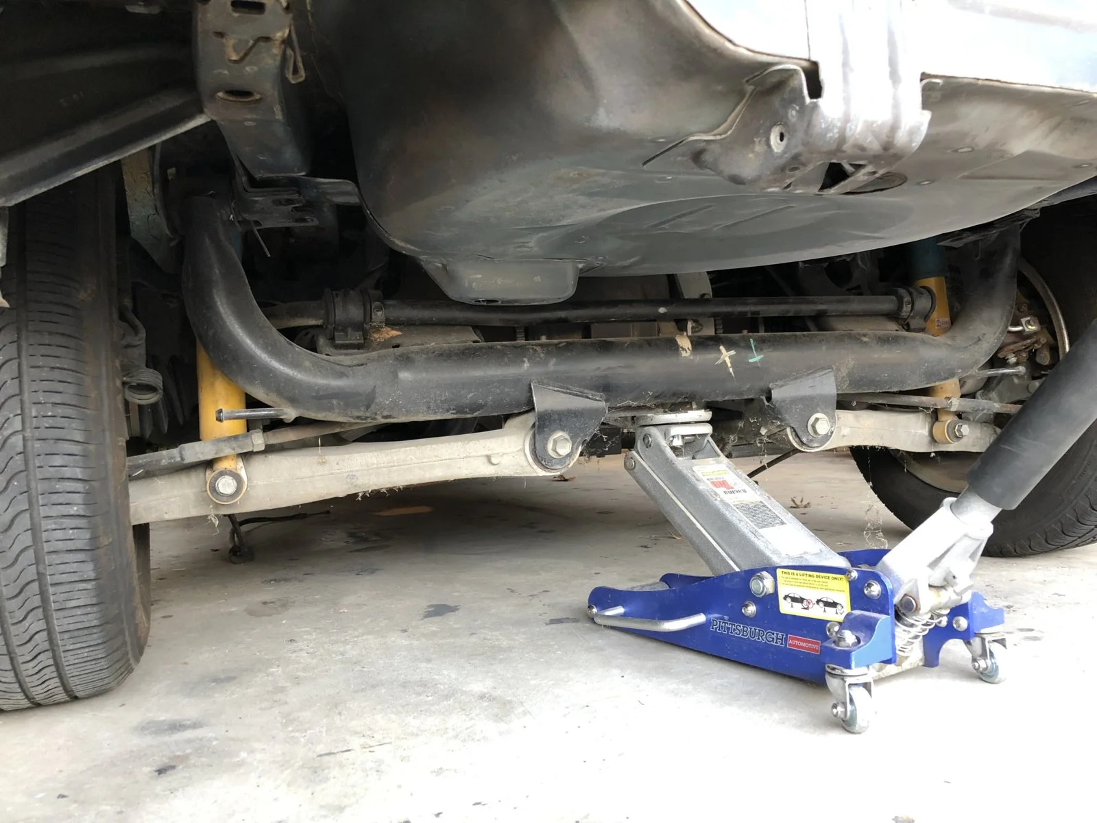

Now I have a question for you IRS guys (Chris, Scott, Nick, anyone?) Do you suppose to move Booger out of the garage I could just get away with doing the side mounts through the frame with no additional support or bracing? I also don't want to do the bottom bolts right now.
Hopefully the money pit (I mean my house) sells quick, it's officially listed. I wish to go on to the next chapter of life. This one sucked and lasted way longer than it should have.
I figured I would go ahead and try mounting the IRS. It was way easier than I thought it would be. I didn't put a bolt through the upper rear mounts, hence the jack. I'll drill one hole to hold the rear of the mount on Saturday.

Here's a picture with my youngest son in the driver's seat. The car is perfectly sized for him. He's 5'10". I'm 6'2". Some adjustments will be coming. I'm thinking those mounts that set the seat back a couple inches would be nice too.

You got a whole lot done man. The IRS should be ok without the bolts through the bottom. Guess you figured that out already.

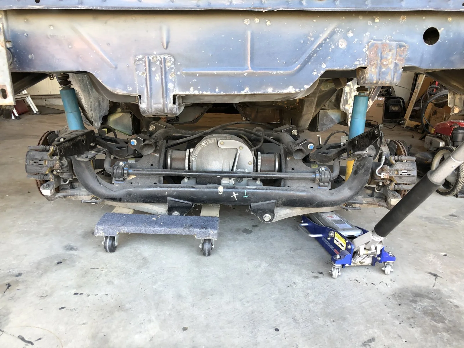

Another big whoop evening. I got the irs rear mounts mushed up to the frame (it helps to remove the sra rubber snubbers, btw:nonono:).
I drilled one hole and used an old bolt from the upper control arms to hold it. You can see it needs the other bolts or it might want welding instead. I don't care, I can move it to it's new old home now (the storage unit).
