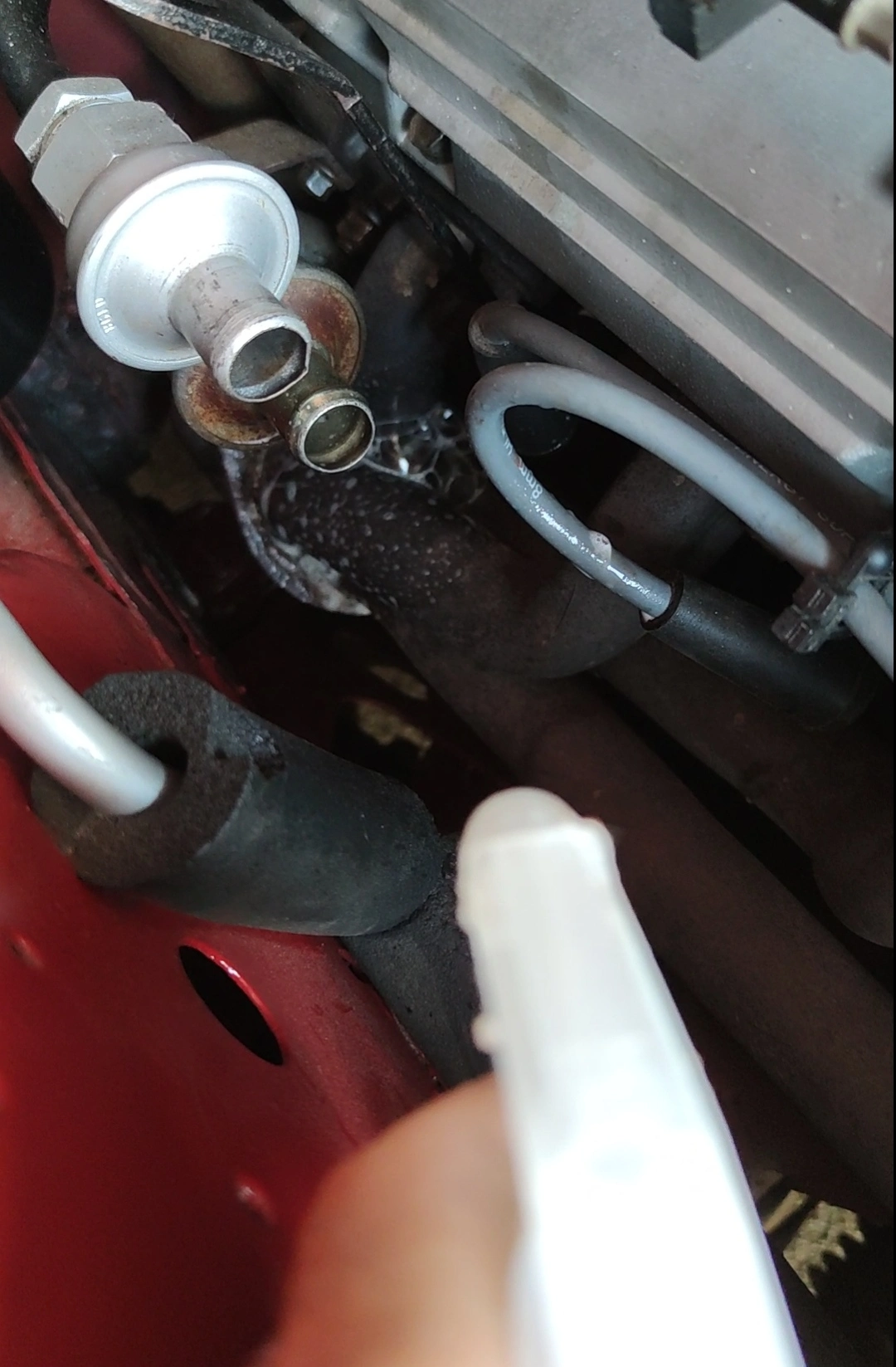

Found leak at collector!!!!!
May this be tick-knock source resonating thru whole engine?????
It is a clear tick in there with vacuum hose stuck between those 4 pipes and in my ear.
Reactions: 7991LXnSHO

Advise sell it real cheap on ebay and have them ship it
The one way valve was available separate at one time. Last time I was in europe they had lax emissions standards. You could kink those octopus hoses braze them up and be done with it. The closer you get to Cali the more of those old thermactor tubes you will find. Easy to find at a wrecking yard around here. There are several ways to block the exhaust ports off. Personally I would like to see you fix it back to stock and replace the thermactor tube and pipes assembly. Do you still have the veci under the hood ? Vehicle Emissions Control Information sticker under the hood?
Reactions: snovak
Ordered one-way valve. My intentions are to keep the car stock. That is why I was repairing thermactor system (was bypassed and is now temporary due to knock).
