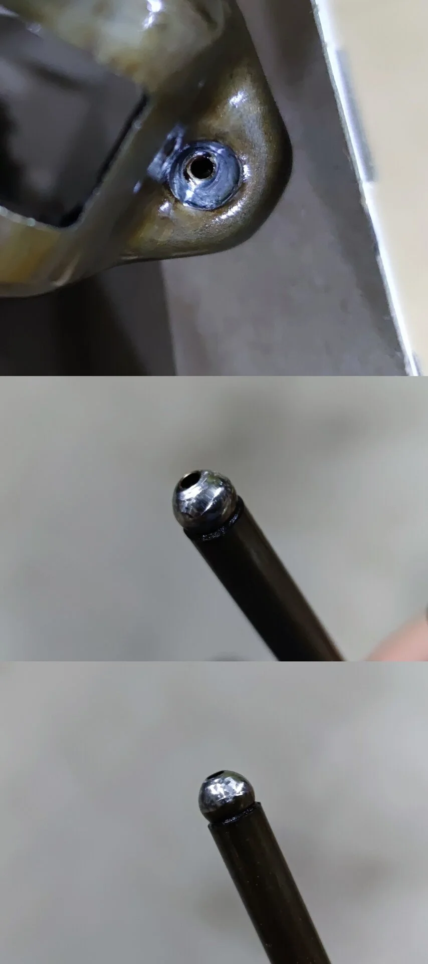

Now I have more importaint stuff on my mind with this car.... but could You guys check this picture and tell me what may be the reason behind rocked arm......dont get me wrong for wrong expression but like "chamfering" pushrod... you'll see on picture what I mean...
Rockers were tight. What is the story behind this kind of damage in 302?
Was this a bad lifter and I didn't swap them pointless eitherway? Or is the problem in bridge
between two rockers? Or more deeper... ?
This is fourth position passanger side counting from front of engine, which should be cylinder #2, exhaust valve.

That is lack of oil damage. Most likely the lifter is not letting oil thru to the pushrod, Install a direct pressure gauge to check the oil pressure. Replace the pushrod and the rocker arm. Pull the intake check the camshaft lobes for wear and that lifter in particular. The early roller blocks used to let a lifter go sideways once in a while
Check the oil pressure with a direct pressure gauge. Use the tap near the oil filter. There is no test for the oil filter bypassing. You can cut the filter apart and check for sludge. The oil pump pickup tube is what will be plugged if the silicone oil pan gasket deteriorates. The silicone chunks will make it to the filter and be trapped. Real common on 2.3 Mustang and Rangers. Car will have little to no oil pressure and will be okay after replacing the pickup tube. If you can't find a new pickup tube in Croatia, then clean it out. Just cut the screen off clean the tube in solvent and re weld the screen.

All the 302 roller engines can have a lifter break a dog bone and ride the camshaft sideways. I've seen it a few times. Happened to me on my 347. Didn't really over rev it either. Wiped the camshaft and destroyed the lifter. My push rods and rockers were all OK. Happened on just one lifter.
It was years ago and the machine shop blamed it on Royal Purple synthetic oil. Synthetics got blamed for everything back then.
Thnx. Lack of oil is what I am scared of since the knock started. I was waaaaay more careful IMO than anyone here not to drop anything when lower intake was off, so my guess is there was/is a mess of a sludge like it was under upper intake.
I may have disturber things further when I lifter engine by back of the oil pan to change engine mounts... only question is why is the oil pressure still okay?!

Regarding pushrod and rocker, they are the original ones I have on shelf. There are new ones in, accompanied with a new lifters and rocker bolts.
Question was only in a sense to avoid such a damage of new parts...

Found just one pushrod and rocker with some wear (cyl2, exhaust, pictures above), and was lucky as dog I found issue and knock source, but it was not.

Why does engine stop to knock when I increase revolutions (and build oil pressure)?
Anyways, due to Your experience wouldn't a faulty oil pump or restricted pickup clearly show itself on oil pressure gauge check?
If there is a restriction in the oil feed line after the oil pressure sensor you'll show higher pressure than can be reaching internal parts. Generally, a clogged oil screen will cause oil pressure to drop as rpm increases.
