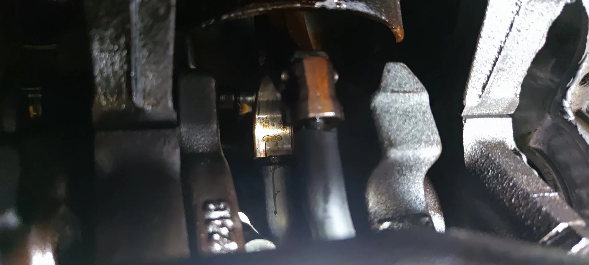

Good news! Found the problem when scouting flexplate health again and how to drop k-member. I removed serpetine belt and wiggled balancer .....
Bad news! I have crank front to back play, roughly measured a whole 1.3mm or 0.051" (close to 1/16"). To be exact I must get dial gauge.
Now, the HB play is followed by flexplate hence I know crank has a play....
Pushing HB front and back is very, very close to knock sound I hear on idle :-(
According to play, what may I expect down there? Thrust bearing, beaten bearings or machining?

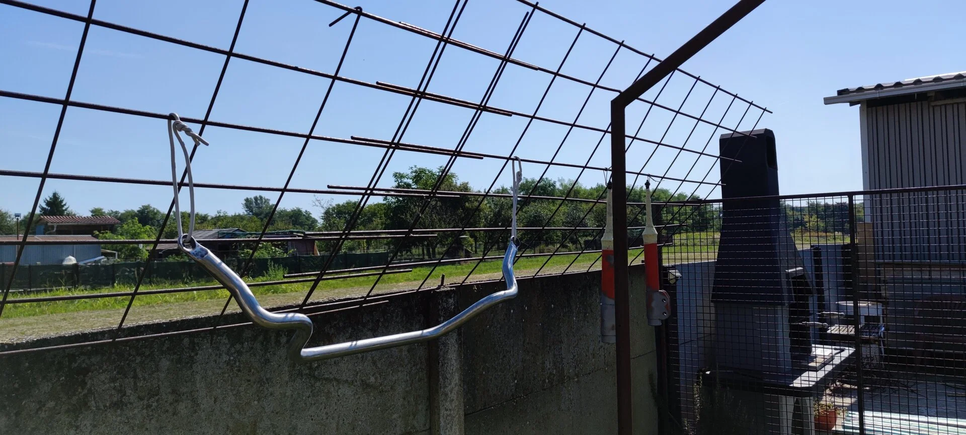

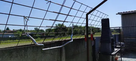

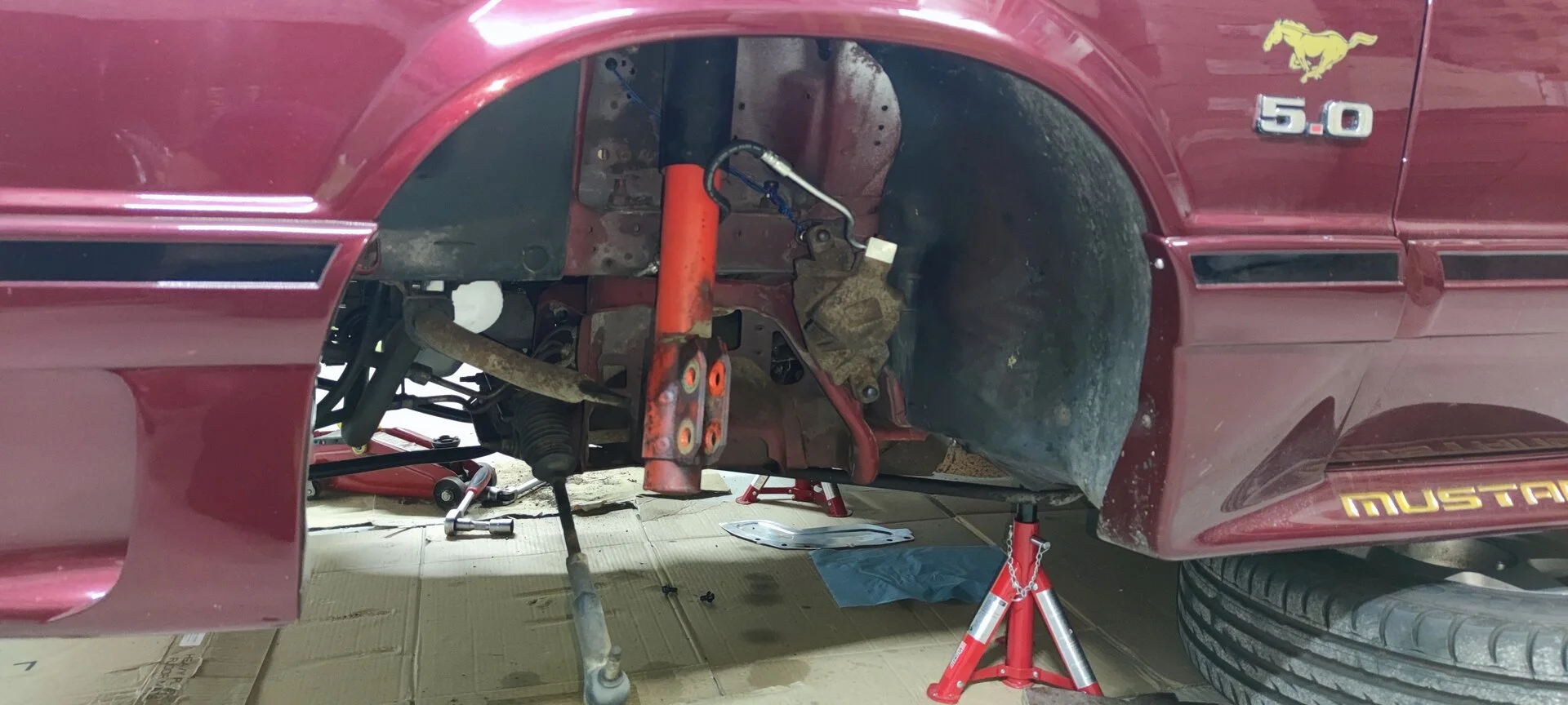

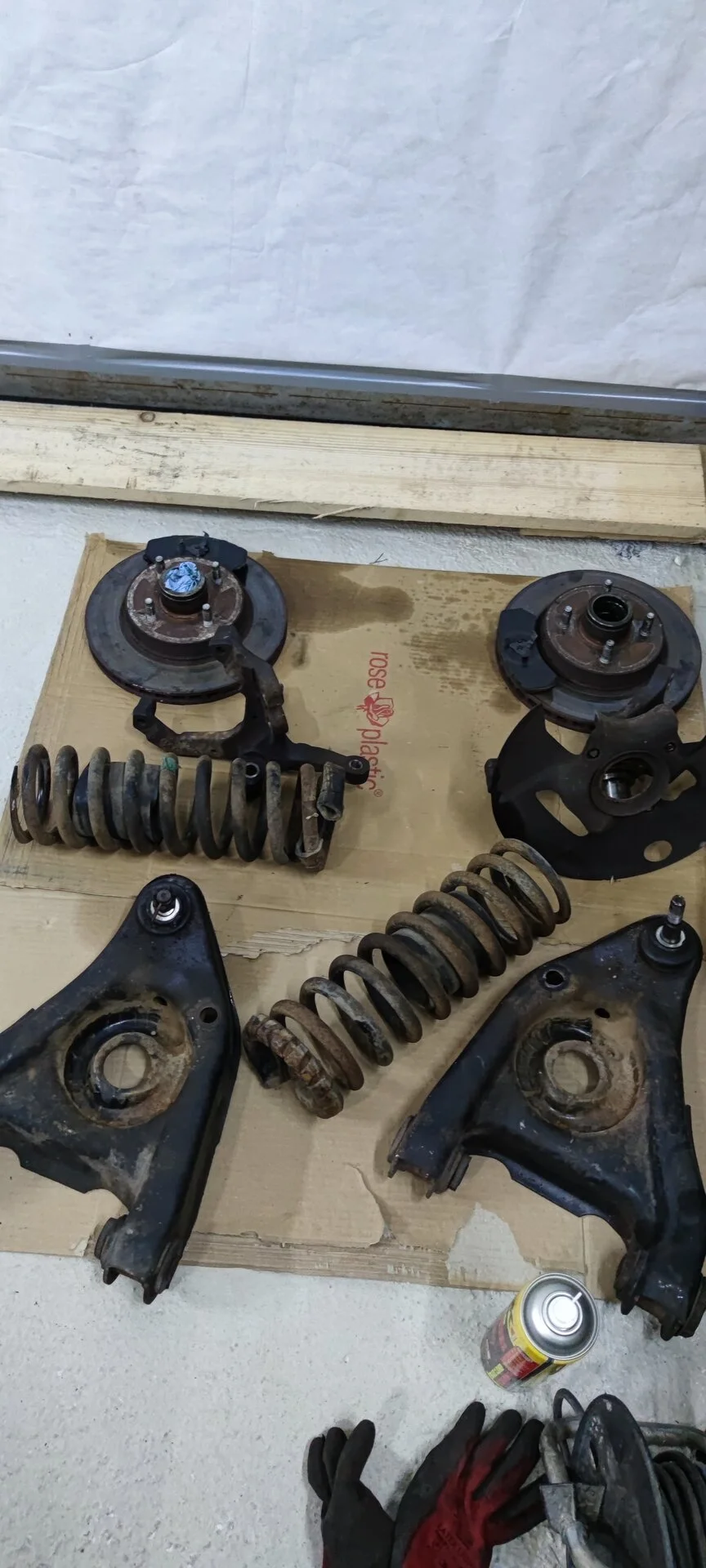

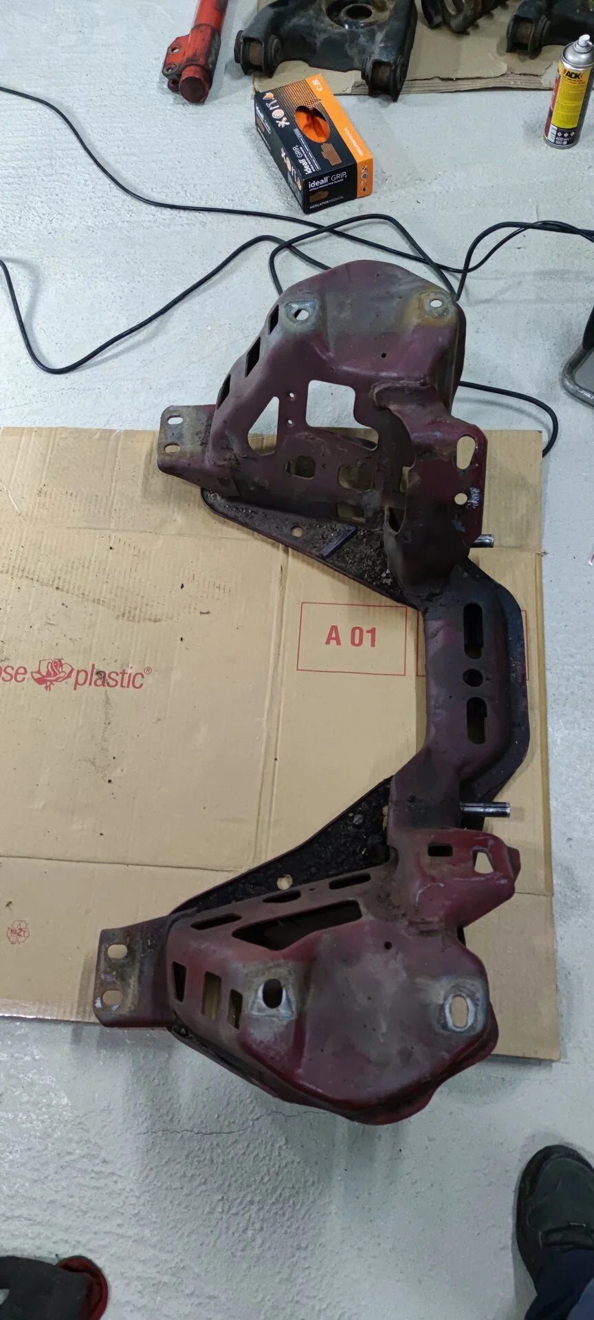

10pm and k-member is finally down. I was affraid of weight, but I can take it to sandblasting by foot. Ain't that heavy. I drilled two 3.2mm holes at each side of back two bolts to use as a dowel pin when I (hopefully) reassemble.
Instead of hanging it as recommended and hitting it with head, I took steering rack off the car, it was two bolts more .... I will do the same with sway bay (and powder coat) tomorrow as oil will drain...
Oil pan is exposed, but it was late and cold to my pal in garage (rhodesian ridgeback) so we closed the day before draining and lowering pan... Prayers are on.... keep fingers crossed.

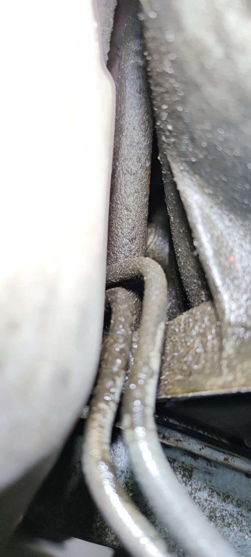

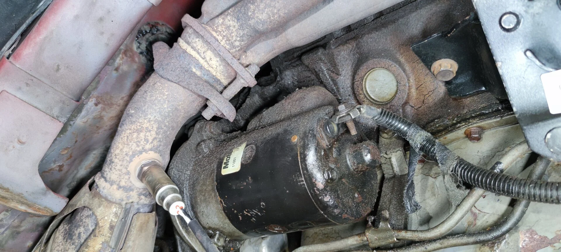

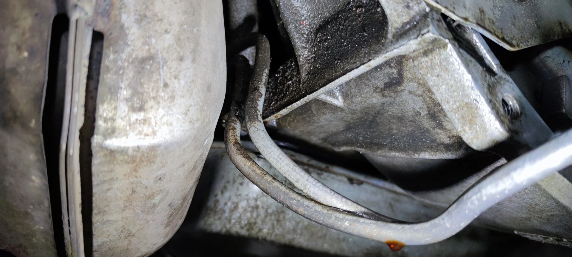

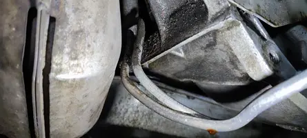

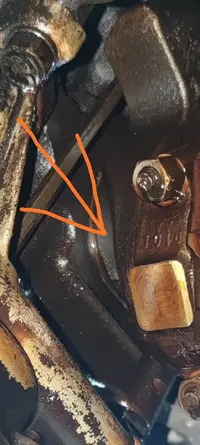

I saw some old sludge above starter, but I also have leak somewhere around tranny cooling lines. This car has a leak history (valve covers leaking and loose and PCV out of engine when I bough it).
The question is could the sludge above starter be a rear main seal leak? (I attached pictures)

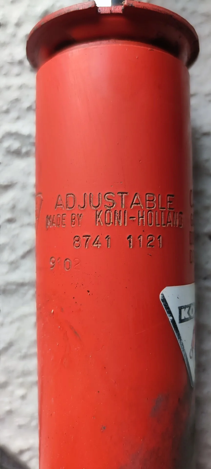

And a good thing in all this mess...everything I touch is stock on car and I didnt know but I have Koni adjustable front shocks (I assume also at the back as they are also orange Koni)
Reactions: 90sickfox

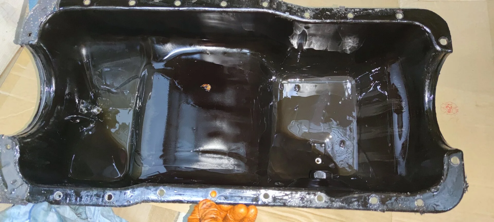

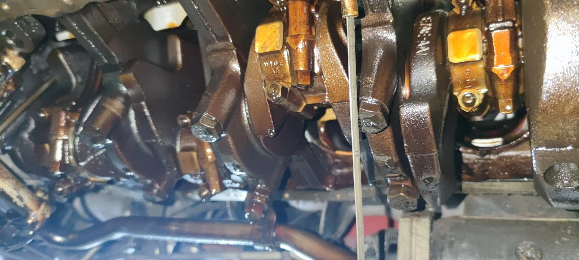

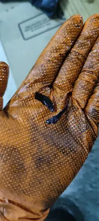

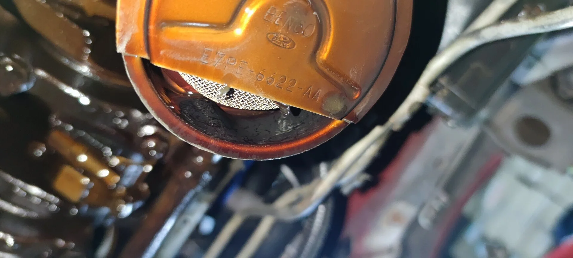

Ok, late here, again 10pm and the pan is off.
Didn't take caps off, just analyzed battlefield:
-oil pan has a coating flaking off between humps, otherwise pretty clean...
-pickup screen had some 1" silicone (not as much to restrict flow I think)
-oil pump is coated with sludge, normal?
-rods have side to side play (axial front to back of engine), a lot... approx 1mm (didn't measure)
Didn't want to proceed without mechanic present. I may not see obvious fault...
To me, a bit dirty but it looks good in general apart from rods side to side play.
Bearings to be checked...
Pictures attached if You see something...

Hard to tell from pics. The oil seems to have a gray metallic color. You'd have to pull the bearing caps to really see what's going on. Bearing surface condition will tell the story. When putting bearing caps back on use assembly lube on bearing surface, keep them in same position, and torque to spec.
Reactions: General karthief

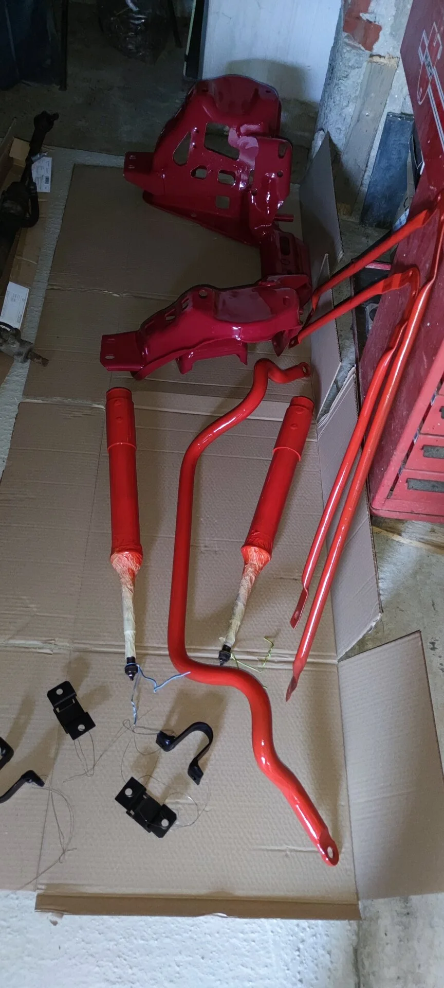

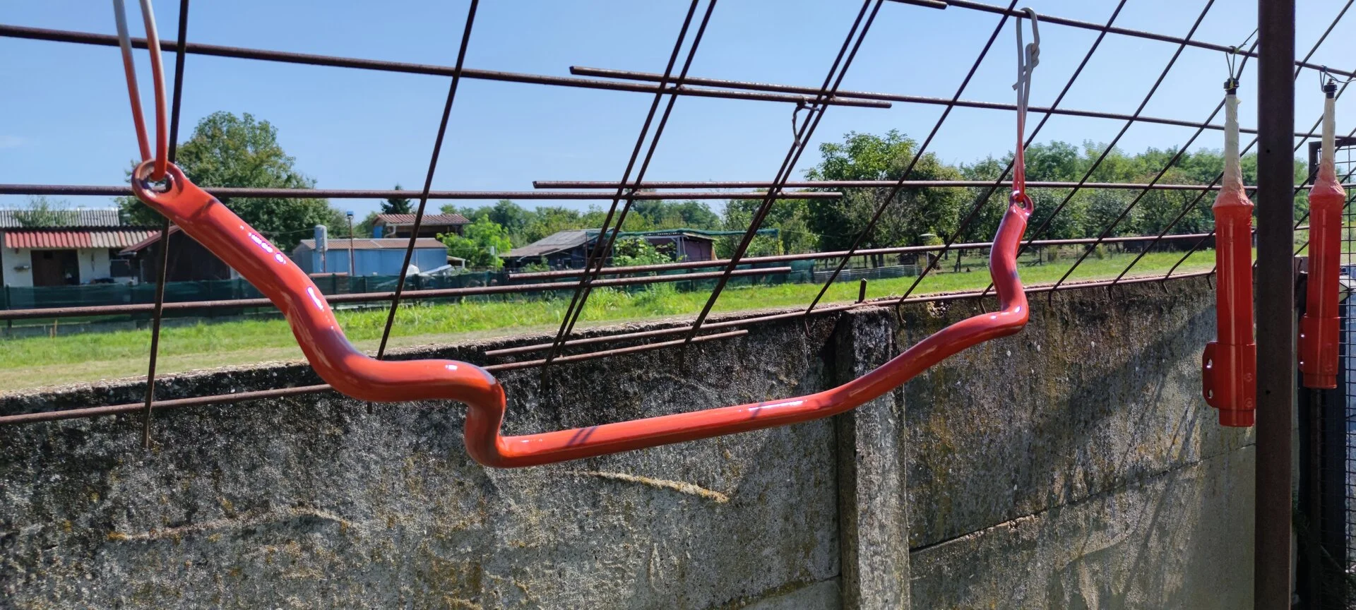

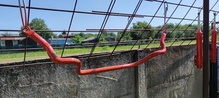

Pulling the engine.... you see on pictures of my sway bay what I mean when avoiding it: It was stripped to bare metal and then painted in Koni orange leftovers.....
That is why I am affraid to pull the engine, it will be a total rebuild...

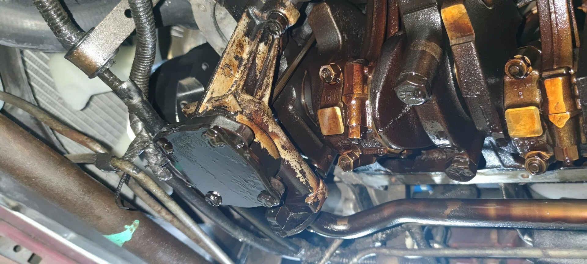

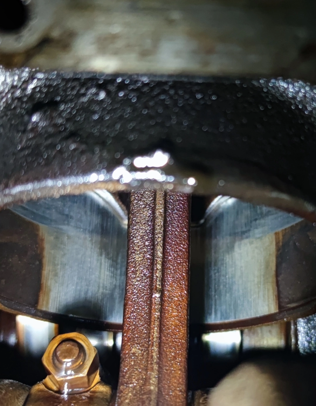

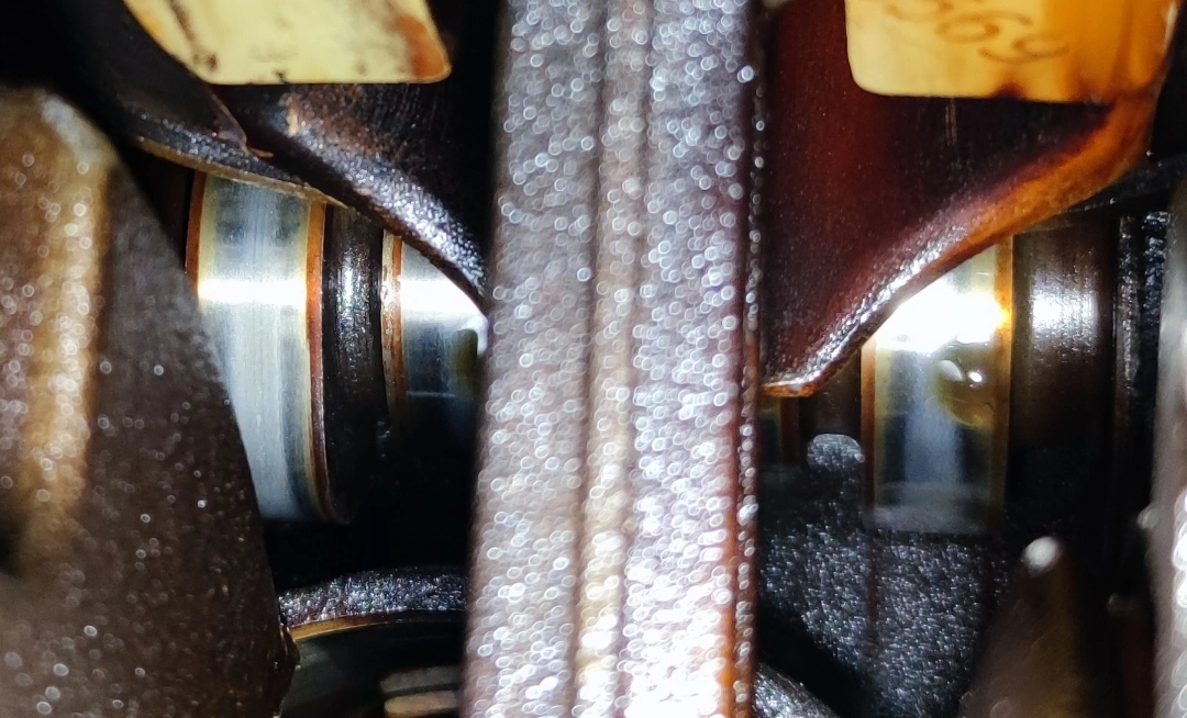

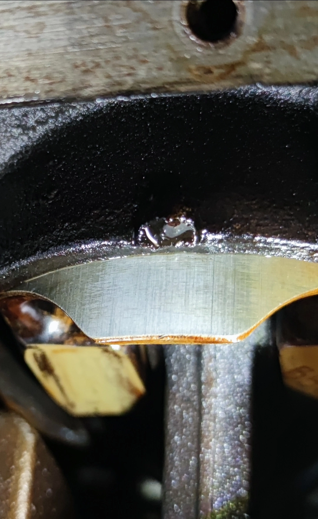

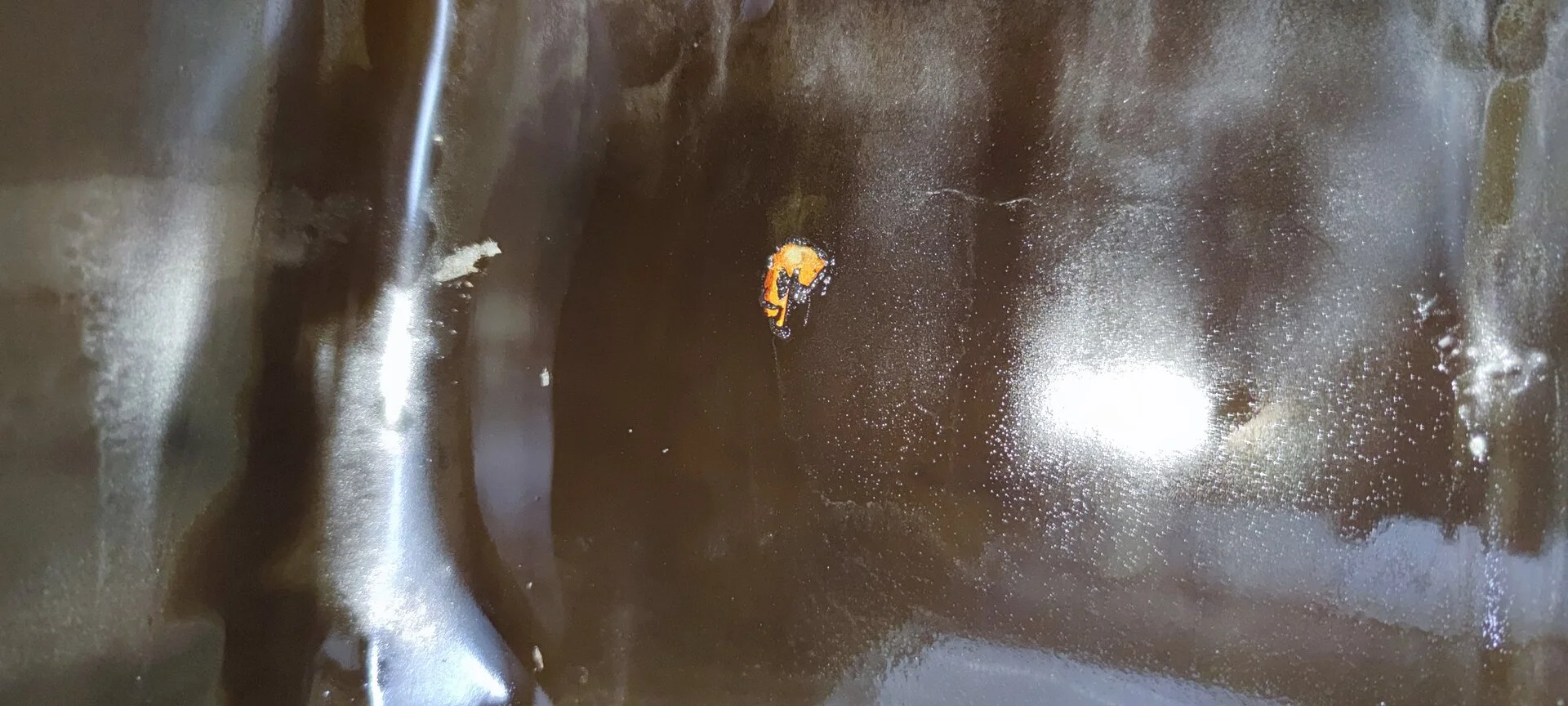

I have attached pictures of bottom piston skirts, cylinder bore bottom end and cam lobes in distance...
Is this scuffing on skirts and cylinder walls "normal" wear for 90k engine?

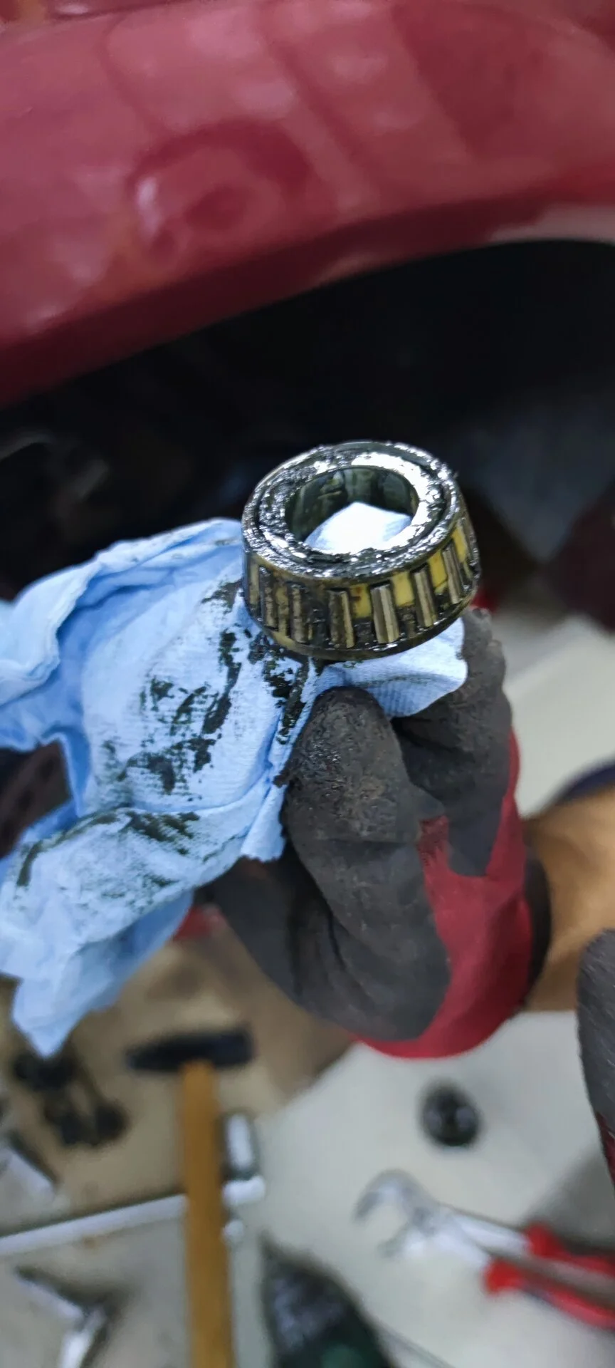

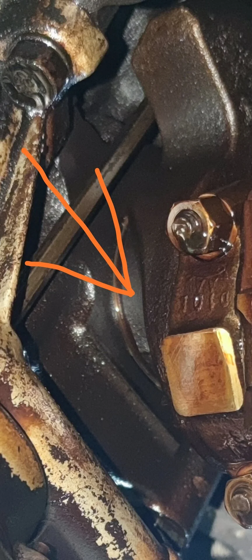

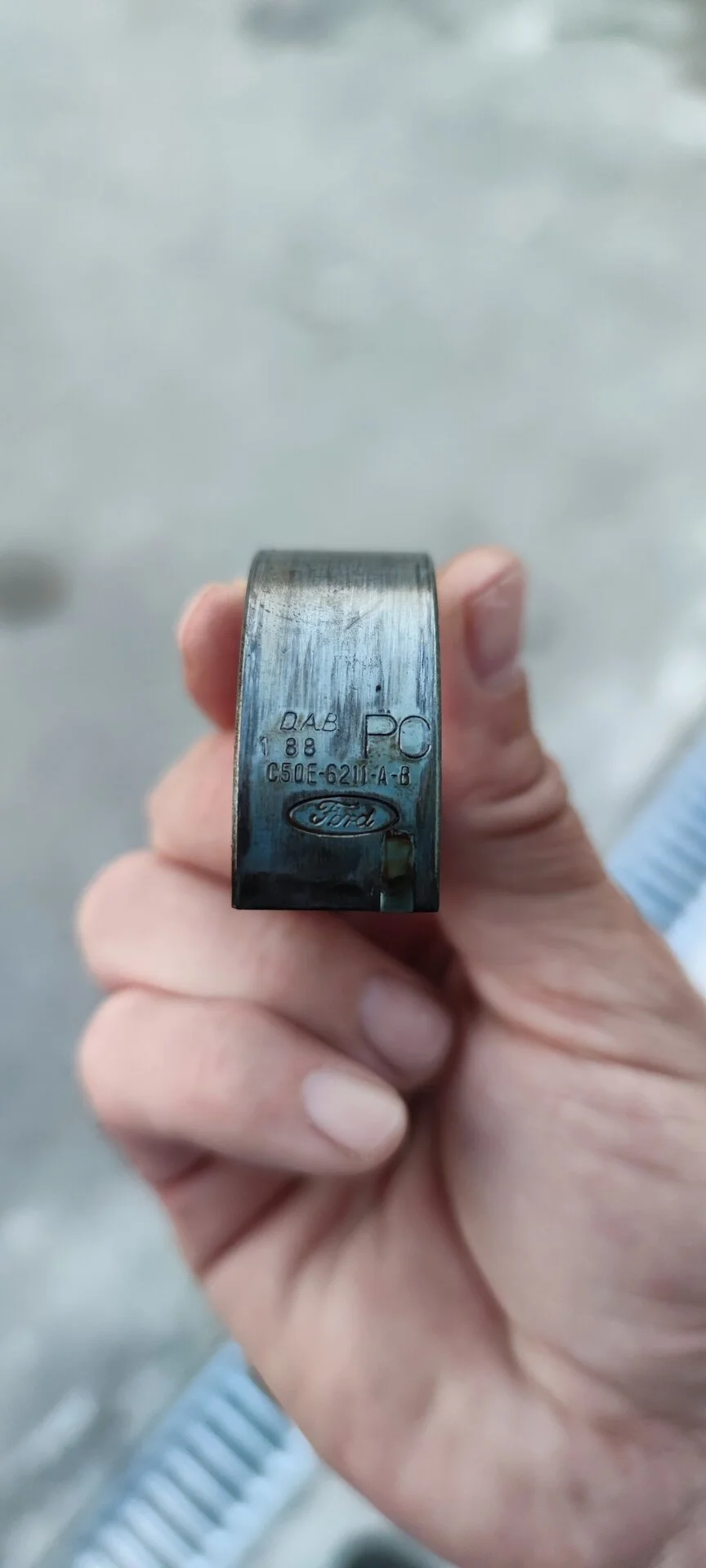

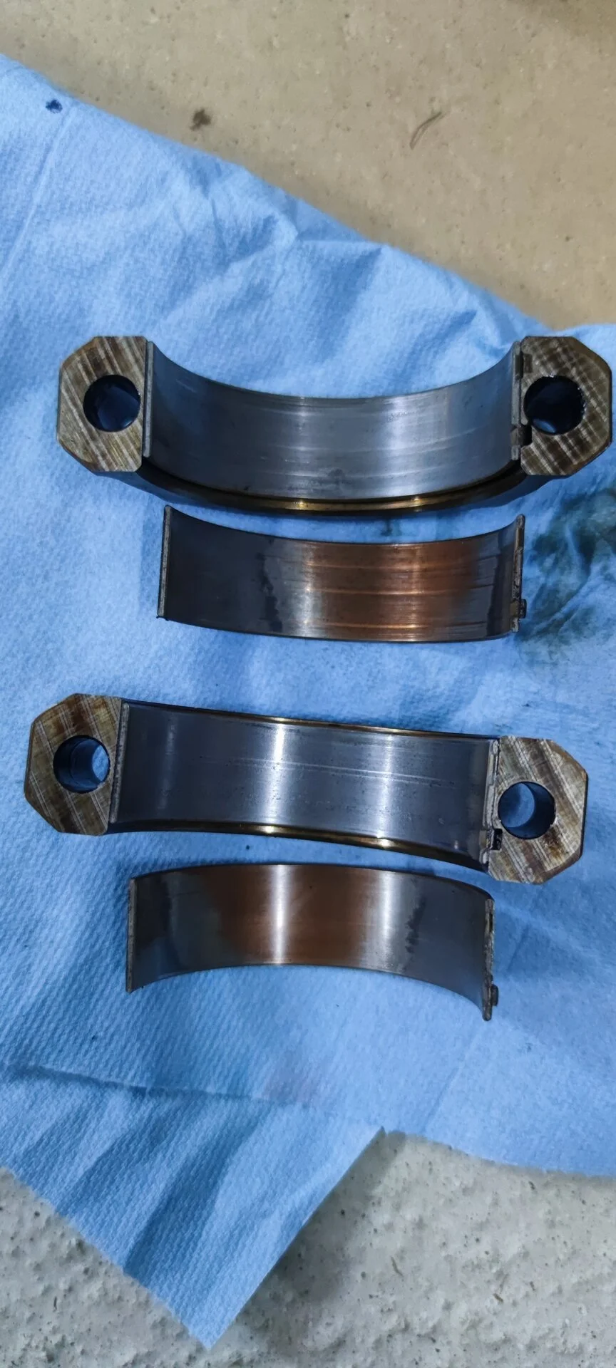

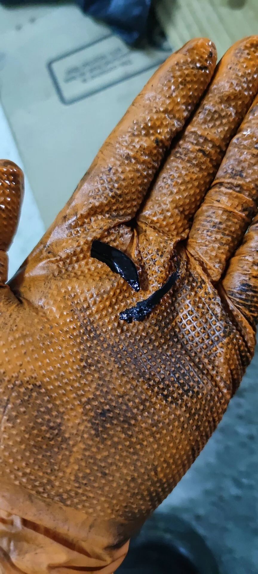

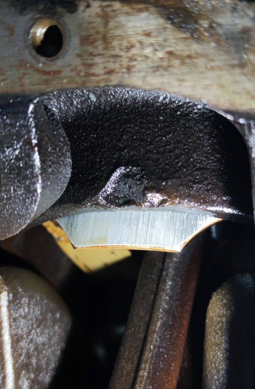

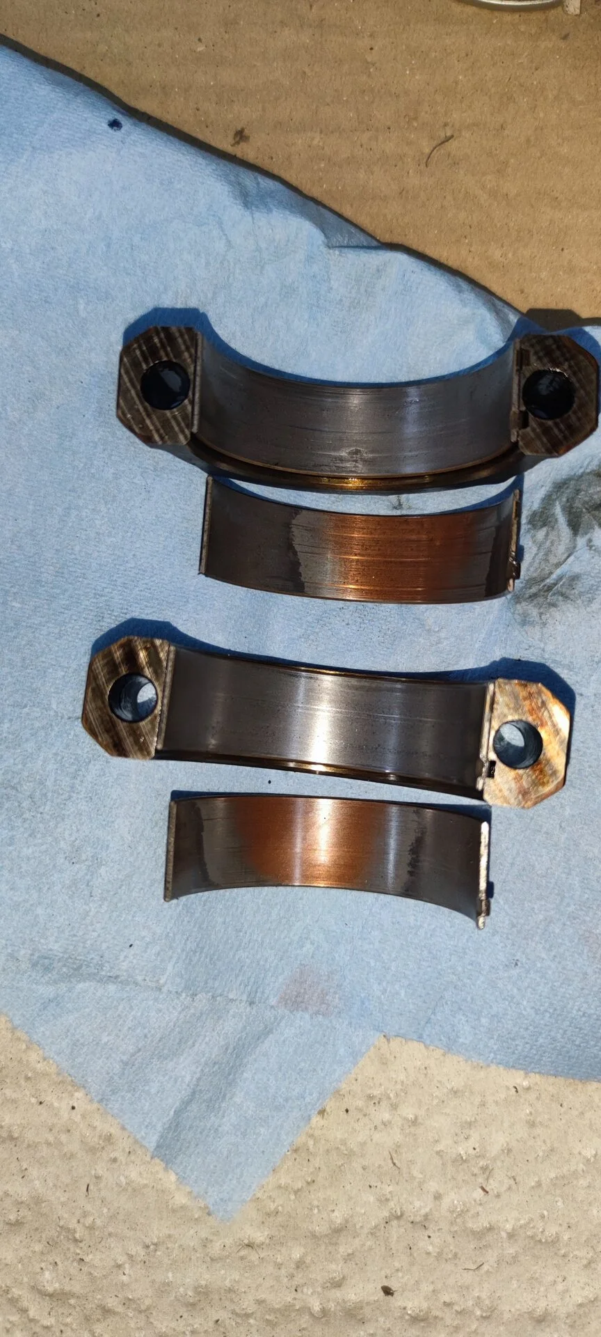

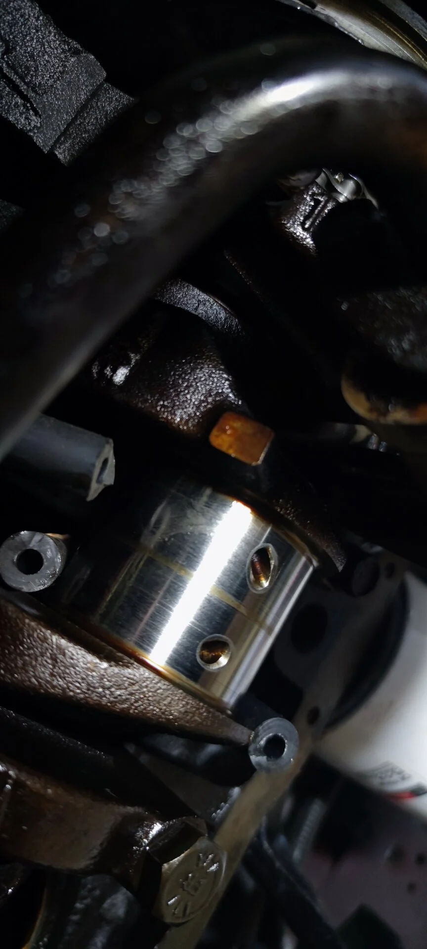

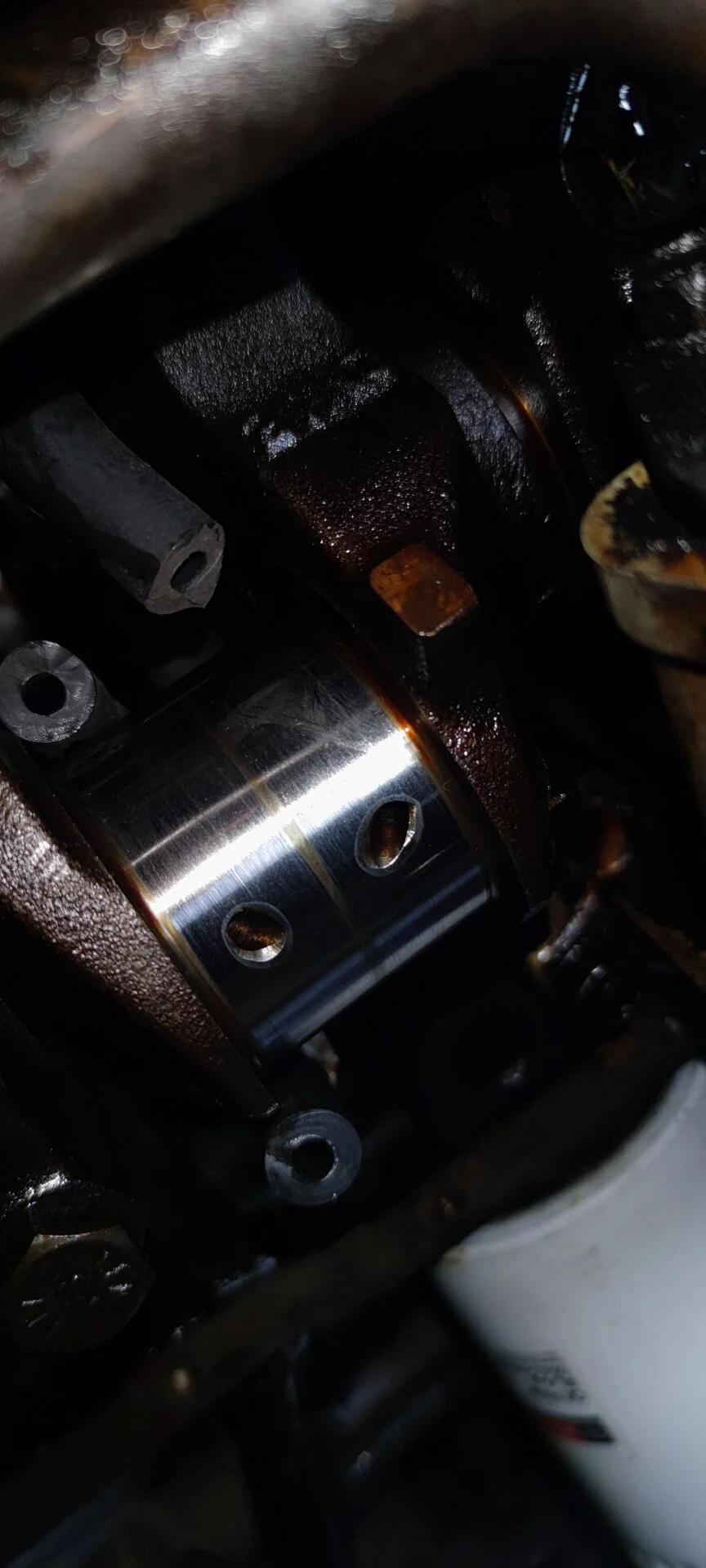

Okay #1 and #5 (first journal) upper OEM Ford 1988 bearings are shot. Copper showing up... crank looks okay, a bit polish only needed...
Can I get by by puttin in new std bearings?
Hard to tell, but could this really be a knock source?

The crank can be worn without showing on the surface. You'd have to measure it horizontal and vertical. You don't want an egg shaped crank journal. That engine looks like it's due for rebuild. The piston skirts and cylinder wear are what I'd expect from 90k mile car. At this point the skirts need to be measured and cylinder bore checked.
The short answer to your question is....you could try standard bearings. New bearings would be better than what's in there now. The engine was on its way out.
The knock could be a wrist pin or the thrust bearing. Hard to tell without actually being there to hear the noise. The crank could have easily been knocking from the space from the worn bearings too.
If I were me I'd pull the engine and rebuild it. However, you would loose nothing but the cost of bearings replacing them and putting it back together. It's easier to take time to have an engine built when the current car starts, runs, and drives. You know what you have now and could get some time to get the money and parts together while still driving occasionally.
In reality you could but the car back together with just the new bearings and your knock could be gone. Crank pictures look OK but I'd want to measure it to be sure.

I have no experience, but bearings which started to show copper as on 1st journal should not hurt crank due to design (hopefully).
If the rest of the journals are like that I may get some road life to save for proper high quality/performance rebuild. This is a weekend car anyhow, but a proper rebuild should be done. It is clear now.

Knowing myself it will finish like parts in picture, ripped, stripped, coated, renewed... (wheel arch parts still at powder coat service)
