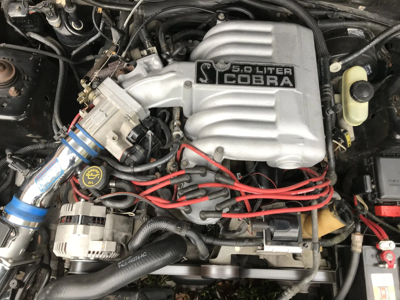

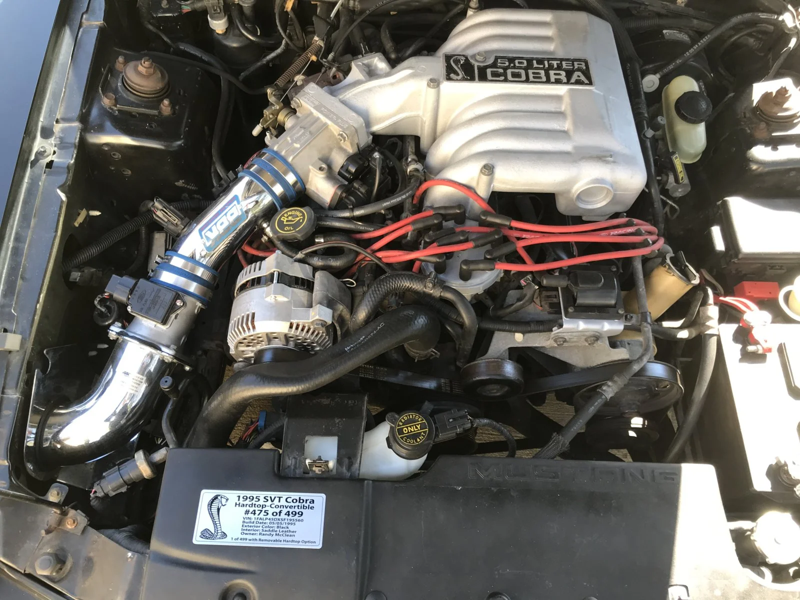

Did you disconnect the two big connectors behind the intake? One is black, one is white. Maybe they didn’t get pushed back together all the way?

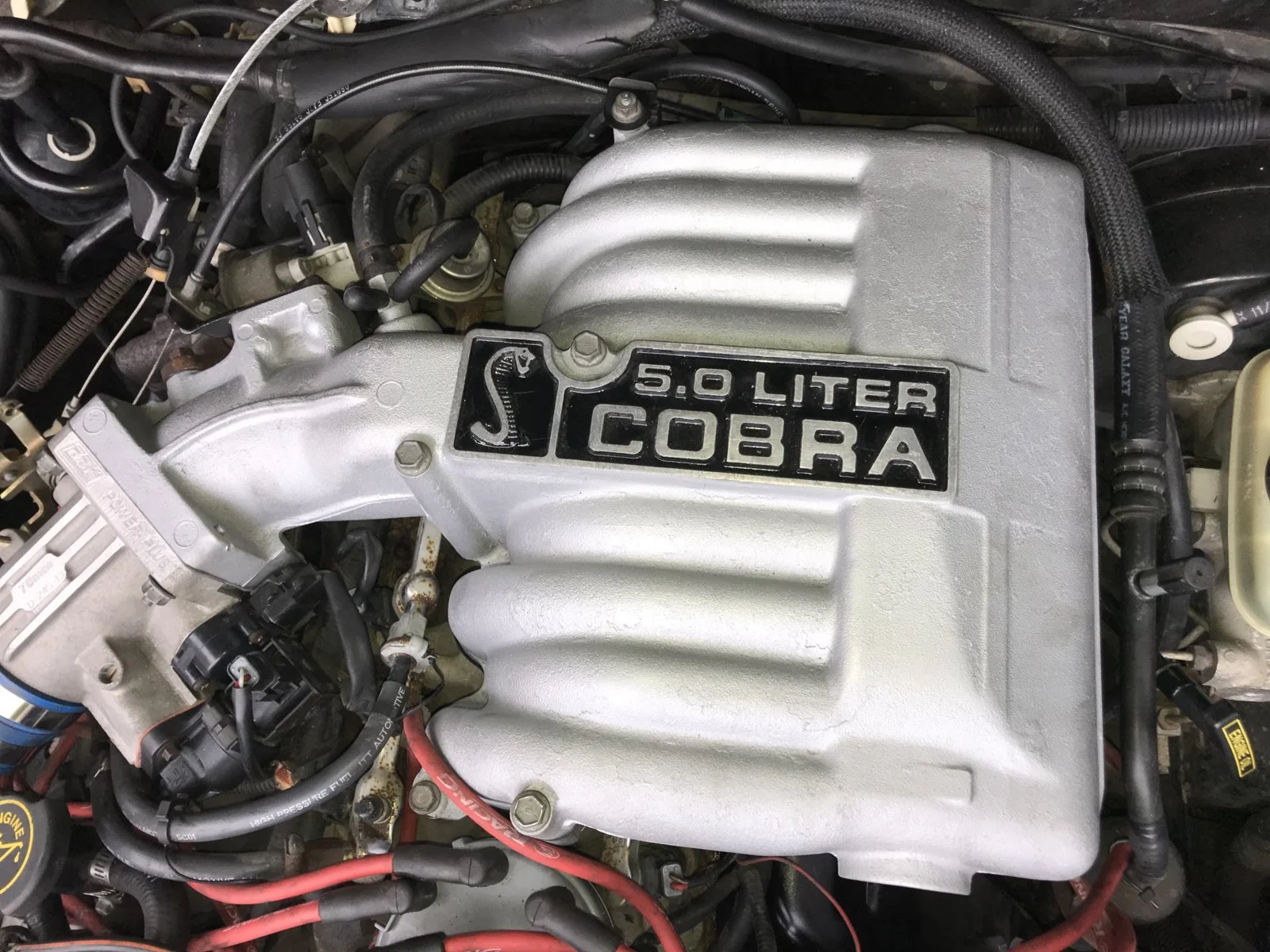

The coil wasn’t plugged in. After I did that the car didn’t stay running. Big vacuum leak. The hose running to the passenger side from under the manifold got caught between the upper and lower and was severed. After a run to the parts store with a new hose, I was able to dissemble and reassemble in a mere 20 minutes. Car started up and ran real healthy. Will post pics soon
Sn’s don’t have the salt and pepper connectors
That’s the biggest pain about putting the upper back on is avoiding pinching any vac lines. Glad it was something simple like a coil.

96pushrod said:
Sn’s don’t have the salt and pepper connectors.
I wondered about that after posting. It’s been a long time since I had my ‘95, lol.
OP, glad you got it figured out.

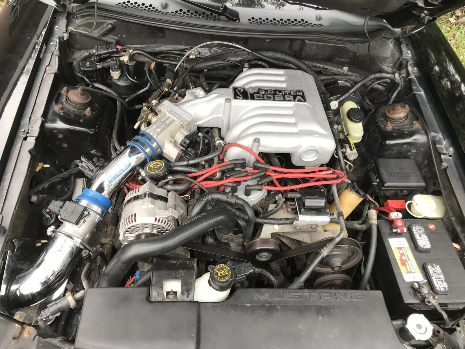

All put together now. All I need now is a distributor loom, and that radiator cover decal and the one under the hood. Hopefully LMR has them. Here’s final photos

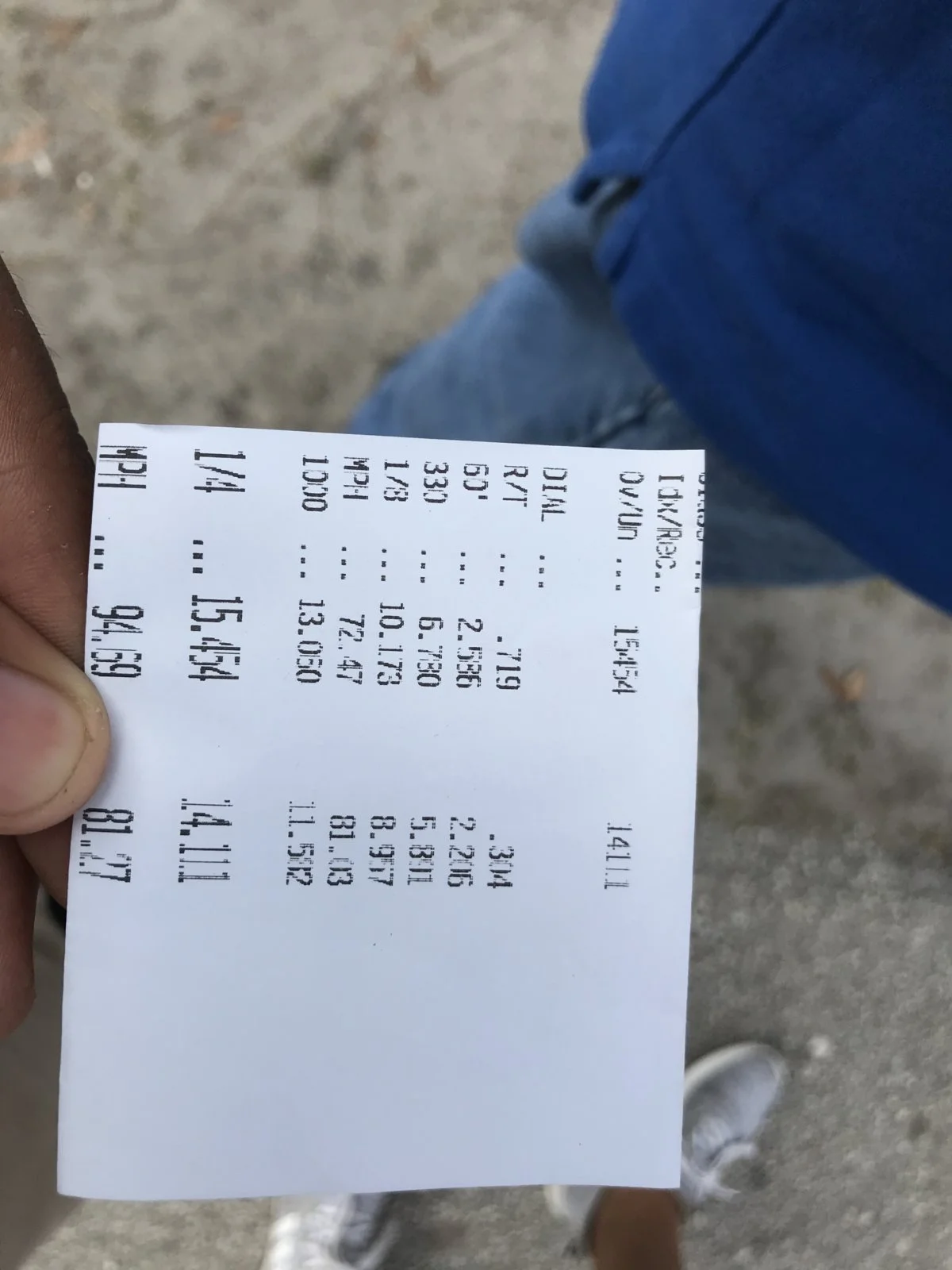

Ran the car down the 1320 for its and my first time. Wasn’t exactly pretty but it sure was a blast and I will be back

Super Embarrassing 60ft and ET due to me getting nervous and dumping the clutch so bogged off the line. Wasn't looking to cut the light either. Had a super good time though and only one pass due to it raining after me. Looking to get back out there soon and get the launch now. I know this car should be 14.6-8 if I improve.
Here’s the slip

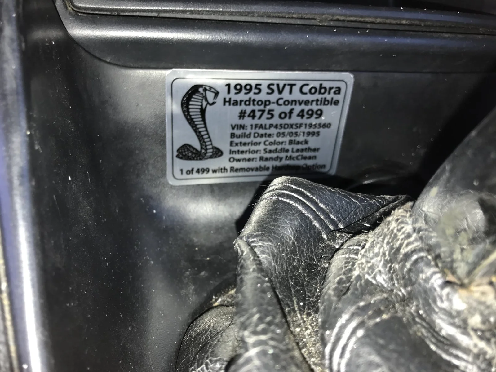

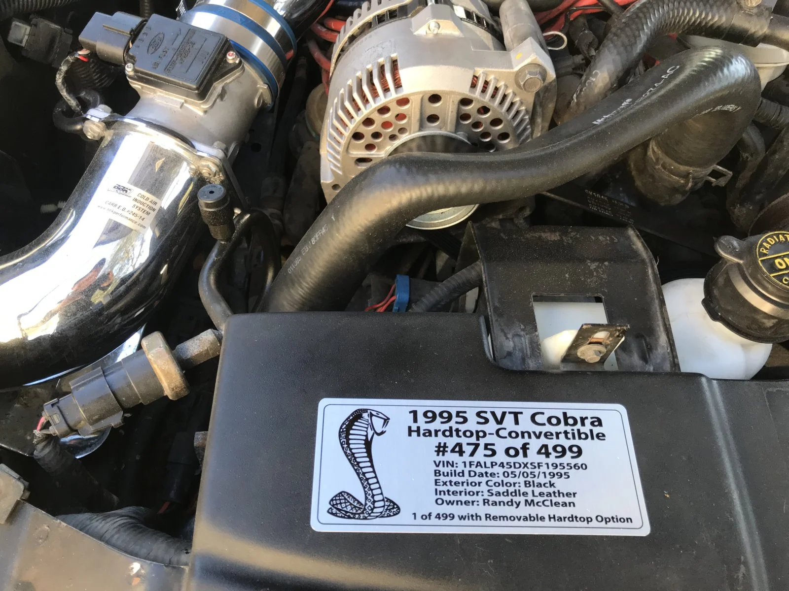

Also forgot to update a little something I got from the SVT store as a gift from my dad. Custom plaques for the Cobra. I absolutely love these and it adds a nice custom touch to the bay and interior
