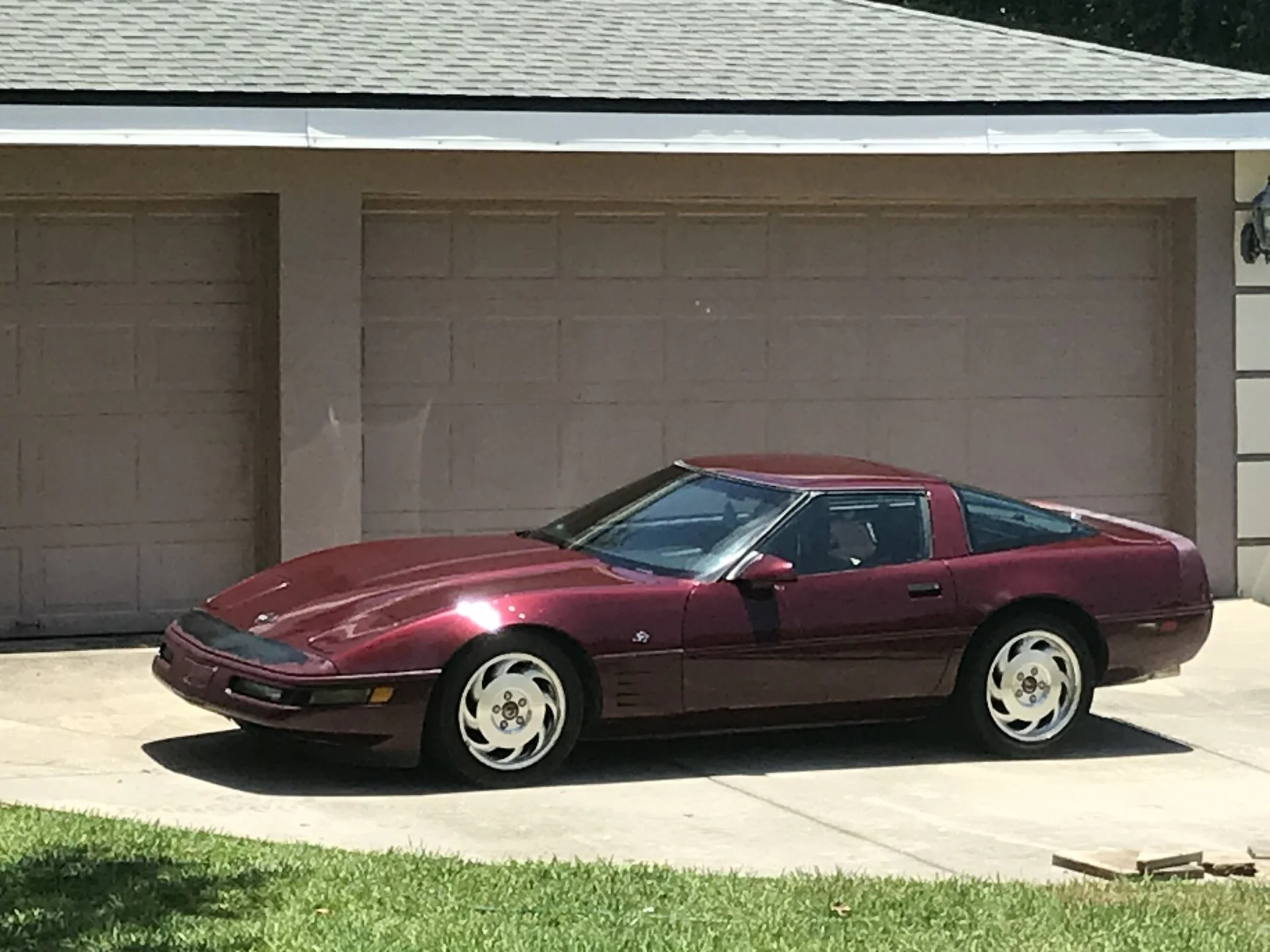

And my new project for the summer before school is to start painting. We bought a c4 vette in ruby red metallic that needs some paint work on the bumpers. I also want to repair and paint my wing and front fender. Got the compressor and a hf purple gun and all the necessary supplies. Should be spraying next week. Conditions are less than ideal but I’m optimistic for results
Reactions: General karthief

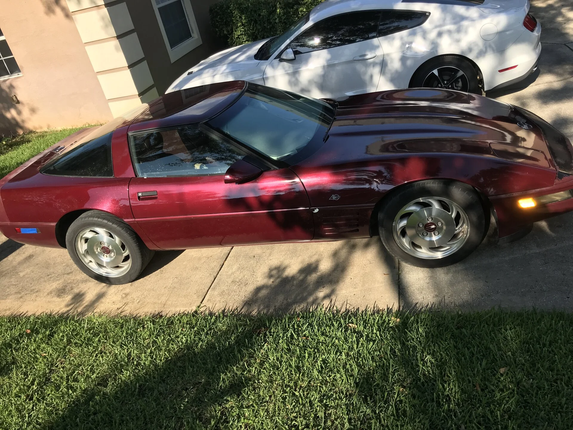

Test panel
And the vette project after a compound/polish/wax for those who care. Going to paint the bumpers on it

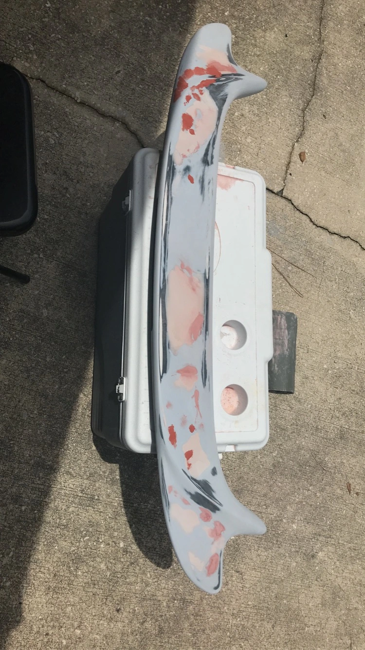

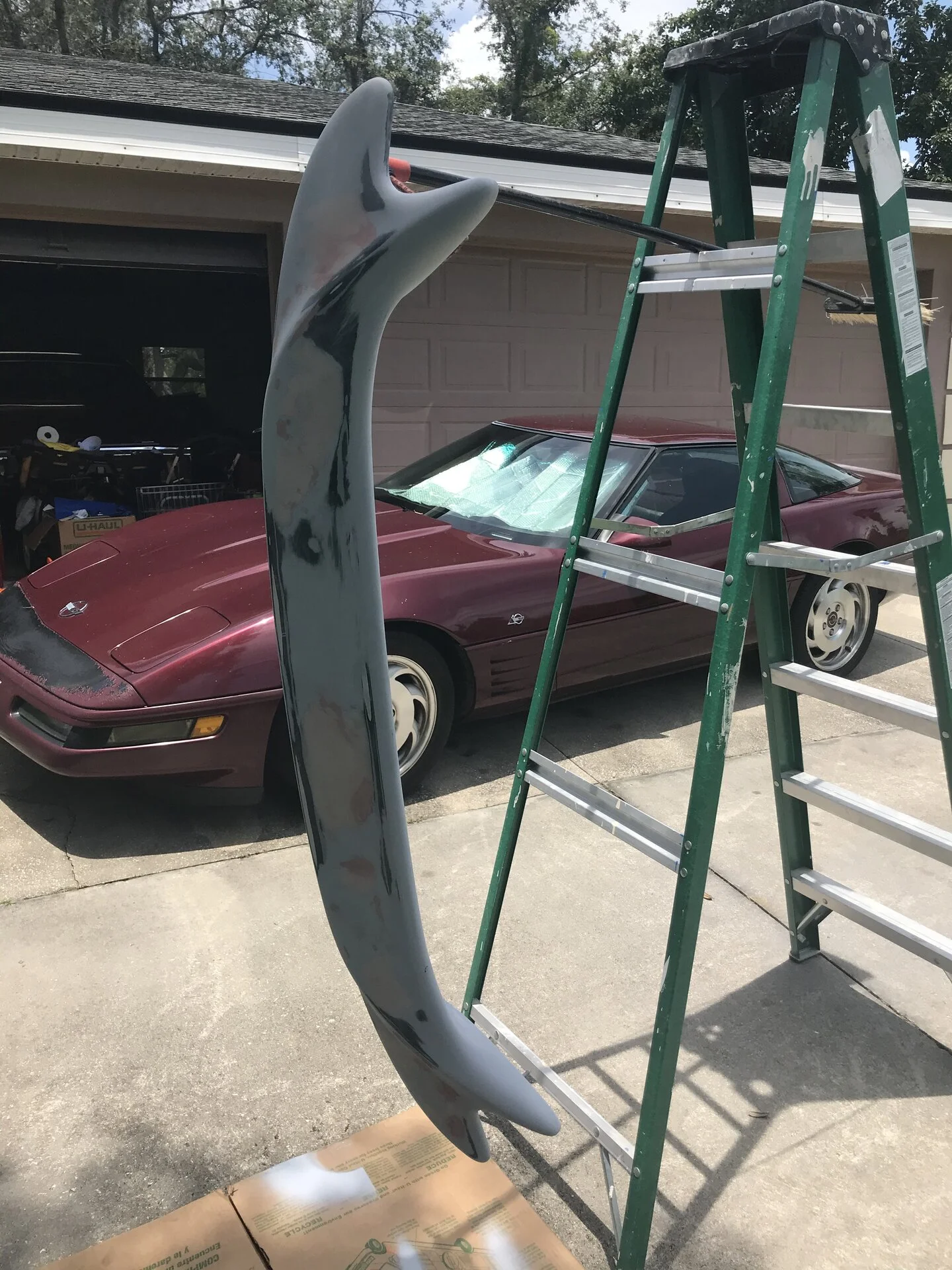

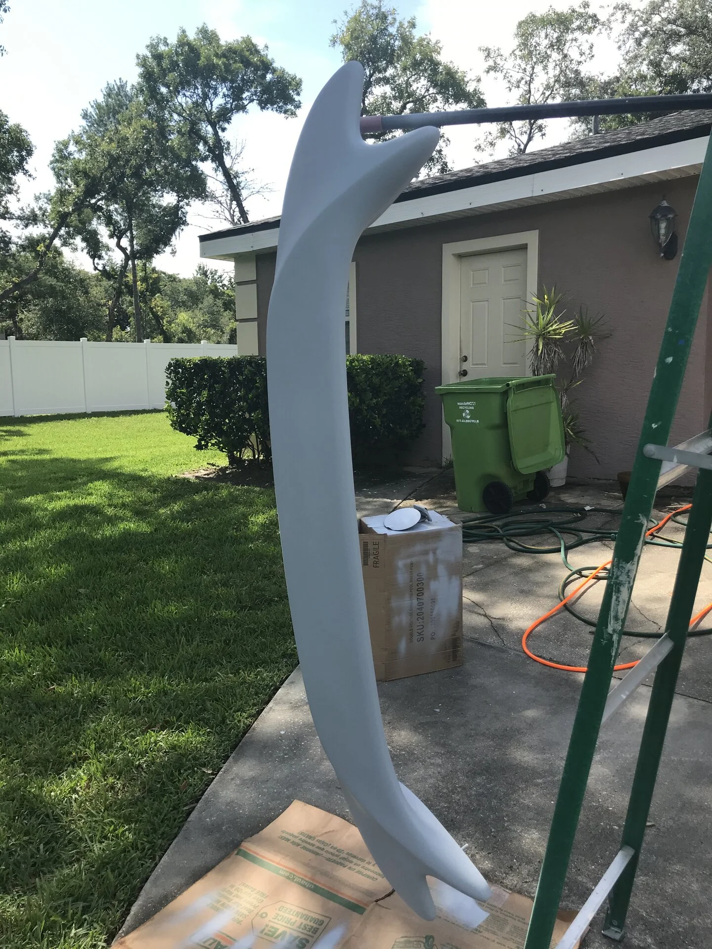

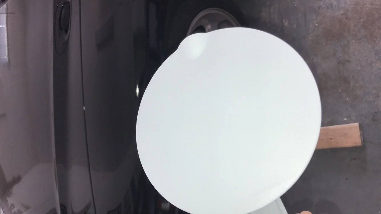

Fuel door and wing primed. Going to fill little dimples with some spot putty and give it another two coats of primer. Base coat should be here next week. And for all the paint guys, will medium hardener be okay for Florida weather? They sent me medium instead of slow and they don’t do returns and I’m in almost $100 for my clear

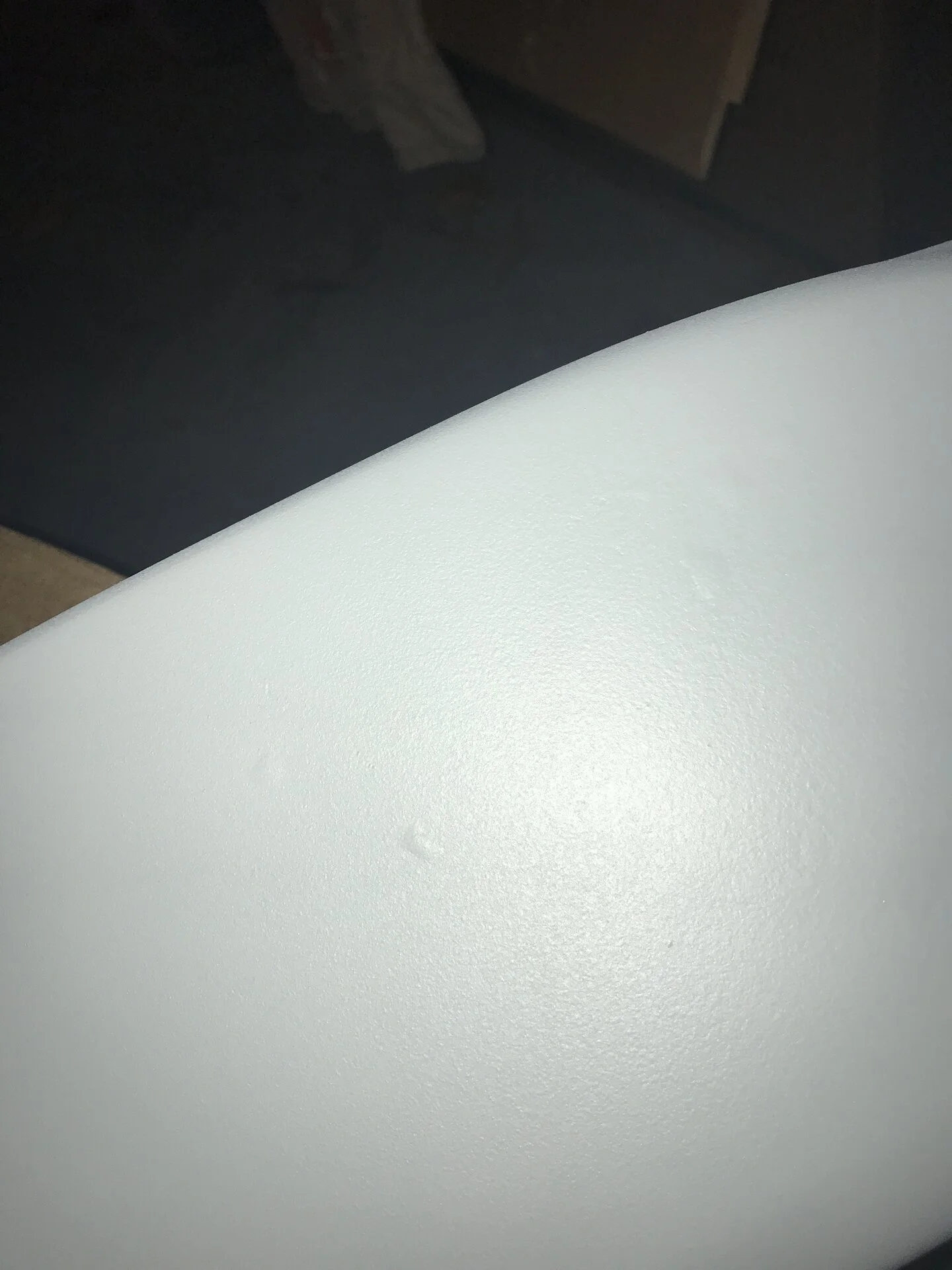

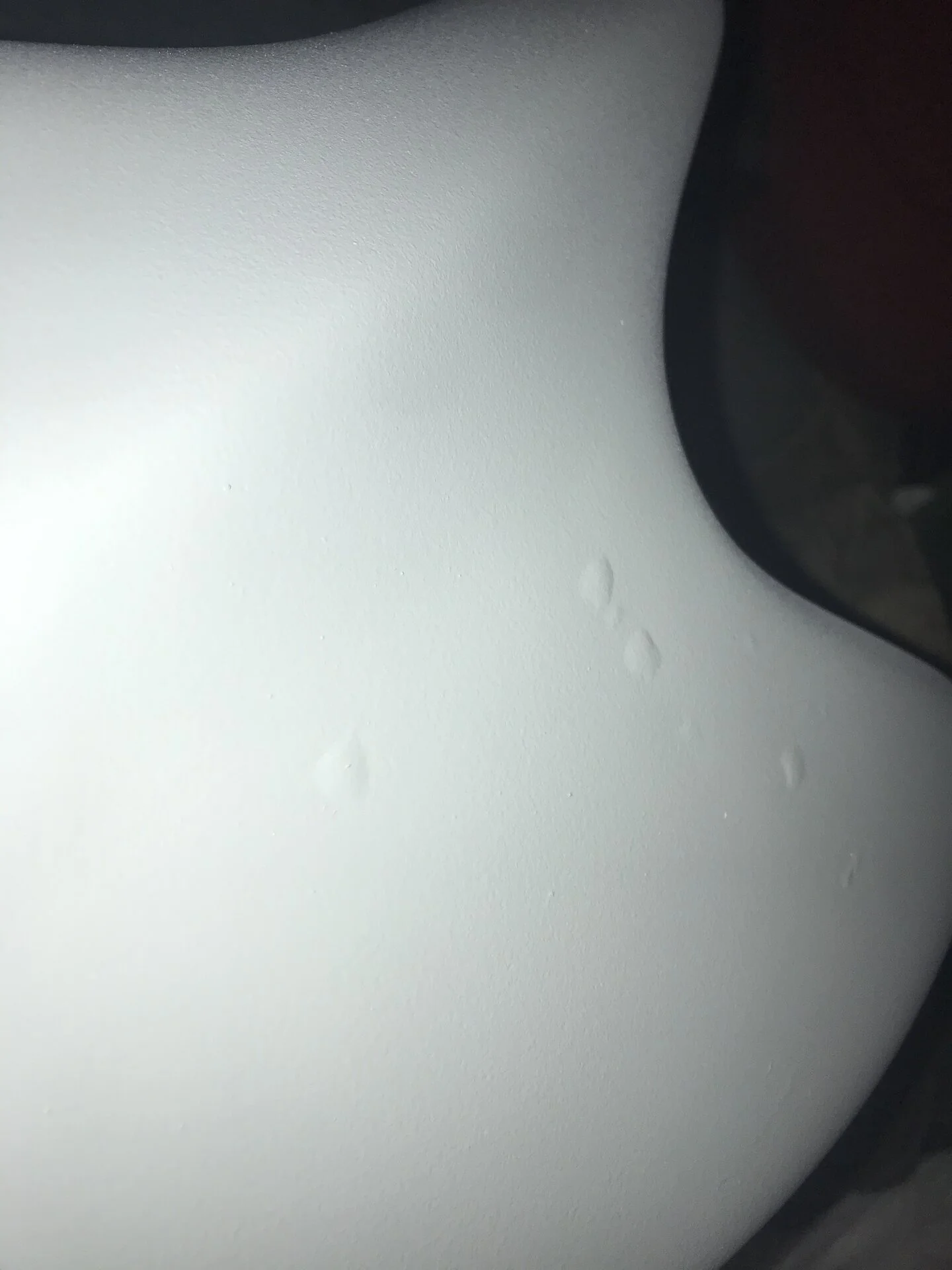

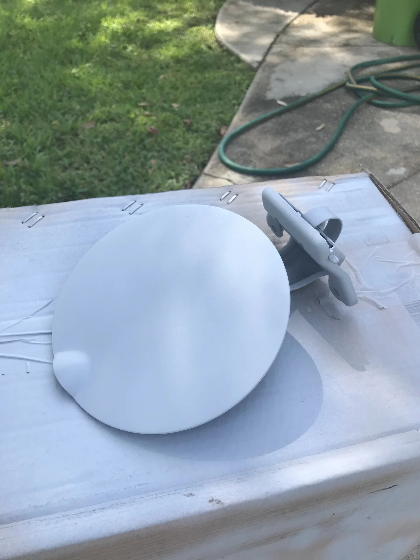

Sprayed 2k primer on wing and fuel door. Wondering what these bubbles are that came up While drying. Haven’t sanded yet but worried that I’ll have to redo it. See last pic

Not sure if it’s coincidental but it seems these bubbles are the same areas where glazing putty was used. Could it be gassing off or something?

Hoping someone has seen this before and can help. @95steedamustang maybe

Bubbles are in your filler or putty. You need to
Strip it all off and get down to metal or a good surface and start back. Then feather and reprime.
Sigh. I was hoping it wouldn't come to that.
Anytime you have something bubbling, the only proper way to fix it is to strip the area and start fresh. Otherwise your going to end up wasting all the material and time you put on it after that.
I did my wet sanding just to see and they disappeared. My primer calls for 220-500. Should I still strip it and start over?
Yes. And sand primer with 220 if your going to reprime. Sand it with 400 then 600 wet before actual paint
Thank you! Just got the base coat in today and am hoping to have the spoiler done by Tuesday. Also, what’s the difference between wet and dry sanding? I’m assuming not as deep scratches?

Not a whole lot. You just make less dust and most 400/600 paper is made for wet which most paper below that is made for dry sanding. Less dust before paint always is better
