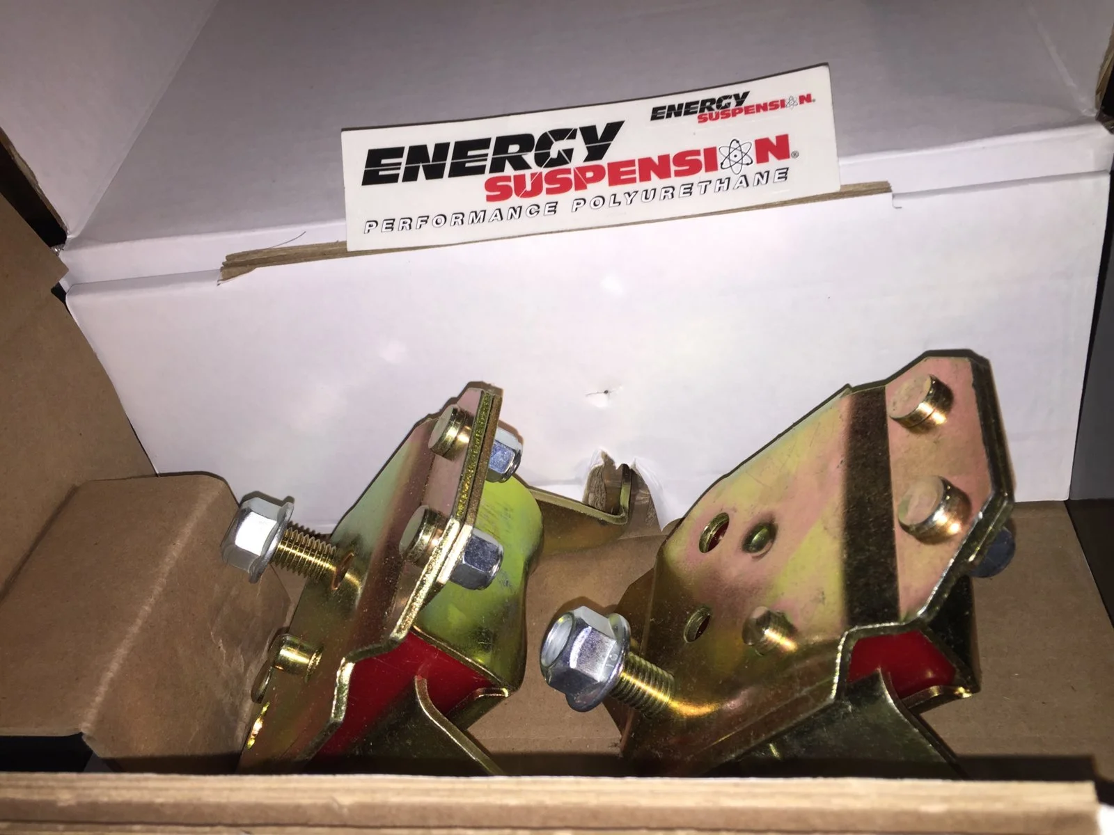

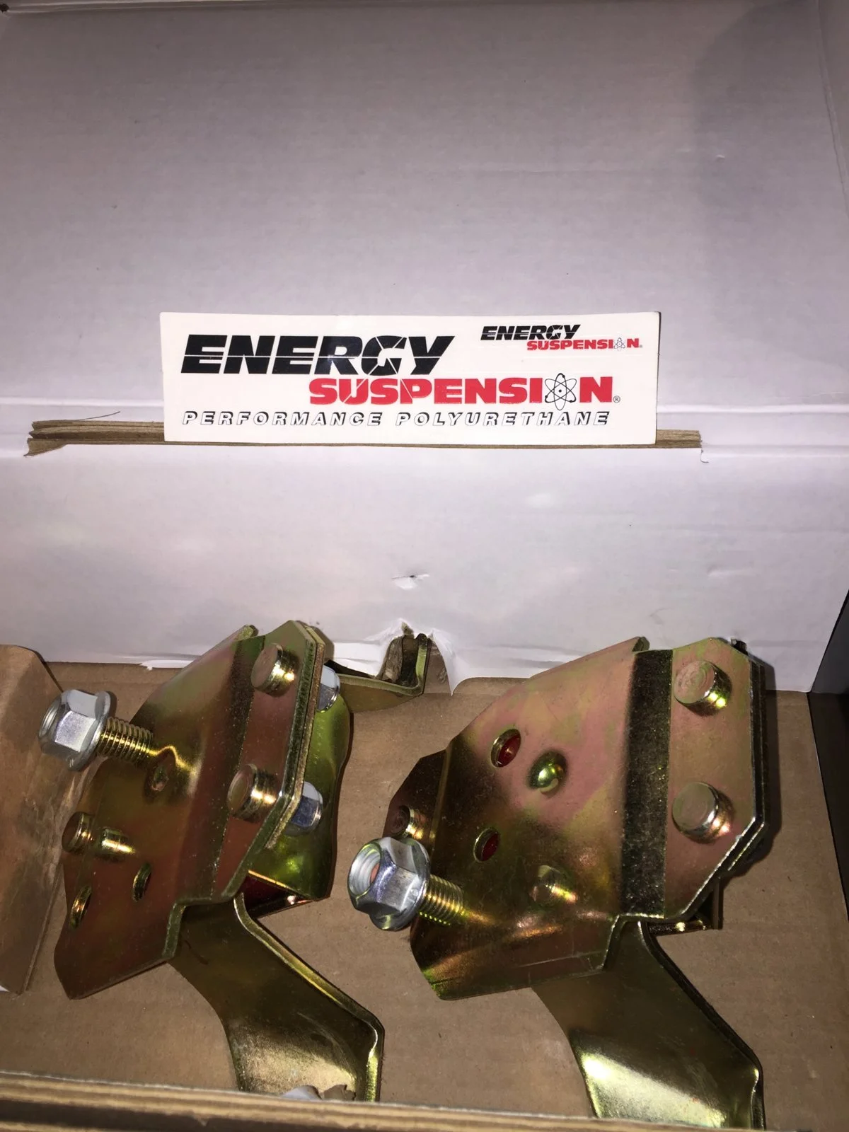

Just to clarify, we did poly because the rubber mounts we had which seem to be the common parts store part did not fit and we have seen many reviews saying they broke again in under 1,000 Miles. Energy suspension has wonderful testimonies through forums and vendors so we decided to spring for the extra upfront cost to get it done. Tomorrow we will have them in hopefully have the Cobra ready to rip again.

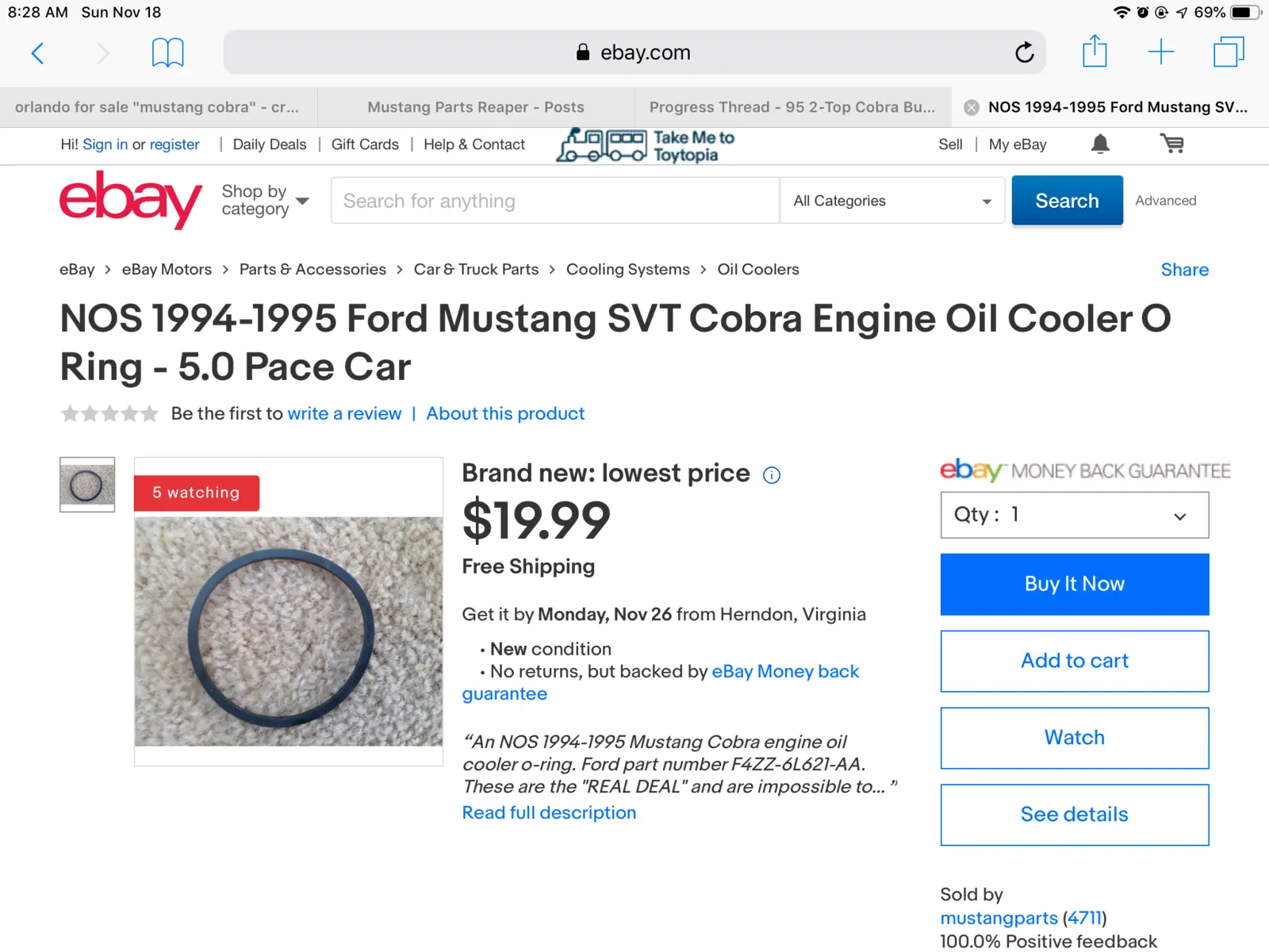

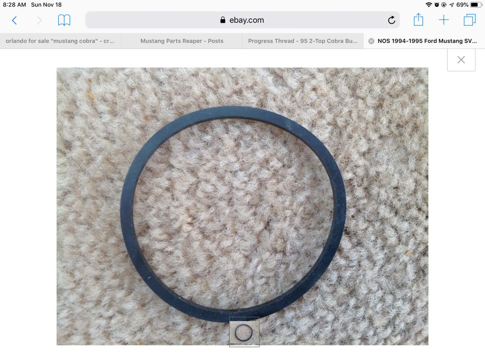

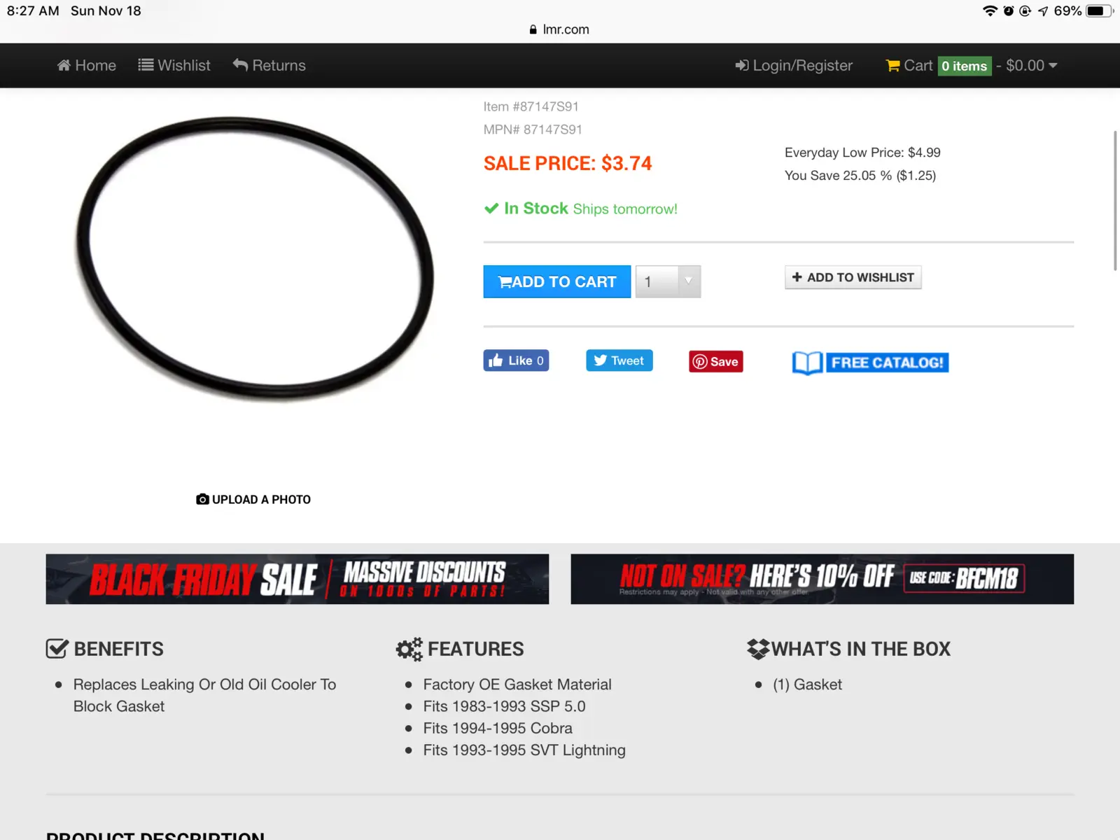

Motor mounts are in! Had to utilize a dog nose bolt to get past the initial bad threads in the block and everything fit into place nicely. Cleaned up the oil cooler and installed the new gasket from LMR, new oil filter in and buttoned back up everything we removed for the mm install. Started the car and oil began shooting out from around the oil cooler area, we suspect it is the wrong gasket because upon comparison the gasket lmr provided is simply an o ring shape while the oem gasket had a flat lip on the top. I believe this gasket was catered more towards the ssp fox bodies oil cooler even though they said it should work for 94-95 cobras as well. Now we must source a proper gasket for the oil cooler to block to get her back on the road
  • Sad
Reactions: General karthief
I swear that looks like a regular oil filter o ring... It's square edged just like a regular oil filter o ring. It may be shorter than one though.

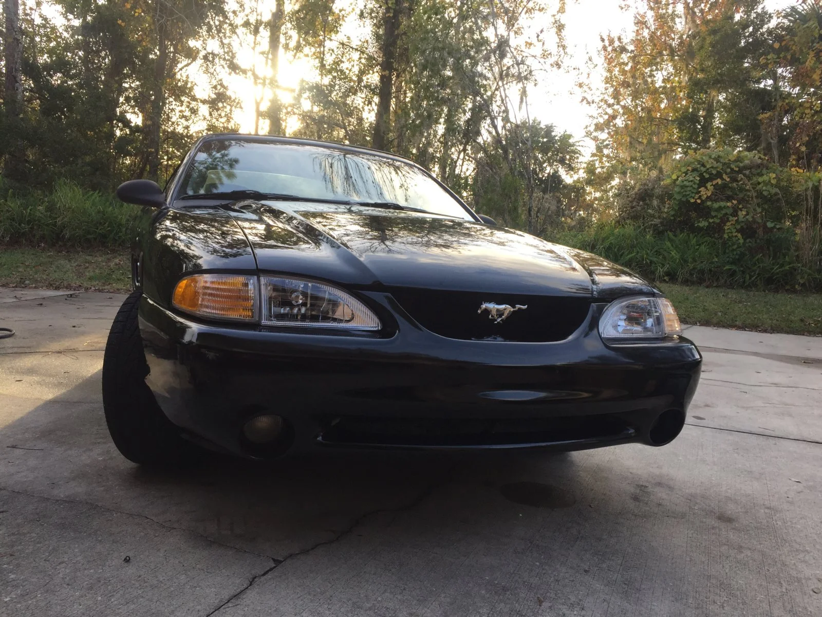

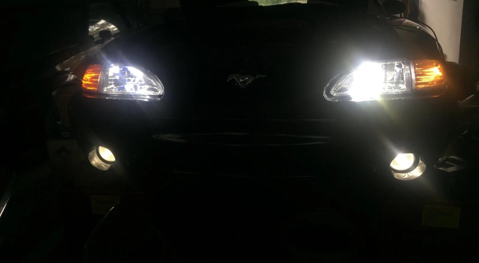

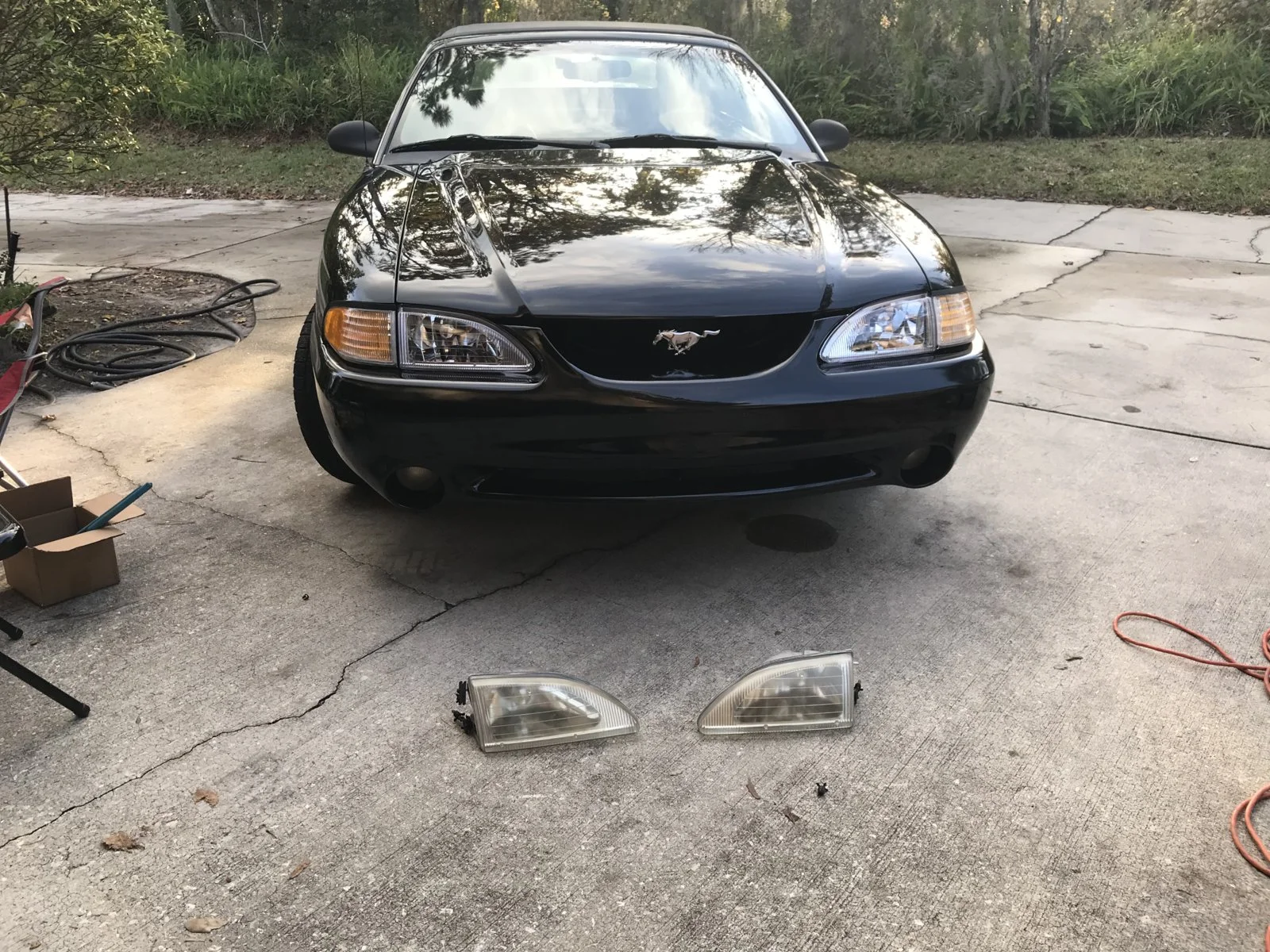

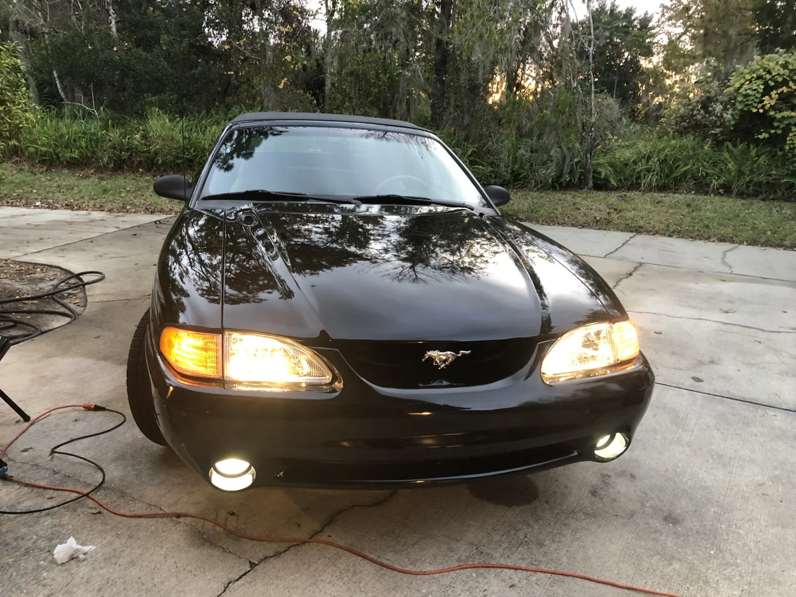

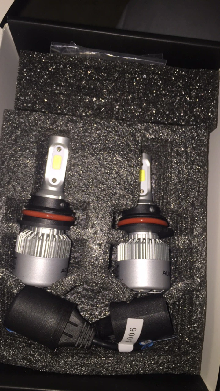

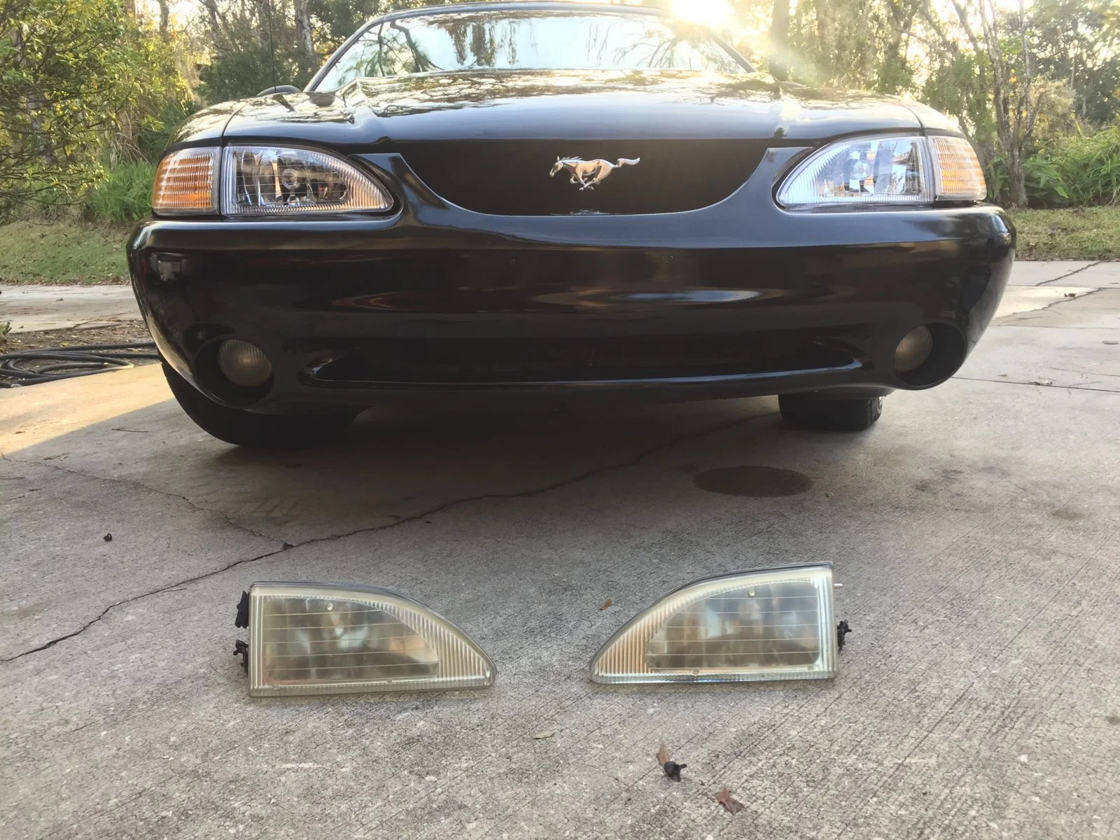

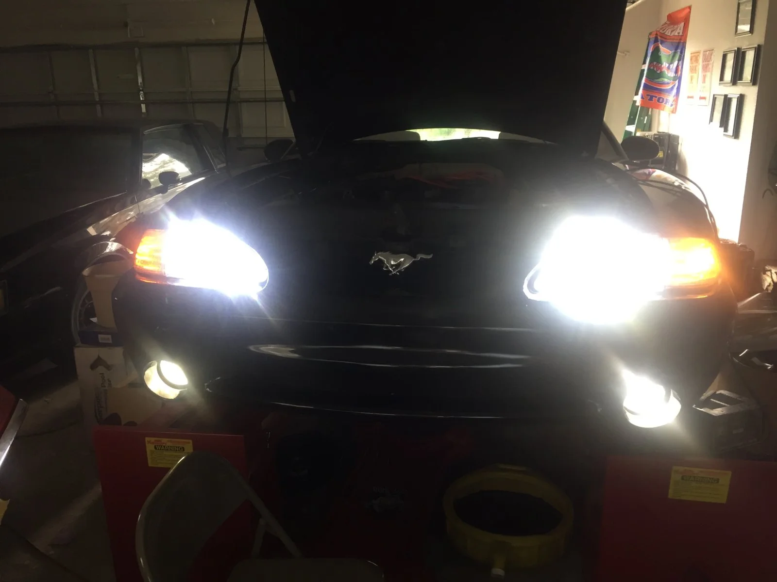

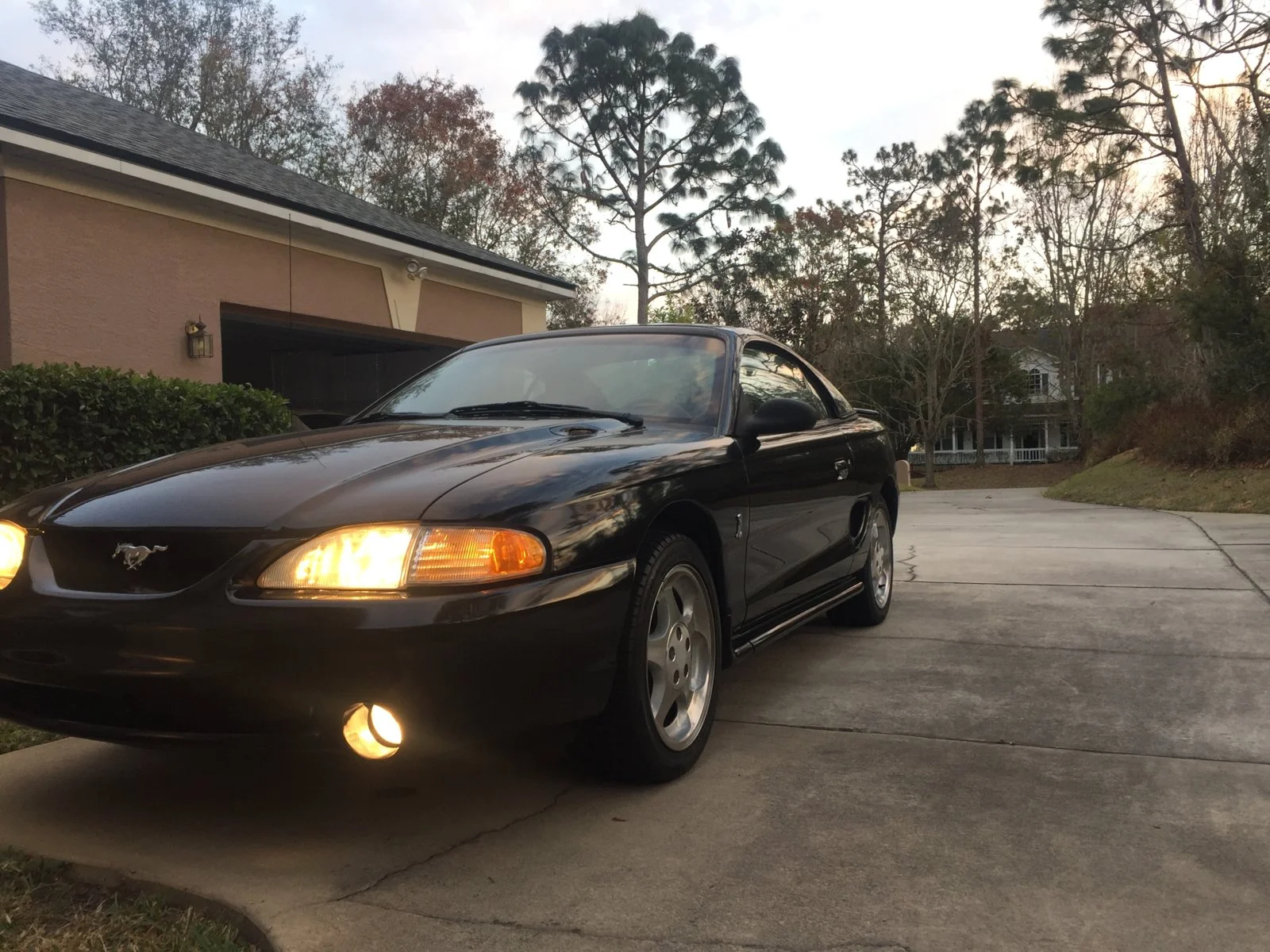

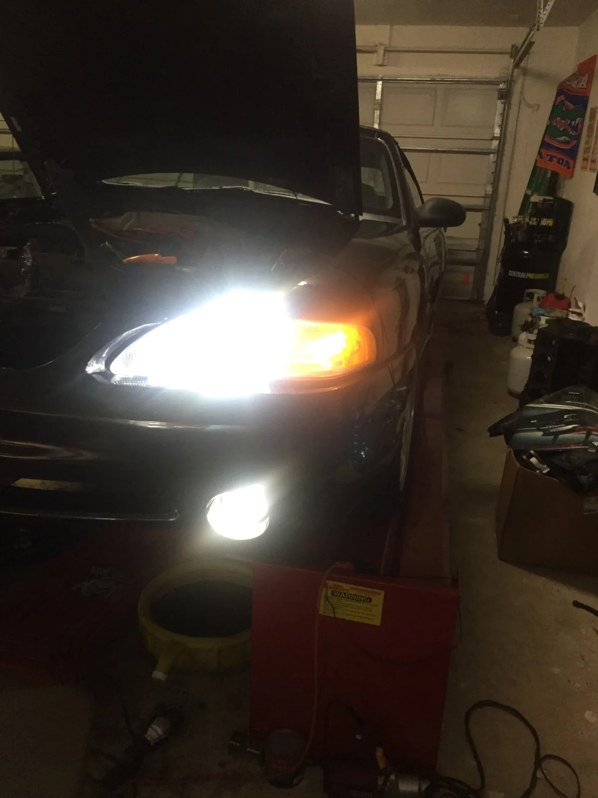

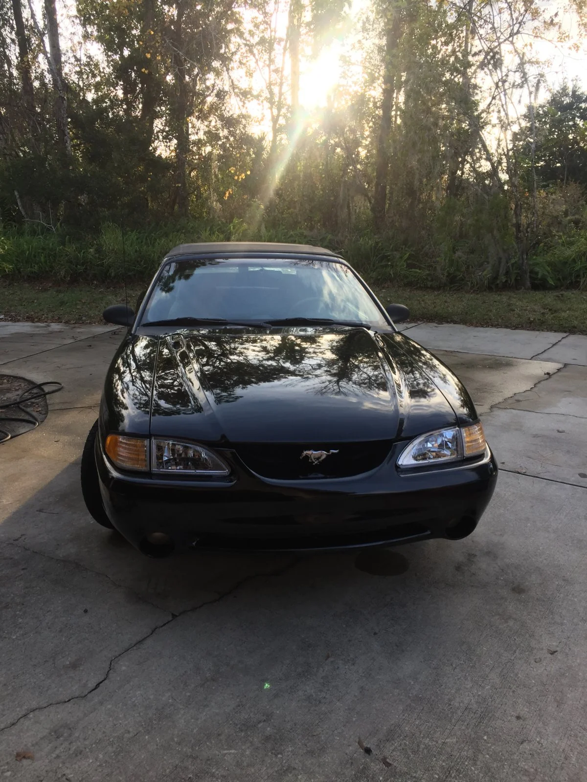

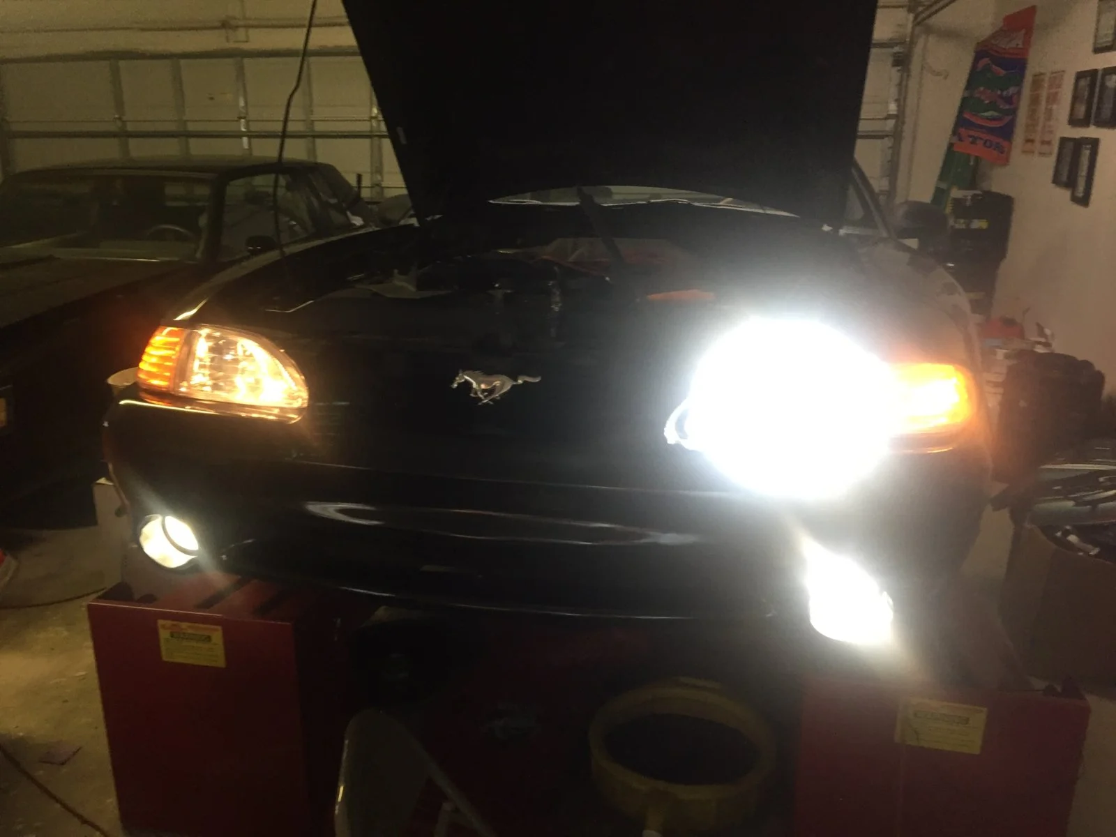

And for Christmas, my parents graciously gifted me brand new cobra headlights, I couldn’t wait for the led bulbs so I installed them right away after we washed and buffed her out. First two pics are before from a year prior, and the rest are from today, led head lights will be in on the 28th. Very happy with how this build is coming along, slowly becoming the vision I had in mind when we bought it. Merry Christmas to all!

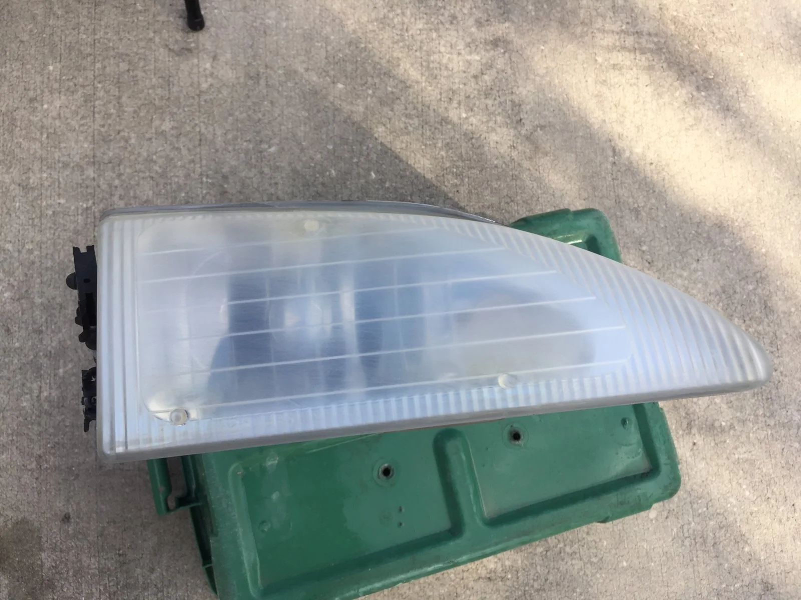

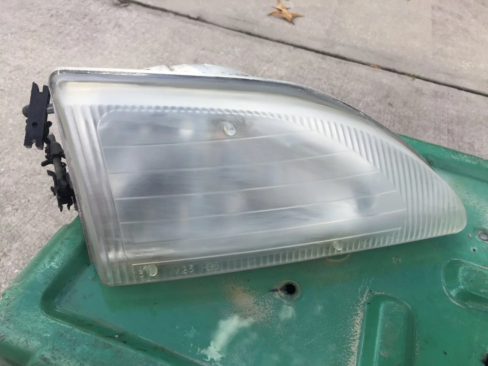

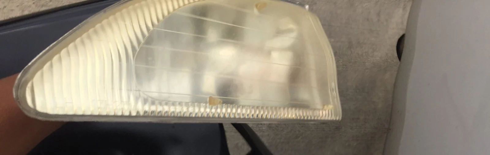

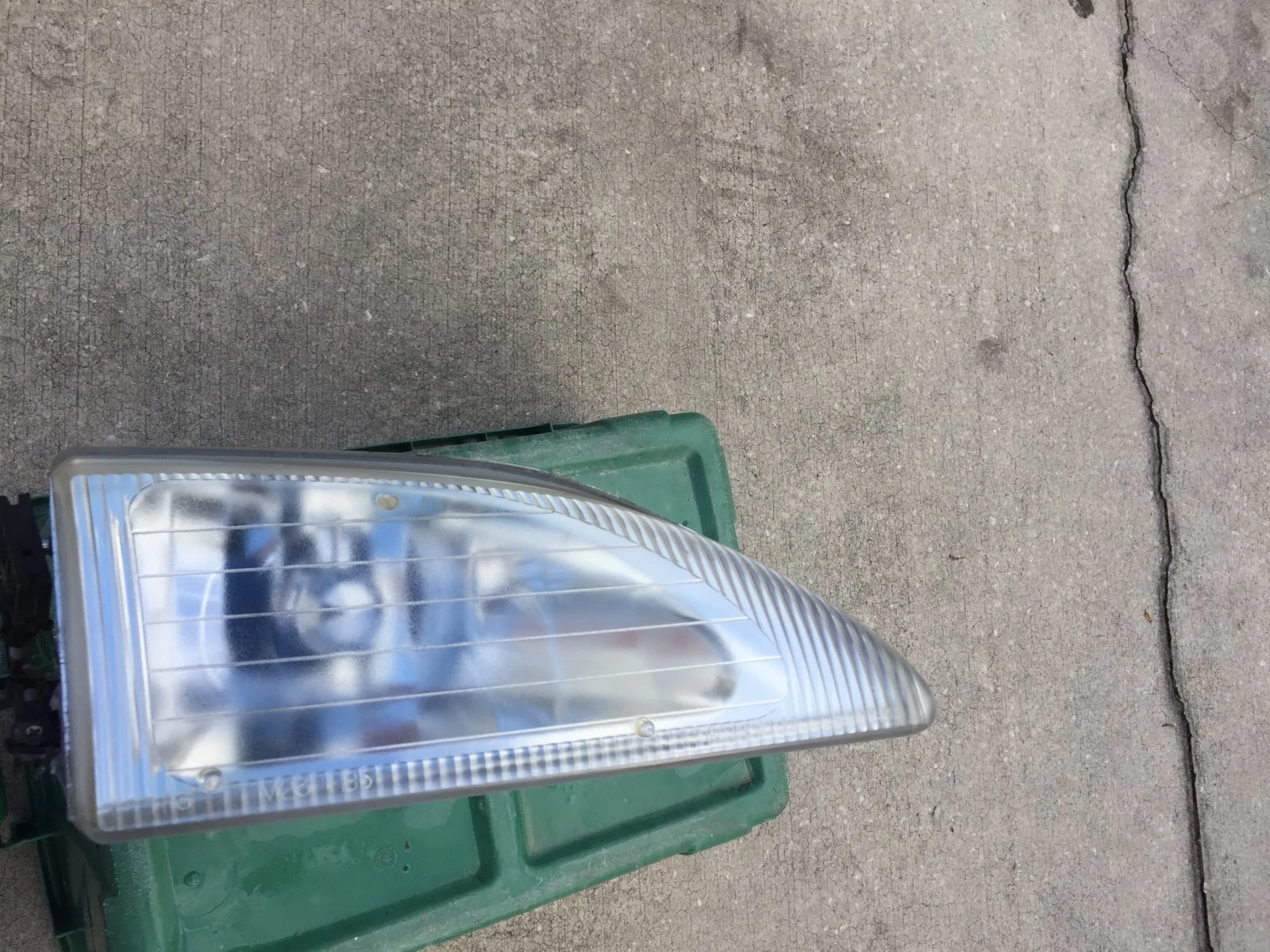

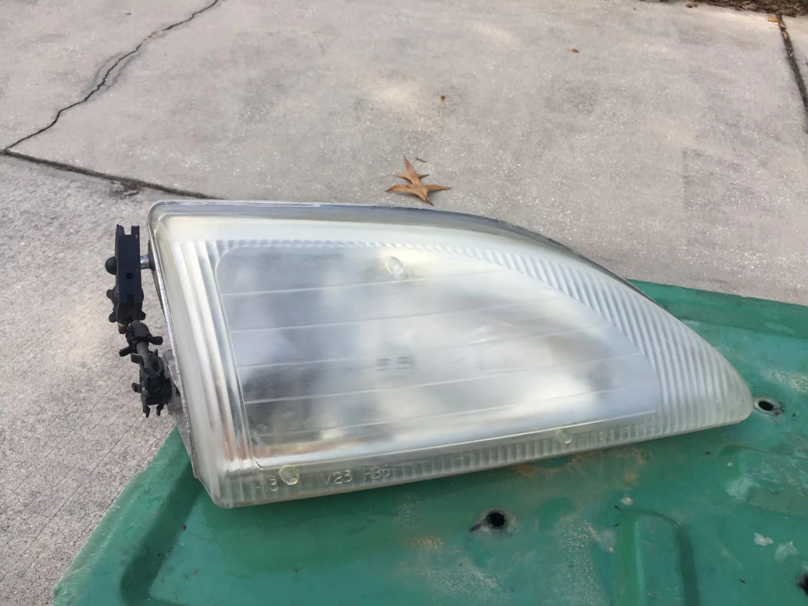

Took on a little fun project today in trying to restore old headlights, not a full blown effort just a little experiment
Here’s after 400 grit
600 Grit
2000 Grit

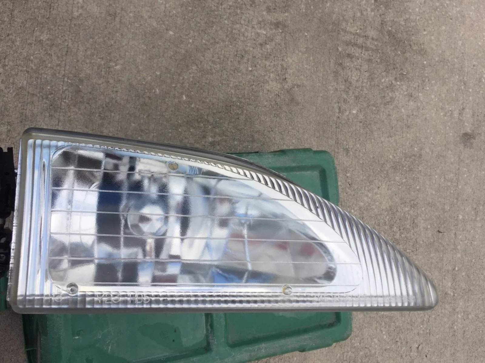

After first coat of clear
Third coat of clear done, still have to wait a couple days to sand it down once more to get rid of orange peel and polish it out
