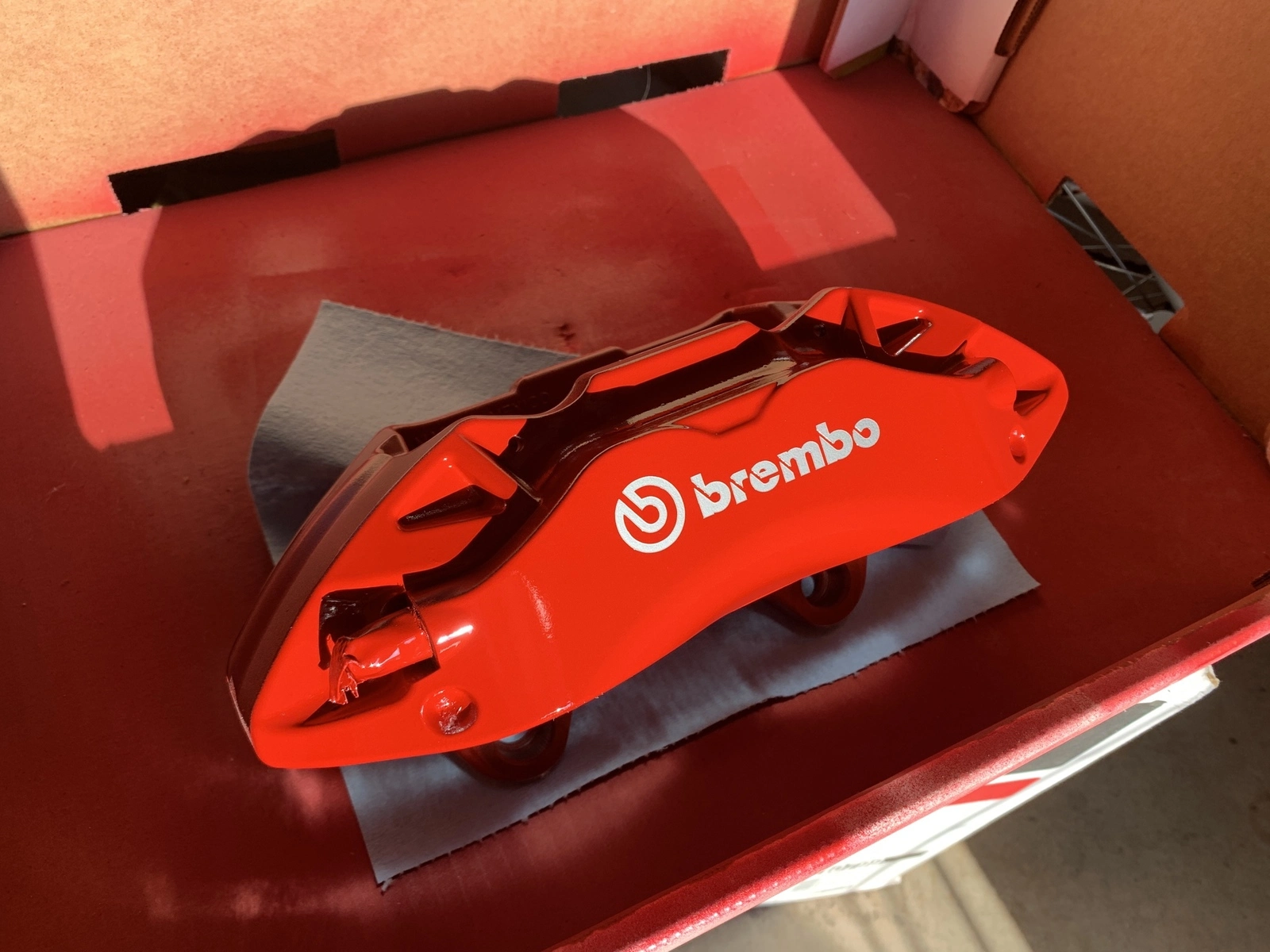

M12x40mm length. It does stick out on the backside and is close to the rotor, but no contact.
Removing the original inserts is easy. M14 bolt in the backside. Hold the caliper firm in one hand and a few taps with a hammer and it comes out. The press fit isn't really that tight. Easy to remove.
For the XTS Ill need the larger 14" Rotor? If so Ill try sending them back. ThanksThe description states ATS Caliper, but that photos is an XTS brembo
Thanks I apreciate all the help. I believe Ive seen them posted by you with the 14" rotor. I already have the cobra setup so Ill just send these back. The ebay seller said follow a return through ebay so hopefully I dont get screwed on my refund. Again thanks for all your help. I was just about to pound out the inserts before I noticed they looked different.Pads and hardware the same.
The body has a bigger curve and more offset from the spindle. I have both, I’ll see if I can get a side by side
Good catch!

Thank you...yeah its kind of confusing because I checked Rock Auto also and it doesn't find that part#...but if you look at the add on eBay it shows that it fits 2013-2019 ATS and it says its interchangeable with other part #s...hopefully I got the right ones especially since I sanded one already and prepared it for paint LOLWelcome, nice to have you here.
I checked that first part number on the ad against Rock Auto and didn't see it... I see

I did put a list of parts I ordered in my build thread for this... and the pictures look correct but @Mustang5L5 would be able to compare the XTS for you.
precisely why I didn't buy mine off Ebay, but rather a parts seller...Thank you...yeah its kind of confusing because I checked Rock Auto also and it doesn't find that part#...but if you look at the add on eBay it shows that it fits 2013-2019 ATS and it says its interchangeable with other part #s...hopefully I got the right ones especially since I sanded one already and prepared it for paint LOL
Yeah, just figured these guys looked pretty reputable...had a lot of good reviews...who knows I guess i will find out LOL...wish there was better way to tell if they will work by looking at them.precisely why I didn't buy mine off Ebay, but rather a parts seller...
