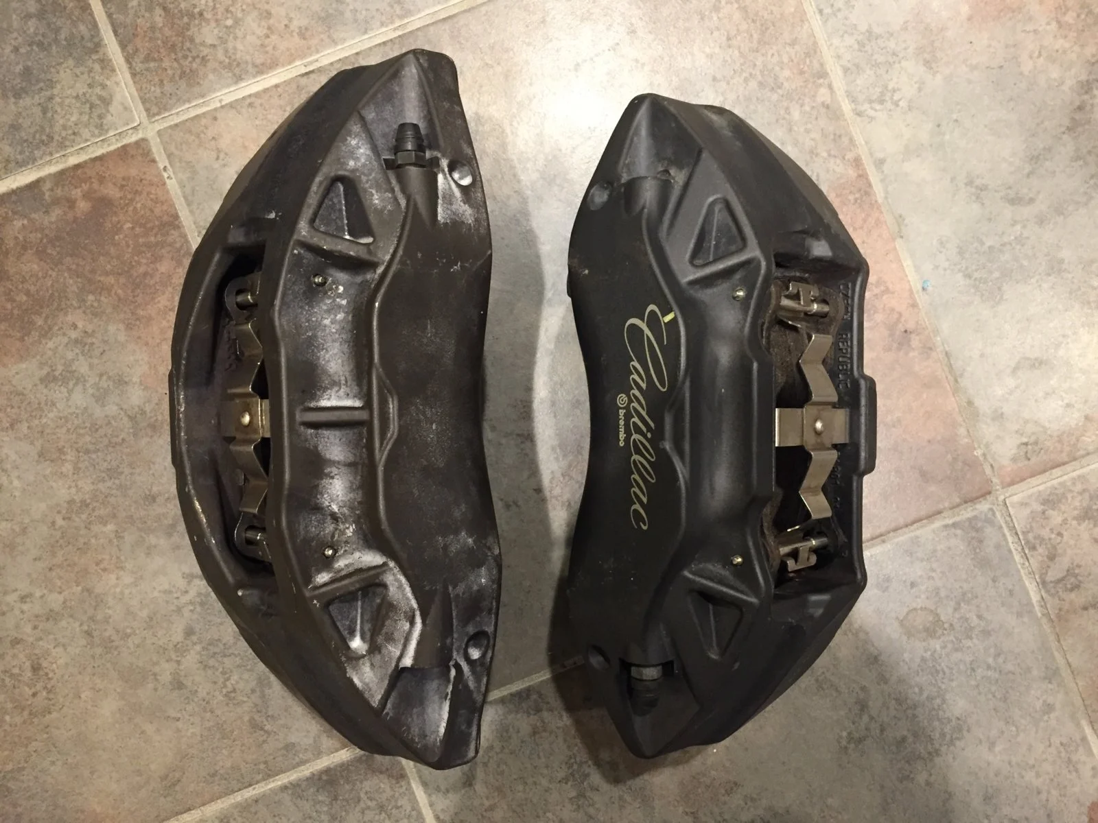

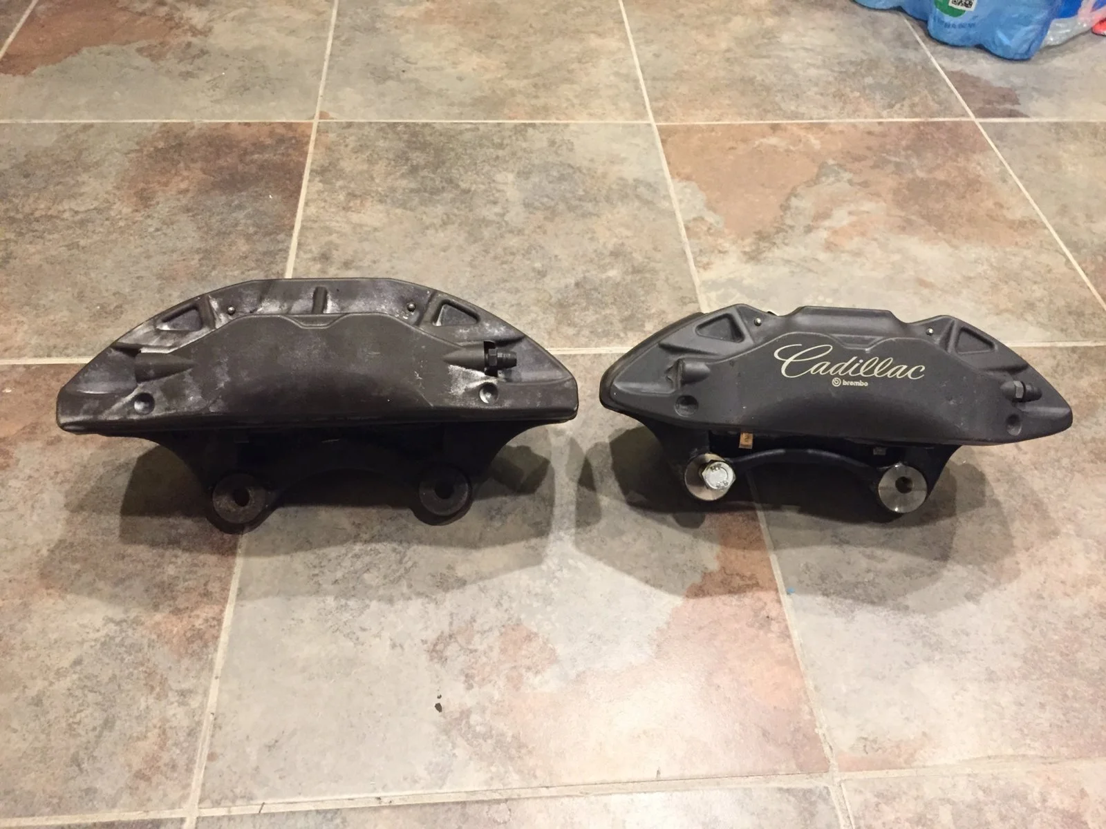

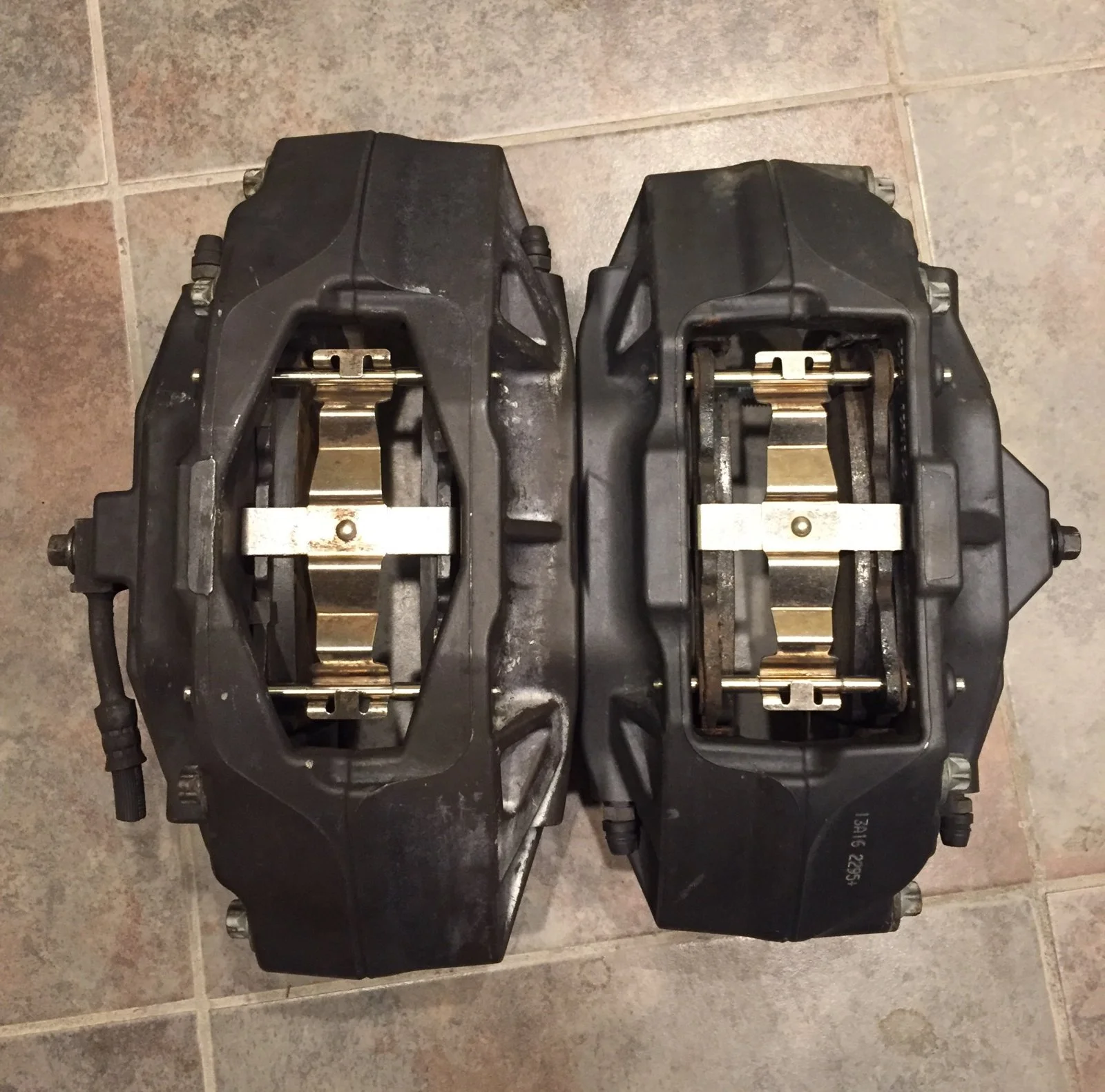

A lot of sellers are mixing photos of the two up. The XTS and ATS are similar but not the same. The XTS uses a 13.6” rotor in its original setup, while ATS uses 12.6, so there are differences in size and height of the calipers.
XTS on left, ATS on right in all pics
They use the same exact brake pads and hardware. The XTS is physically bigger with a more pronounced curve. The ATS Caliper has two notches on the top curve that makes it easy to ID vs the XTS
AWESOME!! Thank you so much...this definitely helped a lot! I have the one on the right so this will definitely work out. Looking forward to doing all this to my car once I can get back down to Florida to get my car. I am currently in NY unfortunately, stuck here with all this COVID 19 crap going on!...I am a fireman up here in NY, have 2 yrs left to retire--cant come soon enough!

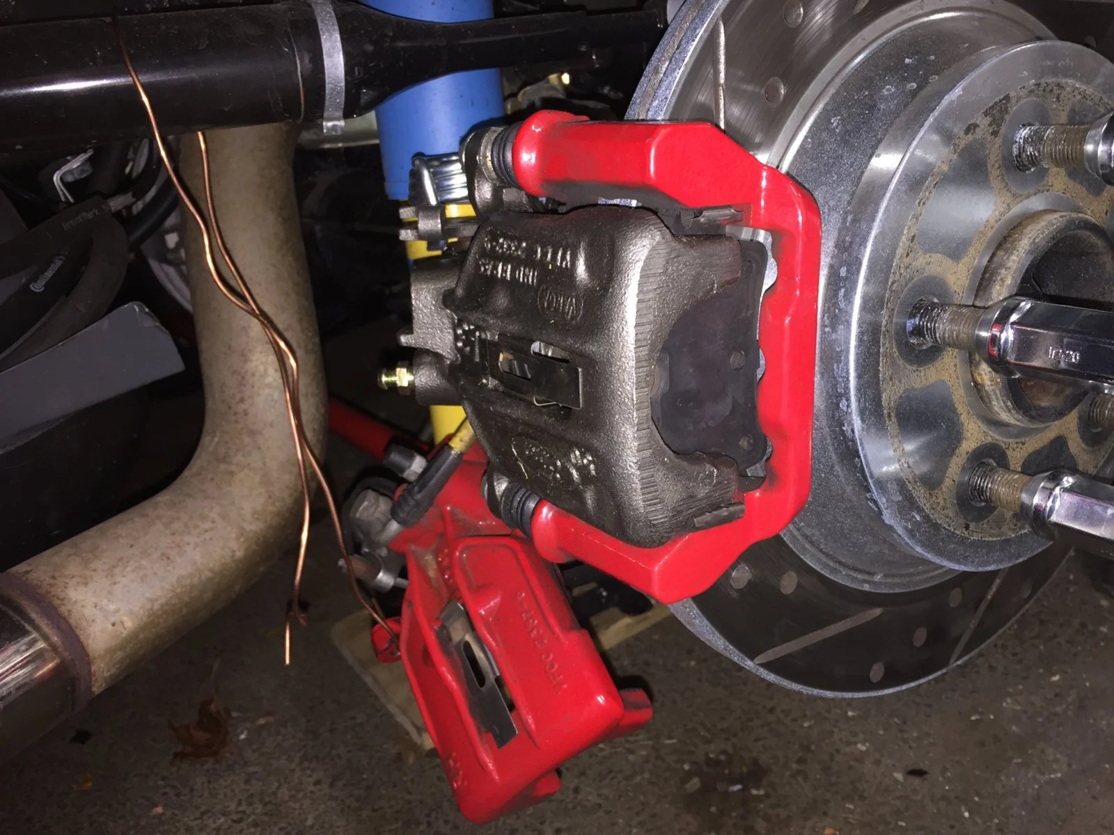

What are you using for rear disk brakes? Should be using the 11.65” rotor and calipers from an 94-98 cobra.
Where the Taurus Caliper come in is that the Caliper portion of the above setup is replaced.
So in this pic, my setup is purely cobra brakes, except I swapped out the Caliper fit the Taurus 43mm unit (the bare cast Caliper in pic)
The red Caliper and bracket are the cobra parts, along with pads and rotor
Makes sense?

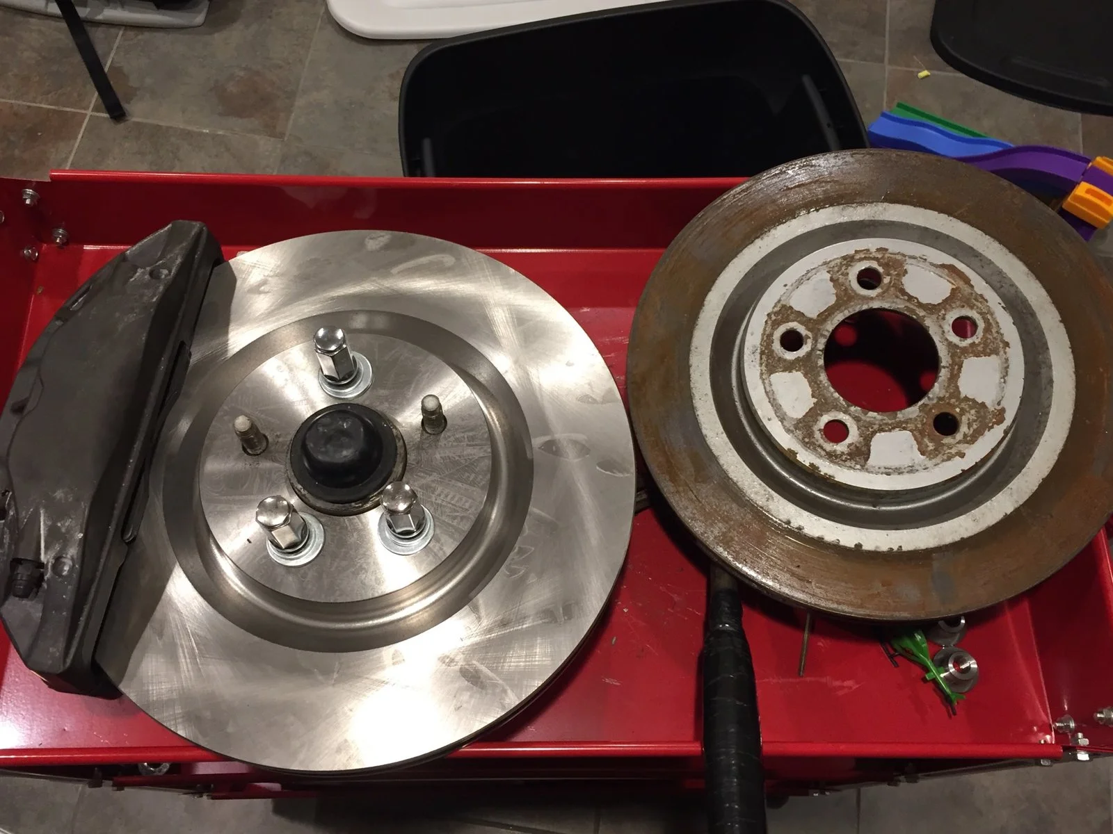

Maybe you can help me. I bought XTS Calipers thinking I was getting ATS Calipers, and I have them mounted on my car already. my question is, is it ok to run my cobra 13 inch rotor? Or should I buy bigger rotors? Or sell them, and buy ATS Calipers?
The 13' rotor is too small for the XTS caliper. If they are mounted on your car? What rotor are you running?
I used a 2007ish GT500 14" rotor.
Caddilac XTS 14" Brembo brakes on a Mustang...under $300
Just messing around with this setup, no intention of running it, but pretty impressed how it fits together. Not strictly 100% bolt on though..but can be. Cobra 13" rotor on the right. They are Junkyard Caddy XTS Brembos, and GT500 14" rotors. I paid $90 for the paid of brembos from a...
www.stangnet.com
The rotor clearance to the caliper is tight. To center it, I had to machine a time bit of the caliper mounting face off at a time. I know the ATS kit comes with a spacer, but the ATS caliper is only fitting a 1.1" thick cobra rotor in the rotor channel, so a lot more forgiving. The GT500 Brembo is 1.25" thick, and the rotor channel on the XTS calipers is maybe 1.4". It's tight.
Looks badass though (rotor on right is the 13" cobra rotor)
